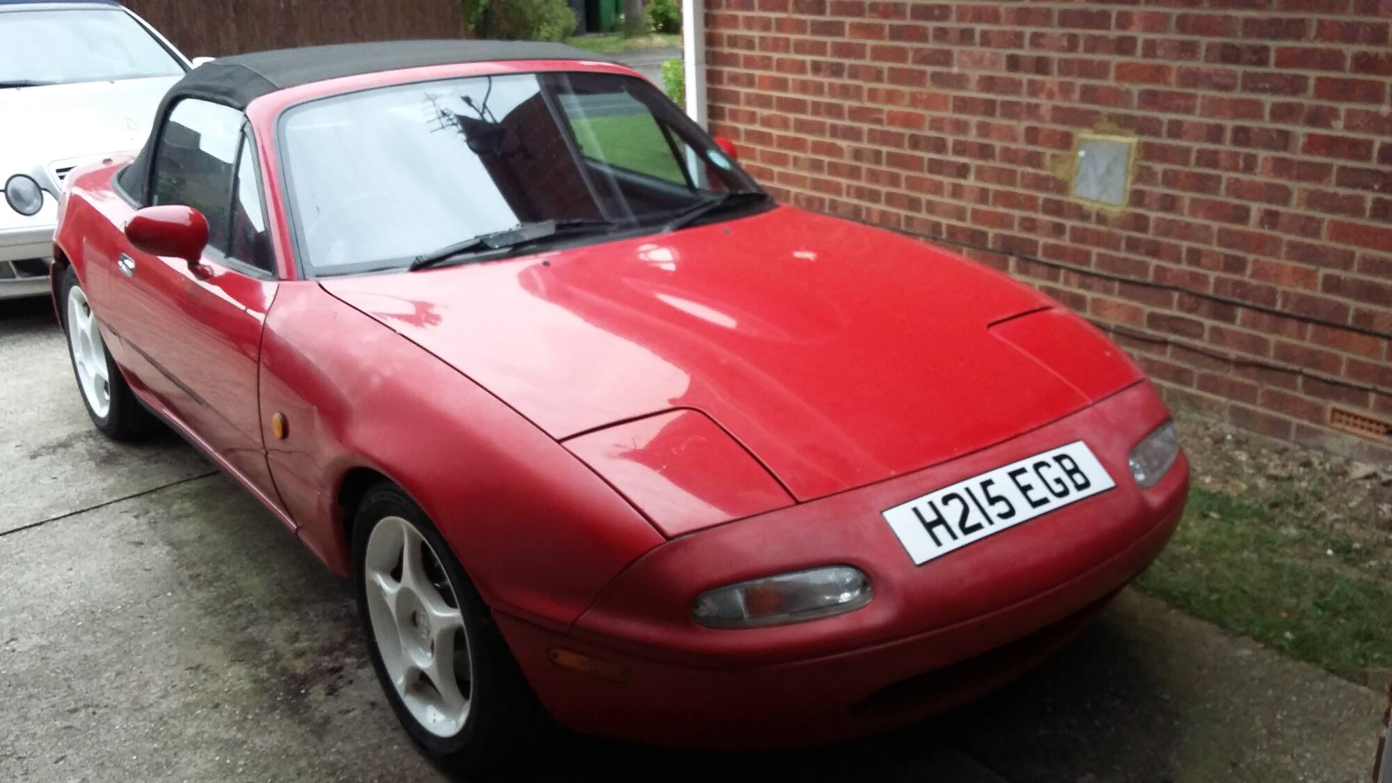

I've decided to create a thread for my long-neglected MX5.  It's been unused for the past 3 years and I need to decide if I'm going to keep it or sell it, so this may yet become a
'for sale'  thread if it fails the MOT in spectacular fashion later this week.  REMAIN CALM - I know I'm raising your hopes of owning a rubbish old car that makes you look like a Pound
shop Peter Stringfellow, but you must be patient.

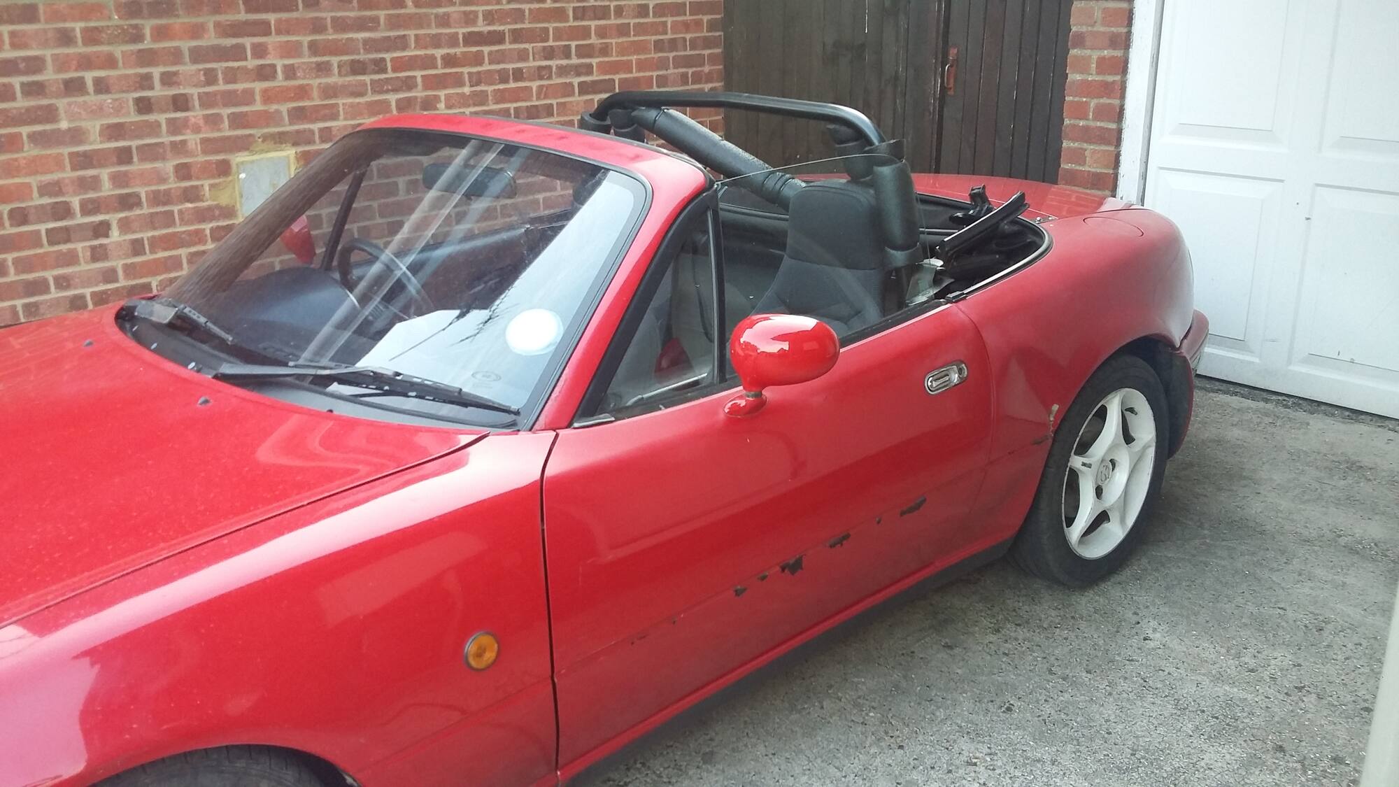

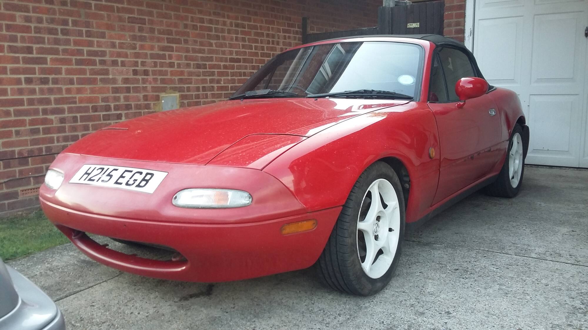

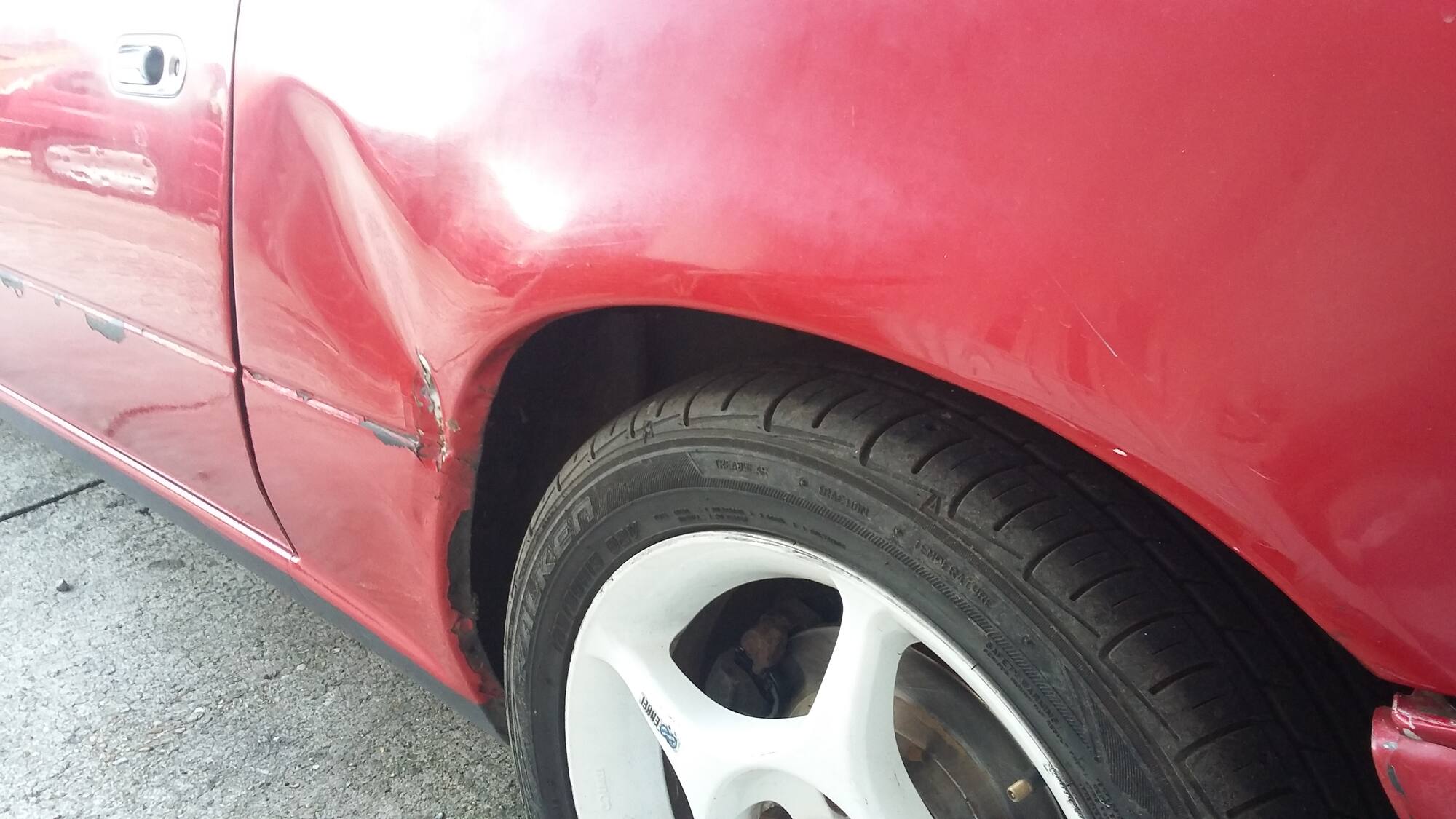

Here it is - doesn't look too bad but the photo flatters.  Note dent in the wing, I did that with the forum-bike Jaguar.

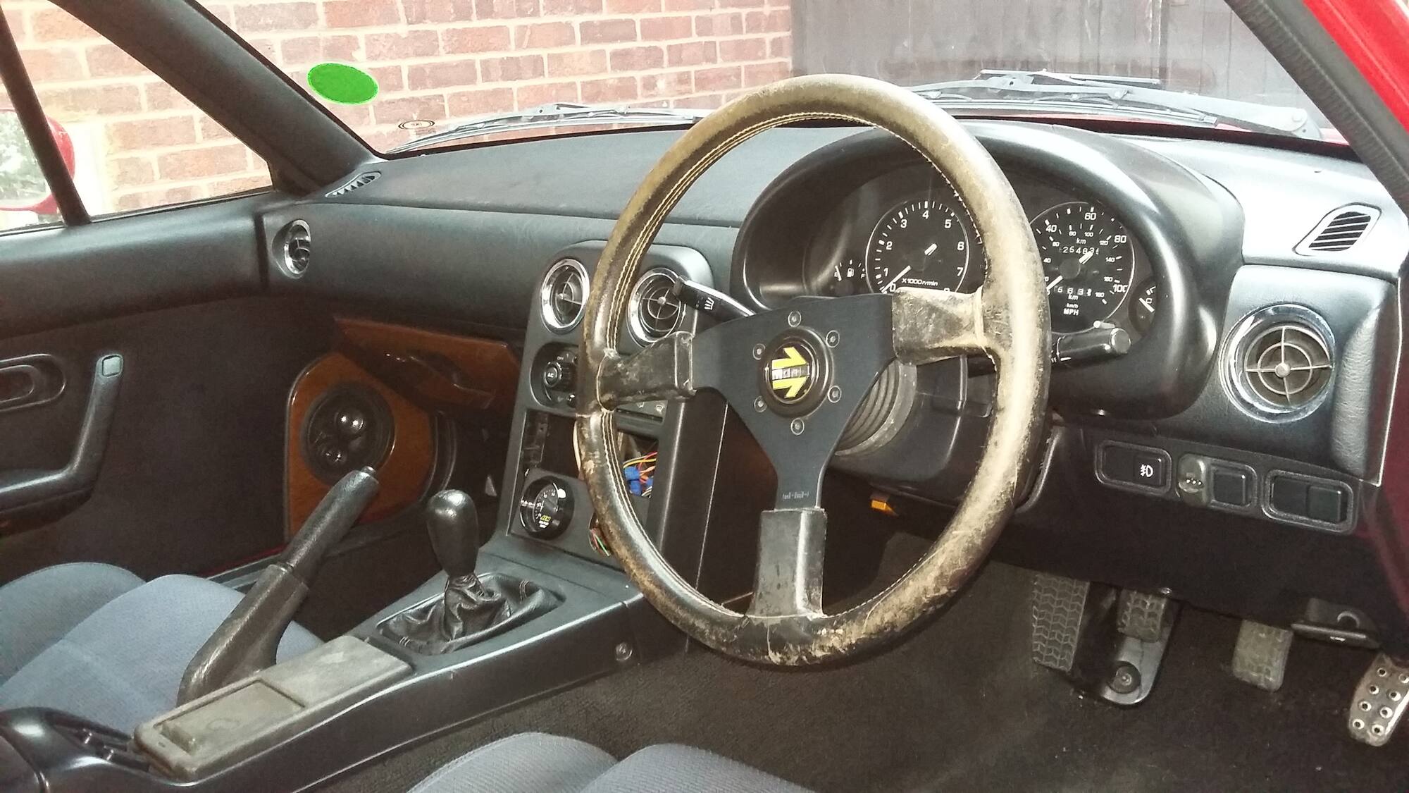

'Minor' wear after just 250,000 KM. Check out the plastic wood trim, RARE and DESIRABLE, that is.

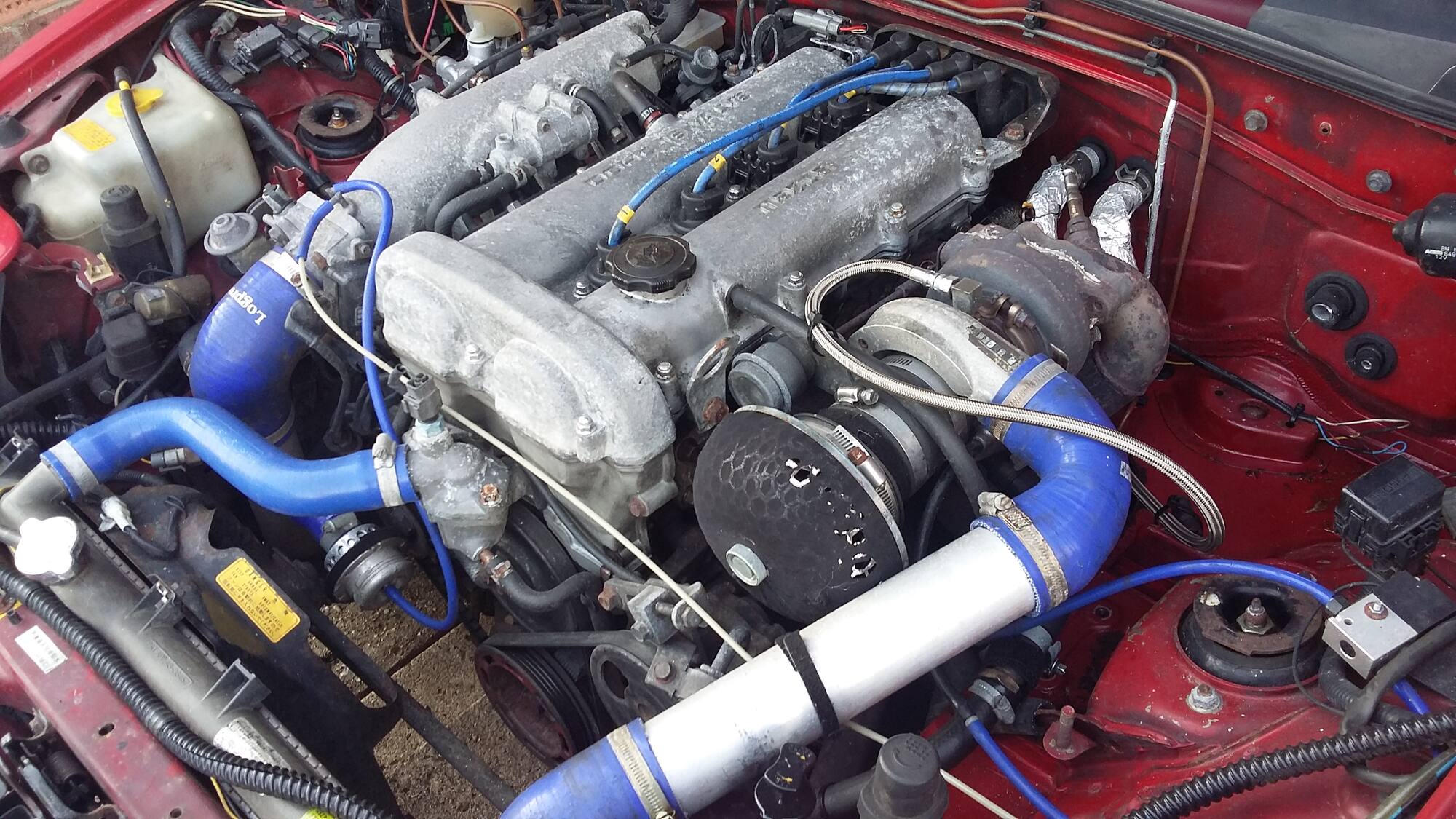

More cobwebs, but behold the SERIOUS TURBO BUSINESS. I enjoy swift progress so made a lot of modifications using parts mostly picked up from eBay, etc.  The turbo was from a BBR (a dealer fitted turbo kit available on the mk1), it needed a rebuild which I did using a kit from the USA.  I can bore you with all the other stuff if you like, PM me if you like hot 320cc fuel injector and wideband o2 sensor chat.  I built the Megasquirt ECU from a kit, that's a reassuring thought when you're in the middle of nowhere in the dead of night.

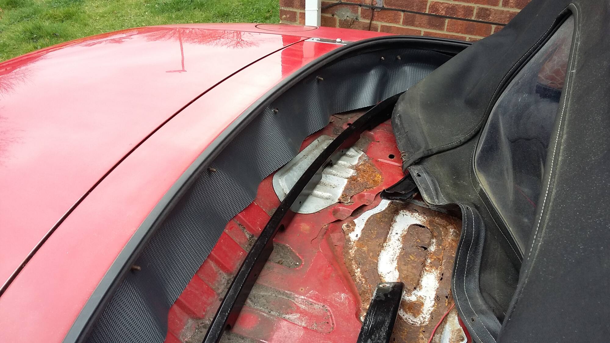

I got into motorbikes about 8 years ago and the MX5 saw less and less use; I stopped using it altogether when the clutch wouldn't disengage and I couldn't be arsed to fix it.  But now I've finally got my finger out so have been rapidly preparing it for an MOT.  First thing was the leaky hood; I suspected it was the rain rail (a U-shaped gutter that goes around the base of the hood), and when I removed it found lots of holes and splits.  You can still buy replacements from Mazda but at ~£170, so I made one out of PVC damp proof course instead.  It works and cost less than £10.

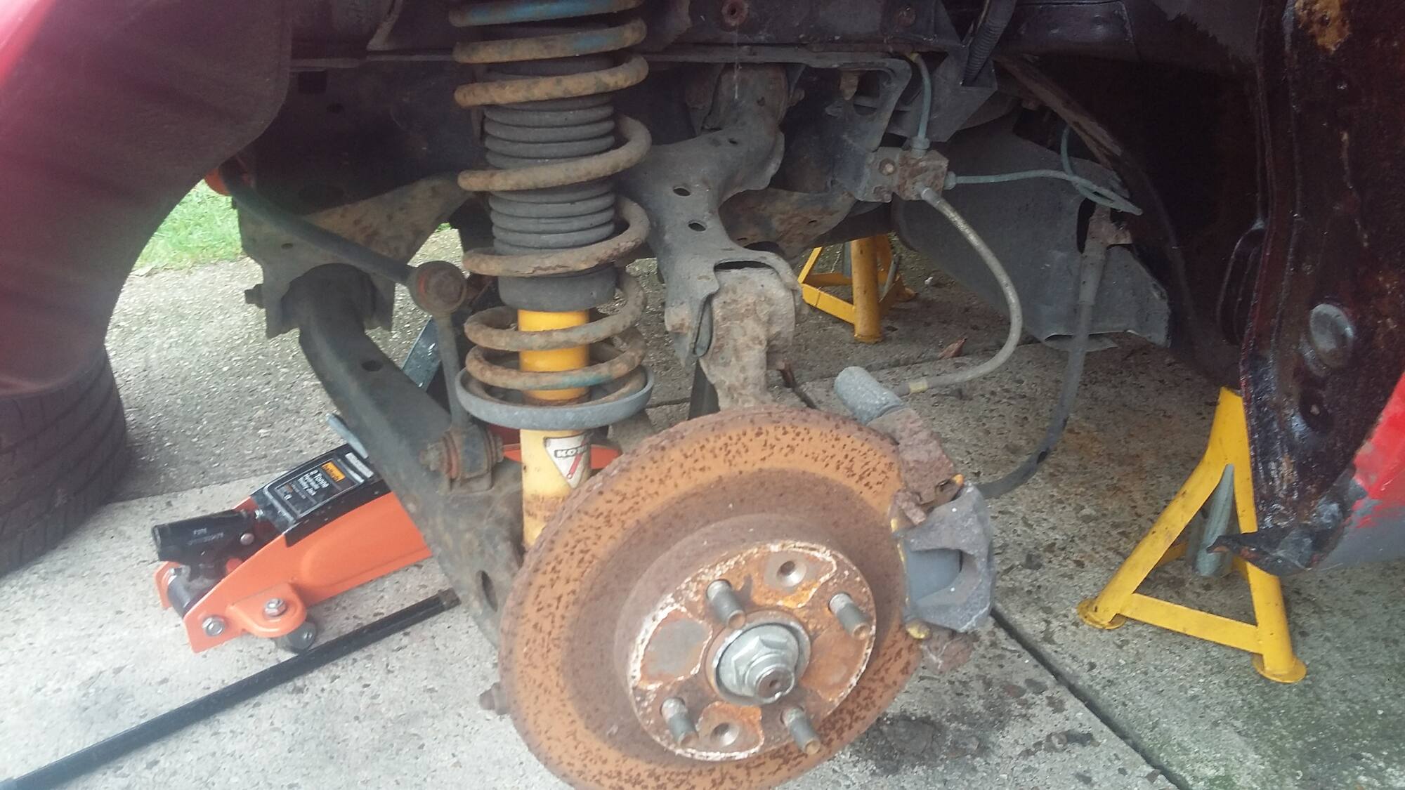

Clutch was next.  Slave cylinders like to fail on these, and when I squeezed the rubber gaiter on it was rewarded with a load of brake fluid in the mush.  Bought a replacement from Rock Auto for less than £10, delivered,  will probably regret that before long.  Or you will, potential MX5 owner!  Brakes next, these were lovely about 5 years ago...
2019: all new disks/pads fitted now.
