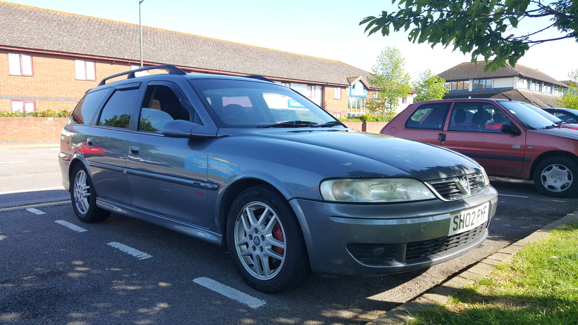

Pics of the '99 Vectra B estate please. It's time this thing had a friend/competition;
