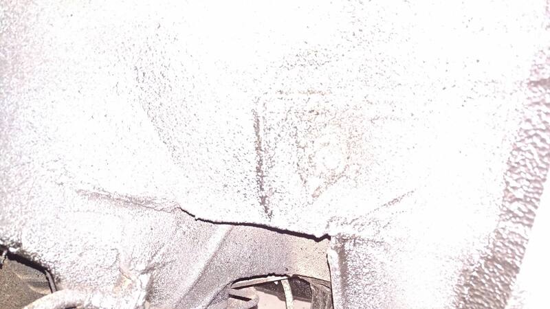

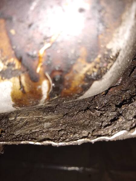

Then I took the arch liners off and was greeted with this:
IMG_20191023_120946392.thumb.jpg.b0f1ae1cc8675e9633809f58455da5b0.jpgIMG_20191023_121012070.thumb.jpg.39d80cba2d47a237909dfbe616c888db.jpg
The bottom of the wing was completely gummed up with silt. Blew it out with the airgun and then let it dry. I passed the time by jetwashing the concrete outside the office door. Sparkly clean now.
I was pleasantly surprised to see that the arch liner was doing its job and keeping this area nice and dry. Blew the cobwebs out and then smothered everything in Dynax S50 as its a cavity in my mind. No photos because mess. A lot of mess.

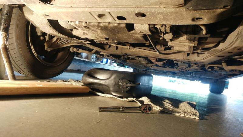

Car's due for an oil change. Re-tensioned the alternator belt to what the Haynes manual says and looked at the waterpump belt. Interestingly enough it doesn't look that bad so I'll leave it be for now. Nearside front tyre is letting out a lot of air now. I think I'll need a new set soon!
Well the day started well. I originally intended to change the oil in my car. I then found out I only had 2 litres of oil and no money because Doovla took £34.00 for my provisional licence, and I wasn't near a bank branch to pay in a cheque I received for Christmas. Post office didn't want it either as I had no generic paying-in slips. Still, I had a list of things to do, like inflate the relatively flat tyres, wash the thing, check the air filter and do the general checks one does on this occasion. I also made the decision to ditch the undertrays as they were doing nothing but cause the crossmember to be eaten alive.
So I remove the undertrays...

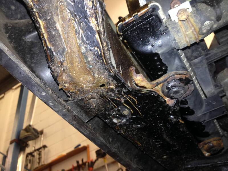

And uncovered this problem area I mentioned in August. Lots of rusty water dripped off too. I did some tapping around with the screwdriver to make sure the metal was solid. In the video I said it seems to be solid, BUT:
Ha ha nope. It's not solid at all!
And that is how far I got I believe.
IMG_0881.thumb.JPG.593c624bb953918a5720b24ed9c5d5a1.JPGIMG_0882.thumb.JPG.ba6691a66bbd64b8b28b39539bf45e61.JPG
As you can see, a nice amount has been removed. Now, the massive crater I have produced is separated by a piece of steel that separates the bottom of the crossmember from the part that links with the wheelarch. There aren't any holes to let in water down there but I imagine water was seeping in from the top where the radiator is mounted. Fortunately it doesn't seem to arduous to weld and make good again, however the sooner the better. I know a friend of mine is doing well with his welding so I might invite him round or stump up the money to get a professional to make it sound.
The smaller hole is instead an ad hoc drain hole. The reason why its there is because the other drain holes were blocked completely by the factory installed undertrays.
By comparison, the other side shows mere scabbing so I think I got lucky here. Sooner or later I'll strip back the crossmember and paint it and undercoat it properly so I shouldn't need to worry too much until Mr. MoT man tells me about it!
So here's where we stand. As long as the car isn't driven in the salt and is allowed to dry out, I'll do my best to make sure what is there doesn't grow any bigger and hopefully, new metal will be put in soon to replace what the tinworm got rid of!

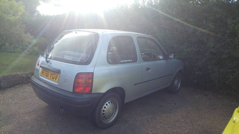

20200315_153822.thumb.jpg.e97d8382c2e5c9e75cf879a3c69aa58a.jpg20200315_153806.thumb.jpg.5cd5214c8f4a0357c0c3b6d1a7df938e.jpg
Taken on a trip last week to the unit to put the bin out. One of these days I'll treat it to a wash!

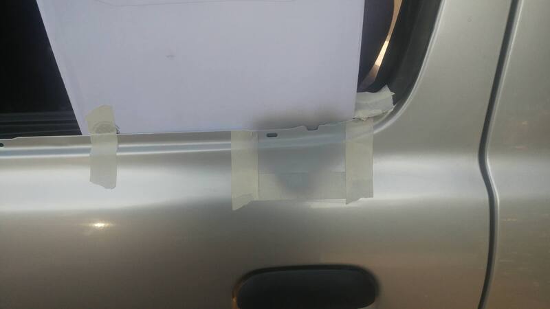

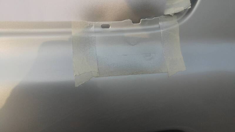

Today I washed the thing and proceded to get distracted with the rust on the passenger door
The "wastegate" thing (the rigid window beading at the base of the glass aperture) is rubber encased steel and it seems it scratched the paint when it was installed, resulting in a festering wound as such. So off it came and I rubbed the spot down. Quite some serious pitting in places but not anything too concerning. I also filed off the burr which caused the scratch as well so the problem will never happen again.
20200427_170358.thumb.jpg.dd668552662532d1e35247942bda542a.jpg20200427_171338.thumb.jpg.b179a81f3672e4ed192be260772eeca3.jpg
Zinc primer and paint applied. Nice drip too.
Lacquer applied and the masking tape peeled off. Looks okay I guess. Could have done better, however its far better than rust being there. I then polished out the lips where the masking tape was, as well as the overspray from the rattle cans. I used a promotional sachet of Meguire's "Ultimate Compound" which claims to be clearcoat safe, however it has the consistecy of watered down T-cut. I've yet more to do but it looks good for now. As the sachet is single-use, I decided to use the rest on the bonnet to get rid of some of the scratches on that. Managed to buff it to a nice shine too!

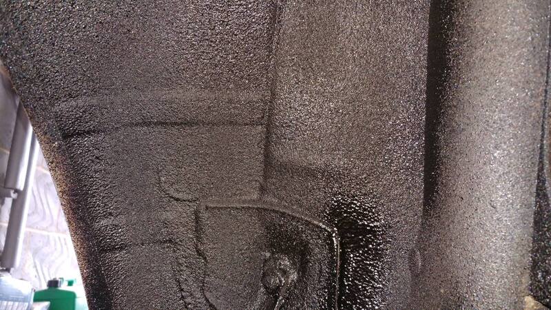

When I first washed the car at the unit last year, I also undercoated the rear wheelarches, the nearside in Dynax S-50 and the offside in Dynax UB. After washing out the wheelarches today, here are the results:

Re-coated the wheelarches with Dynax UB:
20200503_161423.thumb.jpg.b89534dc00a2fe6bd6ea70b1593cd928.jpg20200503_161701.thumb.jpg.b62dddf689a9b72b7cbdd9826b5d8334.jpg
Sorry about the shitty camerawork on the offside photo. Camera just wouldn't work properly!

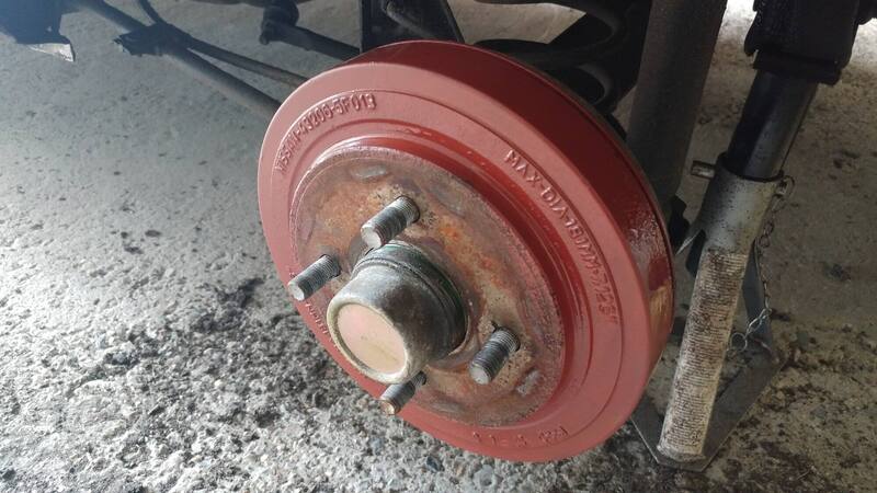

Then addressed the silver brake drums:
20200503_161717.thumb.jpg.87b03e1260b6c03e050e35f8dbdf4336.jpg20200503_161727.thumb.jpg.48717140f945fd082c70b0a9d09c06fe.jpg
Now painted with red oxide primer
20200503_161739.thumb.jpg.136e79bd56b03d0232987f04c478d0bb.jpg20200503_161744.thumb.jpg.b29ec8837edacbc22fb9690723b1436c.jpg
Did the same thing with the seams on the insides of the wheels. When I get round to getting new tyres for it, I'll respray all of them so they look silver. I'll do it properly this time too.

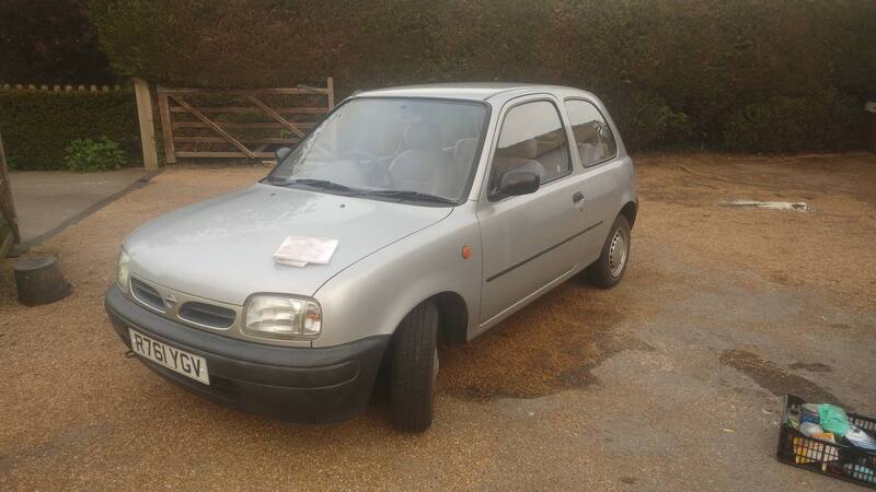

On this day 1 year ago, I bought my Micra.
20200618_184551.thumb.jpg.ea46c9bbfa89294a6aeb1210864c84f1.jpg20200618_184609.thumb.jpg.009ded9bc5b4c67e824420b775d351f1.jpg
Still looking just as happy (if not happier) as it did when we came to collect it. Nice.

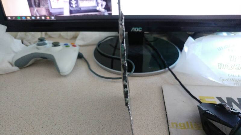

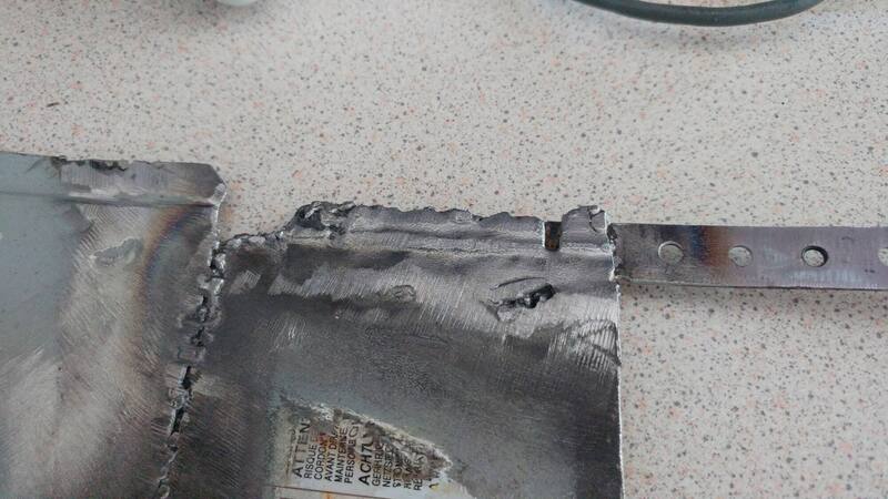

Been meaning to do this for a while, but had to wait for my angle grinder's replacement handle, leather gauntlets and welding helmet to arrive. Now that they have, I conquered my angle grinder fears and cut up and cleaned some steel I had lying in my scrap pile.
One first-time butt weld for your viewing pleasure. Blew a few holes in it but some patience and careful blips with the sparkly stick had me carrying on down the seam. Spatter because gasless goodness.
Wirebrushed, wirewheeled and finally dressed back. Not as bad as it could have been!
A few pinholes found after grinding- 7 in total which I'll make good tomorrow. Not too shabby for a first attempt!

Fortunately the holes are only on the nearside of the car. Everything else is surprisingly solid and still silver. Because of how little crossmember rust there is and the little time I now have, I've decided to weld the areas which are of issue. That'll be after the MoT though so I'll bung the undertrays back on and forget about it until it's tested the week after next.
I'll probably buy a new crossmember anyway, because I'll be constantly playing catch-up with the raw steel corroding away. That's a long time in the future however, but it's good to at least be prepared!

At this point I noticed that the "grinding disc" I was using had chunks coming off of it. That being said, I don't know how one can market a 1mm disc as suitable for grinding because it really isn't:
20200816_183438.thumb.jpg.9db4089140742e6b0db39fab483f07b1.jpg20200816_183446.thumb.jpg.7a57294c3a120a331015ff8a334d7658.jpg
"All rounder" my arse. Uneaven wear pattern too! Okay, it's not the worst but I think I'll use it for cutting and cutting only from now on... that is, if I summon the courage to use it again (bits of disc were going into my face). Anyway, learned my lesson and I've ordered some Abracs flapper and 3mm grinding discs. A tad expensive, but a good investment methinks.
That disc is fit for the bin! Would not recommend using that at all as its now weakened.
Shame that, as it has an expiry of 2022 and was around £2.00. Didn't even specify on Toolstation that it was a 1mm disc so that's annoying. Oh well, when I get back from Wales I'll break it in half and toss it into the bin as its replacements are arriving while I'm away.
