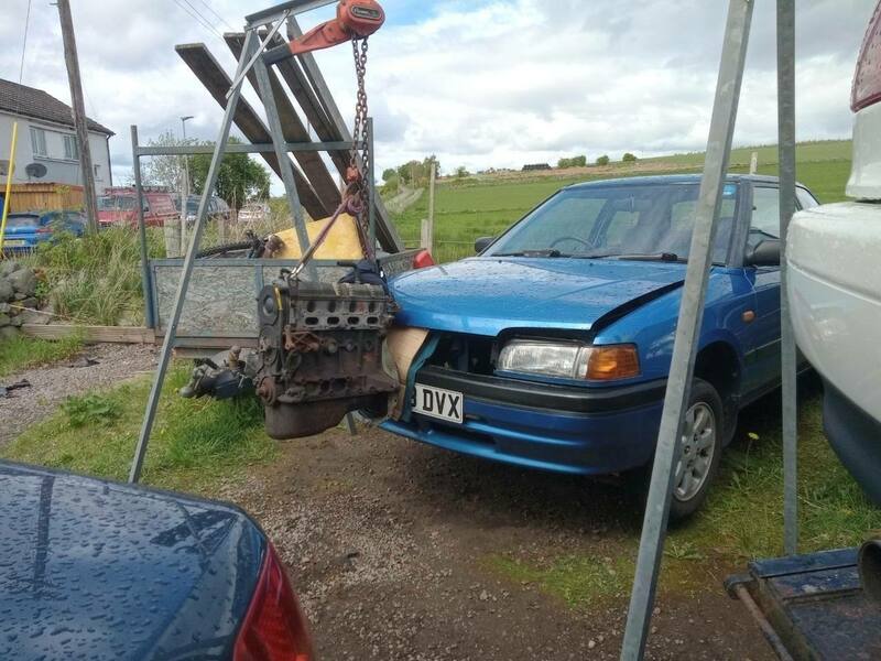

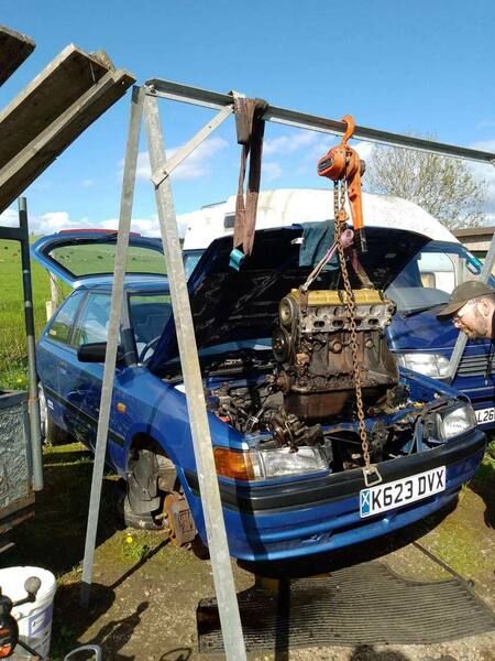

Yes, this carbuncle will be used to lift out the 323's engine, and lift in the new one!  I don't have access to a proper engine hoist, and anyway, the car is on a rough bit of ground that wouldn't suit one.
I had the steel (work were going to throw it away!  Galvy angle iron!), and the chain pull may have followed me out of some previous occupation, so t'was all free... my favourite price.

Old lump is out!  Had the day off yesterday, and the sun was shining, so forged ahead...
The ancillaries were pretty quickly removed, as I've had this thing apart a couple of times now.  The engine itself was held in by it's mount on the offside, and only four big bolts on the bell housing.
Whatever's wrong with this thing, it's definitely in cylinder three btw, only oily plug, and exhaust port oiled up too.  I'm suspecting a cracked head, that opens up when warm, but I don't really know.
The aforementioned hoist set up worked really well, although the engine did have to be turned a bit to wriggle out of it's home.  It is currently sitting in the corner, thinking about what it's done...
While everything's out the way, we will clean up and oil up the usually inaccessible corners, before fitting the 'new' donk this weekend (work and weather permitting, of course).
The clutch looks pretty brand-new, which is nice, and the flywheel is in good nick.
This repair has turned into a proper saga, and we're all desperate to see the wee thing hit the road again.

and it all dropped back into position lovely.  The heath-robinson lifting gear worked really well, I don't think a proper hoist would have been any better now. It's a very light engine mind, easily liftable by two people.

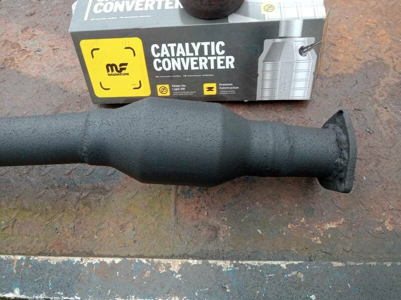

Coupe, just in from fitting the new Magnaflow cat into the exhaust... this has been a bit of a saga, but hopefully this last bit will bring the emissions back into line!  Started and ran lovely, really like that V6 lump.
I even gave it all a lick of VHT paint that will probably last about 2 minutes, but made me feel better!
Sounds much more muted than it did without the resonator (miss the DTM soundtrack still!), but it does still have a nice burble to it.  Be nice to maybe get some runs out to shows this summer.

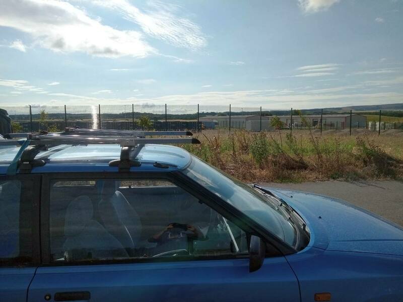

Just a pic update really... Spent a bit of time converting the 323 to MTB spec today...
This will be its life from now on, both boys are pretty into hitting the trails at Glenlivet etc...

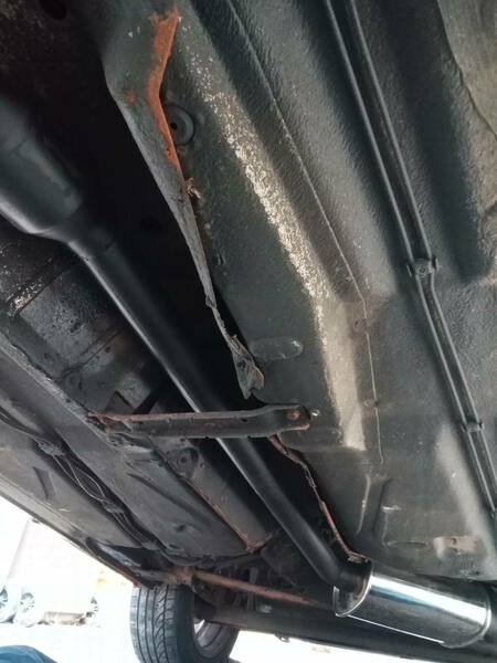

Edit...  Went back to the garage yesterday to get two new front tyres on (good ol' Toyo Proxes), so the only remaining advisories are for the corrosion to the brake discs.  Mechanic assures me they're ok, just rusty from standing.  He recommended using them this summer and changing when off road for winter ready for next year.  Also got some fuel system cleaner (trade stuff he uses, can't remember the name now), he says it's probably worth treating regularly due to the low usage and shite fuel we get these days!
Car's running beautifully, and feels great through the bends on the new shoes.  Proof that it is faster than a 323 with two bikes on the roof below...!

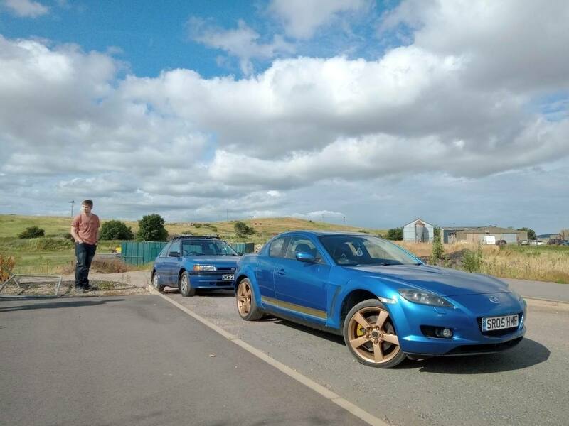

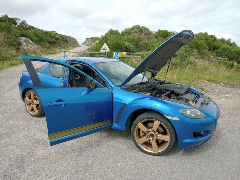

Long drawn out collection (about to leave for work first) starts with pre-breakfast...
Mmmmm...
Anyway, PC = 1.
All aboard the mighty Maz...
Be quiet for an wee while, work to be worked before EXCITE!!!
Work worked, all seems to still be here...
Most important bit...
Onwards to glory*....!
Pez shot, ahead of car shot????!!!!
Interesting...
Curious, no?
Dodgy industrial estate achieved...
Success!!!!
Further updates when home or broken!!!
Oh, stalled during young helper test drive...
Not keen to go again.  Spinning over quite slowly (was jumped to start first time, so hopefully the jump leads and 323 will save us).
Drives amazing, nobody say tip seals!!!!
  • Like 7
Home, phew.  Started fine with a decent battery connected, late breakfast now, washing sesh this afternoon.
By Christ it wants to go!
Ooft, balls of steel with this one ! Looks mega though.
