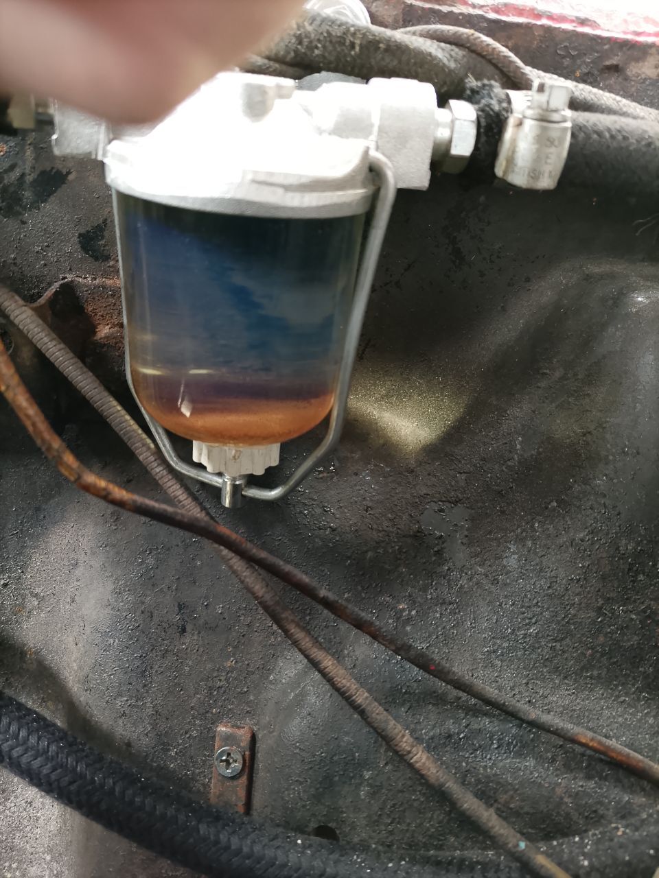

I then removed the crud from the glass bowl fuel filter...
...which is getting less every time, and makes me very happy.  I have no running issues at all now, I just turn the key and go, so whatever crud is still getting through obviously doesn't bother her.

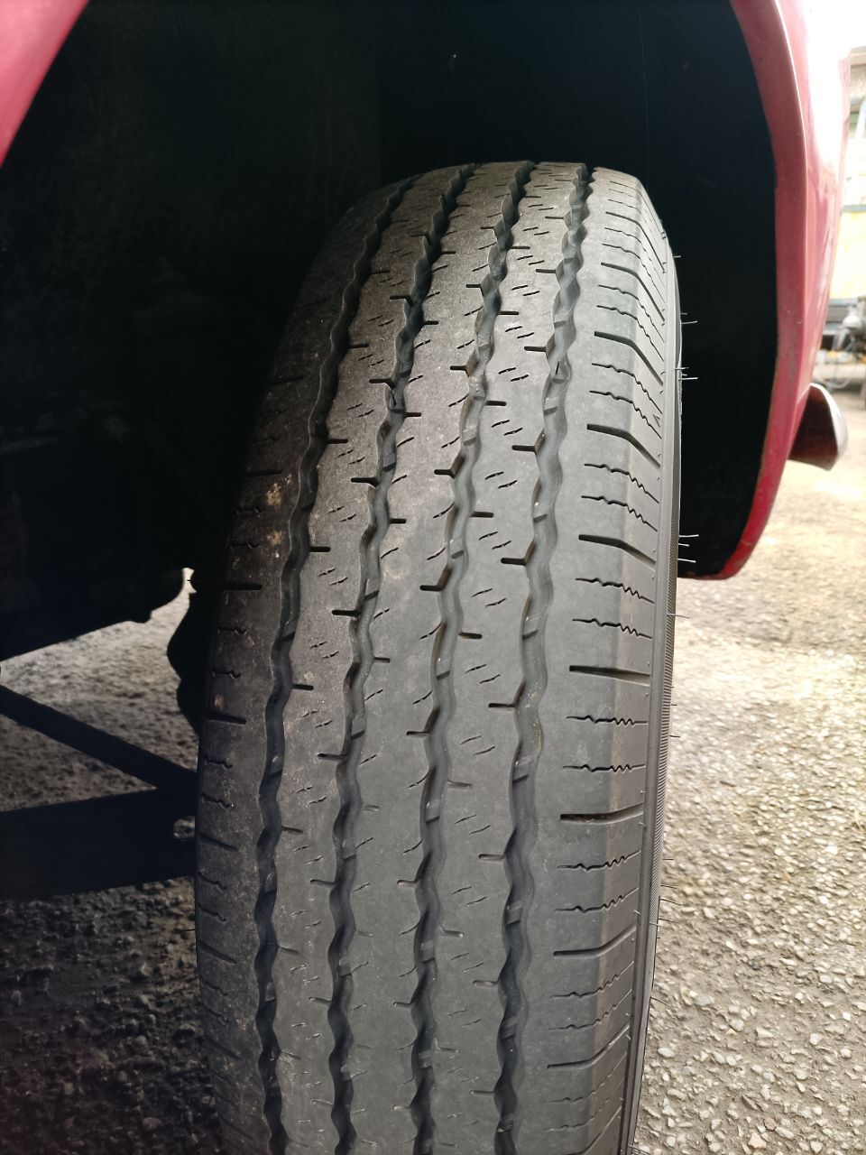

I'm watching my tyres in order to catch any alignment issues before they ruin them, but it's not been long enough yet really...  They seem fine, and are driving nicely in all weathers.

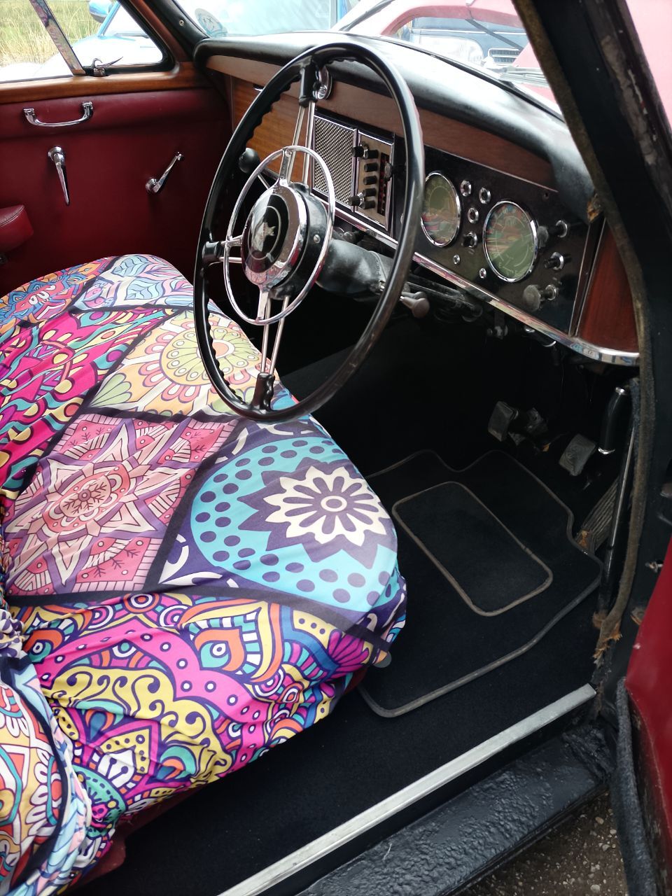

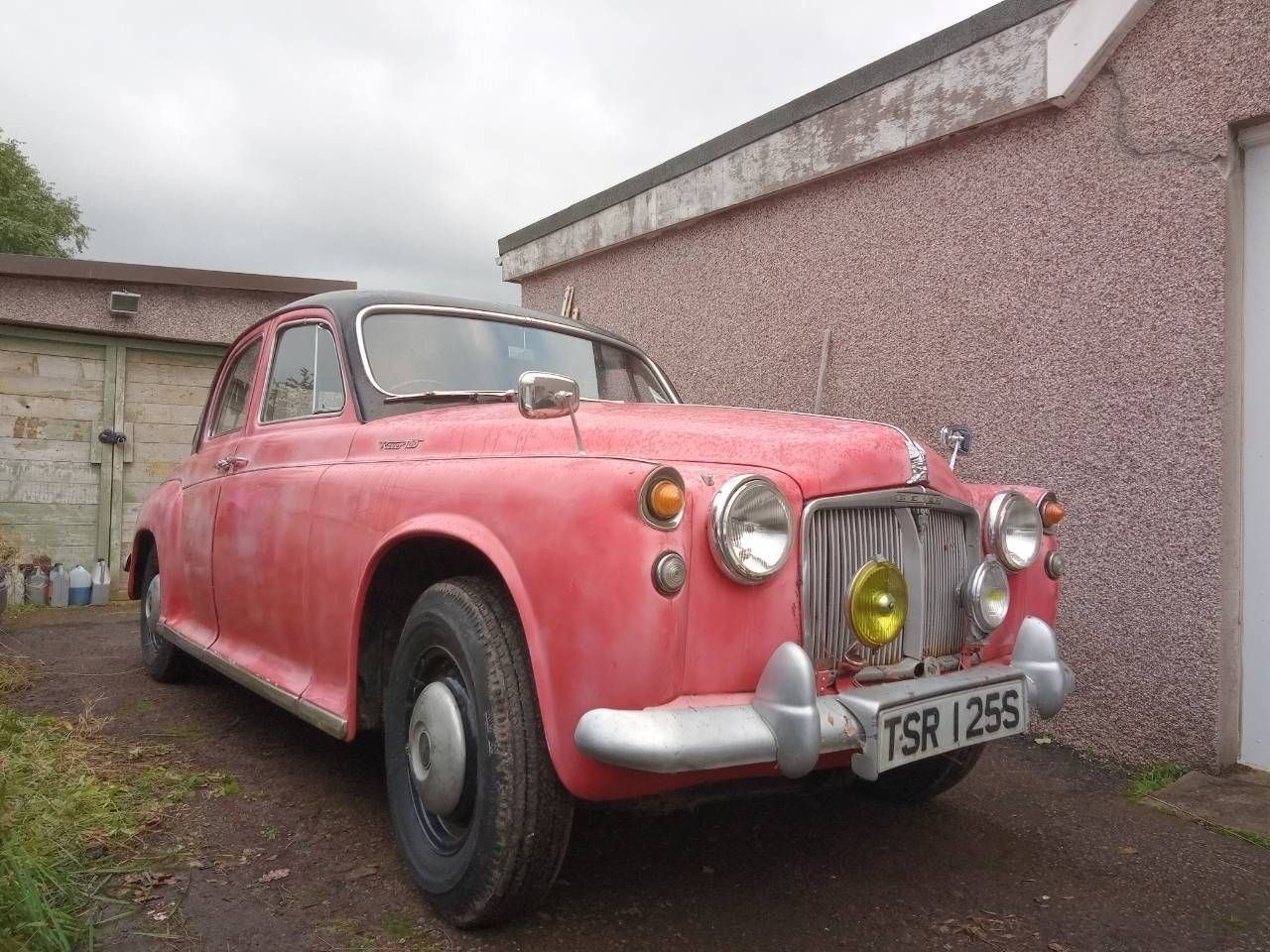

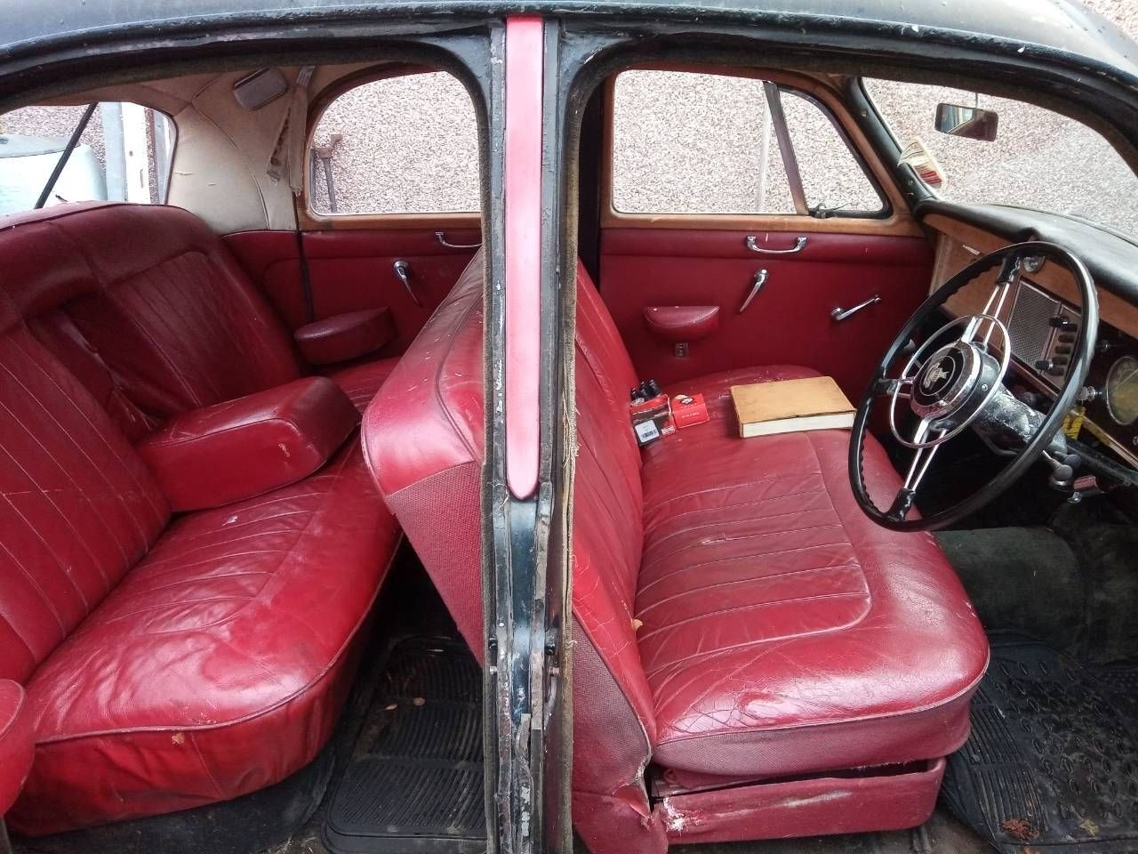

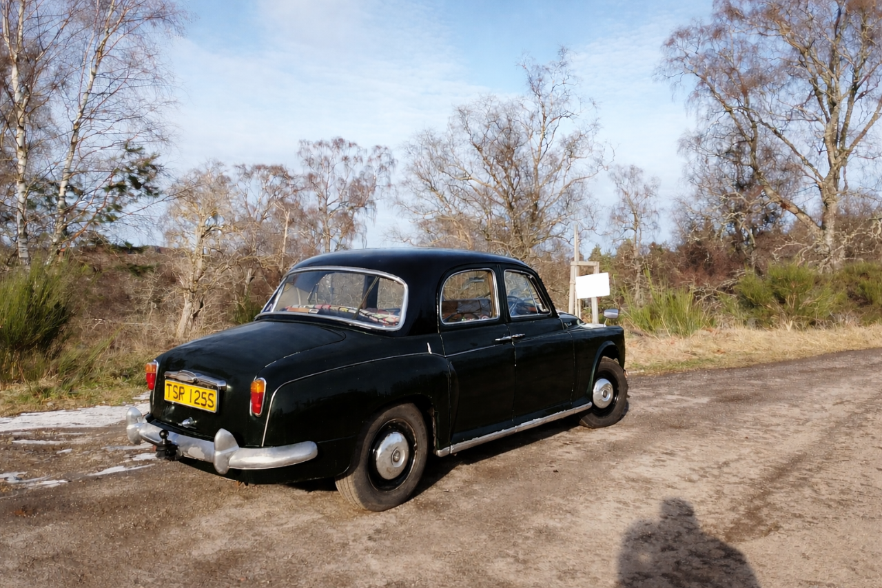

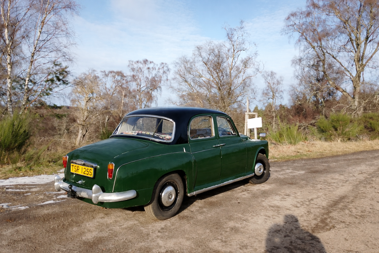

All good then really, my 67 year old daily!  Have some before and afters, cheers all.
As bought...
IMG_20241006_171946_612.jpg.8020631d724ad1abfee1c24593c02934.jpg.fe15740091397587fcf21fe38b62a6da.jpg
...and now.

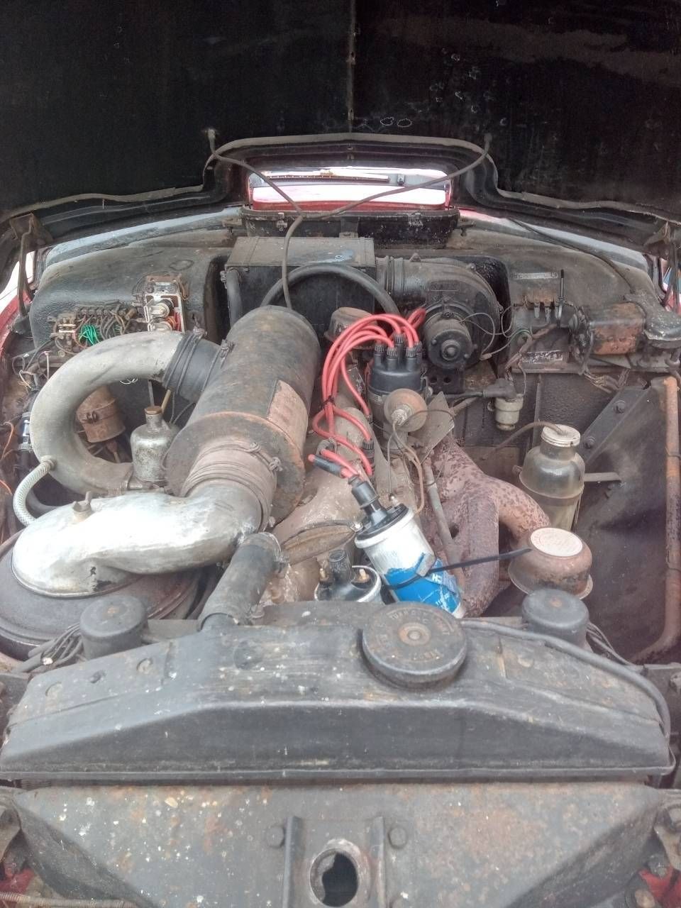

The 'powerbarn' before...
IMG_20241013_151129_775.jpg.b4ebeb0d3dc837d733a47c96f1ad4a46.jpg.6d92de5de9b25635d1dddf014ff932a2.jpg
...and now, not much to look at still but I'm strangely proud of it!
And the exterior...
IMG_20241006_172110_443.jpg.998b8ae301b34adba490e269510be00f.jpg.a240d142b0a5ff8a201d0e47cbaf77b9.jpg

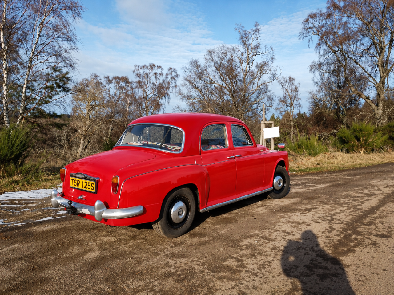

Playing with chat gpt...
I already have the red paint in, and have no plans to change the colour scheme... Interesting to see it differently though.  Aiming for this...
Could do the roof as well...
Or really do the roof...
Have always thought they suit black (as this one left the factory actually)...
And this is nice, especially with the black roof and wheels I think...
Had to stop there, ran out of free gpt credits I think!
I dunno, maybe a Bank Managers (Dove) Grey?

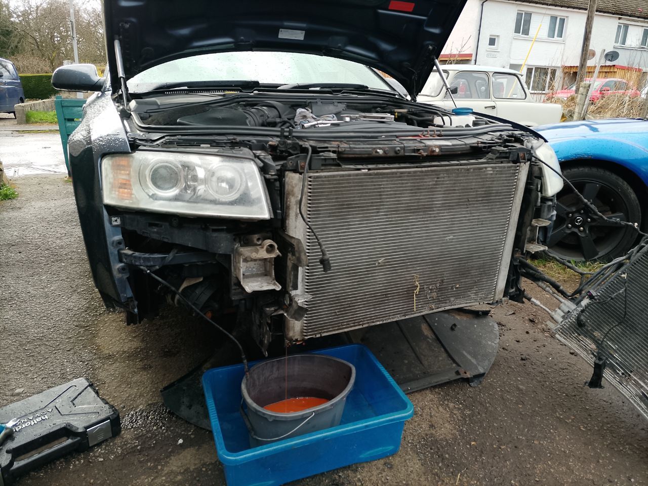

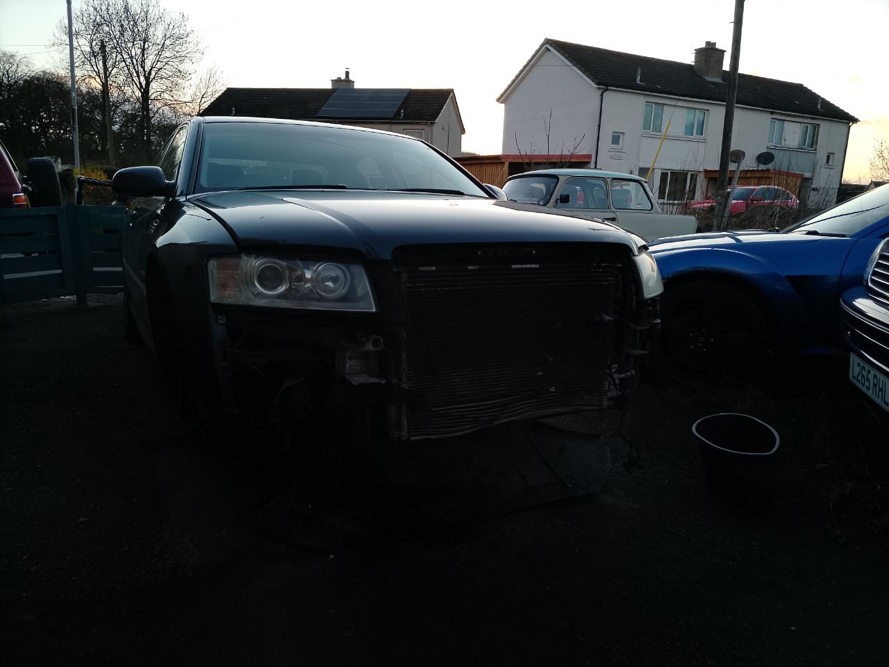

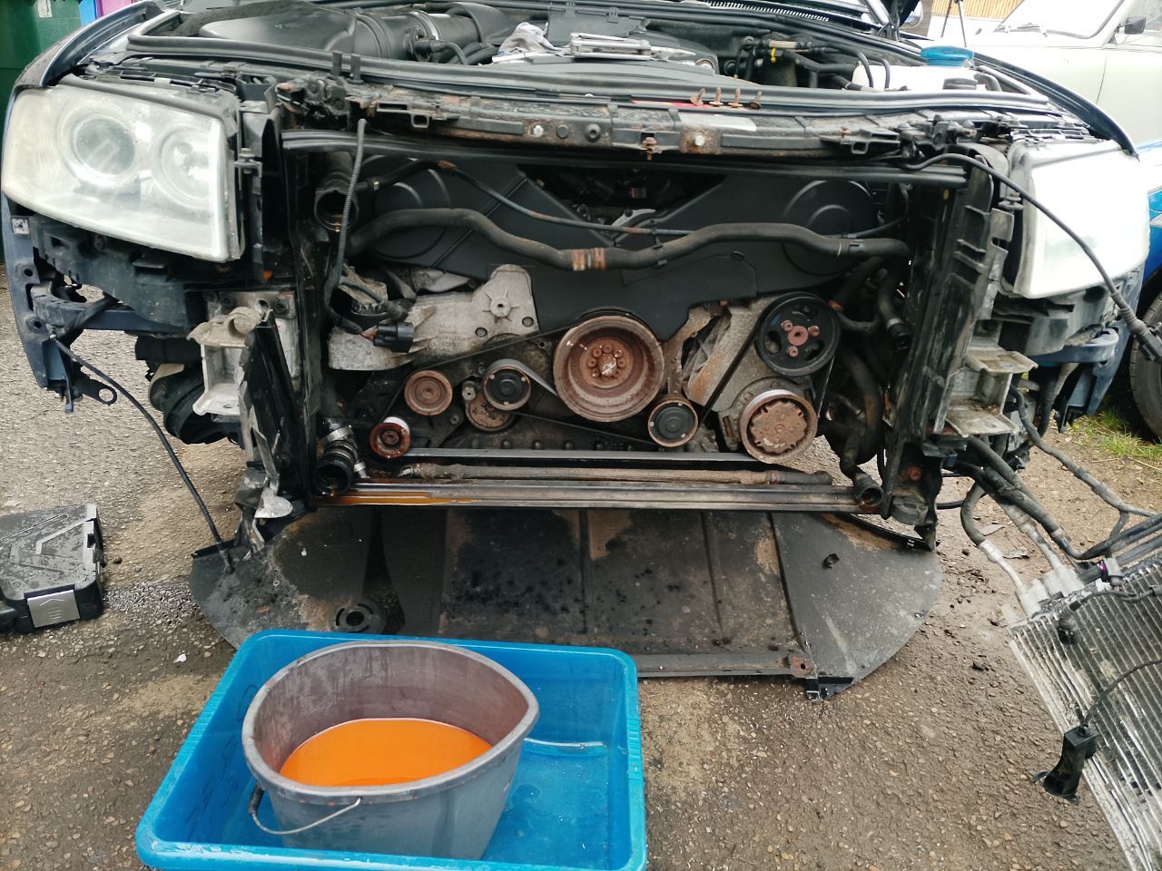

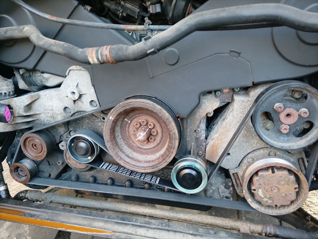

Finally got around to investigating a whining noise from the big Audi today... suspect was something connected to the auxiliary belt.  So as we all know, on an A8 that means BUMPER OFF!
Swiftly followed by the radiator...
This didn't take much time, I've not long been in here doing the cambelt and it's all still fresh in the mind.  Of course, I should have replaced all tensioner and idler pulleys at that point, but they were quiet then!
There isn't a kit I could find for this engine, so I had to order individual pulleys.  The left hand idler was one I couldn't get, so obviously that would be the one that felt a bit grumbly...  Could have been worse, I was sincerely hoping the alternator was ok, and it is.

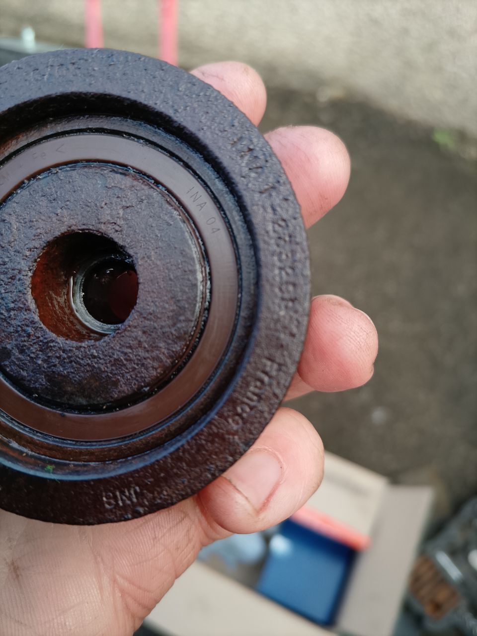

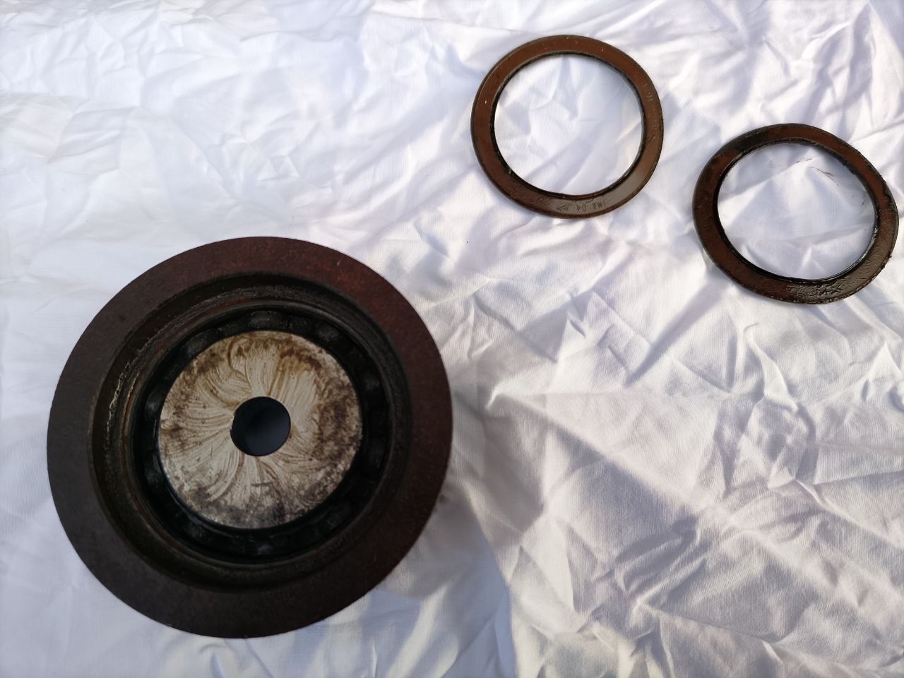

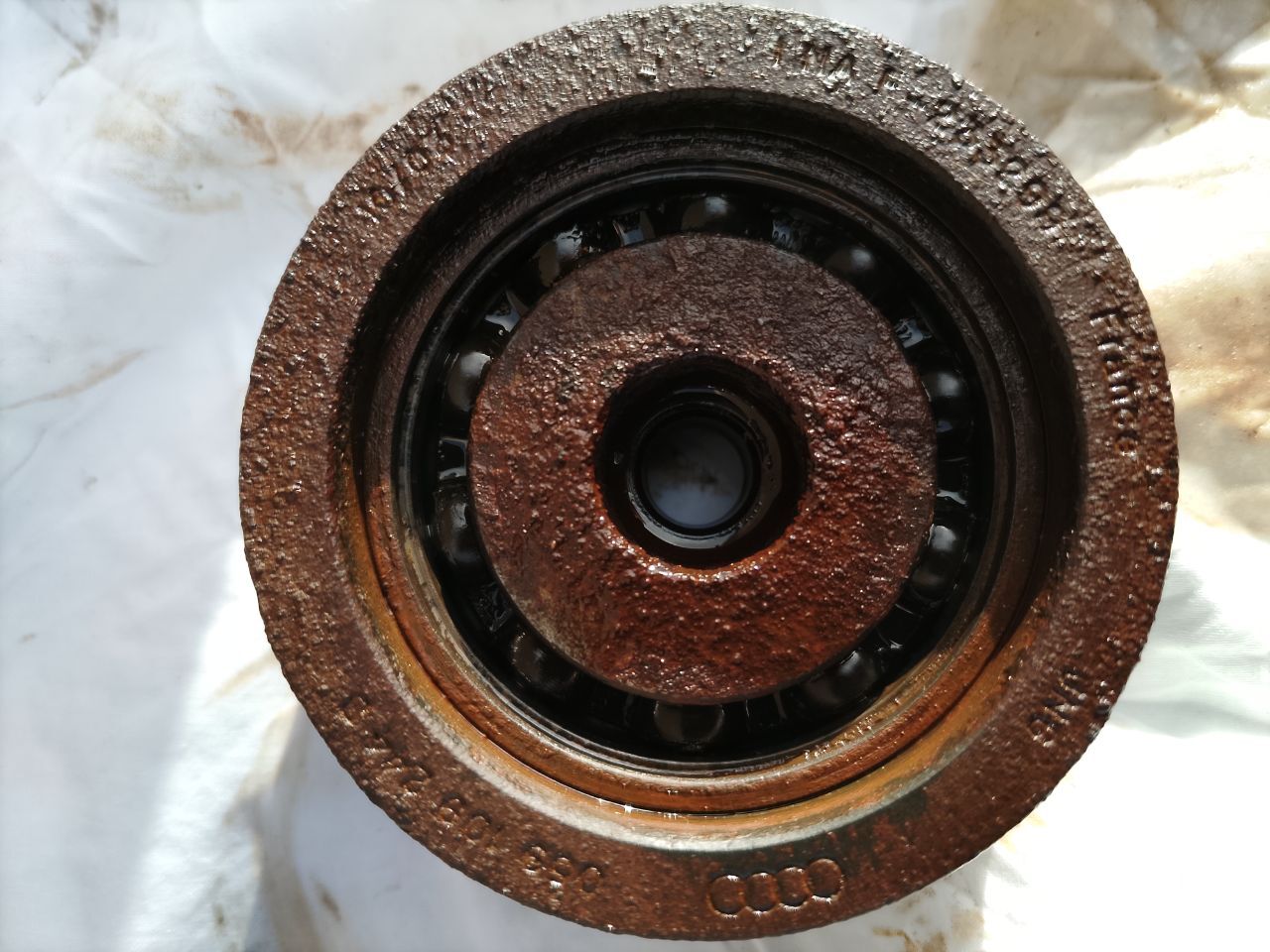

The grumbly idler is a fairly hefty piece of kit, so I teased out the seals hoping I could clean and repack it...
This turned out to be the case, no play I could feel, and it's now silent with new SKF grease squeezed in.
The seals clicked back in ok too, I've got the part number now and will order a spare, but it should be fine for a bit I think.
Anyway, I put it all back together with a new belt, the new pulleys I did have, and filled up the coolant (I'd caught it all in a clean bucket as I pulled the rad, it's new-ish, and looks spotless).
I turned the key at this point, as you can't get the last litre of coolant in until it burps itself with the heater on max.
It is a bit quieter and deeper sounding, but the whine is still present.  It must be the power steering pump, the fluid does smell a bit burned.  However, I can cope with that, an oil change (maybe including some of that 'pump rebuild in a bottle' stuff) will hopefully improve it.  The main thing I wanted to achieve today was identifying the noise, and preventing a breakdown if it was the alternator or a pulley in danger of seizing up.

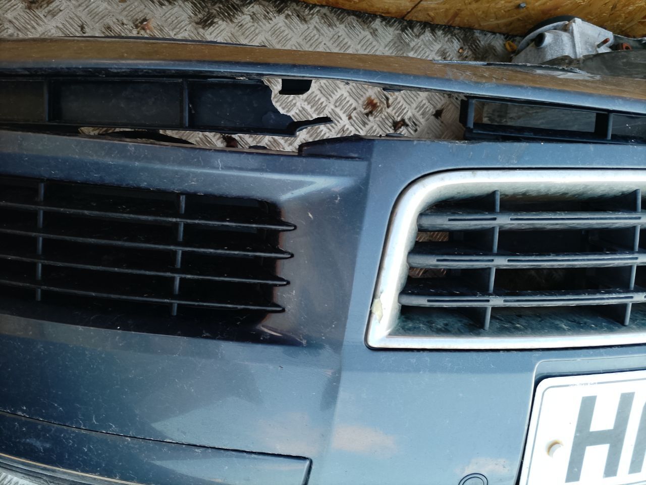

Tomorrow will see the bumper stitched up a bit...
... and refitted.  I've got front brake pads to fit whilst she's up... I don't know if it's the salt up here or if they're just another poorly made component these days, but I do seem to spend a lot of time changing them.

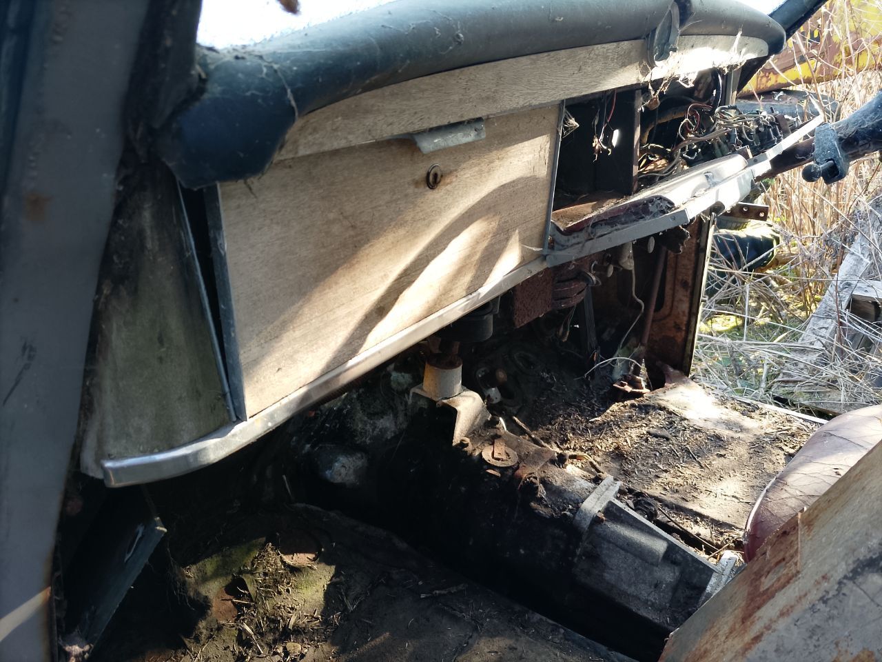

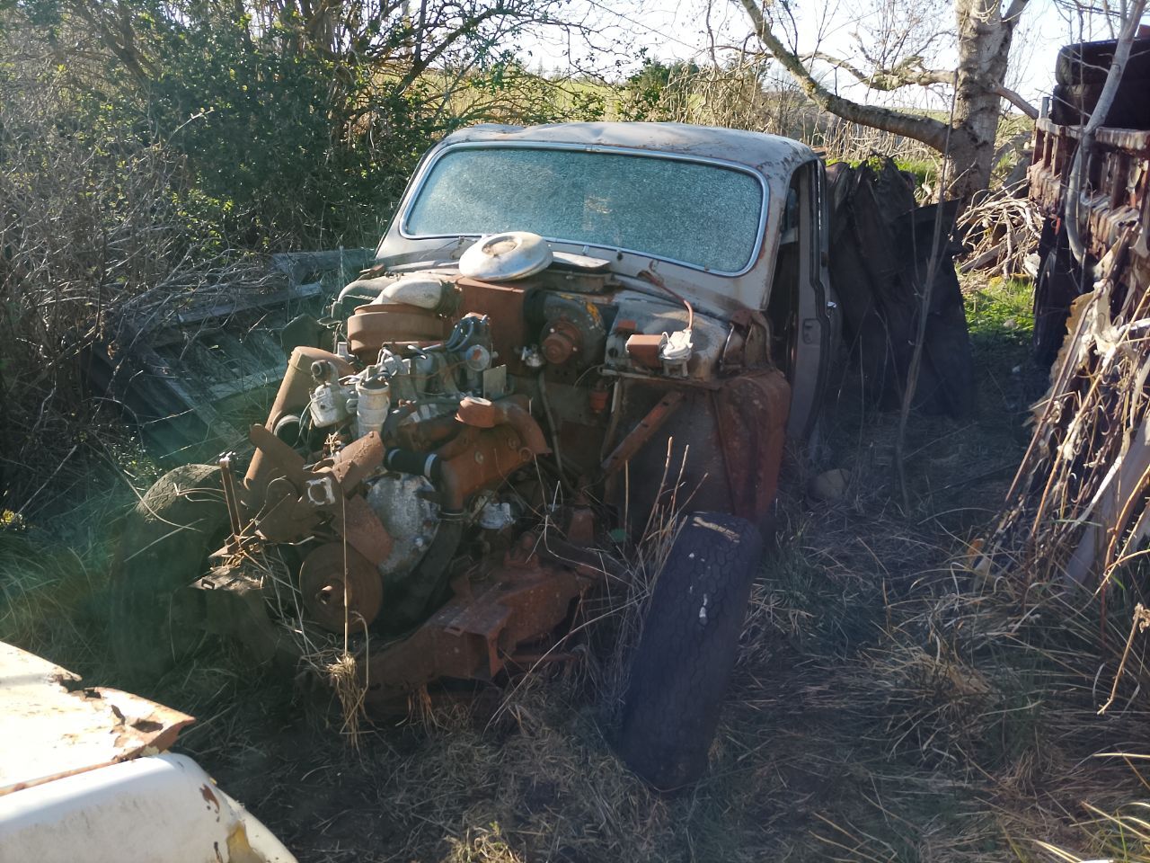

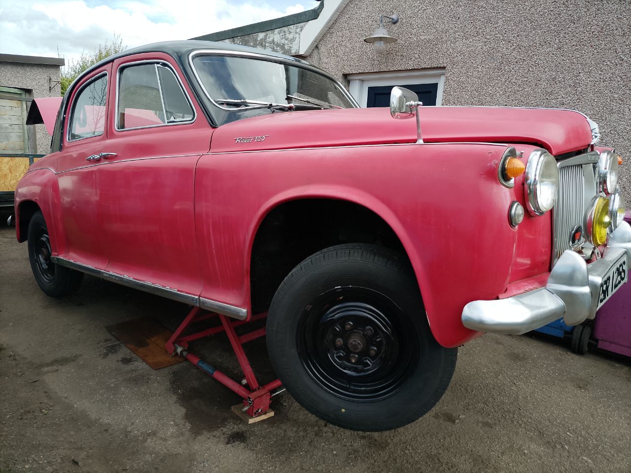

Just had wee spannering session on the way home from work.  The 'parts car' that came with Old Red, is finally destined for the scrap man...
She's in a sorry state, but still able to offer some useful spares.  Chief among which will be the engine, and the (overdrive-equipped)  'box.
So far, the good/useable parts include a fuel tank, carb, air intake and the exhaust manifold looks better than mine!  The engine doesn't turn, but I couldn't stand it going to the yard without giving it a shot at life.  It's sealed at least, with only clean oil visible on the dipstick.
Gearbox looks the same, intact and with good oil at the right level.
I've undone the engine mounts and bellhousing bolts, so with a gentle tug I'm sure the big six will lift serenely up from it's home!  That's for another day though, my friend (whose property this is on) has an old  forklift in need of attention first!
Loads of little spares still there too, trim joiners, dash bits etc, just need to find somewhere to put it all...
