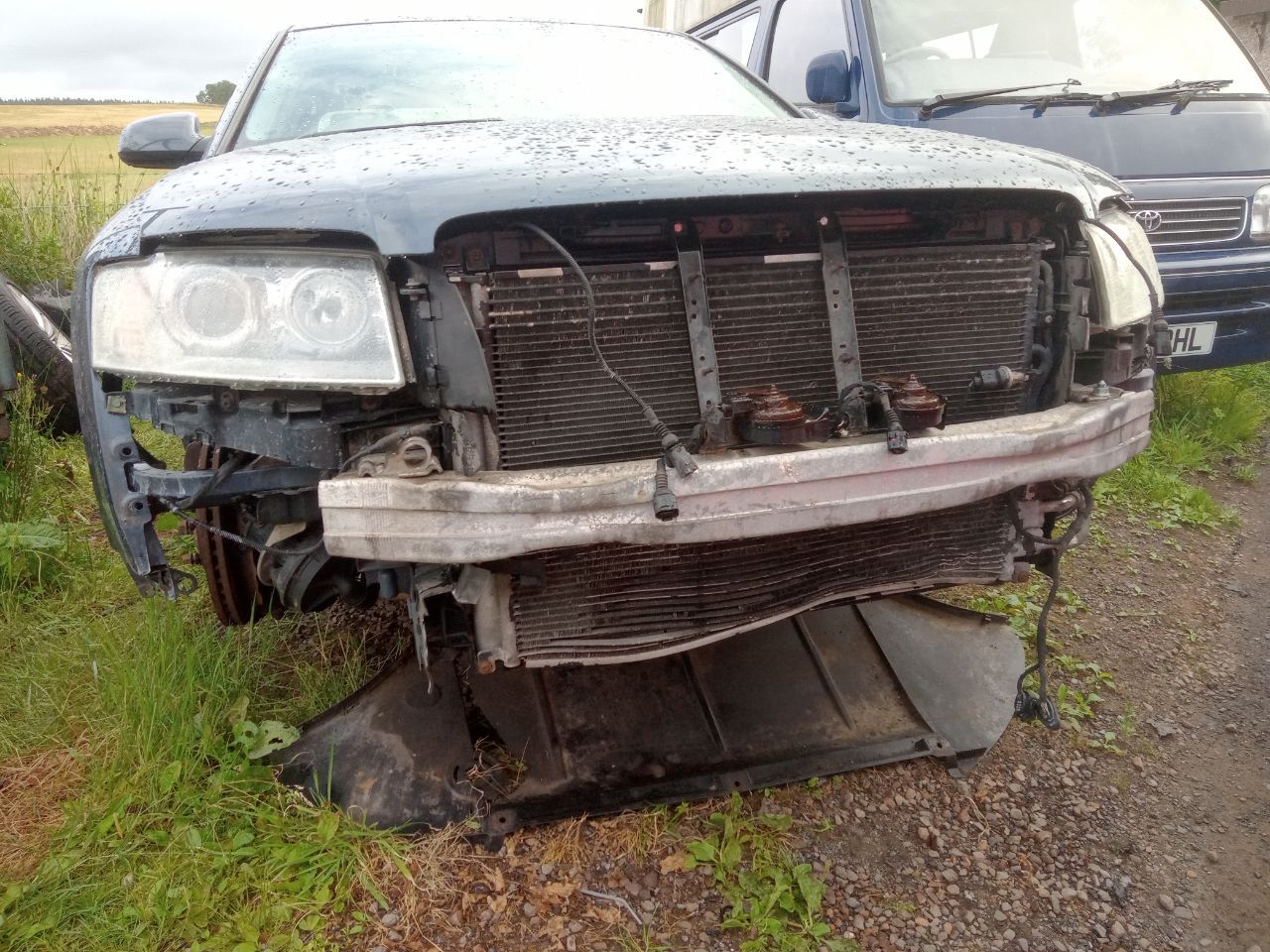

The main radiator is ok, just a minor bend at the bottom, but the aircon rad is toast.... the car has needed a re-gas for a while tbh, and definitely has lost its ice-cube juice now!  It'll go back in for now, there's far too many sensors on it and the aux belt goes round the pump anyway, so in an unusual move for me... no aircon delete!

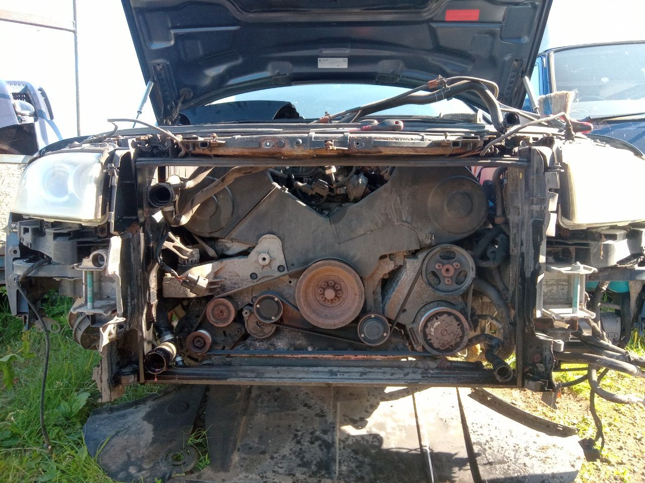

Big Liability Audi Cambelt Update...
Hi all, it's on basically... I'm back to this:
I did refit the busted-up air-con rad as you can see, the top half of it cools the power steering oil...
Just the bumper, arch liners and wheels to go.
I did drill out and re-tap the threads of the troublesome water pump bolts, and the Continental water pump fitted up fine after that.  I thought about smearing some sealant on the gasket, but there was none on the old one so didn't bother.
Next was the actual belt.  Bit awkward, but I got it on and all marks lined up.  The crank pulley was the issue for me... there's a ring of small Torx screws (VAG just loves the things, eh?!) holding the harmonic balancer pulley onto the crank sprocket, however, they were rusted and not for turning.  This meant I'd had to undo the big main bolt holding the sprocket onto the crank.
T'was therefore a bit more difficult see the sprocket behind the big pulley, but I could just get my paint pen in there to mark the belt/teeth before sliding it all the way out.  Putting it back in was more of this peek-a-boo game, but not too bad.
My method with cambelts is to mark the pulleys against the block, the belt against the pulleys, and then transfer the marks from the old onto the new belt.  I find that you can't really go wrong after that, and I didn't lock the engine in any way (there's a special tool available at £101!), and all was well.
My garage didn't want the job, and my neighbour came over and said that he'd had trouble getting one to do his (Ford Focus) belt too.  Thought it was a bread-and-butter job for the professionals but obviously not these days.
I turned the engine by hand a couple of turns, but I really shouldn't have.  There was a couple of horrible clicks from the valve train area as I did so...  A Google search returned some Audi V8 specific knowledge.  The second cam in each head is turned via chain from the first belt-driven one.  Apparently, without oil pressure in the tensioners, the chain can skip, which is probably what I heard... Oh good!
However, it made the same noises when I turned it backwards to the start point, and I then decided to turn the key.  Perfect smooth running ensued (thanks to the mechanical gods!), so lucky there.  I'm not 100 percent sure about the chains skipping anyway... how would they cope with every start up?
A wee while was spent trying to burp the coolant, particularly the cabin heater system.  In the end, a rev up with the cap off did the trick, and there's no leaks this morning!
In summary, I'm glad I did it (I basically had no choice anyway!), but wouldn't look forward to doing it again.  This car lulls you into a false sense of security, with the aluminium body making it seem newer than it is.  Once you're into the guts of it, all the fasteners are rusted up like any other 22-year old motor!

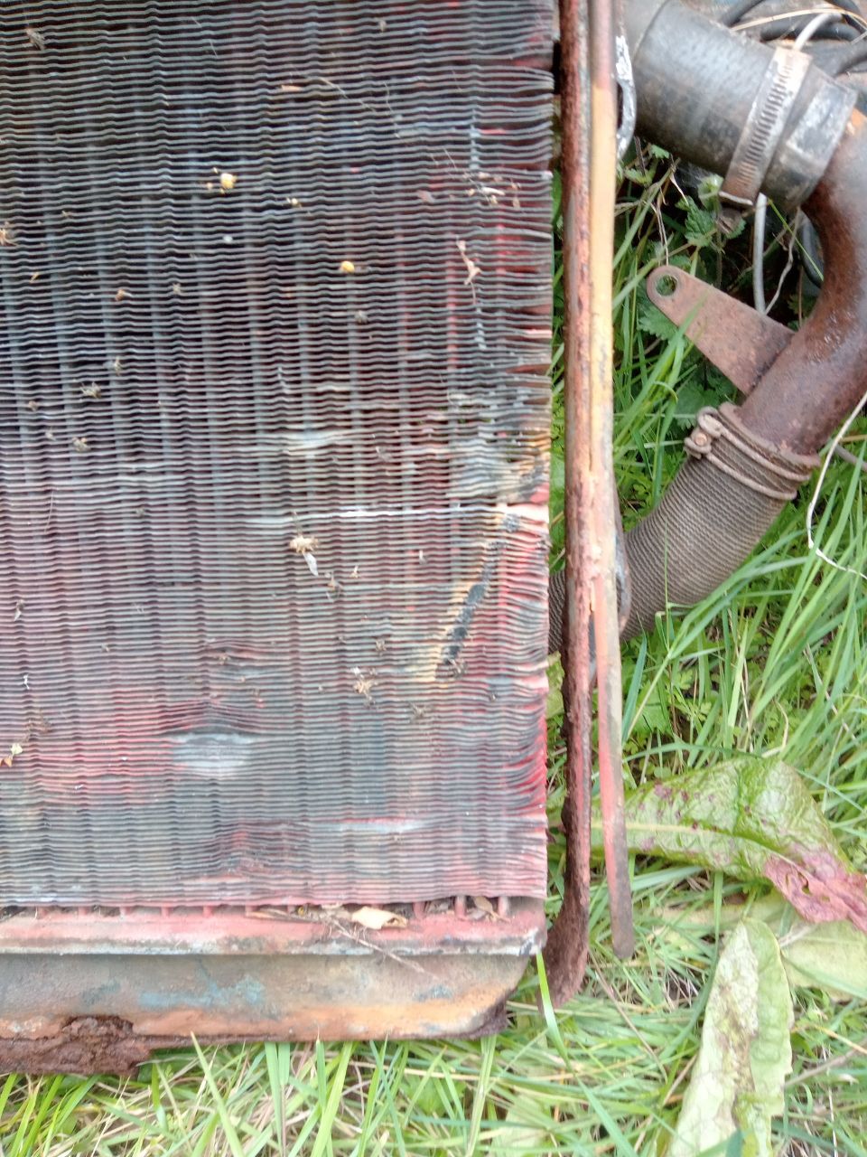

Anyway, some bits of old Rover came in with me, behold my renovations!*
The radiator just got a good clean out (pretty minging as you'd expect, but seemingly in fine fettle), will need a tack or two to the steel surround, and then a lick of paint.  Not the top tank though, that will be polished brass if it's the last thing I do!

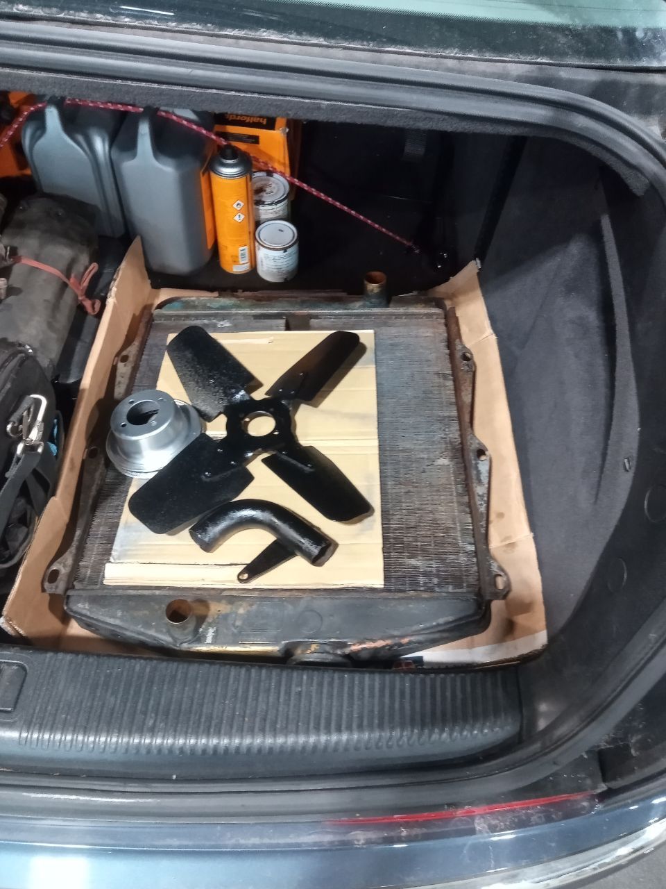

Not the first time the Audi's commodious boot space has come in handy...
...I even hoovered it!

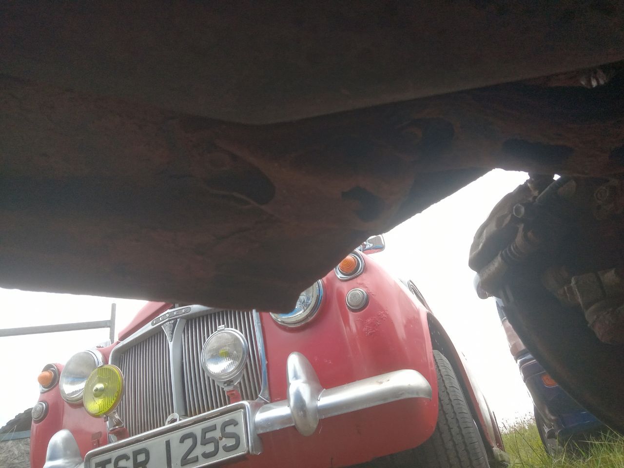

Alas, I poked.
Yeah, a sizeable scabby bit.  Not as crucial as on some cars I suppose, Mazda's finest has more or less a separate chassis, which can be seen just inboard of the holey sill.  It's solid, which gives me some hope that there's a few years of tearing up the Highlands in this thing yet.
I have fabricated...
...and after a wee bit more tidying up, will weld tomorrow.
Otherwise, we're good I think.  I have removed the usual kilo of old waxoyl and rust, so she's ready for a dash of Fertan and fresh oil under there...
