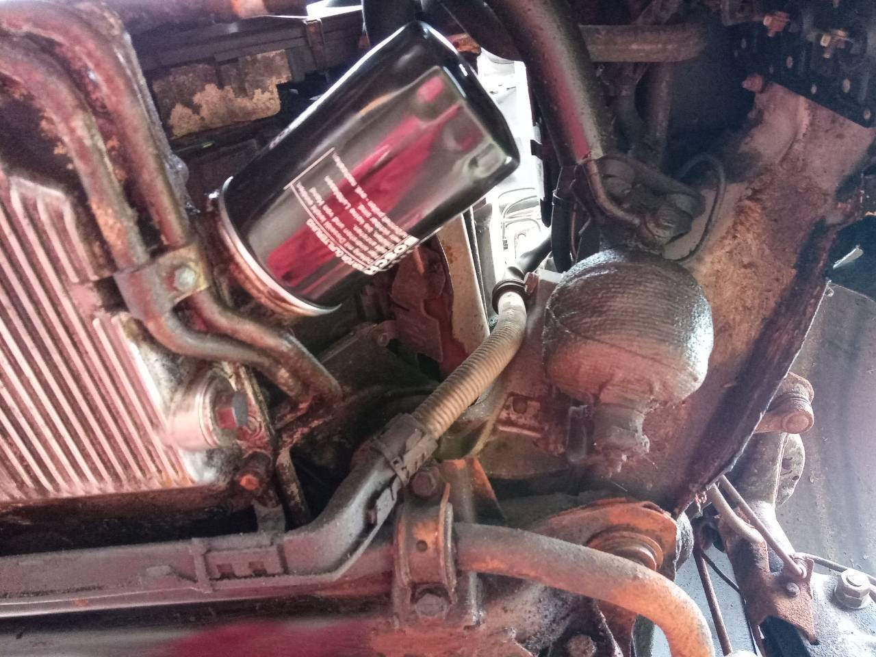

The little round thing to the right of the filter above, is the brake bomb...  The ABC engine uses this wee accumulator instead of a servo for the brake assist.  It is pumped to pressure by an extra pump set on the nose of the power steering pump assembly, using LHM fluid.  I am also keen to keep this nice, so the above denso tape wrapping has always been there during my tenure.
To test it, you're to switch the engine off, and see how many pedal presses you get before it goes hard... 50 is the lower limit, I'm still getting 100 power-assisted presses on this 32 year-old, 220,000 mile car.  They really are built differently these things.
Anyway, that's all I can see/think of to prepare, I'll get it a wash and booked in this week sometime.  That'll leave me free next weekend to do the same on the RX8... I've ended up with two cars due their tests far too close together for my liking, but there you go.

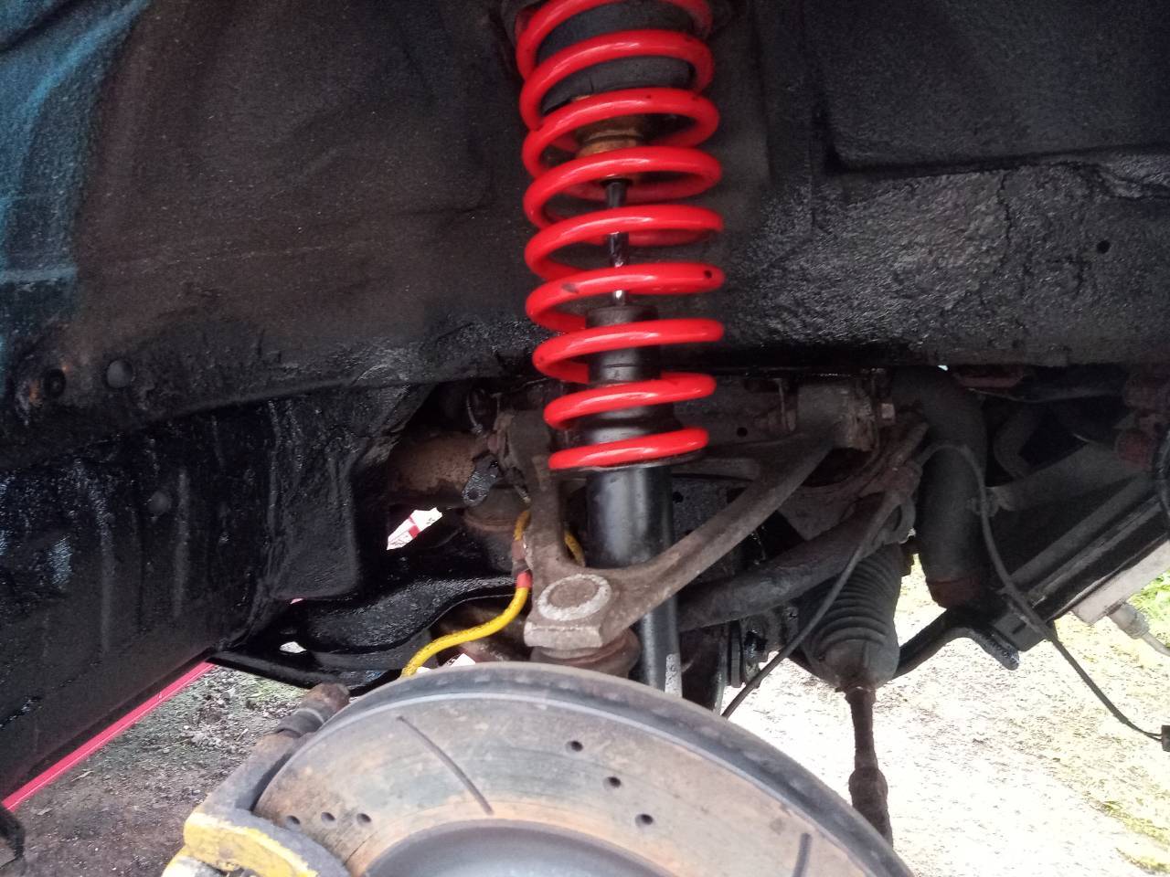

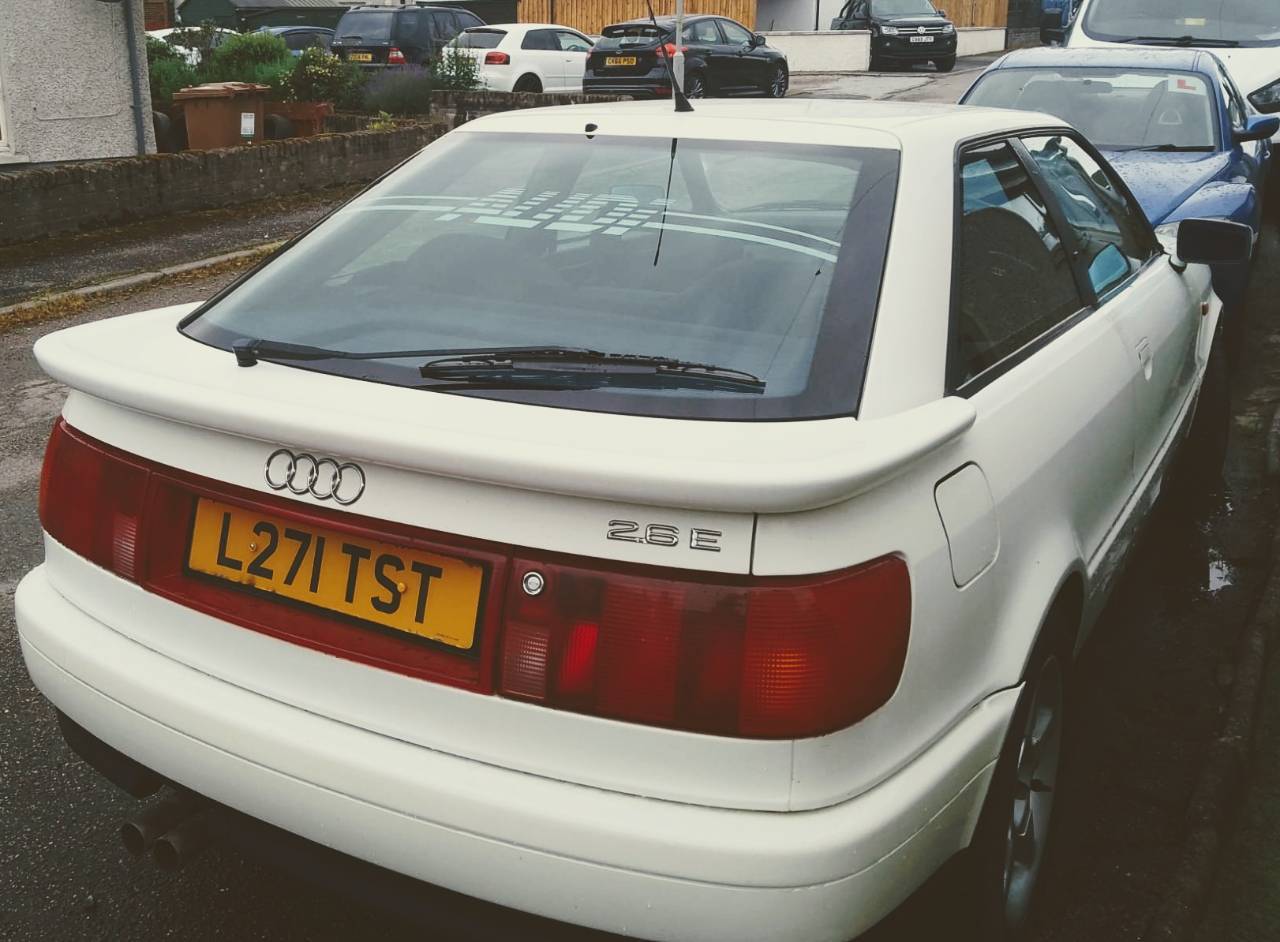

Old pic, she's a bit lower now with the new springs on...

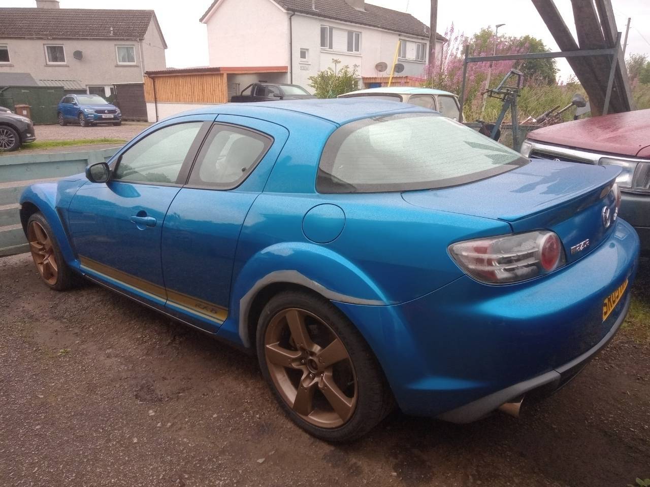

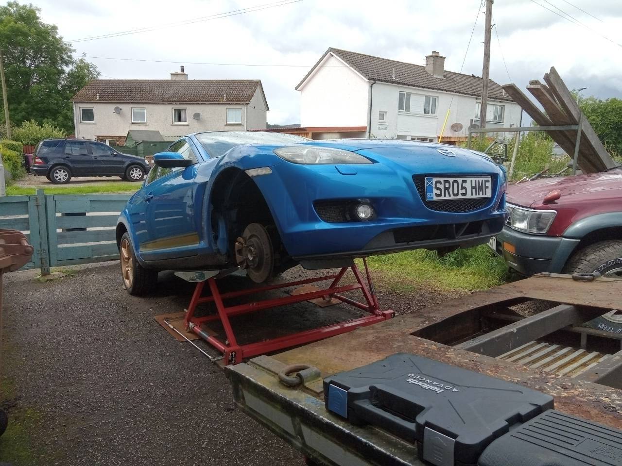

Today will see the RX8 elevated (if this glorious summer rain ever lets up), it must face the welder again prior to it's turn with the ministry man.  Will post up pics of what I'm up to later on.  I'm hopeful* that it's emissions are just peachy fresh, as old rotary engines always are!

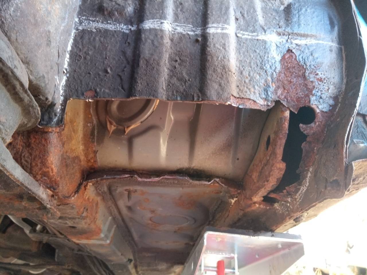

Well, here I go again.  Currently ruminating on my plans with welding up the RX8 in readiness for it's test later this month.
Firstly, up she goes...

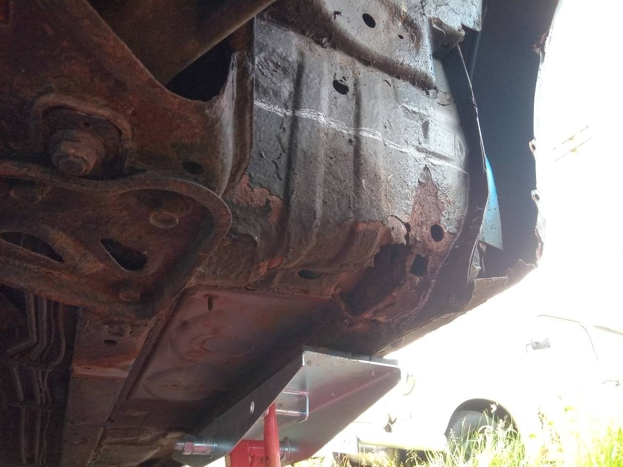

Then with the wheels and liners off, the prodding...
Not good!  However, as you can see the metal that's gone is kind of a second skin over the floorpan/bulkhead proper (which thankfully is in good shape still).  It should form a sort of gutter section at the bottom, adding stiffness between the inner sill and chassis rail I guess.  Got me thinking about the Trabant sill sections I've had stored for years...
I think I'm going to use a length of this to form the bottom of the repair, welding a flange to the floorpan at the rear, and extending the front up into the wheel well.
It seems to go solid again at around my chalk line, so I'm going to cut everything out up until around there I think.
My guess is that these bits of the car have been used as jacking points at some point, which has deformed them, cracked the underseal and condemned them to death.  I'm actually contemplating strengthening the new sections up a bit, so that they could be safely used as such.

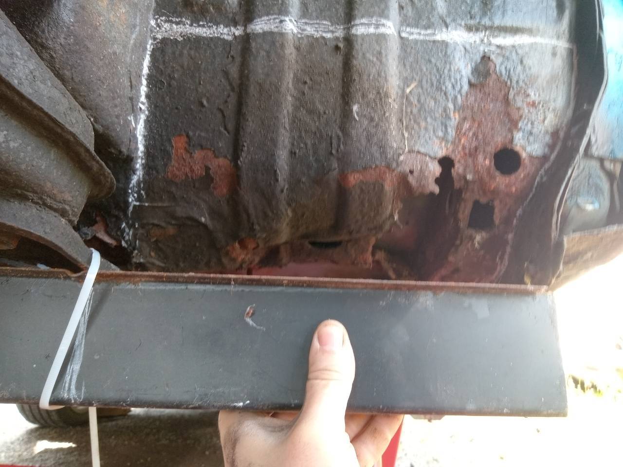

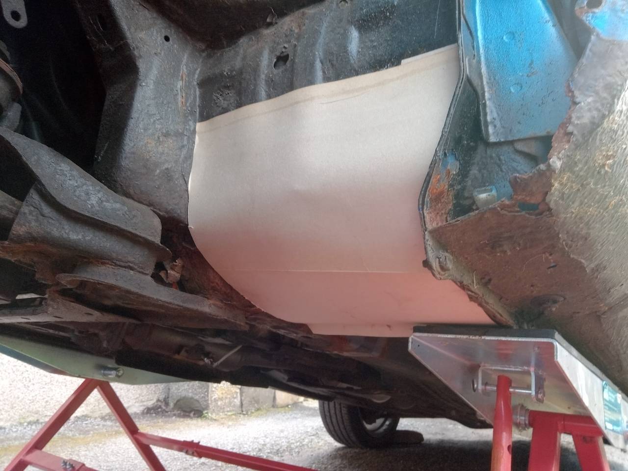

Changed my mind about using the trabi sill sections, quite fancy a more factory* look following some cardboarding.
There's more to come off yet, but below is basically what I'm working with...
I want to weld to the inner sill end on the right, so think I'll use two curved sections.
First one here...
And then a bigger one to meet the chassis rail...
Don't really want to overlap two sheets so will probably have this one butt up to the first, welded along that inner sill edge.  After that I'll just need a flat vertical piece to join the bottom of the curve to the floorpan at the rear.  I'll put lightening holes to allow wax/oil injection, and obviously everything will be vactanned prior to closing it in.
Don't think I've quite enough sheet left here so will acquire some and hopefully get the two sides done this coming week.  It'll be wee sessions after work, so weather dependent too.
Think I'd best at least lift the carpet slightly, could be dodgy when welding that back section in!  Here's the rot removed so far...
There was a small patch on it already, so I'm not the first to attack this bit either.

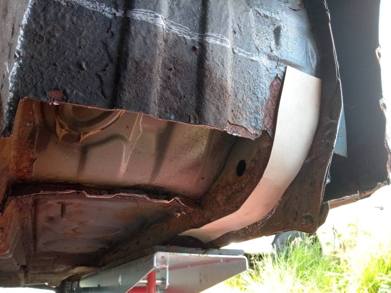

Turned the card templates into steel and got everything tacked in.  First, a dry run...
I had the idea of tying the inner chassis rail to the inner sill with a bit of box, for one because it'll stiffen everything up panel wise, but also because I'll have a better jacking point.  I hate jacking them up on the sill join, much better to have a big pad I find.
Anyway, tacking occurred...
And this is where I stopped...
I'm not too convinced of the weld on the chassis rail, going to buzz it down and go over it again.  I want to up the power, make sure it's really  burned into the thicker steel there.
It's actually quite awkward height-wise under there, too low to sit and weld and too high to lie down.  The biggest issue I have these days though is vision... with the sun above I find I can see very little through the mask until I press the trigger, not good for the thin stuff.
At the rear, I'd put an upward fold on my curved panel, so it comes up to meet the floorpan...  here's the best pics I could get...
Once all this is welded up fully, it'll be more than strong enough I'm sure, it's already stiff af, as the big curved piece is 2mm (all I had)!
Other side will be the same, at least I won't need the thinking time, so should be more able to progress in the depressingly short dry spells we seem to be getting this summer*.

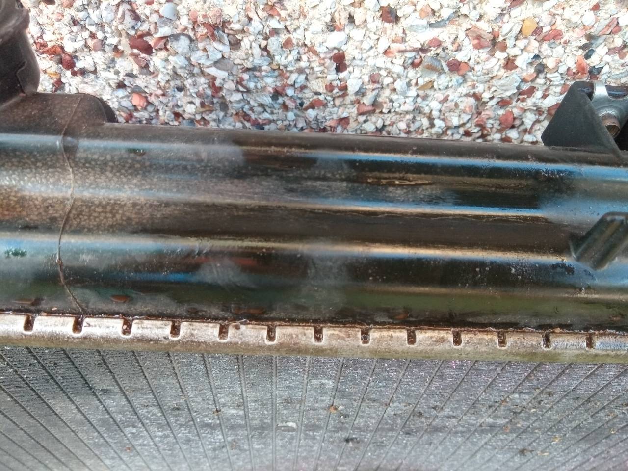

Hard to see in the picture (and in real life actually), but the plastic radiator top tank had split allowing a weep of coolant when hot.
So after 32 years service, the old unit is in the tip, replaced with a Mahle one from good old Autodoc.  It was £130 delivered (the most expensive of the stocked options), and the whole job was done in an hour.  The coolant was absolutely spotless and still bright pink which is always good to see, so went back in.

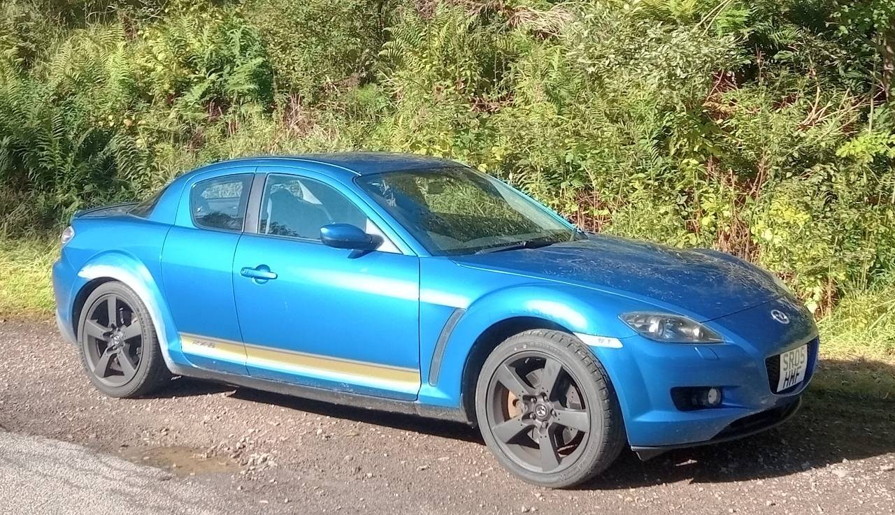

Getting used to the black wheels...
No lights on the dash, and lambda readings ok on VCDS... 4pm tomorrow is MOT time, just itching to hit the road again!

Well, phase one of the swap is complete...  Namely, we have both had a good look at our respective swapees, and are happy to proceed.
The Iveco needed to be awoken from deep sleep... It's been a looooong time since she turned a wheel.
However, after a fluids check, and a fresh battery, she started fine.  No smoke, no fuss.  Great engine this 2.3, whatever the haters say!  We'd chucked in 10 litres of fresh derv before we turned the key, just in case.
The brakes were less happy about the long lay-up, and took a good lot of too-ing and fro-ing to relinquish their grip.  Took her a run up the lane, and they are understandably shite, but everything else was grand... Result!
To my shame, the old thing had become an extension of my shed, so a lot of clearing out happened too...
Where will I put it all now?!  In the bin, mostly...
Anyway, t'was fun having a truck for a while, it brought home the Mazda 323 and the Audi Coupe, and gave the lads and me a lot of happy memories.  Just transport arrangements to sort now, there's only a couple of miles between us so we should manage it this weekend.
