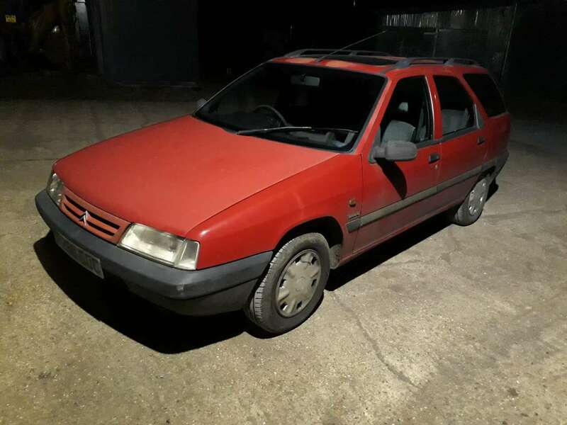

With the mx5 delivered to its new home i was in need of a ride back, mr6 was going to give me a lift back but as the trusty Zx had shown its issue was still around i offered to have a nosey at it and use it for a few days to see if theres any pattern to its spluttery starting.
what a lovely thing to drive it is.  Just does being a car nicely.  A charming bit of lag then off we go, I do love old diesels.  Handles nicely and just feels like a good place to be.  Except for the ice cold water that pissed through the interior light panel when i was turning left today!  Gets a thumbs up from me.
