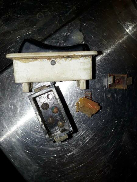

Wiper motor was removed, freed up and the earth cleaned up.
The switch had no continuity, so i took it appart and cleaned up the contacts.  It was pretty crusty.

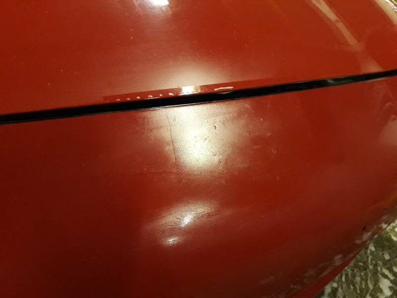

I found a rattle can of red paint in the workshop.  I think it was left over from the wheel arch bodge on an old workvan.  A search on the holts site suggested it was the colour of the wee mazda!  I had clean filler and abrasives.
Better see if its the right colour.
Fix the rusty arches? Nah. That scuff is pretty deep and big, and the debaged area was a bit rough.
The photos make it look great but its far from it. A 10fter. A quick and dirty repair. Good enough.
