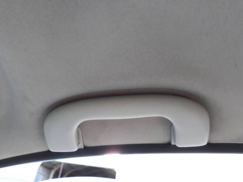

So my local scrappy just rounds to the nearest note usually, tenner , twenty etc etc. I usually try to get a few bits to get my money's worth. Like most cars the Astra didn't have a grab handle above the drive so I took one off whilst I was at the yard. They have no screws at all and just clip in.
So now I have a handle I'll probably never use, unless I start exiting the car like BO and Luke?  Deputy Enos stands no chance against my MPG's.

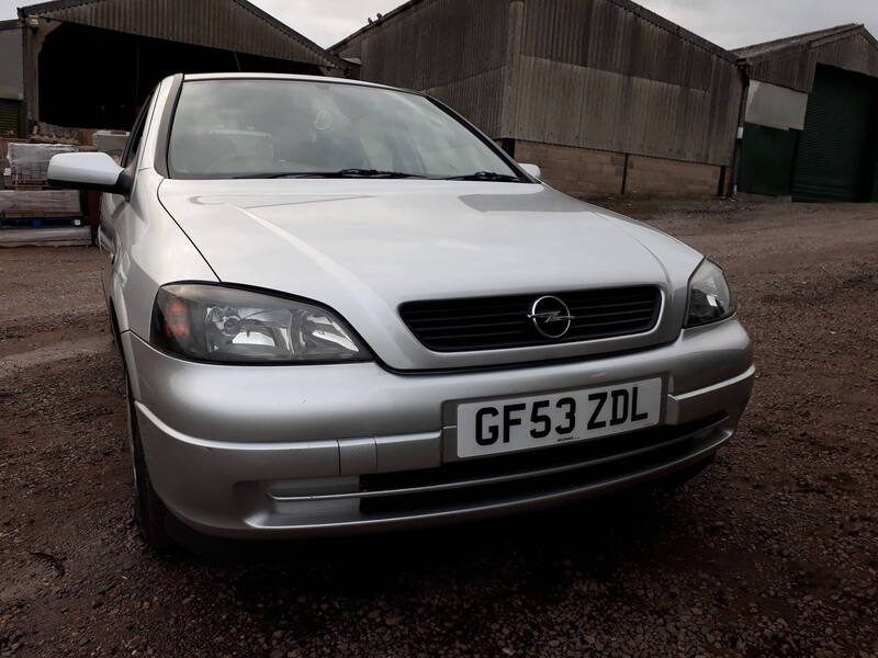

Condensation and my inability to leave things alone had me looking for later/sportier model astra 'smoked' headlights. I like darker headlights (demonstrated below with my disco fitted with disco2 headlights).
I had kept an eye out for a pair cheap and found some on eBay for £18 delivered. They was not really a bargain tho as one appears to be missing an adjuster and they had been spray tinted black! I thought they looked a bit dark in the listing.  With the front end pulled off the lights were fitted then some wet sanding and rotary polishing was required to get them back to standard.
I'm a bit undecided if I like them or not, i prefer them over the silver lights, but with the car being such a slab of light silver they look a bit out of place, and almost look a bit aftermarket if that makes sense. Dunno.

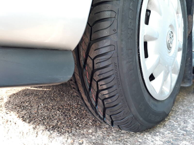

The tyres on the ecto4 consist of two winters up front about 2/3rds worn , one of which made an annoying squelch noise when driving and the rears are mismatch "new" tyres from a part worn place up in Leeds.
The winters are date coded 2007 and one of the "new" rears are 1999.  The other I can't find a date on.
So my friend John picked me up and fitted a pair of the shitters favourite, uniroyal. Not sports but experts, it seems 175/80/14 is not a sporty size. Who would have thought?
Cost price on the tyres and I supplied him with a new tub of tyre soap for fitting them. Win.
The tyres were fitted to the wheels i had previously picked up from the scrap yard as the wheels on the car are really heavily corroded resulting in the ability to knock large chunks out of the back of the rim it didn't make sense to use them for new tyres.
Shark skin technology bitches.
