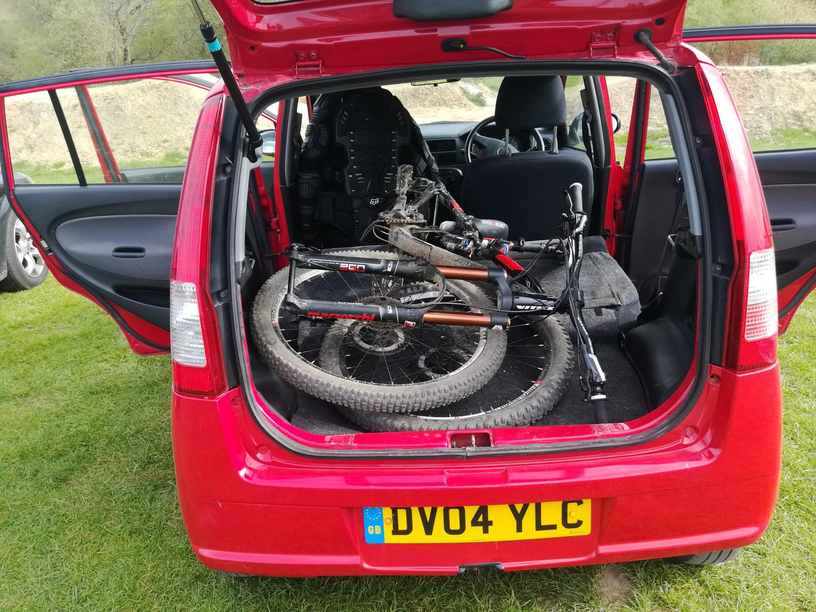

Yesterday I loaded my mountain bike and all my gear (track pump, full face helmet, body armour and knee pads as I'm dangerously incompetent) into the ST170 as I fancied giving it a run out to try and grind the rest of the rust off the brake discs, and to generally have some fun driving it before I flog it. Then it failed to start. I really didn't want to spunk over two gallons of fuel for two hours of incompetent jumping by taking the Mondeo, so I shoved the seats down in the Charade, removed both wheels, and tried my luck. Turns out you've got to either put the passenger seat backrest forward (or push the whole seat forward, it goes a ludicrously long way) but a 6" travel 27.5" wheel enduro bike does go in!
Unfortunately going through Tunbridge Wells I got a bit frustrated after having been stuck behind yet another incompetent weekend driver and gave it a good thrash through first and second when the road finally cleared, which pinged the EML on. That was accompanied by a burning smell, but I think that might have been from the lorry that was really labouring up the hill in front of me. It seemed fine on the way home. Just read the code, it was the lambda sensor as expected.

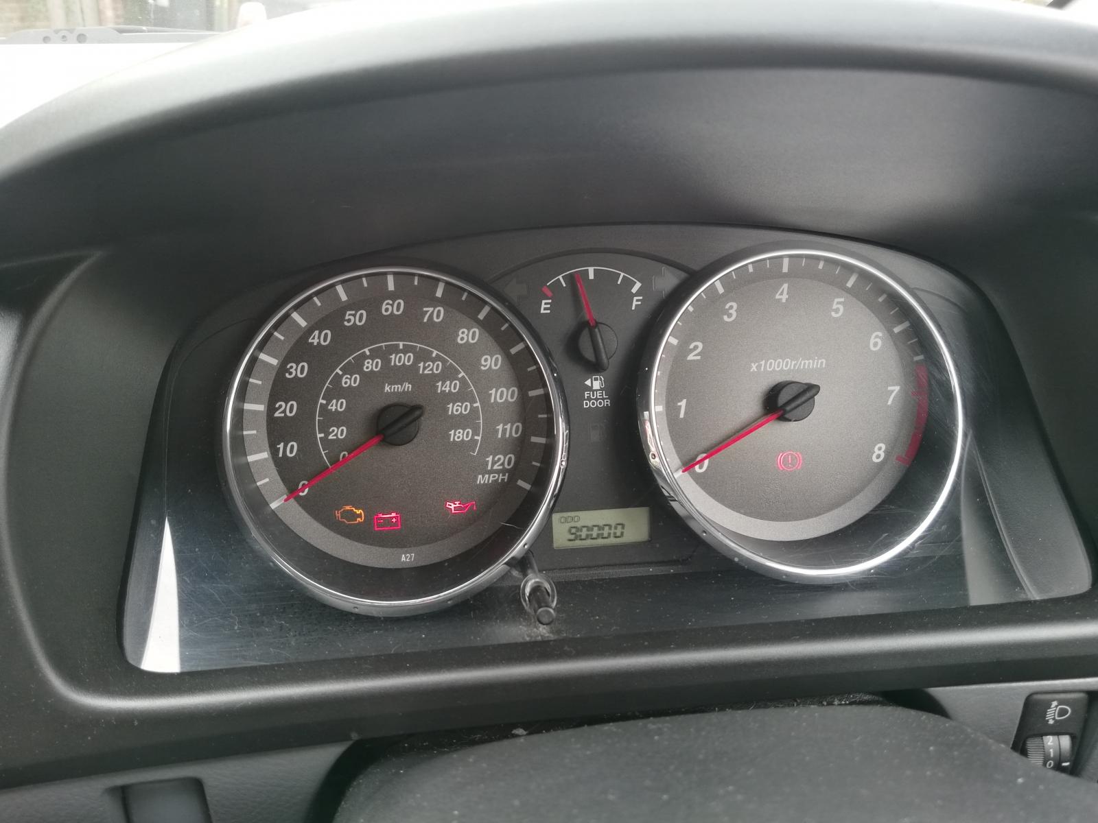

The engine light fault code is a P0136, which is the post-cat Lambda. Switch it off with an ELM327 and it stays off for a while, long enough to pass an MOT at any rate, which is good, because it expired a few days ago. I stuck it in yesterday and it passed, with only an advisory for worn brake discs- the tester said to wait until the pads wear out, but having poked my finger through the wheel and given the discs a poke I'm actually inclined to replace them- ECP will do me a set of Eicher discs and pads for 38 quid at the moment (assuming they're the larger 247mm ones), which is tempting, as I reckon it might also harden up the pedal a bit.
So now I'm wondering what to do about the oxygen sensor. I watched them doing the emissions test; the numbers on the screen were, near as damnit, 0 for both HC and CO, and it initially read over 1.03 for Lambda, before sneaking down to 1.027 and thus passing. So apparently, it's actually running lean (the exhaust pipe is quite rusty, but they didn't advise me of any leaks). This surprises me, as I'm of the opinion that a car rated for 108g CO2/KM should do a lot more than the 54mpg it managed at a very steady 55-60mph cruise on the way back from collecting it, especially given the high gearing. It also takes a few rotations to start when its hot, not so that it ever gives the impression that it won't catch, but a lot more than any of my other petrol cars need. I'm going to pull one of the spark plugs out in a minute for a look, I think, as I can get a set of three iridium Densos for 21 quid delivered off ebay. Then I'm wondering about replacing the pre-cat lambda just because it looks original and the car's done 90,000 miles. Perhaps I'm being unreasonable, but I can still to this day remember that the Nissan Micra K10 brochure I got from the dealer when my parents bought a Prarie in the late 80s reckoned the 1 litre would do 80mpg at a constant 56, and that's from a slightly larger car with a carbed engine, so near on 30% more fuel consumption from something smaller and more modern seems off. I like to think I'm pretty good at hypermiling, I've managed over 40mpg from my 3 litre Mondeo on several occasions. I guess I'll do the post-cat lambda at the same time just to shut the engine light up and in case it makes any difference. Would an exhaust leak cause poor fuel consumption? Any other ideas what might be wrong, or whether I'm just being unrealistic?
Edit: checked the plugs, they are a set of Bosch twin-electrode ones and look absolutely fine.

Exhaust leak before lambda sensor could cause overfuelling. Im sure you know but o2 reading ideally is 1 or close to it.  to be honest I'd be happy with 54 mpg. A 3 pot has to work harder.

Anyway, theoretical thermodynamics ramblings aside, does anyone know if the EJ-VE engine has a dizzy, or if I can adjust the ignition timing some other way? I'm wondering why the timing information is both in the handbook and on a plate under the bonnet, and hence whether it's worth checking. For the sake of 20 quid I think I'll follow TS's advice and bin the Bosch plugs and get some iridium Densos in there, but Jikovron's report that he got over 60mpg with a v8 in the boot makes me think that mine could definitely do better, and I don't think I'm likely to get a 10%+ improvement from new plugs (though fingers crossed, you never know).
No dizzy on these, but it does have a double cam sensor setup controlling 3 coil on plug sparklers as it's got a variable advance inlet cam so needs to reference its advance , any problems with the timing setup pings on the eml straight away and makes it run despicably rough.
These can blow through petrol, if I keep up with the 3rd and 4th lane traffic on the M1 i can drop it into the late 40s mpg wise usually as you say dropping into 4th or even third to keep it responsive up inclines, I get decent economy by essentially just letting it slow on inclines in 5th as it will maintain 65 with very little throttle input, but wants full throttle to gradually get to 70 .
OK thanks, good to know. I'll change the plugs and see about doing the lambda sensors, then I'll just have to be happy that it's running as well as it can.
