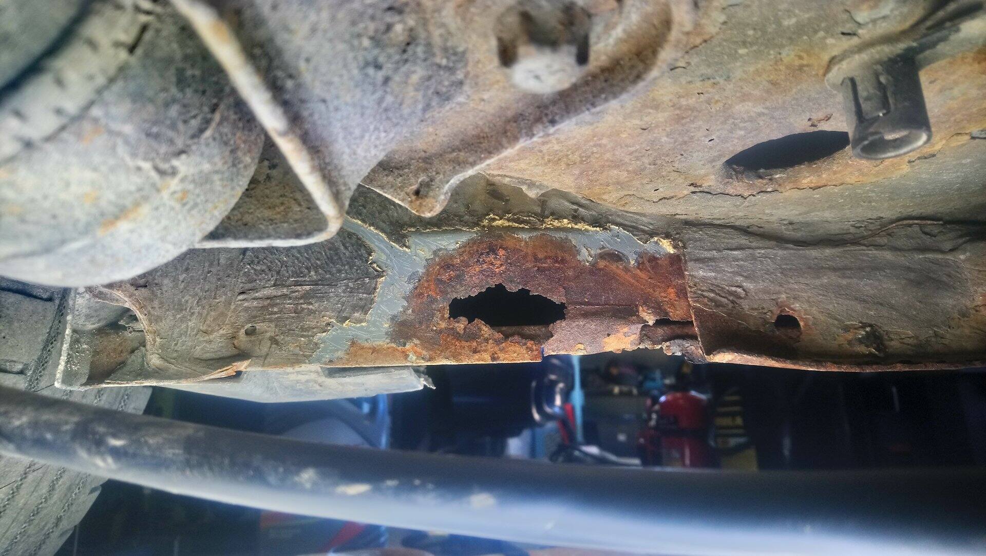

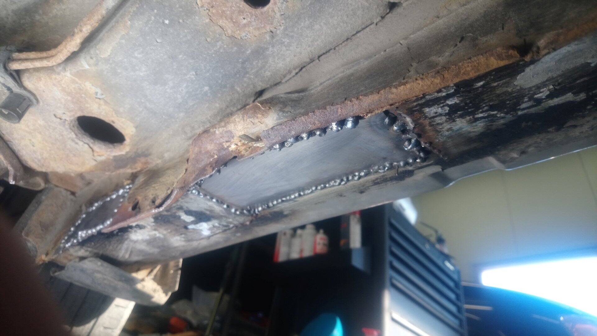

We've very much enjoyed Fehita - there's a certain willingness and effortlessness to it, so we tend to prioritize it over the Volvo, unless it's very hot (Volvo has A/C) or the whole family is going (Volvo has more room and more doors). The Astra has been providing adequate service, but the parking brake cable seized before summer, and the exhaust hangers for the rear muffler failed. I substituted the broken exhaust hangers with some wire, but didn't bother with the handbrake up until last month, what with the inspection looming. A cable change shouldn't be too hard, I assumed, but the Astra has cable brackets in the rear axle, that are held on by three small bolts each, and they of course proceeded to snap in their holes upon offering a spanner. I didn't fancy mucking about with extracting the screws, so I welded the brackets back on and called it a day. While under the car, I found a gaping hole in the back of the left sill, but I decided to leave it up to the inspector to decide. Unsurprisingly, the car got failed due the grot, so I had to weld on a couple of patches.
An hole. I peeled back some of the factory rust protection goop to reveal perfectly fine metal beneath. I cut out the bad part and proceeded to make a patch.
Not very elegant, but it works.
sm_fehDSC_1302.thumb.jpg.69e574a9de7ba744d929f90b3d169fea.jpg.

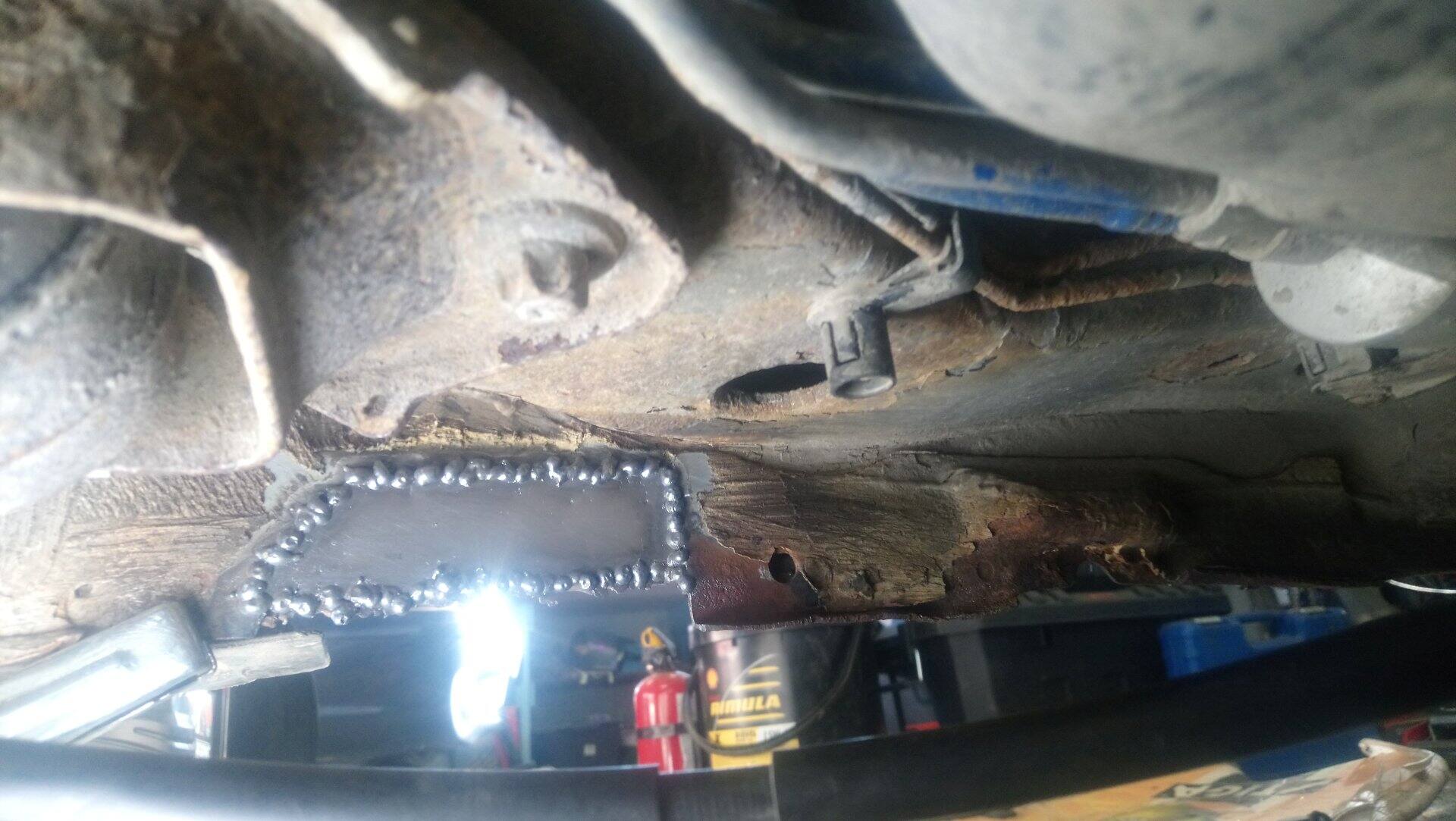

I patched up another hole I found in the outer sill, too. Afterwards I sprayed on some primer and paint, attached the sill moldings and called it done. The inspector was now happy.

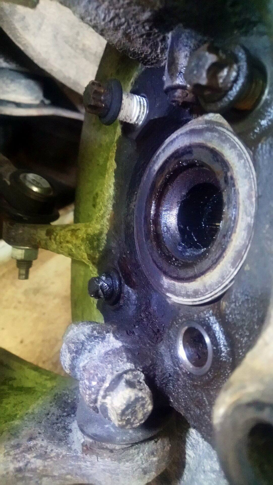

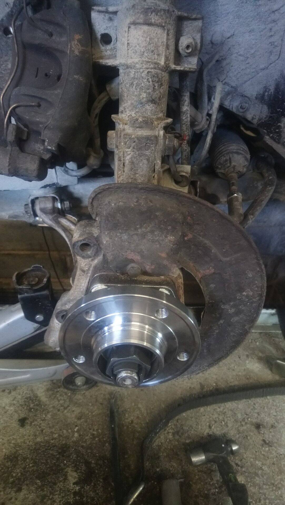

The Volvo failed with a loose tie rod end, and upon fixing it I found that the wheel bearing was absolutely shot, so I proceeded to replace it as well... after faffing about with a broken bolt for half an hour.
The CV axle thread was nearly buggered, so I didn't look forward to torquing the axle nut after installing the new bearing.
Luckily the thread held up and I was able to torque the axle nut to proper spec and degree.

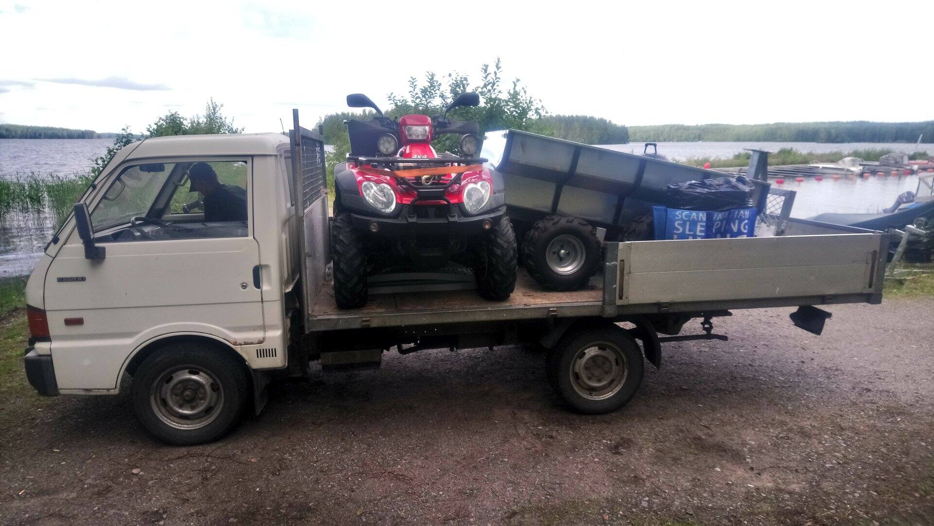

In other news, the Mazda E2200 has been very useful for many a haulage. Here we are using it to take the ATV with trailer from the cottage back to the farm. (And yes, the cargo was strapped down properly for the trip after taking this shot, so no worries there.)
