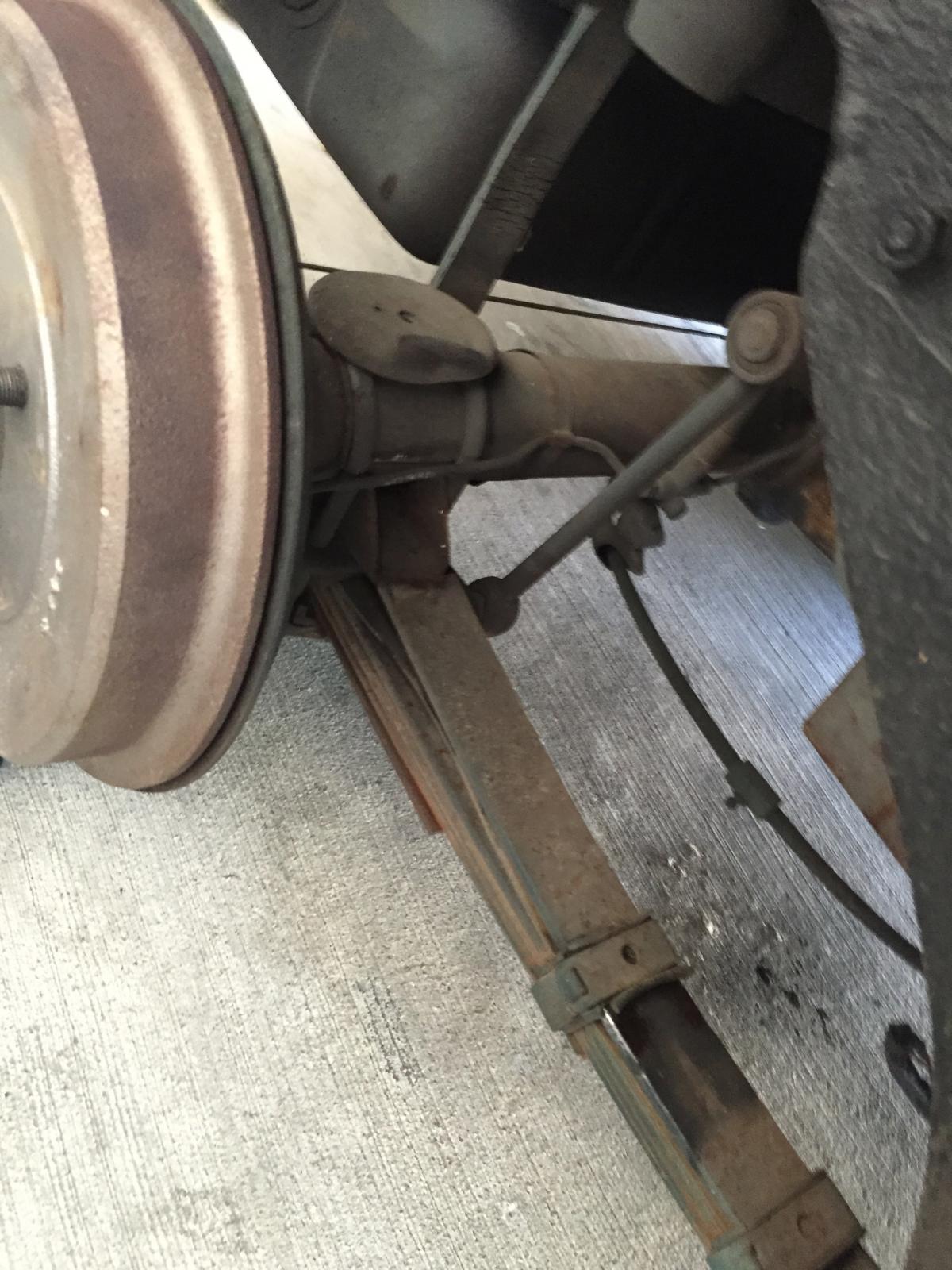

That aside, I've been no stranger to having to tackle the occasional minor or major technical problem. I ended up swapping the transmission about a year after buying it due to a bad speedometer drive gear and also likely a cracked 3rd/4th syncho, something which was a fun weekend engine out job(with a lot of might as wells). I'll write that up later. In the mean time, though, I'll share one of my first projects after buying the car in 2015-I jacked it up and found a cracked rear leaf spring. That led to a rear suspension rebuild, which was a bit of a "trial by fire" on a new to me car, but was fun and I learned a lot. It took me a few days, on and off, to do the suspension on one side and then a few hours on the other side. One of the keys was that after I fought with the front spring mounting bolt, someone finally advised that I just grab a Sawzall and cut it :)
I had to wait on replacement hardware from Moss, but once the right side was done I didn't even try getting the bolt out on the left side-I just cut it which made all the difference in the world in terms of how long the job took.

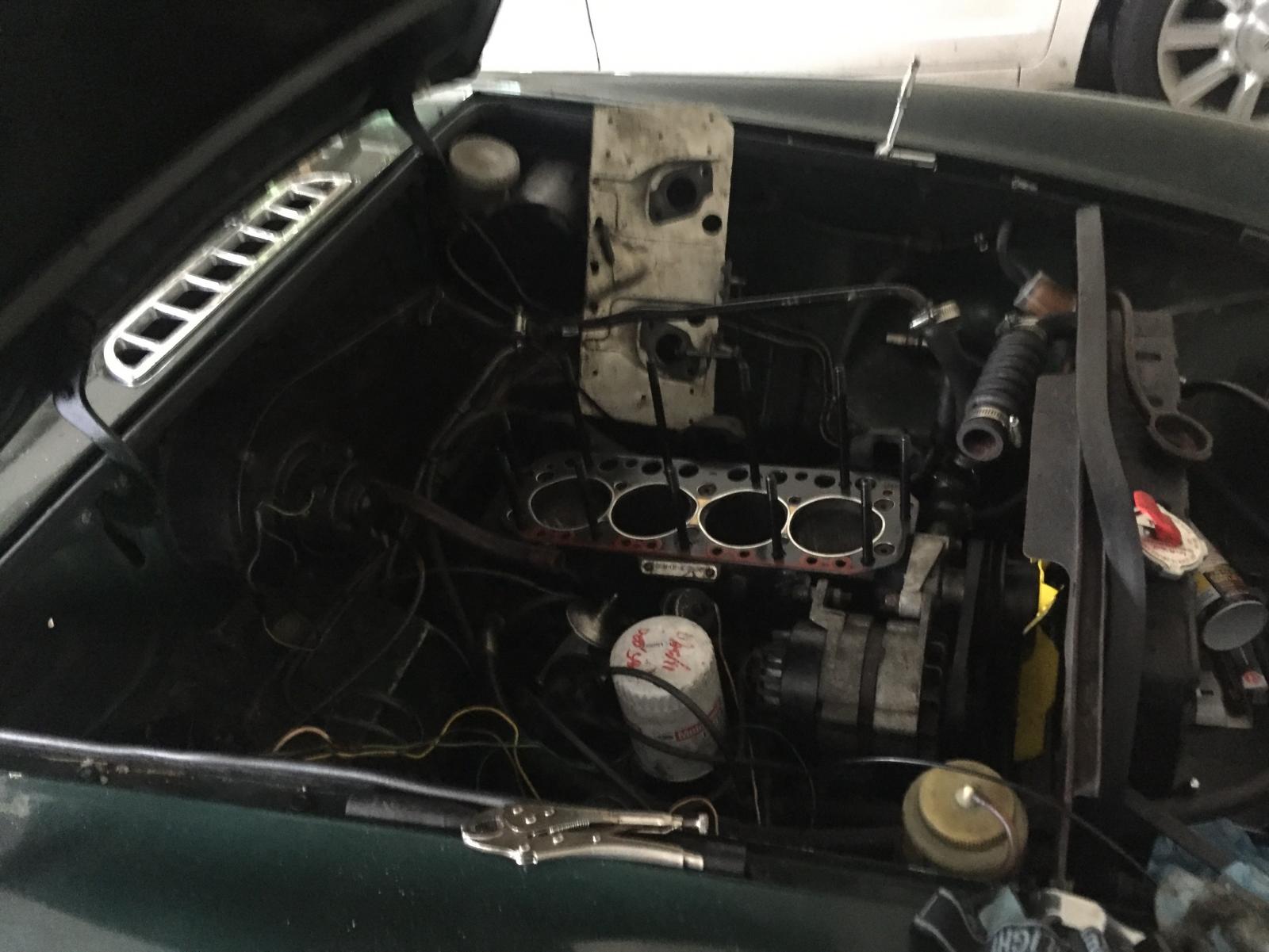

I'm limping along until a complete engine rebuild(I have a lot of blow-by), but a few years ago a burnt exhaust valve caused me to expedite rebuilding the top end.
Although my engine is a factory "high compression" engine, it does have what's known as a "smog head"-it was designed to be used with a(long gone) smog pump that pumped air into the exhaust to theoretically help burn up any unburned HCs and CO, although its effect was questionable before catalytic converters came along. Since the pumps weren't overly reliable, they typically are only still installed in cars registered in states that actually check for those things(and even though '68 and later had them, I don't think any state checks emissions on cars that old). Still, though, the so-called "smog heads" are more prone to cracking. Thus, rather than rebuilding my existing head, I opted to just source another.
That presented me with another option. Stock "high compression" engines use shallow dish pistons with a combustion chamber volume of 42ccs. The low compression engines switched to deep dish pistons, but dropped the combustion chamber volume to 38cc. Thus, one can "mix and match" a late head with shallow dish pistons and get 9.5:1 without any extraordinary effort(but a noticeable performance increase). I have a friend who sells "reconditioned" heads, and I bought a ready-to-go 12H2923 head, crack checked, surfaced, and with new exhaust valves and hardened exhaust seats installed. The 12H2923 was one of two "small chamber" castings, and it's more desirable partially for its factory large diameter intake valves. For a street car they probably make zero difference, but they're nice bragging rights :) (this head casting was used 73-76, 77-80 got the infamous and notoriously crack prone CAM1106 casting).
The difference when installed was remarkable.
Unfortunately, about a year later I discovered the "wisdom" of not replacing the head studs when doing head work. I blew out the head gasket between cylinders 2 and 3, most likely due to a stretched stud. Aside from my lack of compression, I found some nice "milk" on the rockers when I pulled the rocker cover
The breech isn't overly obvious in this photo, but none the less was there
Fortunately, I didn't worry too much about the head. I took it in to work and had the machinist check it for flatness, then spent some time in the machine shop cleaning it up.
Including of course chasing all the threads in the head and block
I threw it back together with ARP studs-about $130 a set but worth every penny-and put it all back together

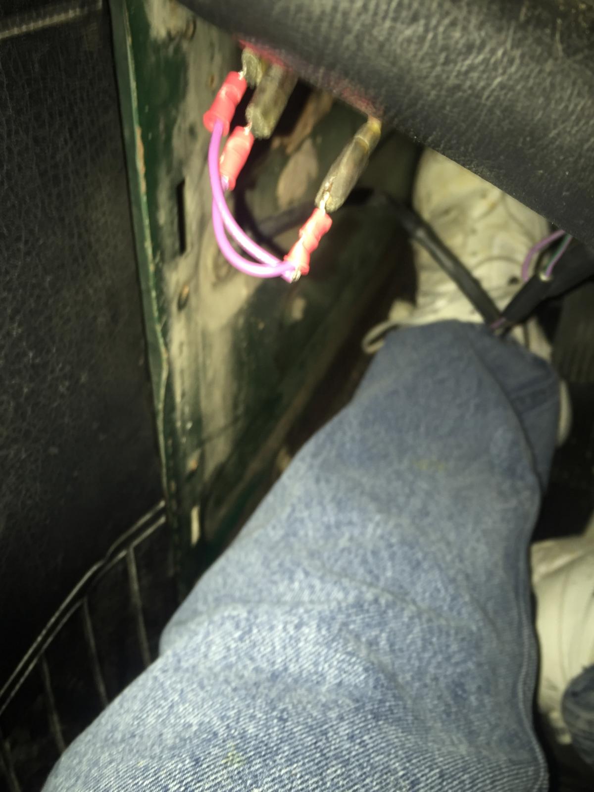

In any case, though, about 25 miles into my 30 mile trip, I had a stereotypical BL/Lucas problem-the headlights, tail lights, and dash lights all went out. This happened to me about a year ago-I knew it wasn't a fuse issue since the headlights aren't fused and also the gauges(which were still working) run off the same fuse as the lights that had died(it's only mildly alarming that I know the wiring that well :) ) . Instead, it's a switch problem-when it last happened to me I opted to clean up and rebuild the old headlight switch since it's pretty widely agreed that the new replacements are junk. I also started hunting for a new old stock switch at the time-I found a few other switches, but not a headlight switch. It looks like I'm going to have to break down and buy a piece of Moss crap while I continue hunting for NOS.
The last time it happened, the high beams would still illuminate if I held back the "flash to pass" switch, so that's exactly what I did. I also flipped on the hazards to make the car a bit more visible, since I only had brake lights(and turn signals) at the rear otherwise. I drove the rest of the ~5 miles home like that.
Such is life with a BL product, and also my punishment for not driving it more.
A new old stock "Lucas-England" switch is on the way, and I have this to use in the mean time...

Unfortunately the switch is done "good and proper" this time around...but I have a "made in England" one coming from Canada. It's not strictly NOS, but is coming from someone who parts out MGBs-this particular switch is brand new and was installed in a never-completed project. It's fairly new(1990 production) but at least WAS in fact made in England and not China.

First, I dropped in the "new" headlight switch.
I'm not wild about the chrome bezel on it, since all the other switches are black(or once were) but at least it's NOS Lucas and hopefully will last.
Even so, though, I need to bump up the relay project, as the switch was getting uncomfortably warm.
