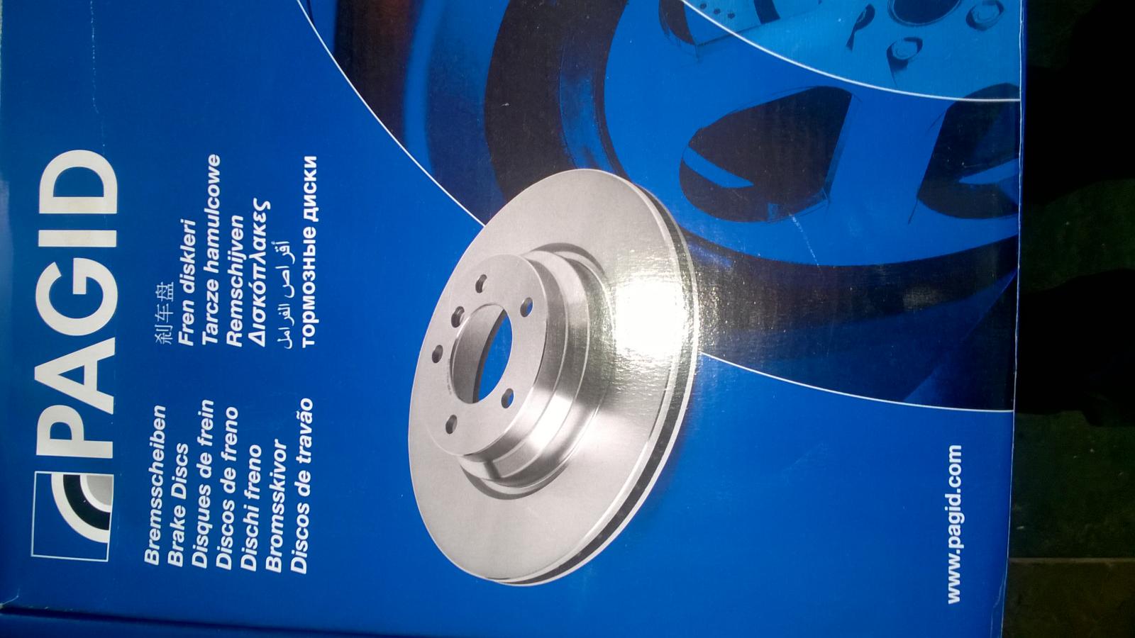

Tamworthbay Posted April 3, 2019 Author Posted April 3, 2019 Thanks to Njgleeds a nice package arrived today: Not brakes discs but a nice stereo for the Pug. Now fitted and worked but I need to fiddle about and route the cables better to get it sitting perfect.
Marm Toastsmith Posted April 3, 2019 Posted April 3, 2019 Now fitted and worked but I need to fiddle about and route the cables better to get it sitting perfect. It's tight back there!
