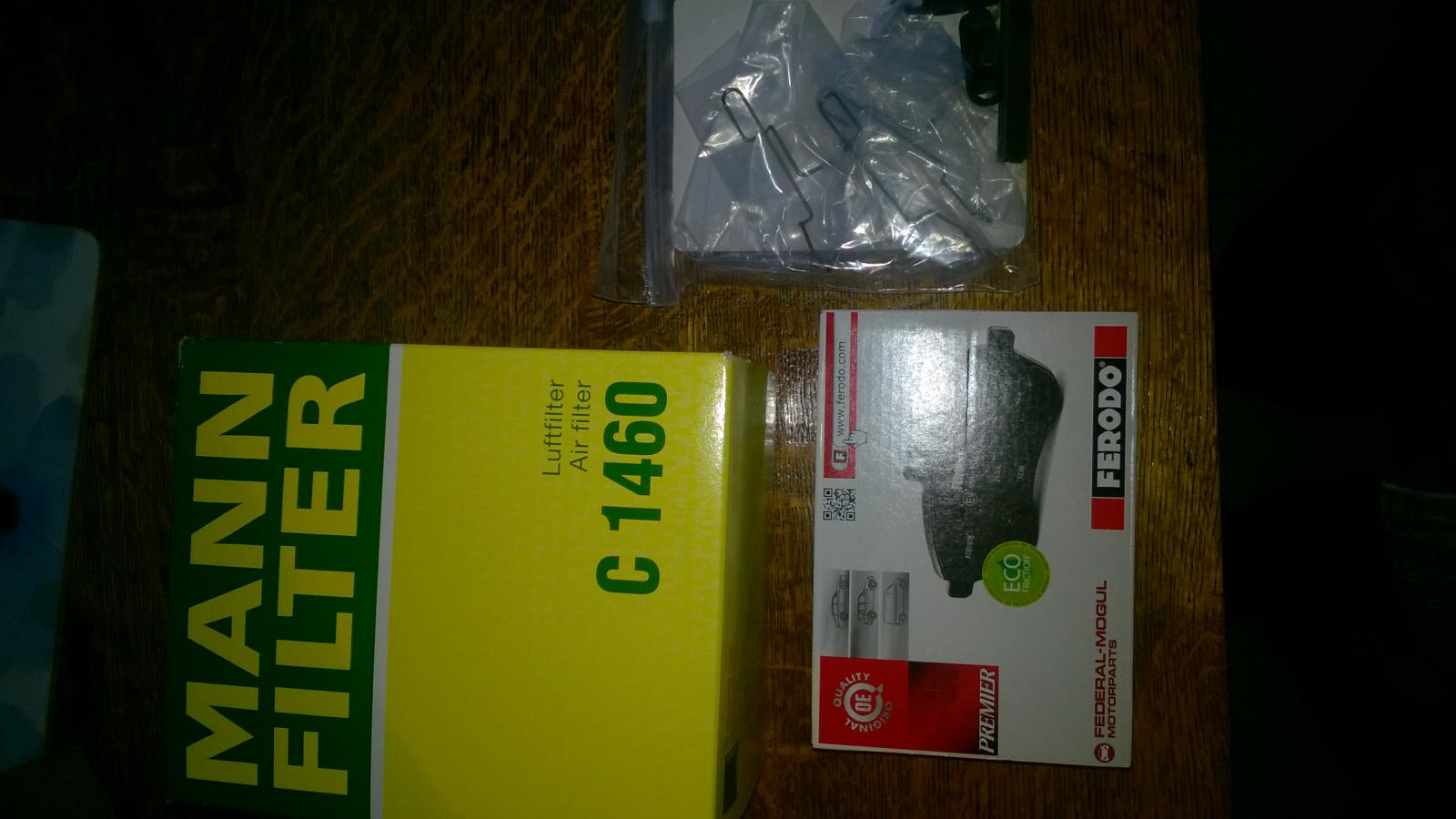

Tamworthbay Posted March 12, 2019 Author Posted March 12, 2019 I picked up the correct pads and air filter today to replace the other bits, just waiting on the air filter assembly and will swap that over if it arrives in time. I am still hoping to get it MoT ready Friday but as my wrist is presently strapped up and painful as hell I will have to see what is possible but at least the bits are here ready. Braddon81, Burnside, GrumpiusMaximus and 2 others 5
