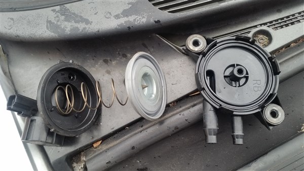

Today I'll be swapping bumpstops for an easy win to start with and then investigating the pressurised fuel tank. Suspicion rests on emissions bollocks currently. The tank vents via a charcoal canister and the fumes from it are fed back into the inlet manifold when off boost. My thoughts are a dodgy valve there allowing boost back the other way. I just need to find the valve now...

I then investigated the fuel system. I think I found the evap charcoal canister, but it's a right twat to get to above the exhaust. It looks quite new anyway. It might be a fuel filter of course, I couldn't find the locations in the workshop manual. So I moved to the front & went looking for the EVAP valve that controls venting of the fuel fumes into the inlet manifold.
Turns out it's nicely located right at the top of the bulkhead in the middle of the car, I guess so any moisture or liquid in the lines can't run into the valve. Noticing it's clipped together I opened it. It's a simple diaphragm valve that uses manifold pressure to block the return line to the tank, along with a sensor so the ECU knows it's working. It's missing from the pic but I found a ridge of gunge around about 50% of the pointy bit in the middle which seals the outlet. I've cleaned it all up & refitted it. I've not tried the car yet so I'll see what happens.

Reading further into it the carbon canister under the boot can get blocked & cause these issues as the breather system runs through it. Now a replacement canister is £197 from Jag & appears to only be available from them. There are guides online about cutting the end off & replacing the charcoal to cure this issue I can't see any reason not to just tip the charcoal out & then glue/tap the case back together. The emissions system shouldn't know the carbon is missing as it doesn't monitor what it's breathing.
That's tomorrow's plan. If it all goes wrong & breaks the car I can steal the one off the Sov & order a replacement.

I have a cunning plan for the tank problem too. If I disconnect the pipe from the inlet manifold to the EVAP valve and plug it then it's impossible for boost to leak into the fuel tank. All it'll disable is a system for burning petrol fumes, which isn't needed anyway.
As the valve is buried under trim panels and can't be seen it won't be an issue if it ever becomes part of the MOT either.

I've fixed the tank issue!
I disconnected the line from the inlet manifold to the valve under the bonnet to ensure that wasn't leaking boost back into the tank, this didn't fix it. TBH I wasn't surprised as if the tank breathers were ok then the pressure wouldn't have built up and stayed in the tank anyway, but it was easy to do so worth a try. You can see the old drill bit I cut down to seal the pipe to the manifold here.
Then I got the car in the air & started following the system through underneath. Someone on FB had the right idea for where the issue was. The plastic valve that controls the flow to the canister from the tank is faulty. I took it off & blew through it, it flows fine towards the tank so you don't get a vacuum as fuel is used but trying to blow from the tank was almost impossible, meaning a lot of pressure builds up in the tank before any air can flow.
The valve.
Back in situ with the disconnected tank vent just visible.
I've disconnected the tank vent hose from so the tank is venting direct to the atmosphere like cars of old. This has cured the issue. I'm in two minds as to leaving it or bypassing the valve with bit of hose. I can't see the point of the valve as the small hose that comes off it just vents to air too. So it can only be to hold a slight pressure in the tank, which seems pointless to me.
Oh & the reason for the pressure in the tank? hot fuel coming back down the return line heating everything up so the fuel & air in the tank expands.

I couldn't be doing with the tank pressure, there was so much of it the tank would have split eventually. Besides if I get stuck into a new car it's all part of bonding with it. If I ignore it for months stuff never gets done as I'm used to it lol.

Excellent fault finding.
That return system must dump some fuel back into the tank for thermal expansion to fill the void from the fuel used which is surprising given these use a fair bit of the pony juice.
