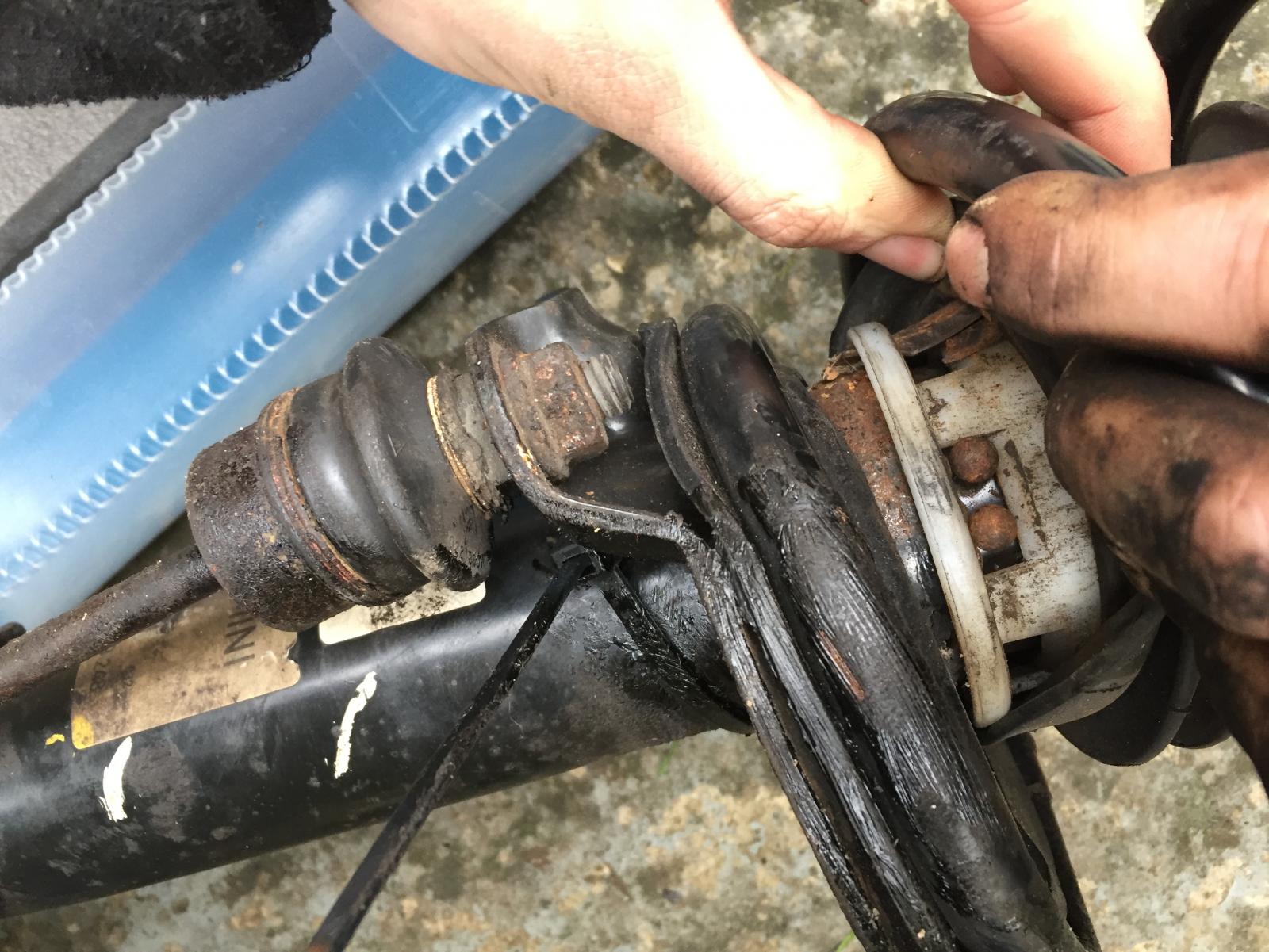

Vince70 Posted January 11, 2019 Author Posted January 11, 2019 I’m still draining the water out the car at the moment but it’s nearly dry now and I’m going to put a dehumidifier in the car tomorrow to see if it gets the last of the water out so it fingers crossed. But I went to turn the steering and get a strange noise which I suspect is a broken spring but it looks like the strut leg is a bit iffy also and wondered is it worth just chucking on a secondhand leg which should cost in the region of £25. I don’t want to throw a fortune at the car as I’ve still got an abs light that’s on and it needs a service and gearbox oil change plus the recoding but would you buy a secondhand strut leg and am I right In thinking this looks completely knackered.This one is the other side for comparison.
bangernomics Posted January 11, 2019 Posted January 11, 2019 I’m still draining the water out the car at the moment but it’s nearly dry now and I’m going to put a dehumidifier in the car tomorrow to see if it gets the last of the water out so it fingers crossed. But I went to turn the steering and get a strange noise which I suspect is a broken spring but it looks like the strut leg is a bit iffy also and wondered is it worth just chucking on a secondhand leg which should cost in the region of £25. I don’t want to throw a fortune at the car as I’ve still got an abs light that’s on and it needs a service and gearbox oil change plus the recoding but would you buy a secondhand strut leg and am I right In thinking this looks completely knackered.92AAD85B-6AF7-4EA7-9ADD-449D568772E4.jpegThis one is the other side for comparison.5BFC666B-618D-4B52-B599-C4F998257101.jpegExactly what I've done re the multipla, by the time you've bought a spring and killed yourself fitting it the strut is done. Don't forget the new drop link too as if attached they invariably pooch up.
Rusty_Rocket Posted January 11, 2019 Posted January 11, 2019 Can't really see from the picture Vince, but the spring is probably only losing its powder coating, which is not a cause for concern. However, if you do want to replace, definitely just chuck a complete leg on it, as you say. Much easier/ safer on something like this. Vince70 1

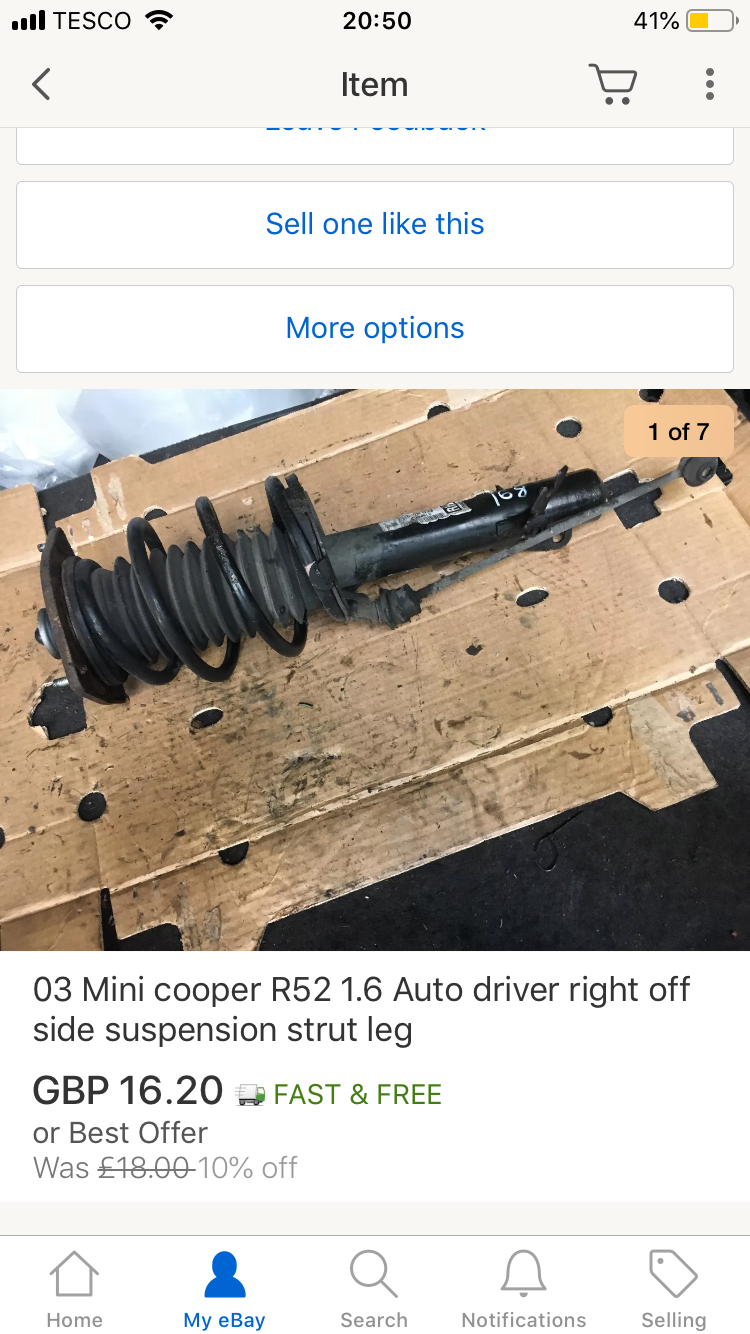

Vince70 Posted January 13, 2019 Author Posted January 13, 2019 The new strut leg has been ordered and I got a secondhand hand one off eBay and used the BMW site to find the part number as it’s got the sports plus package so I paid a little extra to get the right one. Also I had a bit of a result as my other half is scrapping her Peugeot and it had a parrot Bluetooth fitted so I’ve ripped it out the car and I’m going to install it in the Mini to the original stereo and found a loom for it on eBay for £4.

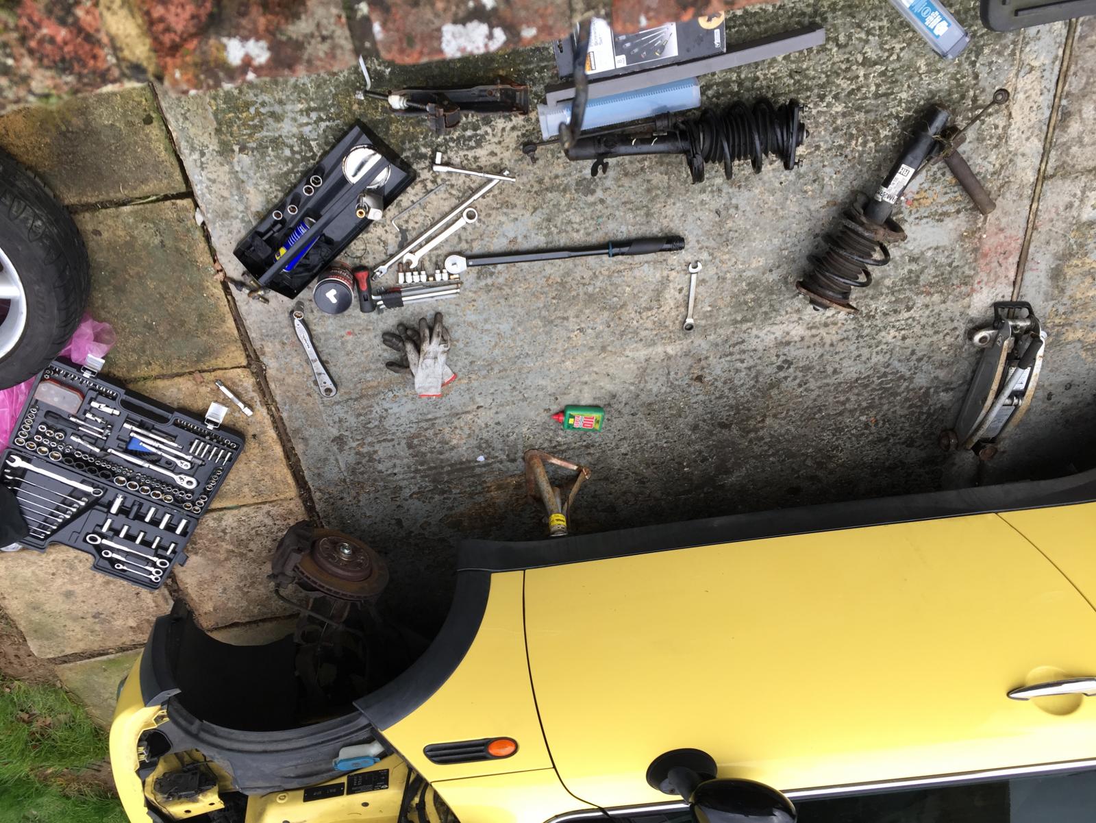

Vince70 Posted January 26, 2019 Author Posted January 26, 2019 Today while the weather was nice me and my mate John decided to change the suspension leg on the car and although the leg was very rusty we couldn’t find a crack in the spring but the noise was coming from that area so it was worth changing and we had the parts anyway.As you can see all was going well and we fitted the new one back on but decided it needed a new sway bar so it needed to come back off and then we found half the bearings were missing on the new unit plus a broken lump of metal fell out. So I’ve found another leg on eBay off a low mileage cabriolet R52 but wondered if it would fit and also I’m worried the spring colour code is different and wondered if it’s worth a gamble as also there was a change to the suspension on the R50 around 2002 and I’m not sure if it just the sway bar or suspension leg.
panhard65 Posted January 26, 2019 Posted January 26, 2019 I did the shocks on a Cooper S a few weeks ago and they don't need a spring compressor, using one does make it easier but you might find it will only need a couple of turns to compress it enough to dismantle. Vince70 1
Vince70 Posted January 26, 2019 Author Posted January 26, 2019 Thanks panhard I’ve just bought another leg for a very cheap price off eBay off a 50 odd thousand convertible and might use the new leg and thr spring off my rusty suspension leg.The other leg which I bought has to go back to the seller and I got a return label for it and looking at threads it seems the only difference is it had a different sway bar on the early leg so I bought a new early one so it’s fingers crossed it works.
Vince70 Posted February 2, 2019 Author Posted February 2, 2019 I fitted the new leg today ( or my mate John did while I made the tea) and the mini is now creaky free and really does drive spot on now and I loaded the underside of the car with Dynax while the strut was off so I can’t see the new one rusting anytime soon and added a new drop link whilst it was apart. The only problem since doing the job is the brake pad warning light has come on and I don’t know why as the pads have plenty of meat so further investigation is needed. I was so lucky as the new strut and spring look like new and only cost £16.50 especially after last weeks fiasco when the one I bought was complete scrap but eBay are going to sort a refund on that one so even more win as it was over double the price also. The leaks now have also been sorted after buying a later R56 door rubber and a new sunroof drain tube but the main leak was the badly fitted windscreen as it was pouring through on that one. I’ve driven quite a few R50s in the past and have to admit this is the best one yet and is also quite quick so next it’s the gearbox oil change and molyslip then it’s going to get the keys coded and I sent the remote one away for repair and that was only £11 so it looks like owning a mini is quite cheap with the amount of cheap spares available. I have to admit though I still prefer my e36 Ti over the mini but it’s going to be a fun winter car.

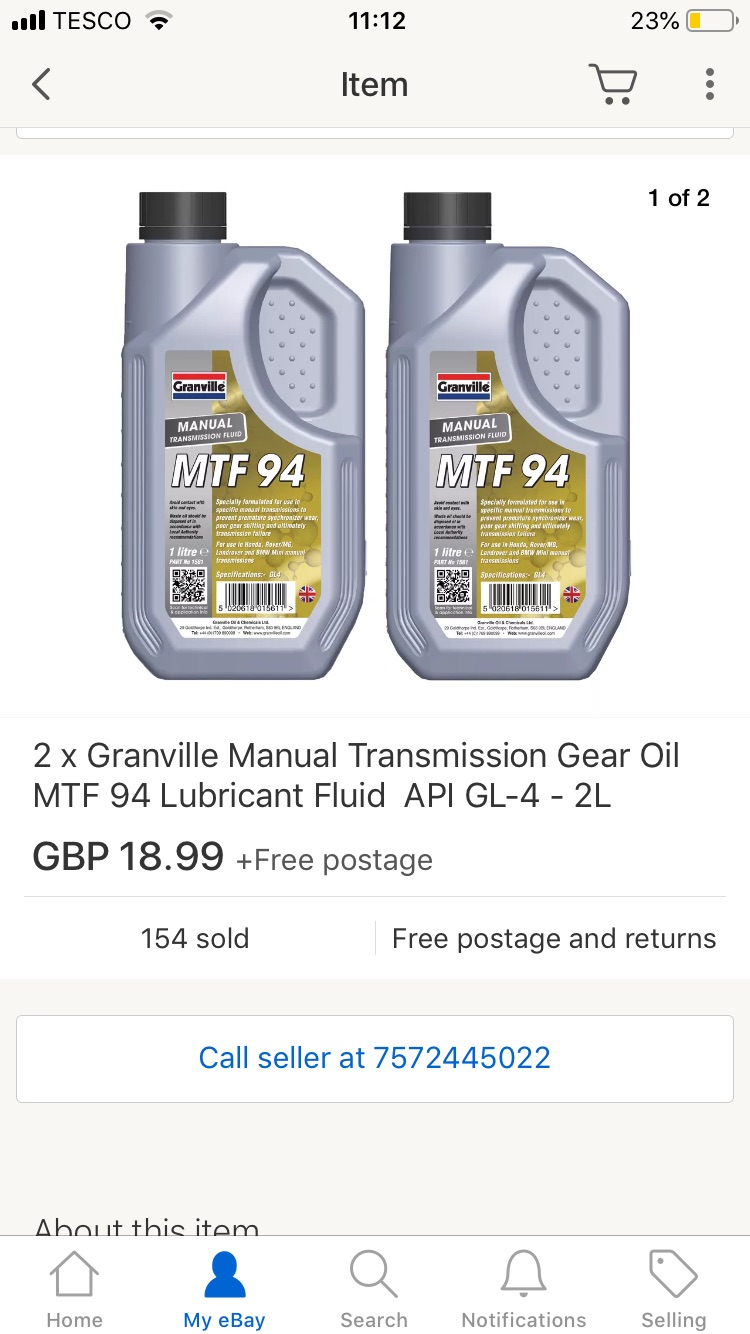

Vince70 Posted February 18, 2019 Author Posted February 18, 2019 This weekend it got some of this and then this in the midland gearbox which had been sitting about in the house collecting dust.I was really quite lucky as a friend of my other half’s daughter works in a garage and he did the oil change for me for a score. I noticed on the way over that the rear brake caliper was binding so another has been ordered plus a set of pads. By the time I get this winter beater of death sorted it will be summer I guess I should of kept that lovely Honda engined rover lol. I will say parts are so cheap for the R50 as although I’m not convinced with the garage that I need a wiper motor I bought one anyway for a tenner and I also bought a new heater control panel as I think that may be broken as the air position dial doesn’t turn a full £360 and the heater temperature dial feels very tight plus it doesn’t blow on any speeds I thought with that would be try the cheapest item first.
