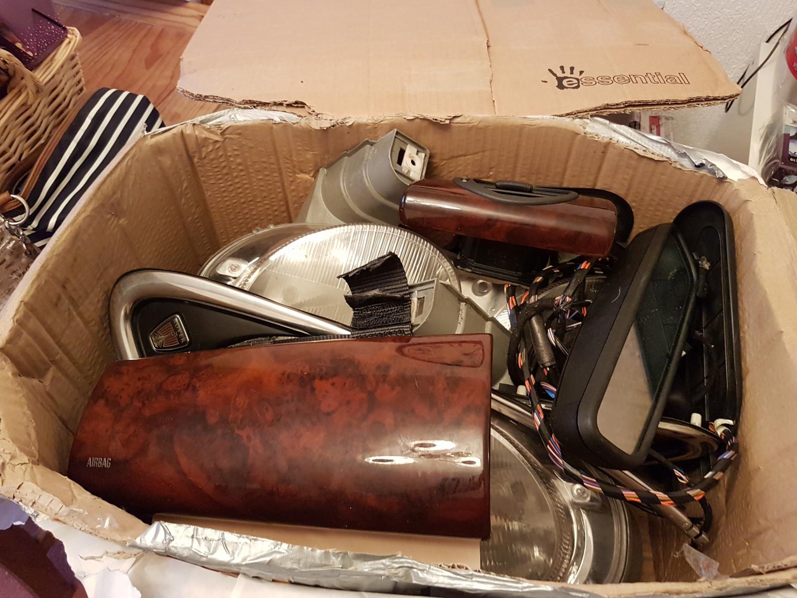

Curtosey of Brodders, two rather substantial packages arrived today for the 75.
All wood trim, headlights, rear lamp clusters to replace the cracked ones currently fitted to the car, boot seal (very much needed) and other bits and bobs.
