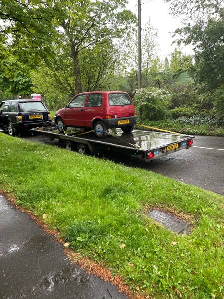

car has only moved from trailer to garage so this is its first run out.

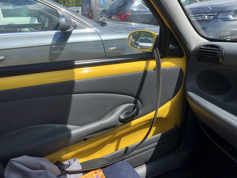

Spent  an age rattling trim, coasting revs and switching fan blowers about to find a squeak then stuck my window down and realised the squeak is most likely coming from drivers wheeel bearing.
not to worry, I think I can afford some consumables as it’s only cost me £6 and a train ticket so far.

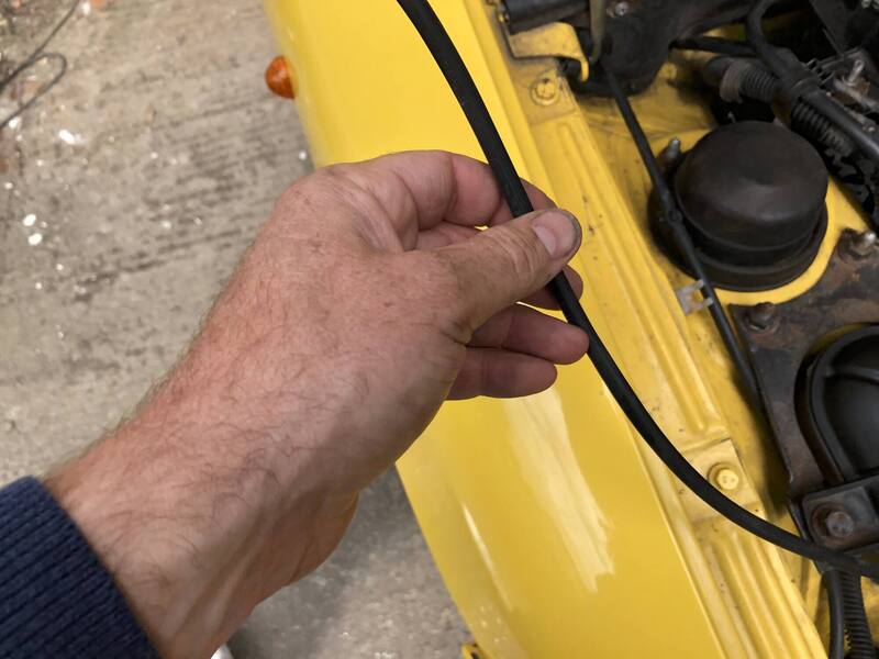

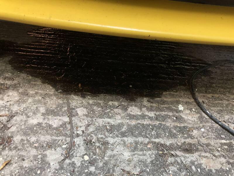

Had a few days with the yellow fella to acquaint ourselves, first job when the post arrives is to pop a new rocker gasket on, as the obvious source of burnt oil smell was detected.
Also refilled the screen wash once I’d figured out where the hell the filler was but no fluids were present, no pump noise either and many hoses to nowhere so added to the list.
perils of a yellow car. Bought some flexi builders buckets from toolstation, put them down on roof, took an hour to find them.

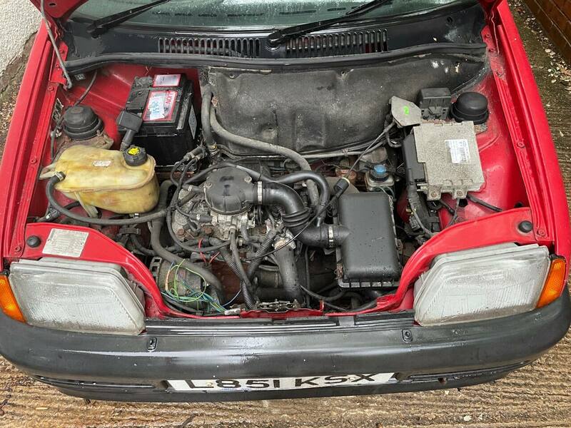

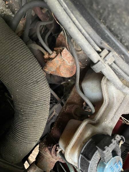

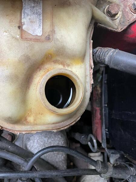

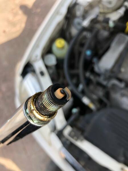

Decided to look into the engine idle issues properly on the Mazda as it actually stalled on me the other day.
Not really sure what I’m suspecting as the coolant header tank was empty, the rad is full, the temp gauge is normal and there’s no Mayo on the dipstick - oil is as golden as honey.
First checked all the leads were sparking - all ok.
Then checked for air leaks - All ok.

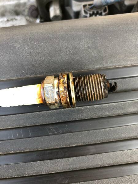

Then pulled the plugs for a nosey, a little bit of oil above them and cylinders 1&2 looked a bit sooty.
Can’t remember when I changed the plugs last so went and got a set this morning to change the over. Naturally, when I came to change them, the plug now looked pretty normal on removal 😕
However, on checking all the connections to the leads at the dizzy end, one came away in my hand.
Fortunately, I had spare but known good old leads I’d taken off the other 323 in case of a failure so C as this so swapped over and then restarted the car.
still much wobbly on the idle so I unplugged the maf and it then started to idle roughly in a completely new way so at least the mad is kind of functioning.
Took off the maf and blasted it through with brake cleaner in case of detritus and set it back in place once dry. Still no dice and the same idle wobble. It seems to have improved and sits still but the coughs once in a while.
Coolant is staying level, it isn’t spitting out the rad  under compression and the exhaust has a ‘put-put-put’ idle wobble.
Heater still blows hot and cold on demand and temp sits firmly in the middle. I guess I need to do a compression test of the cylinders or maybe it’s injectors? It’s very sooty
Advice welcome.

Seems the 90’s are my soft spot and after languishing as a forgotten thread, absent of any mechanised metal of note, it is celebration time as a new car was delivered this fine evening…
Starts and drives, albeit stoops very quickly off throttle as the front brakes are seized so they will be getting whipped off first.
looks fairly solid in the main…wonder what this bit belongs to?
No mayo in the coolant…although looking at how black it is, you’d be forgiven for mistaking it for Brent crude!
Smoll engine, is smoll shocker.
brakes stuff a bit crusty all round
some wires
Yes…about those mix tapes!
Kids already want to be taken to school in it!

- investigate the brake pipes
- Investigate the pile of rust that is the master cylinder and possibly replace.
