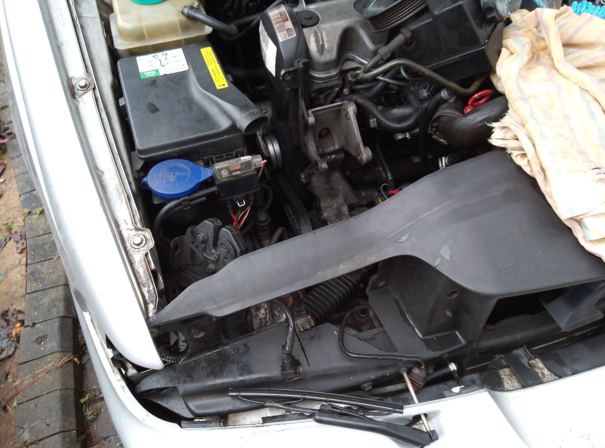

All sorted! What a pig of a job! 9 bolts so how hard can it be? Moving the power steering pump was ok, the bolts are well hidden but came out ok. Alternator was tight in but came out with a wiggle. Then to get it out........ there is a bracket that holds the power steering pump, alternator and ac compressor. It could easily have been made in two parts and would make the job dead easy, but no. So the headlight, indicator, and various other bits have to come out, then the slam panel has to be unbolted and wangled forward and with much wiggling and yanking it finally comes free. Half and hour and a cup of tea later the new one arrives. Except the wiring connector is different and there is no way the two will mate in a million years. After a couple of minutes head scratching I knocked up a small (and properly shite) loom (in the loosest sense of the word) to connect the two. Time will tell if it lasts. Now to get the bugger back in. I ended up getting it to a point where it was alloy on ally and then standing on the front bumper and gently bouncing with my weight on the alternator to get it home. From there is was a relatively strait forward reassembly job except the locating tang broke of the indicator so it's now held in fetchingly with black gaffer tape. New alternator is kicking out 13.9v so all is good, for now. Not a job I would like to repeat in a hurry.
Fuck me, that is one cramped bit of engine bay.
Yup it is, everything seems to be surrounded by sharp edged plastic as well and there seems to be something in the way of each and every bolt you want to get to. My knuckles look like they have been sanded. Apart from the issue with the different connection it went as well as hoped apart from the crusty plastic on the indicator. I will try and get the right connector and build a better loom so it’s a more long term fix.and it seems it may well have been the original alternator looking at the markings.
