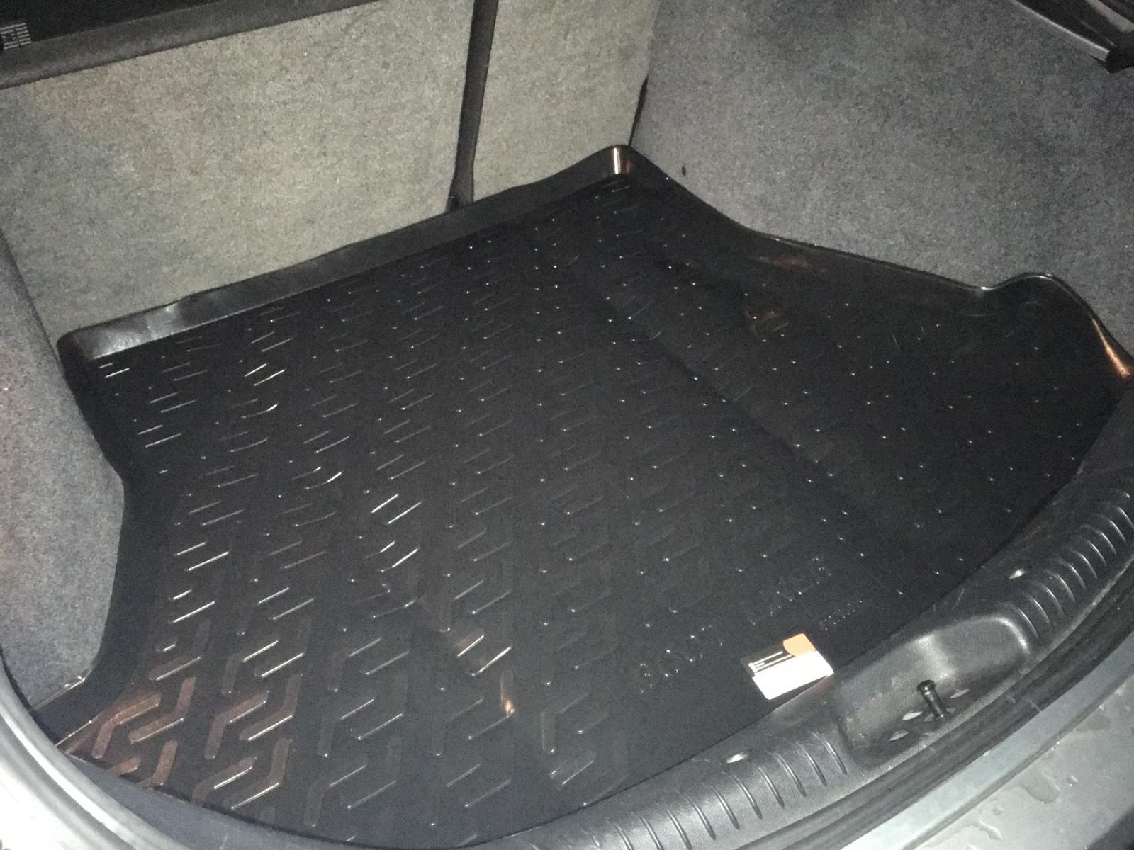

Ordered a rubber boot liner as although it’s giffered externally, I’ll feel guilty scuffing up interior with building rubble and house building parephenalia.

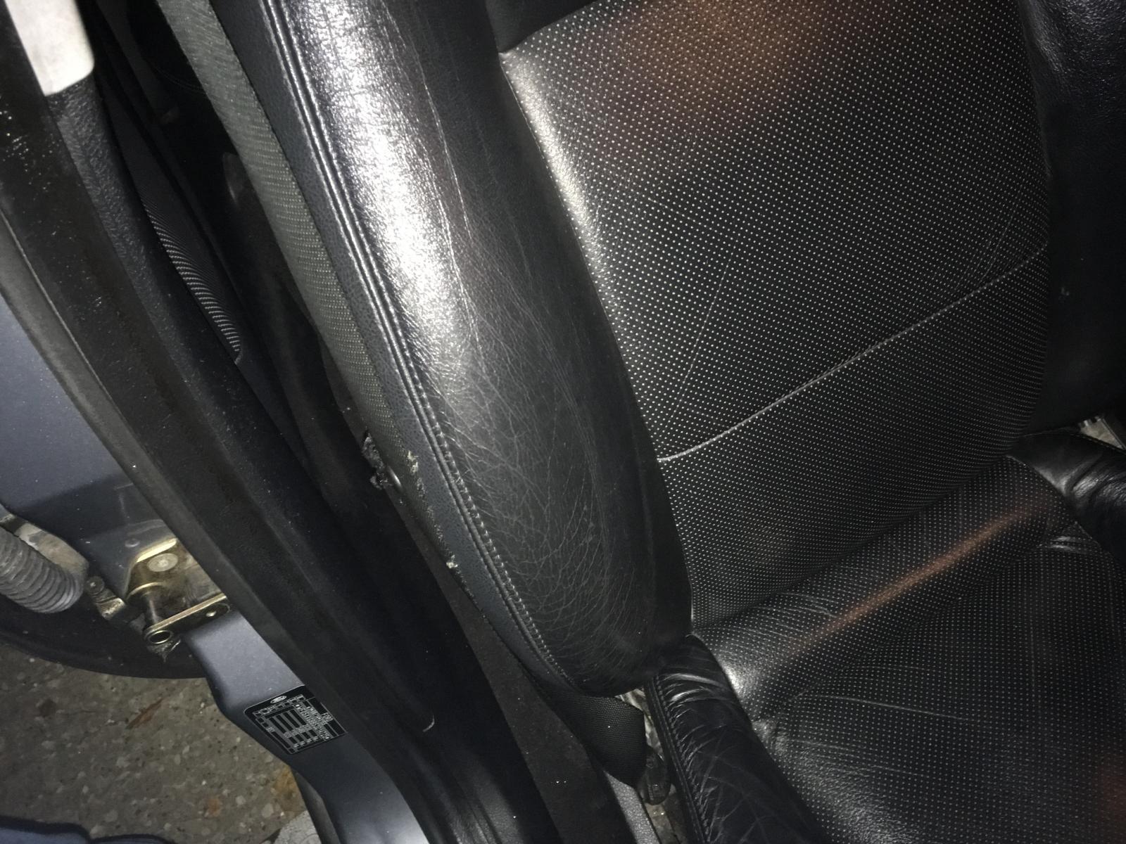

Also ordered a spot of leather dye for for the lightly scuffed bolster.

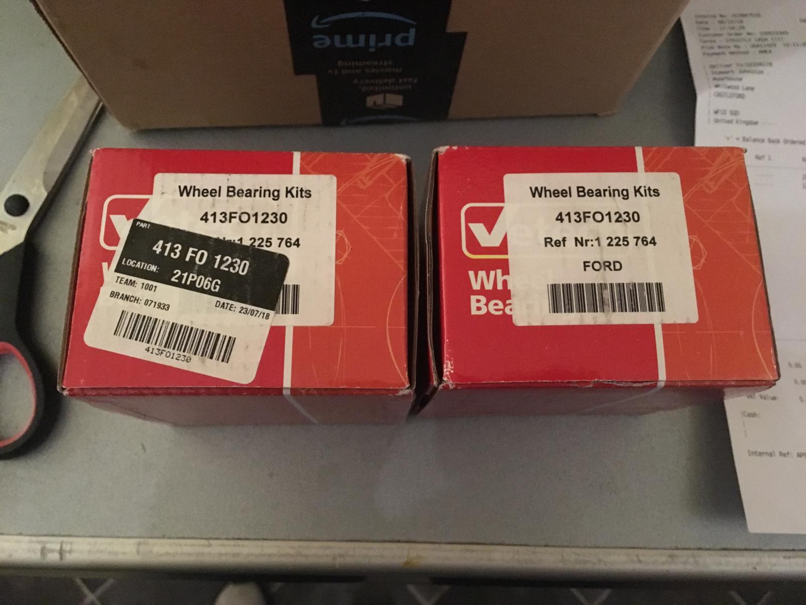

Two wheel bearings on order from gsf. Absurd £79 each but a total of £65 a pair with one of their limited time* 59% off offers.

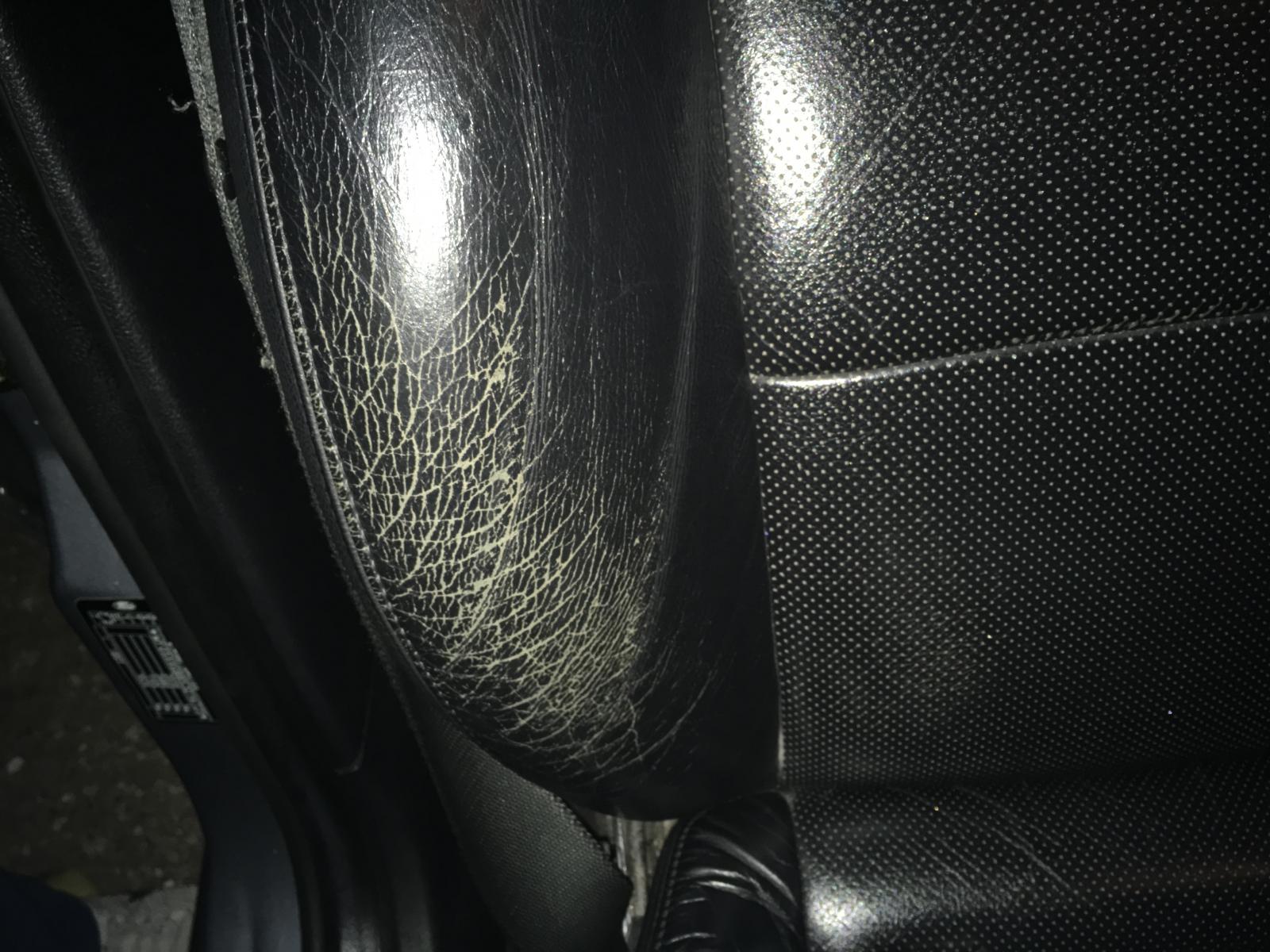

Scuffed leather bolster versus a thimble full of the £6 quids worth of leather balm.
Bang! and the grey is gone!

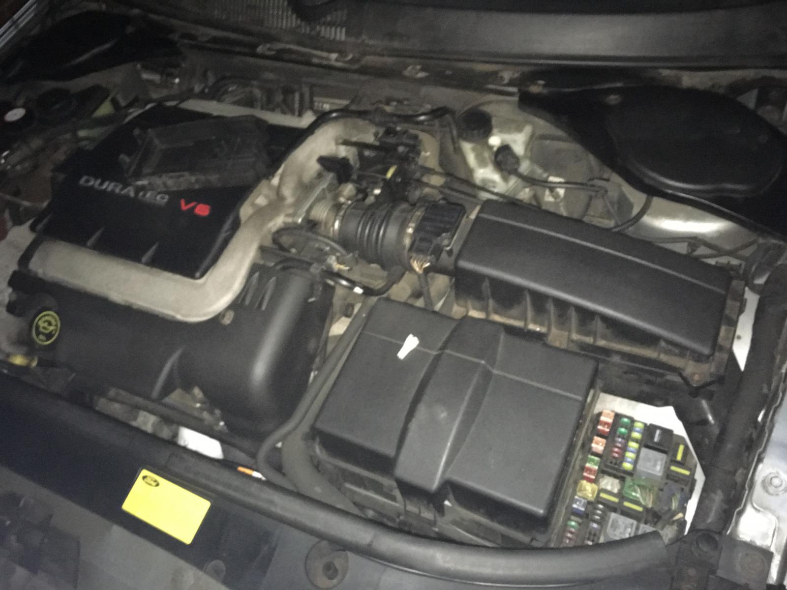

Thought I’d check the fuses and relays for the heated window, very impressed with Ford design for removing glovebox to get at fuses. Much time saving.
Less impressed at random bonnet release with a goddamn key behind the badge?!? Much time lost. Car is spotless under bonnet.
All fuses and relays correct so cleaned contacts and will retry when the frost comes.

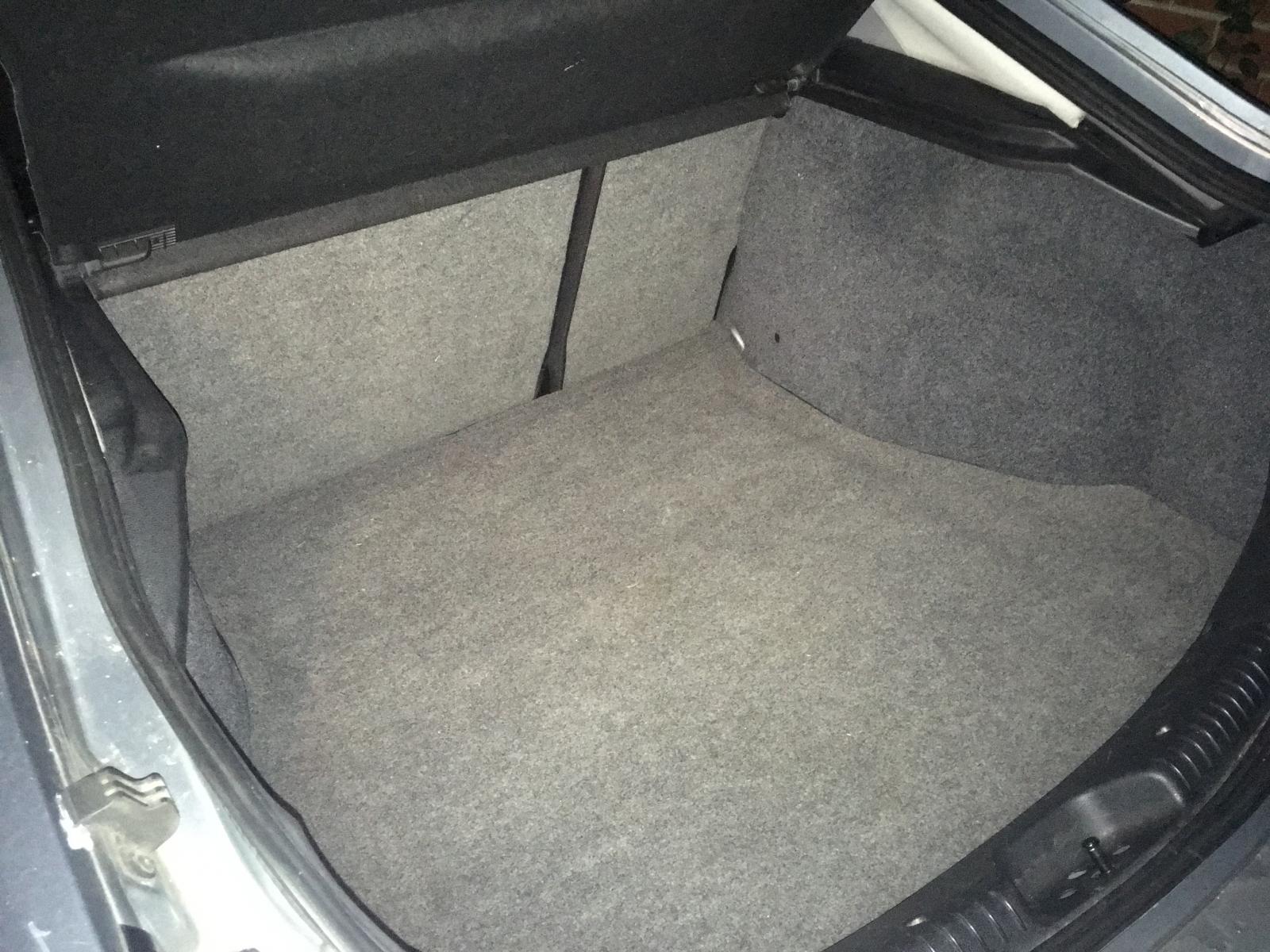

As the Giffer X will be involved in ferrying builders rubble around, I felt obliged to protect the minty interior, hence...

Word of caution if you’re preparing to do the front wheel bearings, you need to drop the subframe, not all the way, but enough to get the angle to separate the bottom ball joints. They are an absolute Colin hunt to get apart on these.
Wisdom says you need subframe alignment tools to bolt it back up, but aligning it by eye to where the previous ‘dirty’ marks are should be close enough. Would advise alignment afterwards because it will probably chew the front tyres to bits otherwise
All front suspension jobs on Mk3 Mondeos are bastards - fact

Ah yes, I have seen the very same autodoc vid, don’t believe a word of it. Bottom ball joints are an absolute pig to separate on these, even if they only went together 20 seconds ago
They’re not insurmountable, but be prepared for a fight
Front bearings on these, if consign that job to the garage if it’s hundred quid or so.
