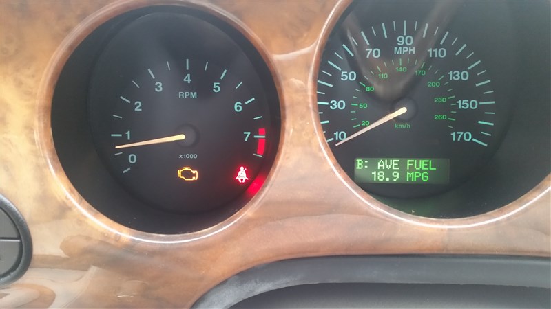

Well pretty much dead on 2,000miles in and on the way to a job interview earlier this happened.
Which turns out to be this & reappears when reset
Time for some reading on common faults & causes I guess.

Ignore or knock lamp off for test.
Behave, apart from it being annoying on the dash it says rich & these drink enough normally!
Right I've done my reading...
I'd say I can ignore the last two as they only seem to have appeared because I read the codes too quick after starting the car.
I'll see if the fueling code reappears as well as having asked on a Jag forum if there is a common fault that causes it. I suspect it was a temporary glitch as it also caused a 'reduced performance' warning on the dash that cleared a few mins later & it's driving as normal again. I was creeping uphill in traffic & slowly down slightly, so I wonder if I managed to hold the idle up without providing enough power for the gearbox to 'catch up' with the car & upset it? Being a Jaaaaaaaaag it's bound to get cranky sat in traffic, I know I do.
Nice find cheers I hadn't found that myself. I'll keep it in mind if the fault reoccurs. It was hammering down with rain this morning too which is bound to upset any weak connections.
I would speculate and my suspicion would be on a leaking injector. That's on the basis that most other faults would more likely cause both banks to run rich.
What are the fuel trims like in live view?
Of course if its running rich in one cylinder, then good old fashioned checking of the plugs should help in this too.
I had a P0172 on the Kia. It was the mass air flow meter that was the issue in the end.
I've not looked tbh. I'll see next time I use it. I agree a lot of those codes should affect both banks so a plug check is an idea.
Has it fixed itself yet?
I cleared the code & left it ignored on the drive. So far it's not done it again...
for MoT before last had to replace upper lambda on rh bank. maybe cheapo nasty chocolate was installed, not by me, just saying
Has the fuel filter and sparks plugs been changed recently? Might benefit also from a good blast and quality fuel system cleaner (Liquid Moly is very good I have found, worked well on XK8).
Interesting as I think bank one is the RH side as you sit in the car.
No idea I've not read the history file yet, the man above might know.

Anyway I used the Jaaaaaaaaaaaagg earlier & this fault didn't reoccur. I also found out from a Jag forum that if you do the following it resets the learned fuel trims.
Unplug the MAF
Turn the ignition on for at least 5 secs
Turn ignition off
Plug the MAF back in
So I did that while I was out too & it's now running smoother so seems to have helped.
