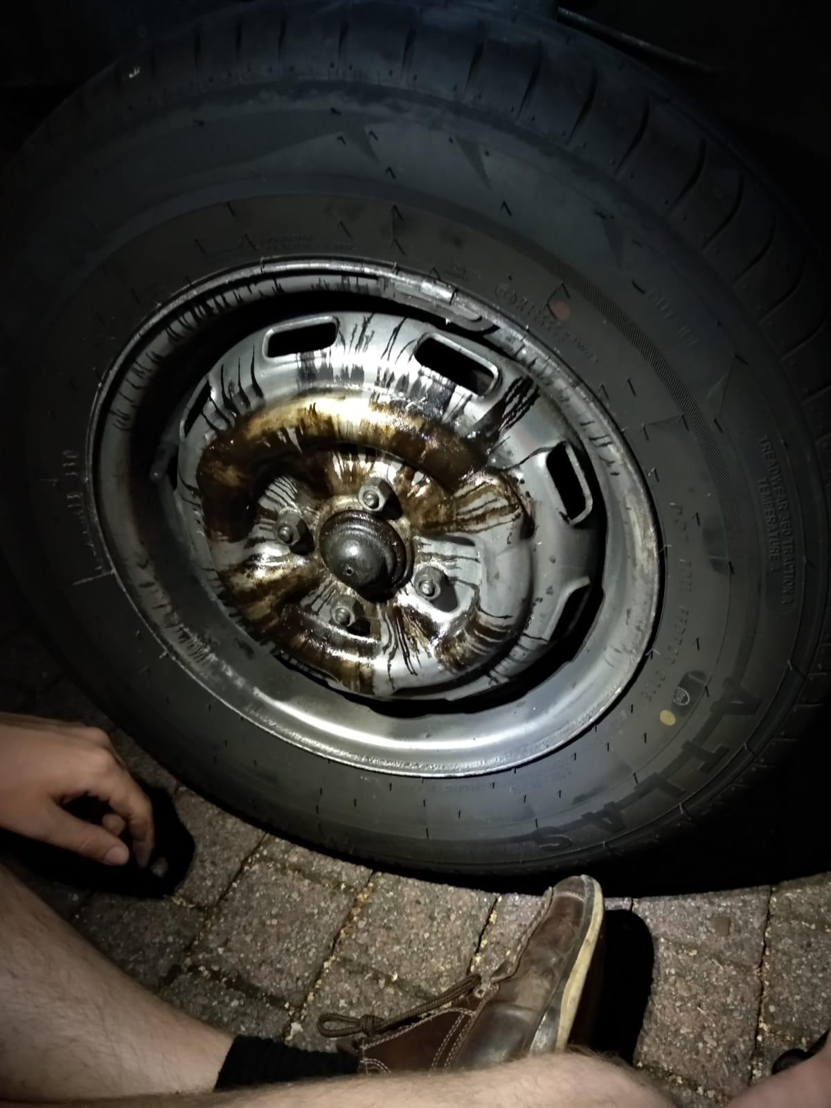

petermcpete Posted September 12, 2018 Posted September 12, 2018 Hi all,I've done something unnecessary and bought the Toledo in Italy and am currently partway through the collection caper home.In Freiburg and run into potential difficultly - the wheel bearing sounds pretty ropey. I'm planning on doing 250 miles to Spa tomorrow, is that sensible? Then on Friday 150 miles to Bruges where I'm staying for 2 nights. Video in next post of bearing.When I'm safely home I'll update with many pics, but a couple of teasers coming up. Cheers,Pete johngarty, Split_Pin, richardthestag and 9 others 12

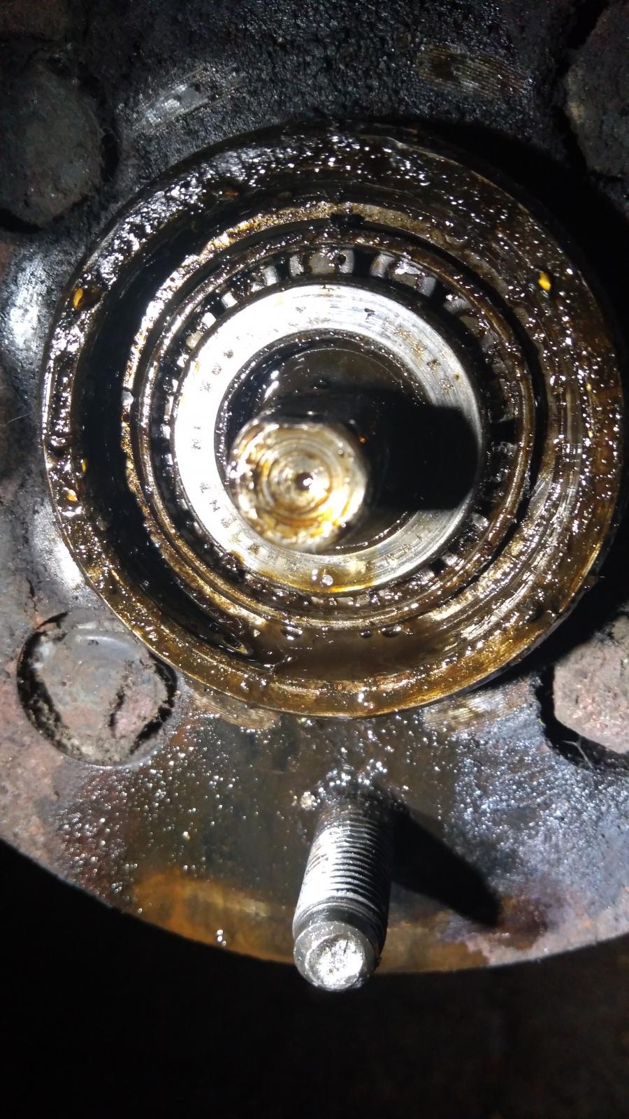

Tamworthbay Posted September 12, 2018 Posted September 12, 2018 Is the drum dragging? Looks like that has got hot and melted the grease. So first check the brakes then repack the bearing with grease and set it up, then check it every few miles. I found the ones on my Dolomite needed nipping up a bit after about 50 miles and again a bit later. purplebargeken and trigger 2
dollywobbler Posted September 12, 2018 Posted September 12, 2018 Yeah, that doesn't sound great to be honest. Can you repack it? As suggested above, looks like a sticky brake has got it too hot so all of the grease has leaked out. EDIT - and, YOU BLOODY HERO!
petermcpete Posted September 12, 2018 Author Posted September 12, 2018 HillmanImp, gm, Yoss and 29 others 32
Tamworthbay Posted September 12, 2018 Posted September 12, 2018 And if the option to get it out is there give it a damn good clean in meths or brake cleaner before repacking.
petermcpete Posted September 12, 2018 Author Posted September 12, 2018 It's front discs, on that side one of the pads is really low, almost on metal - went through the Alps yesterday which didn't help! I'll see if I can get to a position where I can repack it.
Tamworthbay Posted September 12, 2018 Posted September 12, 2018 That is probably what’s done it but make sure you don’t have a sticky piston. petermcpete 1
artdjones Posted September 12, 2018 Posted September 12, 2018 Don't do it up too tight - a little bit of play is way better than too tight.On taper rollers I usually do it up until it starts to drag,then back it off,then do it up as tight as I can with my fingers,then put the split pin in. Asimo and Squire_Dawson 2

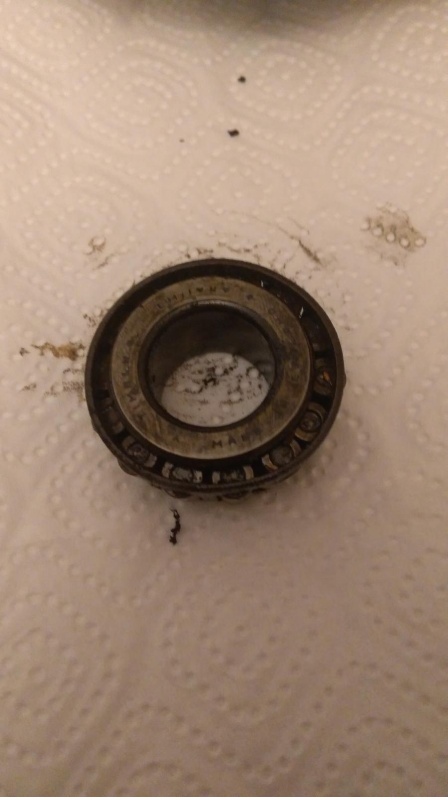

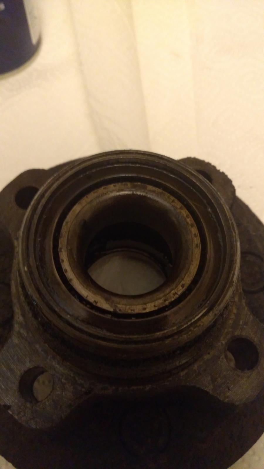

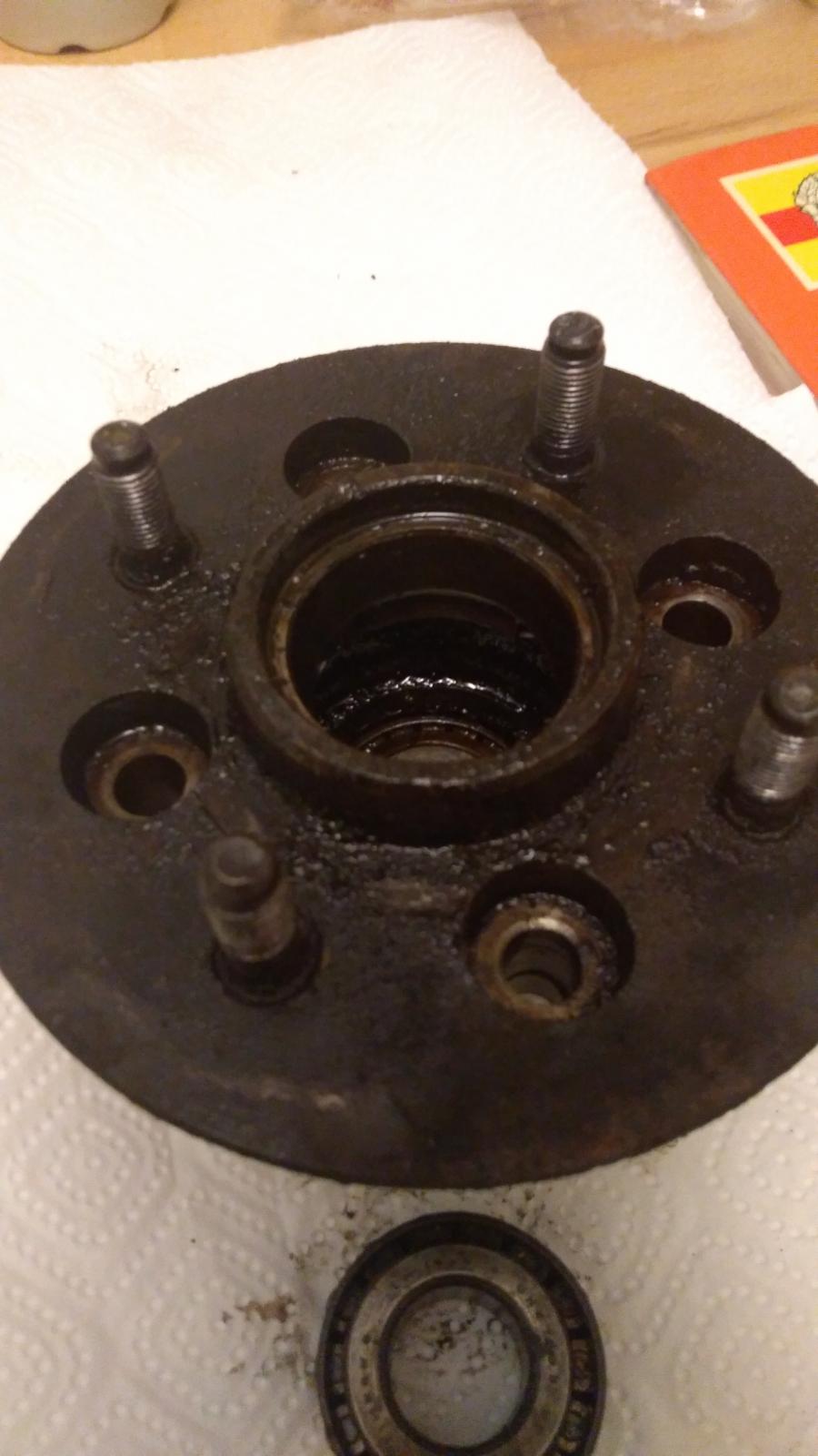

petermcpete Posted September 12, 2018 Author Posted September 12, 2018 Right,I'm doing car repairs at 10pm on the table of an AirBnB Managed to get the bearings off the car. This one sounds ropey: And this one sounds ok: Sorry for my not having a clue, what should I do now? I have wd40 to give them a clean, but no grease with me - I can go out and buy some first thing tomorrow morning though. oldcars, johngarty, Mrs6C and 6 others 9
Tamworthbay Posted September 12, 2018 Posted September 12, 2018 Whatever you do, do not run them dry. They won’t do ten miles and will lock solid. Grease is essential. In fact grease is the word. johngarty, Cavcraft, Squire_Dawson and 8 others 11

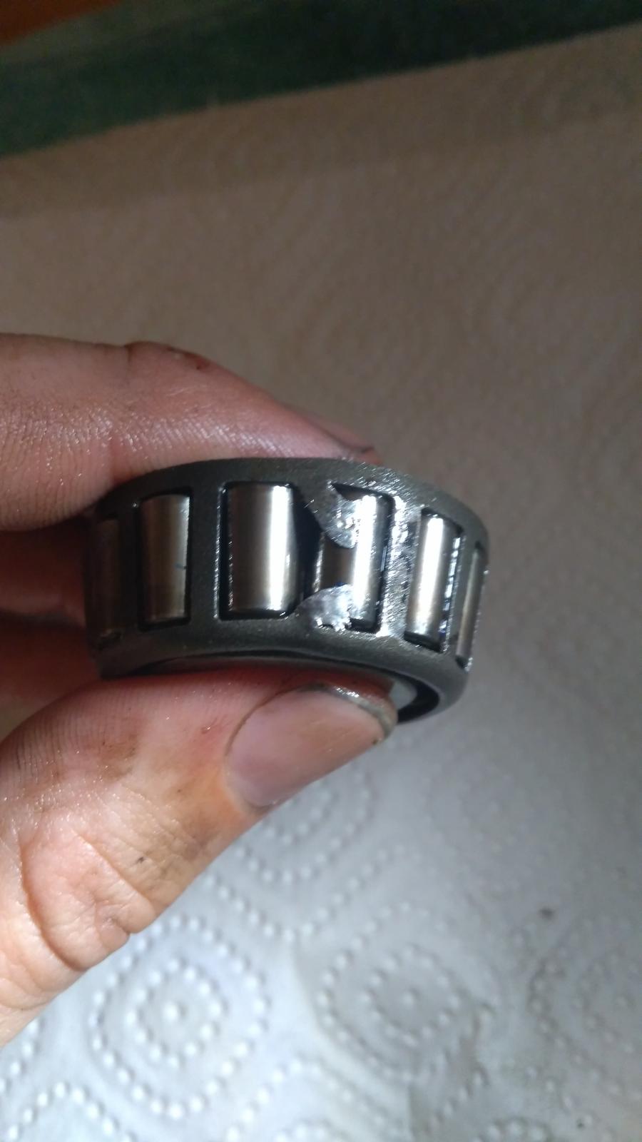

petermcpete Posted September 12, 2018 Author Posted September 12, 2018 Guessing this isn't meant to be like this? johngarty 1
Tamworthbay Posted September 12, 2018 Posted September 12, 2018 You guess correctly, that’s bad. It may hold but would be great if there is a local bearing supplier that could match it. Squire_Dawson 1
Mally Posted September 12, 2018 Posted September 12, 2018 Correct, it shouldn't look like that, but rather than risk breaking the bits off I'd stick it back in as is if I had to.Bearings have numbers stamped on them. Write the numbers down in case you can locate a stockist.Use high melting point grease, press it well into the rollers.When its assembled spin the wheel and check for side play.You should fit new parts as a supplied pair, but if the outer race looks reasonable and you are short on equipment, you could just fit a new roller unit into the old outer.I have never* done it myself though. Squire_Dawson and Scruffy Bodger 2
Tamworthbay Posted September 12, 2018 Posted September 12, 2018 Correct, it shouldn't look like that, but rather than risk breaking the bits off I'd stick it back in as is if I had to.Bearings have numbers stamped on them. Write the numbers down in case you can locate a stockist.Use high melting point grease, press it well into the rollers.When its assembled spin the wheel and check for side play.You should fit new parts as a supplied pair, but if the outer race looks reasonable and you are short on equipment, you could just fit a new roller unit into the old outer.I have never* done it myself though.I have, it’s far from ideal but as a needs must solution it works fine. Squire_Dawson 1

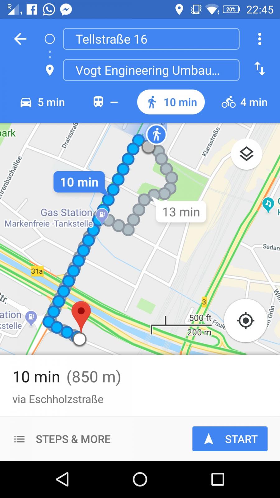

purplebargeken Posted September 12, 2018 Posted September 12, 2018 Try these people, they are old timer engineers and are in Freiburg, they mention Triumph on the website. Vogt Engineering Christian Vogt Haslacherstrasse 25 D-79115 Freiburg Phone / Fax +49 (0) 761-47999846 Mobile +49 (0) 1715317088 Mrs6C, CGSB and oldcars 3
Squire_Dawson Posted September 12, 2018 Posted September 12, 2018 Yes, packing with grease is absolutely vital. I don't know if these bearings are meant to be pre-loaded, but nip up the retaining nut with a spanner, so its pressed home, slacken off and hand tighten. Presumably there is a retainer with split pin? Jack it up and try to wobble the wheel about with your hands - you'll know if its gone. But make absolutely sure its swimming in grease before fitting. Tamworthbay 1
petermcpete Posted September 12, 2018 Author Posted September 12, 2018 Try these people, they are old timer engineers and are in Freiburg, they mention Triumph on the website. Vogt Engineering Christian Vogt Haslacherstrasse 25 D-79115 Freiburg Phone / Fax +49 (0) 761-47999846 Mobile +49 (0) 1715317088 Amazing!!! 850m from where I'm staying. Fingers crossed they have the part. michael t, Stanky, wuvvum and 14 others 17
purplebargeken Posted September 12, 2018 Posted September 12, 2018 Damn, I'm goooooood! lol Hope they can help mate. The Tolly looks ace oldcars, Christine and Tamworthbay 3
