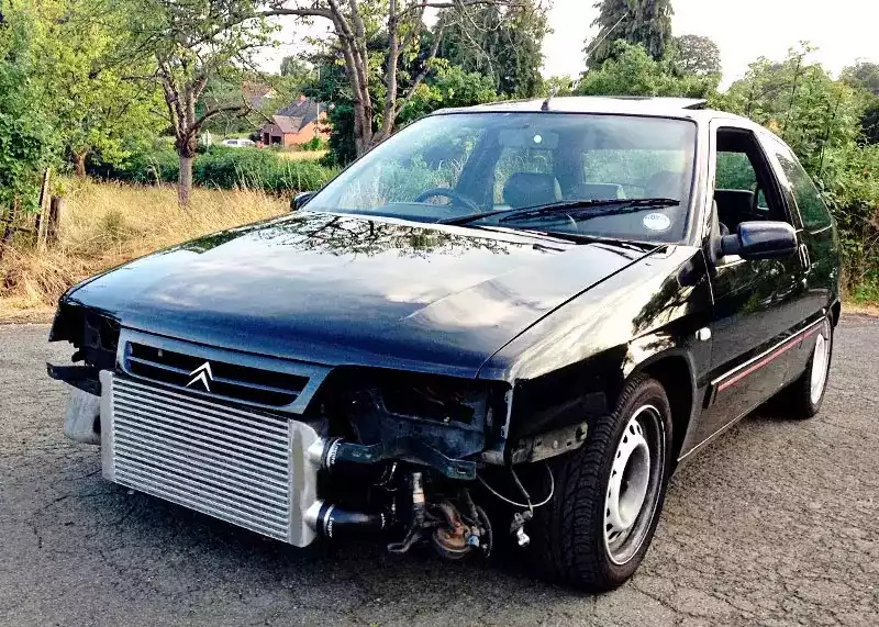

Scruffy Bodger Posted September 11, 2018 Posted September 11, 2018 That's a proper bonus. Maybe just fudge it through the MOT then? My mate owns that, it's circa 237bhp & 327 ft/lbs, it smokes a bit on boost as you might imagine. He simply adjusts the maximum fuel screw on the side of the pump to get it through the test leaning it right out. It won't hurt the engine, too much fuel is what damages dervs. Lacquer Peel, The Moog, Tepper and 2 others 5
Matty Posted September 11, 2018 Posted September 11, 2018 That's a proper bonus. Maybe just fudge it through the MOT then? My mate owns that, it's circa 237bhp & 327 ft/lbs, it smokes a bit on boost as you might imagine. He simply adjusts the maximum fuel screw on the side of the pump to get it through the test leaning it right out. It won't hurt the engine, too much fuel is what damages dervs.In love
beko1987 Posted September 11, 2018 Posted September 11, 2018 My xantia had to me massively de tuned to pass the smoke test, I can also confirm that neat veg smokes like a twat if the pumps been fiddled with. You could also turn the fuel screw in (or out, I can't remember) to weaken the mix, limp it to the test with no power, pass then put it back... Just foot to the floor it to test, I got a proper black mushroom cloud out of the back before arthur_foxhake twiddled it Scruffy Bodger 1
Guest Hooli Posted September 11, 2018 Posted September 11, 2018 It's out for less power if memory serves from tweaking a Tdi Landy years ago.
Scruffy Bodger Posted September 12, 2018 Posted September 12, 2018 In love Quaife ATB, forged H section rods, blue printed, head ported and flowed with flow bench results to prove gains, Dieselmeken Pump, paddle clutch etc, You are not alone. Hooli is indeed correct if yo want to lean it out. https://www.306oc.co.uk/forum/printthread.php?tid=145 Lacquer Peel, Sigmund Fraud and Matty 3
