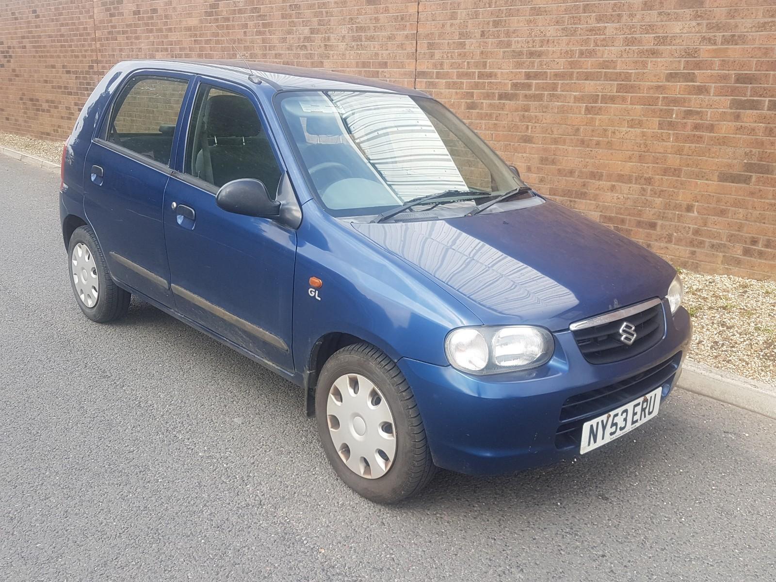

114000 miles,plenty dents,1 mths ish mot, all for the lovely sum of £30,radio knackered are swapped out,runs like kangeroo,misfires all over,eml light on,so worth the risk,!!!

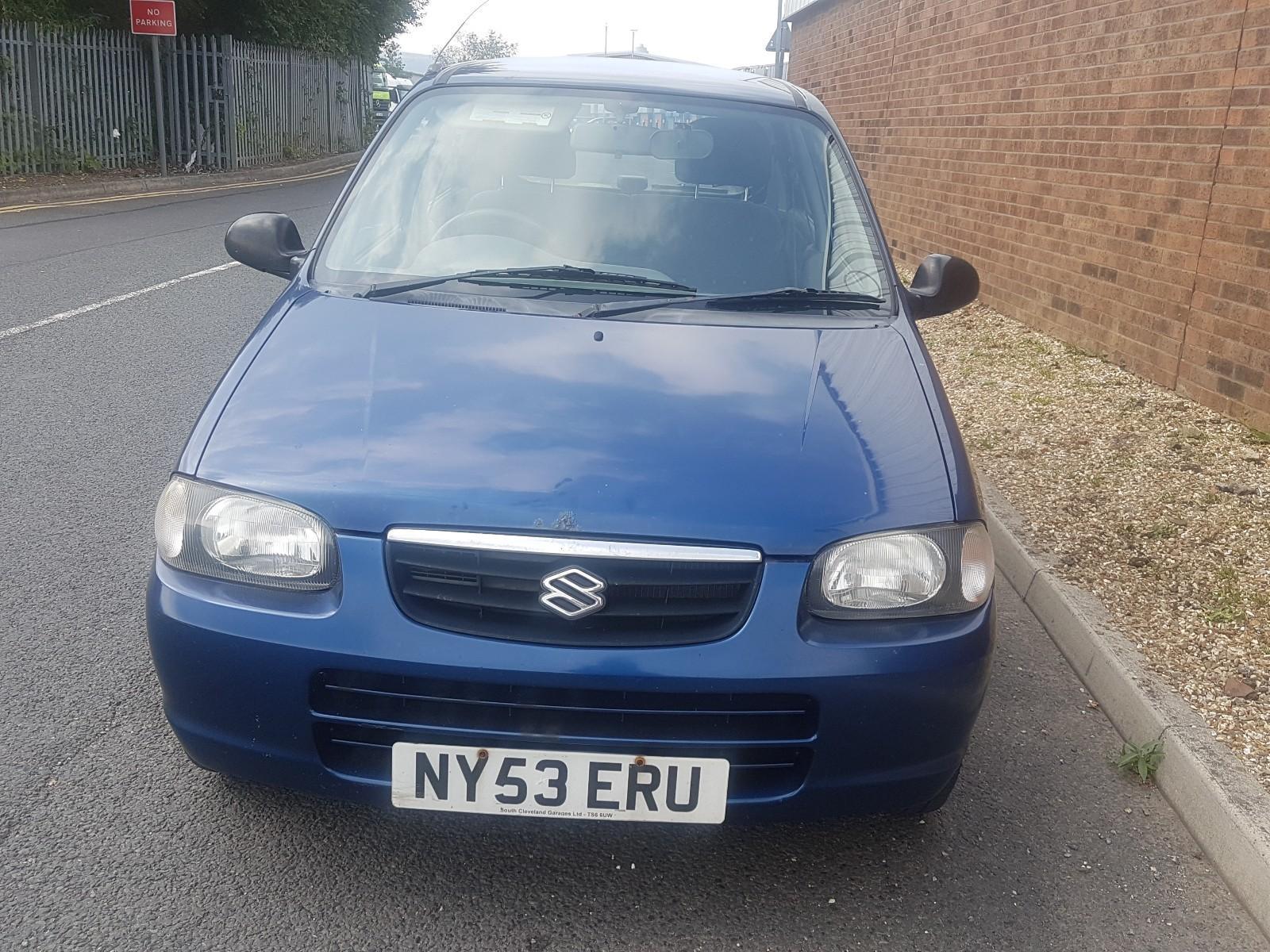

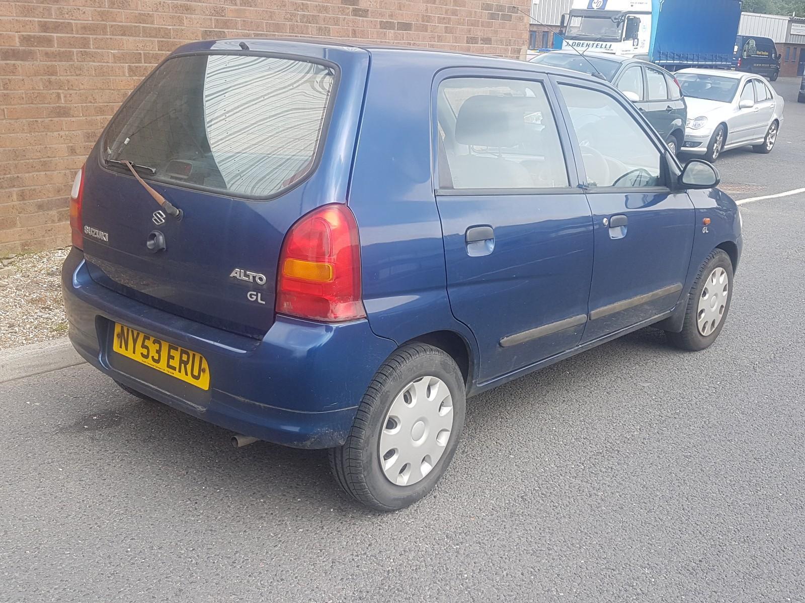

back from sunny blackburn,the pictures do flatter it abit, only £30 squid year to tax,now done,was untaxed since july,than sat on driveway,went to ace motorspares,cheapo oil,blackwaxoil,brushes from poundland,2 wirebrushes for 50p.will plug in code reader soon,
This has exceeded my expectations. Nice little shed, that.
There's nowt wrong with that, £30 ffs.

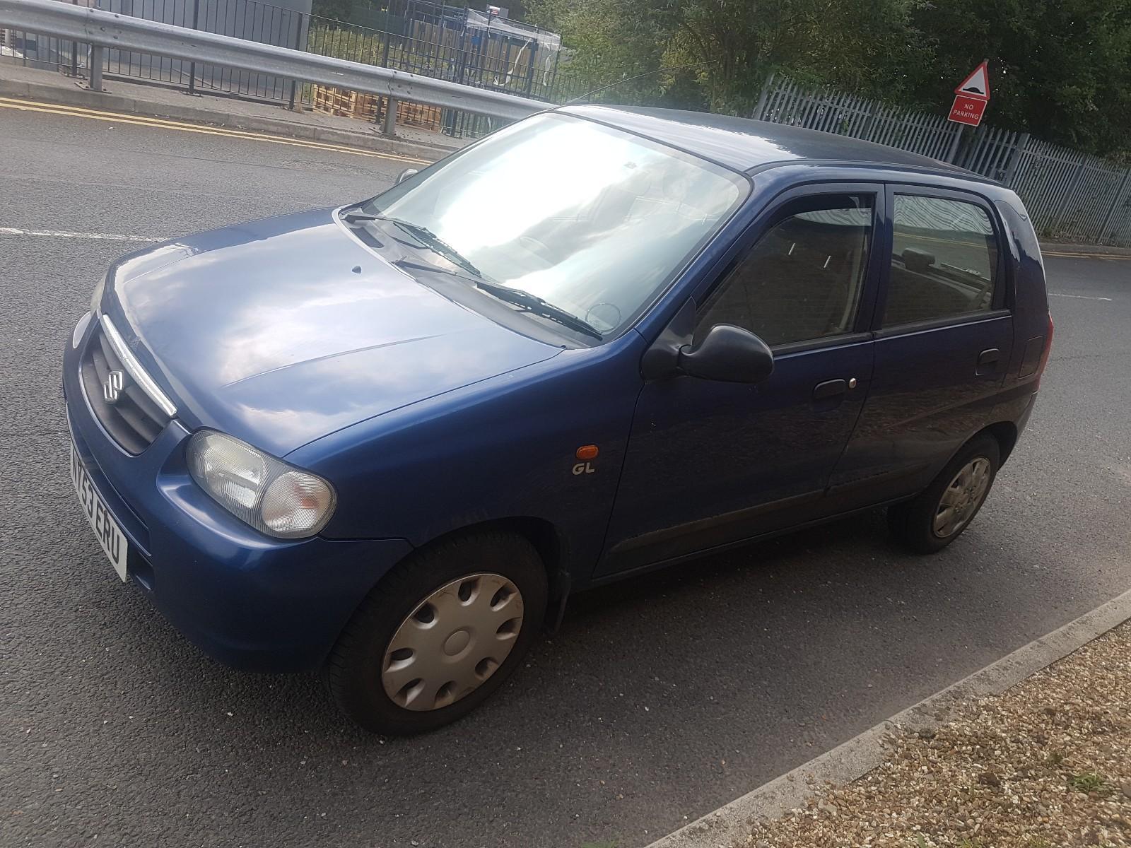

eml light,2 code showing,misfire on 4,etc,bought new set sparkies,one plug leads was broken,easy fix got a old lucas lead cleared codes,took for drive,all fixed,no misfire,no light back on, :-D :-D
