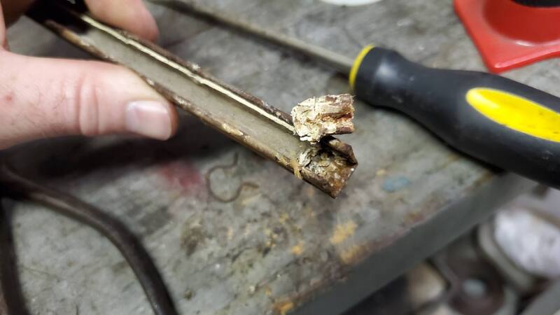

Liberated the driver's front sash channel tonight.
Is that household window putty I spy? Yes it is. Front glass channel is missing, the glad was done up into the metal fixings and broke from there. Marvellous. Now I gotta find one of those to fit, new glass and probably a new top/rear glass channel.
The rubber doohickey that grabs the glass into the sash channel is available new.
Phil
Wire wheel and fire and paint. Straightened it out too because it was bent on one end.

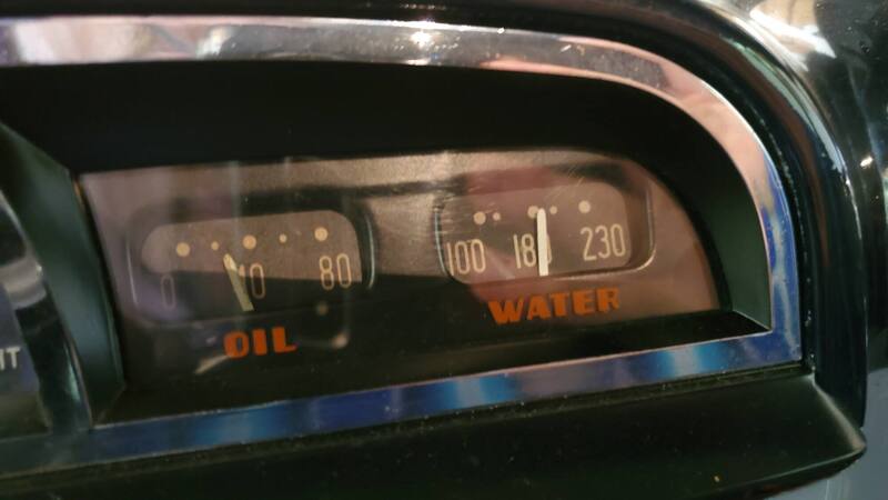

Installed board.
Got engine warm.
Calibrated gauge.
That's better.
Phil

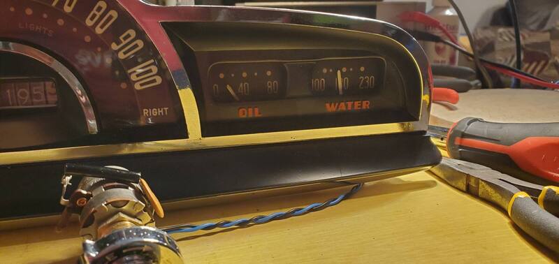

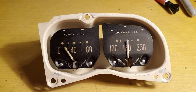

This afternoon I did this.
Because the temperature gauge was getting stuck in the middle like that, and wasn't moving smoothly. It needed a thump on the dash to make move. The oil pressure gauge was reading just above zero also when disconnected and that irked me so I adjusted that.
Little bit of light oil on the moving parts.
Turns out the gauge was good when removed but once tightened up into the bucket was twisting a tiny amount and making the needle bind. With it tightened down I carefully bent the armature and now it moves nicely. It's lost the gooey damping oil effect to a degree but I'll buy a slightly wobbly gauge over one that doesn't move.
Better. Doesn't get stuck any more.

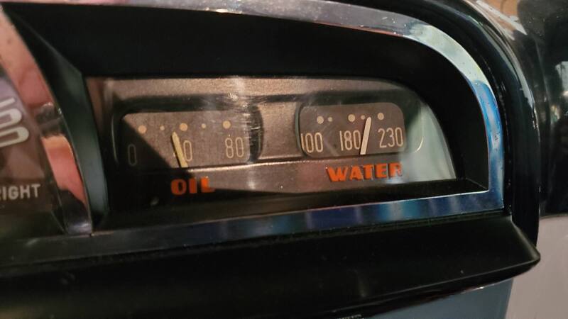

Put it all back in.
Got it running.
Up to running temperature.
That'll work.
Phil
