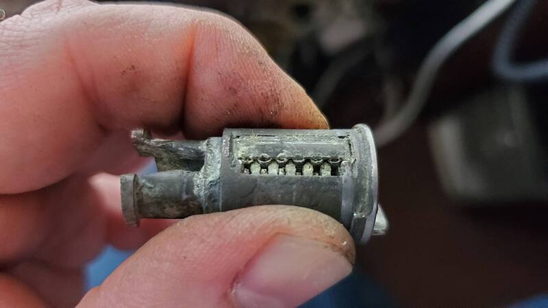

PhilA Posted June 29, 2020 Author Posted June 29, 2020 Ok. Chieftain time! Recall a while back, I dropped the keys in the parking lot at the store and someone pinched them rather than turn them in? Decided today to remedy that. So, I pulled the lock barrel out of the trunk lid. Using nothing other than what is in that picture (.0015 feeler gauge, bent paper clip, pliers) I picked the lock and disassembled it. Books say that the side bar style of lock cannot be picked with regular tools. It can but it's not that easy. Anyhow. With it all pulled apart I was able to get the "code" of the lock. There are only 4 height steps on these barrels so I am going to go to the hardware store later and see if they have the correct blanks, buy a couple and see if I can file my own keys to make the lock work. Lock picking does give a certain sense of achievement and is moderately therapeutic. Certainly a fun puzzle. Phil Tickman, mat_the_cat, loserone and 7 others 10

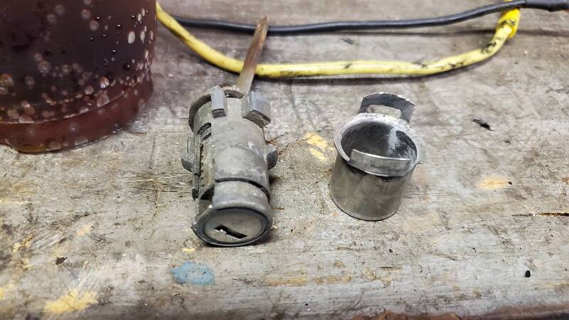

PhilA Posted June 29, 2020 Author Posted June 29, 2020 First lock I've ever tried to pick. Bought a blank. Marked it up to depth. Filed it down. Cleaned and lubricated the lock, reassembled it. Now I have a key for the trunk and the glove box again. I'll get a spare cut from it. Next up, I'll remove the door handles and find out what key blank they take- looks to be a much later shape, 80's truck. I'll try cut a key for that then I'll be able to operate the locks. That'll be nice. Total outlay for today $2. Phil DeeJay, LightBulbFun, paulplom and 6 others 9

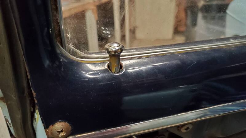

PhilA Posted July 1, 2020 Author Posted July 1, 2020 I reassembled the door lock (funny, discovered after the fact you can pull the handle off without taking the door card off), I need a new rubber O-ring for inside the handle. The old one fell apart. It serves two purposes. First, it stops the button going CLACK if it's released hard, second it positions the lock mechanism to engage properly with the barrel. Right now I have to push the button in slightly to get the door to lock and unlock, but the driver's side works properly. I will pull the door card off the passenger side, remove the button rod and copy it for the driver's side. Phil LightBulbFun 1

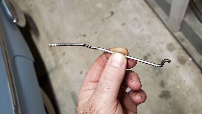

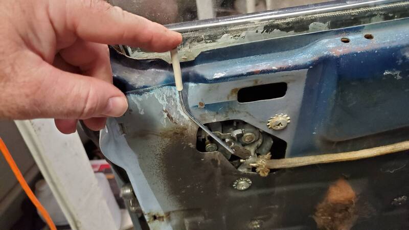

PhilA Posted July 2, 2020 Author Posted July 2, 2020 Decided to wing it, so I went liberated a plastic coat hanger with a metal hanging hook because it looked about the right diameter and length. Heated it and bent it to shape. Added a piece of insulation off a wire to bring the diameter up and give the pin something to grab on to. Unlocked Locked That'll work. Phil GrumpiusMaximus, adw1977, egg and 12 others 15

PhilA Posted July 2, 2020 Author Posted July 2, 2020 Pulled the handle off and put an o-ring on the base of the button. It now locks and unlocks well and doesn't rattle. Phil mercedade and LightBulbFun 2

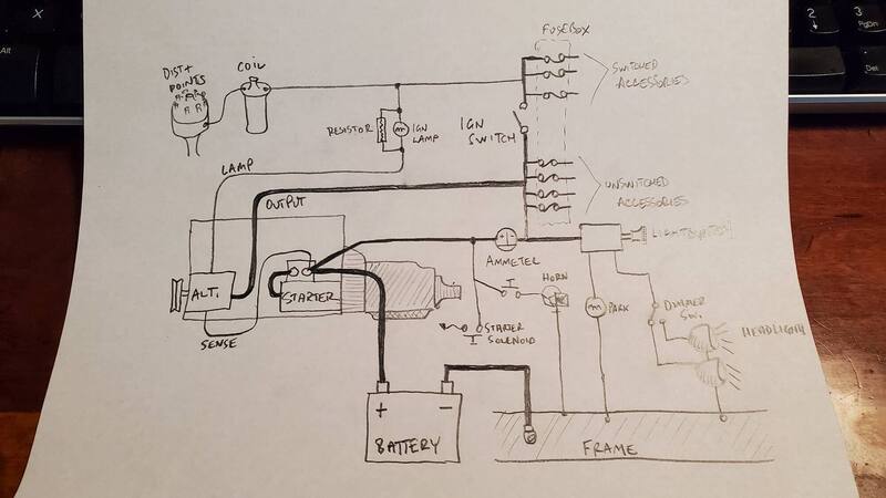

PhilA Posted July 3, 2020 Author Posted July 3, 2020 Had a little time today so started on the wiring again. Got the alternator primary run through and terminated. Ran the primary from the fuse block up to the group terminal on the light switch- marked the outside of the wire where to cut by scoring it with my thumb nail. Got up out of the car, went get my big wire cutters, crimped the end on then found it about 4" too short. I cut the wrong mark! Argh. So, I need to go get a few more feet of wire and a couple more connectors. Not the end of the world, for sure. Phil paulplom 1

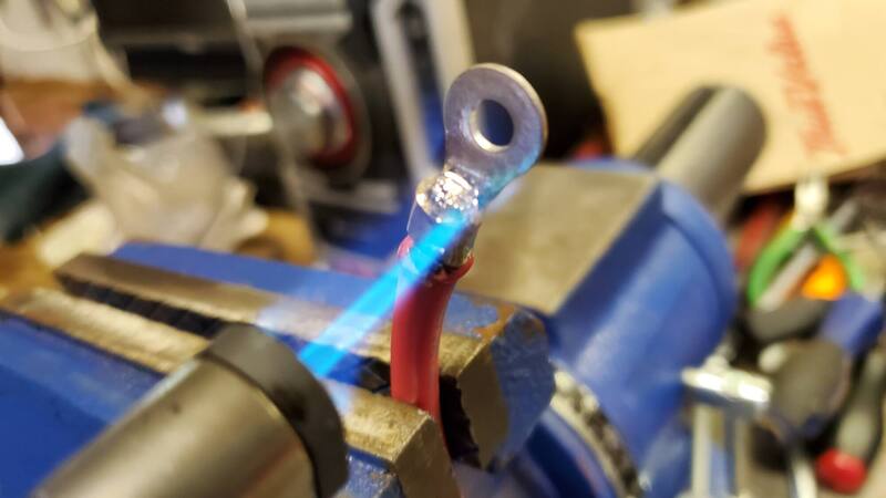

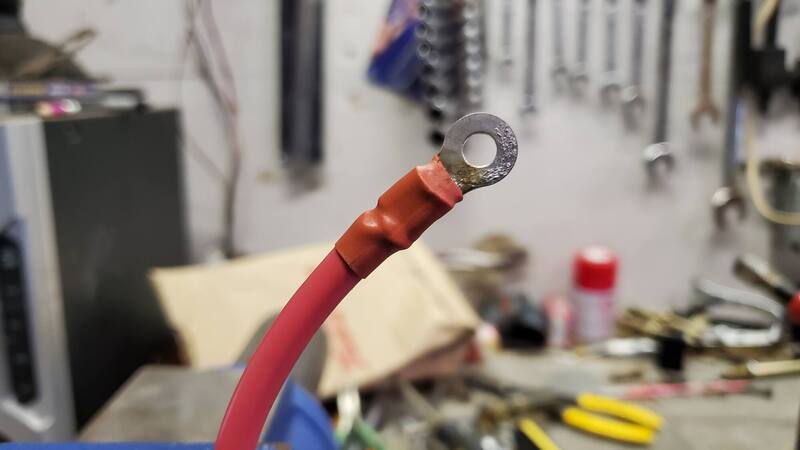

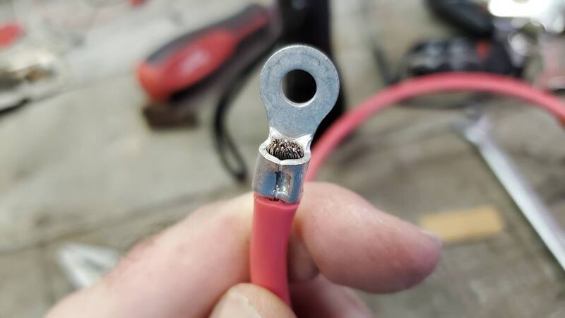

PhilA Posted July 5, 2020 Author Posted July 5, 2020 Today there was quite a lot of this. Decided to double up and solder the connections. Covered up with heat shrink. Why? Now the charging system is up to spec with the correct gauge wiring for the updated alternator. I also put a heavy shunt across the ammeter connections, so that roughly halved the current through it, meaning on a discharged battery revving the engine doesn't cause the meter to peg out any more. I'm happy about that, it was a concern it'd run too hot. Most of the time there's not going to be much current going through it because the alternator can provide 60+ Amps, with everything electrical switched on the draw is about 30 Amps- the original dynamo was good for 30A which was a bit underspecced to be honest. With everything on (lights, radio, fan) there would have been nothing left to charge the battery. This alternator changes that but the original system wasn't up to it. But, with exception of redoing the ignition wire from the switch not the fuse box and terminating the wire for the under-hood light the rewire is done. I'll then loom it up and call that part complete. Phil somewhatfoolish, mercedade, GrumpiusMaximus and 2 others 5
