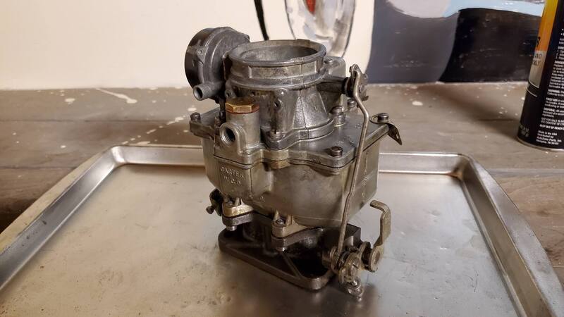

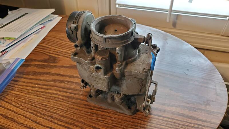

PhilA Posted April 7, 2020 Author Posted April 7, 2020 Low mileage carburetor. Cleaning time begins! Phil scdan4, LightBulbFun, BlankFrank and 2 others 5

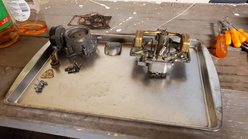

PhilA Posted April 8, 2020 Author Posted April 8, 2020 It's made from lots of little pieces. Phil scdan4 and LightBulbFun 2
hairnet Posted April 8, 2020 Posted April 8, 2020 do you have an ultrasonic or have ya a toothbrush and some cleaner?
PhilA Posted April 8, 2020 Author Posted April 8, 2020 46 minutes ago, hairnet said: do you have an ultrasonic or have ya a toothbrush and some cleaner? Ultrasonic bath and a brush!
PhilA Posted April 9, 2020 Author Posted April 9, 2020 Came up ok. scdan4, egg, Skizzer and 4 others 7
PhilA Posted April 13, 2020 Author Posted April 13, 2020 Bolted in place. Runs well. This one's better. Phil paulplom, DeeJay, Uncle Jimmy and 9 others 12

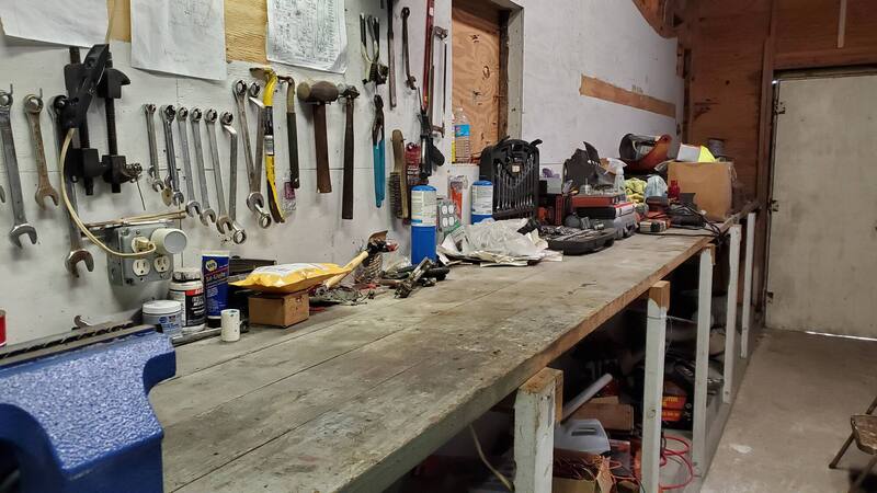

PhilA Posted May 14, 2020 Author Posted May 14, 2020 OMG clean workbench Can't stay like that Better. Chieftain radio. Phil LightBulbFun, Skizzer, Tepper and 1 other 4
