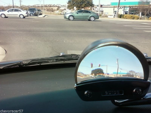

paulplom Posted January 17, 2020 Posted January 17, 2020 What's that metal, crescent shaped thing on top of the dash binnacle?
PhilA Posted January 17, 2020 Author Posted January 17, 2020 14 minutes ago, paulplom said: What's that metal, crescent shaped thing on top of the dash binnacle? That's a traffic light lens. From the driver's seat, with the sun visor fitted to the outside of the car it becomes very difficult to see overhead traffic lights (the norm here) without leaning forward a long way. The lens gives a very wide upward view, allowing traffic lights to be seen from a regular seated driving position. As above (library picture) Phil spartacus, LightBulbFun, tooSavvy and 9 others 7 5

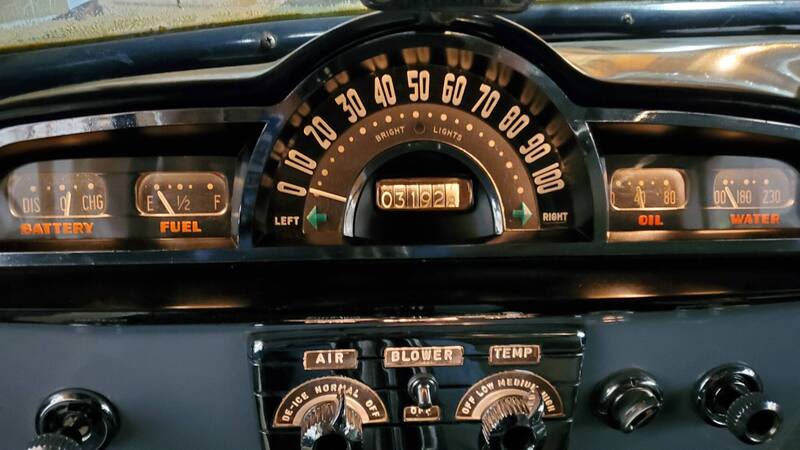

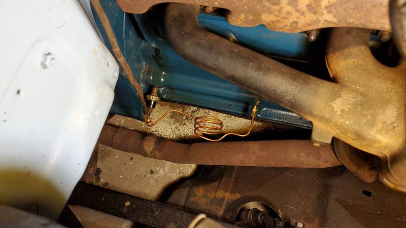

PhilA Posted January 19, 2020 Author Posted January 19, 2020 Bought some tube and fittings. Hooked up the oil pressure line to the gauge. Needs a couple P clips to hold it in place. Now all my gauges work. Phil Zelandeth, RayMK, mat_the_cat and 7 others 10

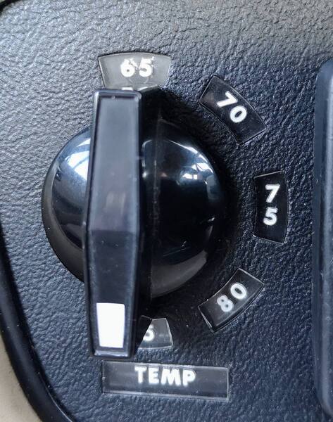

Zelandeth Posted January 19, 2020 Posted January 19, 2020 Interesting to see that (while the actual illumination source is different) that your heater/ventilation controls use the same sort of "floating" illuminated text as Jag did for the HVAC and ancillary controls in the XJS (and early XJ6/12 I think). Yours are lit rather more usefully though! LightBulbFun 1
PhilA Posted January 19, 2020 Author Posted January 19, 2020 18 minutes ago, Zelandeth said: Interesting to see that (while the actual illumination source is different) that your heater/ventilation controls use the same sort of "floating" illuminated text Yes. A single 3 watt bulb that illuminates a sheet of acrylic mostly edge-on, with the words cast in to the sheet, and the backs painted black and the text painted white. The principle is sound and still used today, though nice thick plastic makes it look "jeweled", which is really pleasing to look at both illuminated internally and from an external light source. Phil LightBulbFun 1
