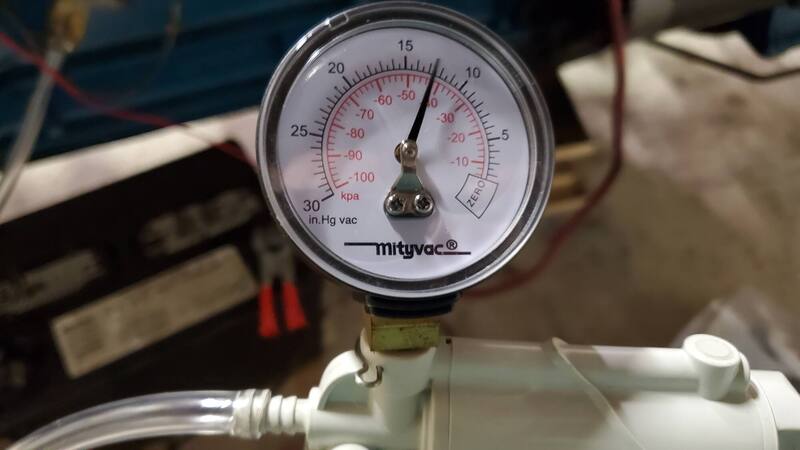

PhilA Posted September 30, 2019 Author Posted September 30, 2019 Last night I dug out my little hand pump vacuum and went to test the distributor advance mechanism. At first glance the diaphragm is good because it'll take and hold a decent vacuum. But, it didn't move. Oh. That might be why. Let's unhook the vacuum arm from the condenser clip. No bueno. Took the vacuum unit off and tested it- moved nicely. Pulled the condenser off to get it out of the way... Some cretin has used a screw there's about 1/2" too long and has bent the plate up and jammed it against the mechanism below. Attacked the screw with a hacksaw and bent the plate back. Free to move but the maximum vacuum advance makes the engine run like crap so that may need to be adjusted- someone's already been in there and has bent the stopper tab (that limits the amount of advance available) so that may need to be fettled a little. It was working well enough with no vacuum advance so limiting that should help it not be lumpy at light throttle. Phil somewhatfoolish, LightBulbFun, RayMK and 5 others 8
