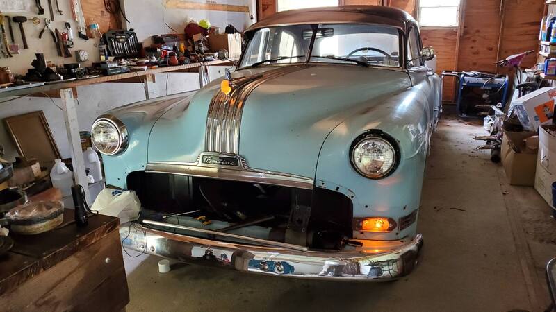

PhilA Posted August 27, 2019 Author Posted August 27, 2019 Started out today by disassembling the old fuse holder and redoing the wiring and solder cups that contact the fuse. A couple of the interior lights had eyelets in the bases as contacts. These are easy to unsolder and add new wire. Takes a bit of time but it's worth it. One lamp, with significantly less chance of conflagration. This one is operated by pulling the ash tray out and illuminates the floor. More in-depth wiring then occurred. Switch on parking lights, get parking lights Switch on headlights, get headlights. Also, chief. This is all slightly more complicated than it should be because the parking lights go off when the headlights come on; that's an age thing in terms of function. However, the chief is technically on the tail light circuit so that has to be brought up to the front of the car.. additional complication. Tail lights also work, which is a bonus. Tomorrow, rear lights and turn signals. The switch is complicated and has 6 wires, which I need to trace out. Phil LightBulbFun, TripleRich, busmansholiday and 12 others 15

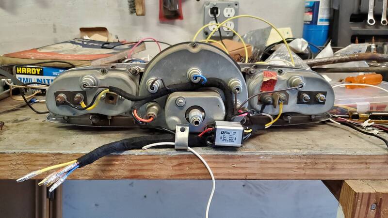

PhilA Posted August 31, 2019 Author Posted August 31, 2019 To take my mind off other things for a while, I rebuilt the wiring harness for the dash gauges. Extra special bonus, it all works. Phil mat_the_cat, Dan_ZTT, Sudsprint and 12 others 15

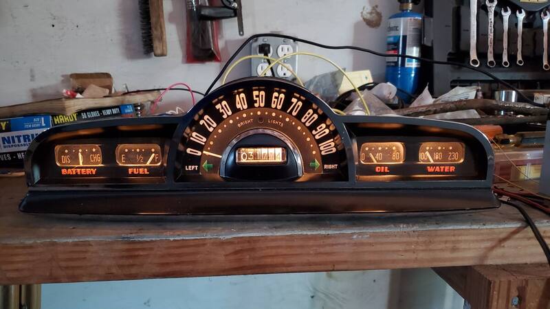

PhilA Posted September 1, 2019 Author Posted September 1, 2019 Test fit. Ammeter registers a discharge with the lights on, turn signal and high beam telltales work, dash dimmer kinda sorta does its thing, gearshift light works and even the gas gauge shows me the tank isn't completely empty. Phil busmansholiday, Skizzer, Yoss and 12 others 15
mercedade Posted September 2, 2019 Posted September 2, 2019 I know it's small potatoes in the grand scheme of this marvellous thread, but I love that dash so much. The font for the labels on the gauges looks like something Batman should be driving. Joey spud, LightBulbFun, Skizzer and 2 others 5

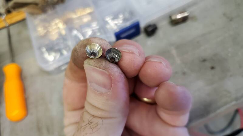

PhilA Posted September 6, 2019 Author Posted September 6, 2019 Started in on the heater panel. Lower bezel, all rather dirty. Cleaned up real nice. Removed the upper heater bezel. Out of the car it looks filthy. Cleaned up the switch and removed the old wires. Scrubbed the grooves. Through years of dirt and metal polish some black paint became visible. It all came up looking nice though. Next up I added some wires with some connectors to a little warning light. Years ago someone had drilled a hole under the dash. I fitted the lamp socket into the hole, which was a reasonably good fit. Lamp itself doesn't look too much out of place and is tucked away but still visible when you're driving. Hopefully a little more tonight Phil mercedade, LightBulbFun, somewhatfoolish and 8 others 11
