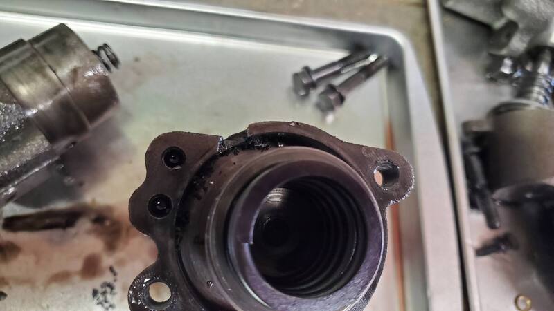

PhilA Posted August 11, 2019 Author Posted August 11, 2019 Root cause of the failure of the gearbox. A nice cascade failure; this spring failed, tension on the front band was lost, the band slipped causing the clutch to slip, heating the clutch, which heated the bearings causing them to fail. Had to add to my toolbox today. Big screwdriver. Why? Slotted head screws to hold the front oil pump together. WTG GM. Even so I had to saw out one and drill out another. Still, got it apart, cleaned all the crap out of it and de-burred the pressure relief valve so it now moves smoothly. Phil LabRat, Skizzer, Amishtat and 5 others 8

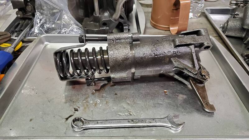

PhilA Posted August 11, 2019 Author Posted August 11, 2019 Trying to move forward, got a lot to go yet. Another hallmark day though. First new parts going back onto the gearbox. Two oil control rings first, for the inside and outside of the fluid coupling housing. Used the old seal to knock the new one in. Looking better, that's the part there that was leaking like a sieve before. Next up, rear servo. Not liking the look of that spring. Phil mercedade, stonedagain, scdan4 and 5 others 8
Zelandeth Posted August 12, 2019 Posted August 12, 2019 That spring does look rather lively. Hopefully you won't end up with a servo shaped hole in your garage roof... stonedagain and LightBulbFun 1 1

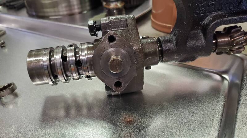

PhilA Posted August 12, 2019 Author Posted August 12, 2019 That's my worry. The manual is remarkably vague about taking it apart, too. Big new screwdriver allowed me to undo the large plug on the side of the front servo. Inside is this shuttle valve; it acts as a plug to the servo bore until the 4-3 downshift is activated, when it moves along and dumps the pressure from the servo, causing the downshift. It wouldn't have worked, the thing was stuck firm. It took five minutes of persuading it against the bench for it to begin to move. It now slides freely in the bore and even the spring clip locates correctly in the hole in the other side of the piston. All back together, awaiting spring. Rear servo and reverse mechanism to go. Phil LightBulbFun, stonedagain, mercedade and 7 others 10

PhilA Posted August 13, 2019 Author Posted August 13, 2019 Careful use of muscle and clamps saw this undone without sending any part of it into orbit. That spring is as strong as it looks. It also has plenty of friends inside helping to push everything apart. That and enough in the way of metal shavings inside to make a 1:32 scale model of the gearbox. Thoroughly cleaned, the 4 moving parts (all spring loaded) aligned and piston rings located without breaking any. Torqued up and ready to go. This one I liked doing. It's the only part so far that's not cost me any money. Phil Burnside, mercedade, Tickman and 4 others 7

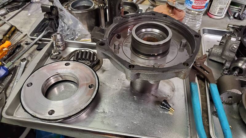

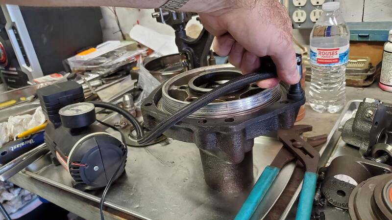

PhilA Posted August 17, 2019 Author Posted August 17, 2019 I made Special Tool J-4670 out of some bolts and plywood. Made an attachment for the air line out of a tire valve, trimmed it flat. Tried with my little air compressor. That just blew bubbles. Employed bigger air compressor, win! That represents the last piece to disassemble. It's all reassembly from here on in (barring taking old bearings out). Phil DeeJay, DSdriver, Tickman and 8 others 11
