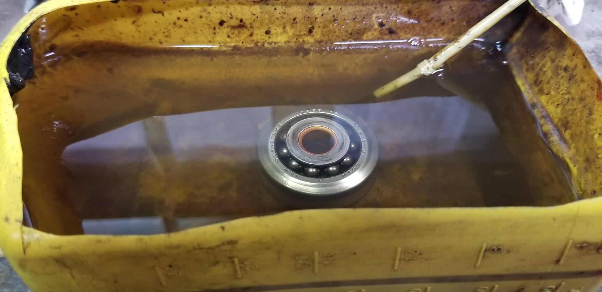

PhilA Posted June 1, 2019 Author Posted June 1, 2019 I split the wormwheel from the cross-shaft tonight. Not in overall bad shape, thankfully. Cleaned it out in gasoline. All the old grease dissolved out. Reassembled it and tweaked it up a little, which has removed most of the slack. Still need to add thread lock and peen the nut on. Cleaned a lot of the old grease out of the steering box. Going to work on the rest later. Scrubbed the lid down and painted it to stop it rusting. That's all for tonight. Phil Sigmund Fraud, Scruffy Bodger, scdan4 and 7 others 10

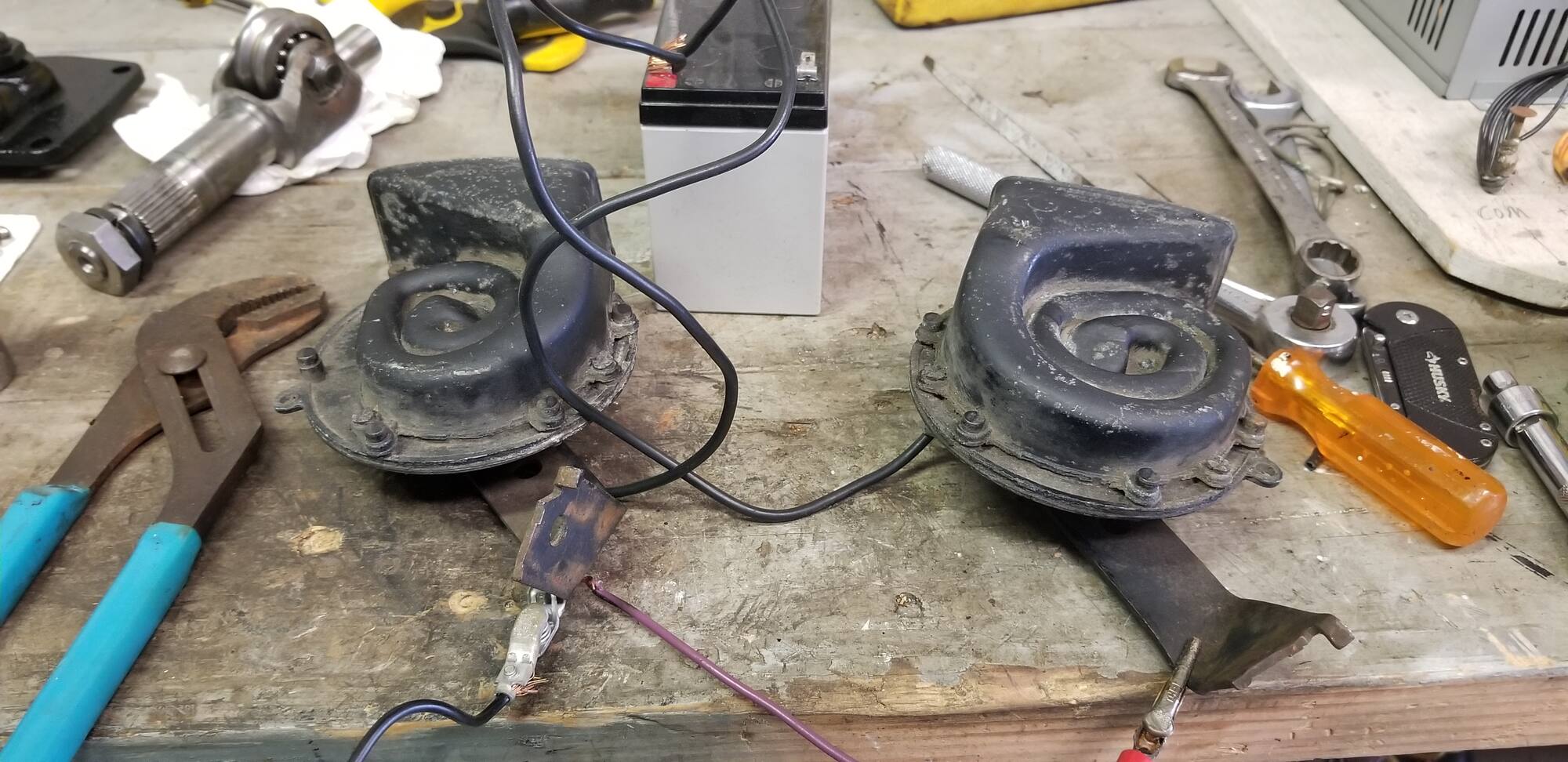

PhilA Posted June 3, 2019 Author Posted June 3, 2019 Oh my. Somebody has given me the horn. That is, a pair of Delco horns arrived in a box today... Phil The Moog and LightBulbFun 2
hairnet Posted June 3, 2019 Posted June 3, 2019 shouldnt the car do that PhilA, LightBulbFun and Scruffy Bodger 2 1
somewhatfoolish Posted June 3, 2019 Posted June 3, 2019 Meep meep! Mopar did get Delco or whoever to make a horn that made that noise specially for the Roadrunner.
PhilA Posted June 3, 2019 Author Posted June 3, 2019 The funny thing is, the Road Runner horn was more like the cheap horns fitted to small cars today- that have a harsh BEEP (think mk1 Ford Fiesta) rather than the traditional long-trumpet parp noise horns made at the time. --Phil somewhatfoolish and tooSavvy 2
PhilA Posted June 3, 2019 Author Posted June 3, 2019 With a little tweak, they now work (one was kinda rattling, the other let out a feeble gargling buzz). Hot damn are they loud. I need to make some new brackets for them to allow them to fit but they sound the part! Many thanks, the horn push will be known as the hairnet button now. Phil jumpingjehovahs, somewhatfoolish, LightBulbFun and 7 others 9 1

PhilA Posted June 4, 2019 Author Posted June 4, 2019 Took it without him knowing. Yes, the things are particularly loud- that was them facing away from me. I made the kids run away "Here, come here, listen to this..." --Phil hairnet 1

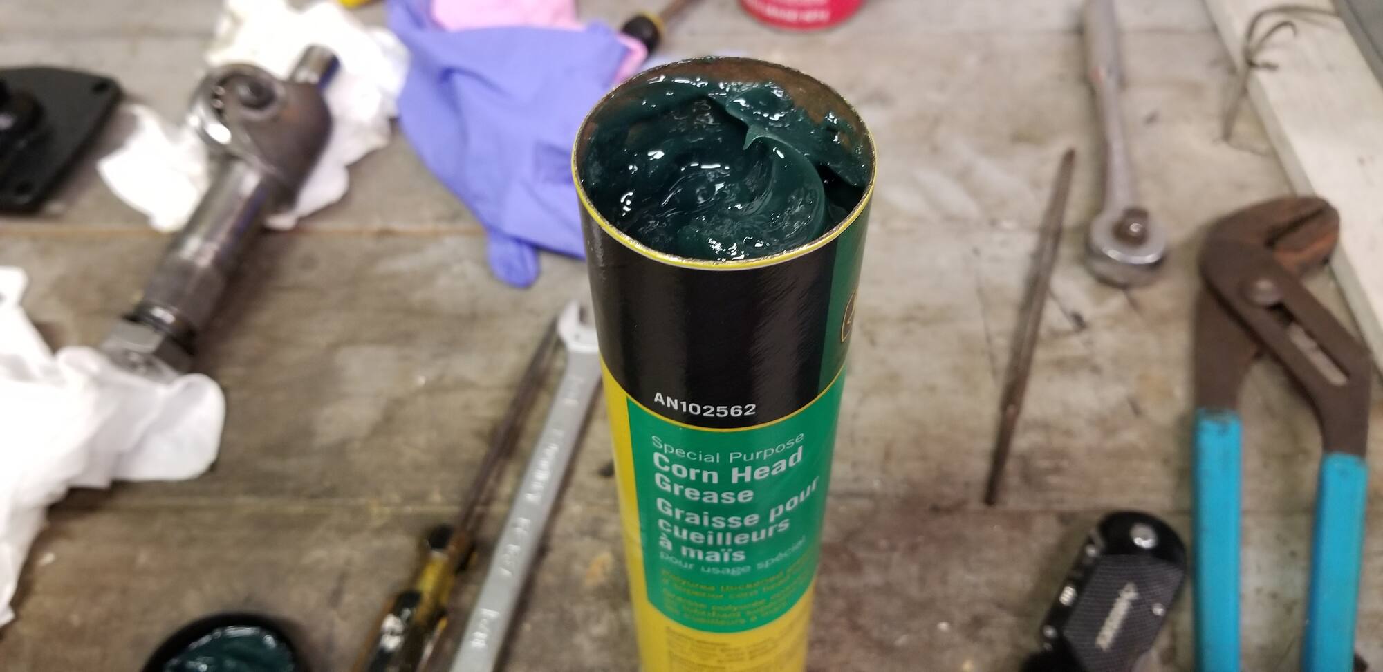

PhilA Posted June 7, 2019 Author Posted June 7, 2019 Ordered some grease for the steering box. Next up is to finish cleaning the old stuff out, then it can all go back together and be painted. There's not enough hours in the day! --Phil LightBulbFun 1

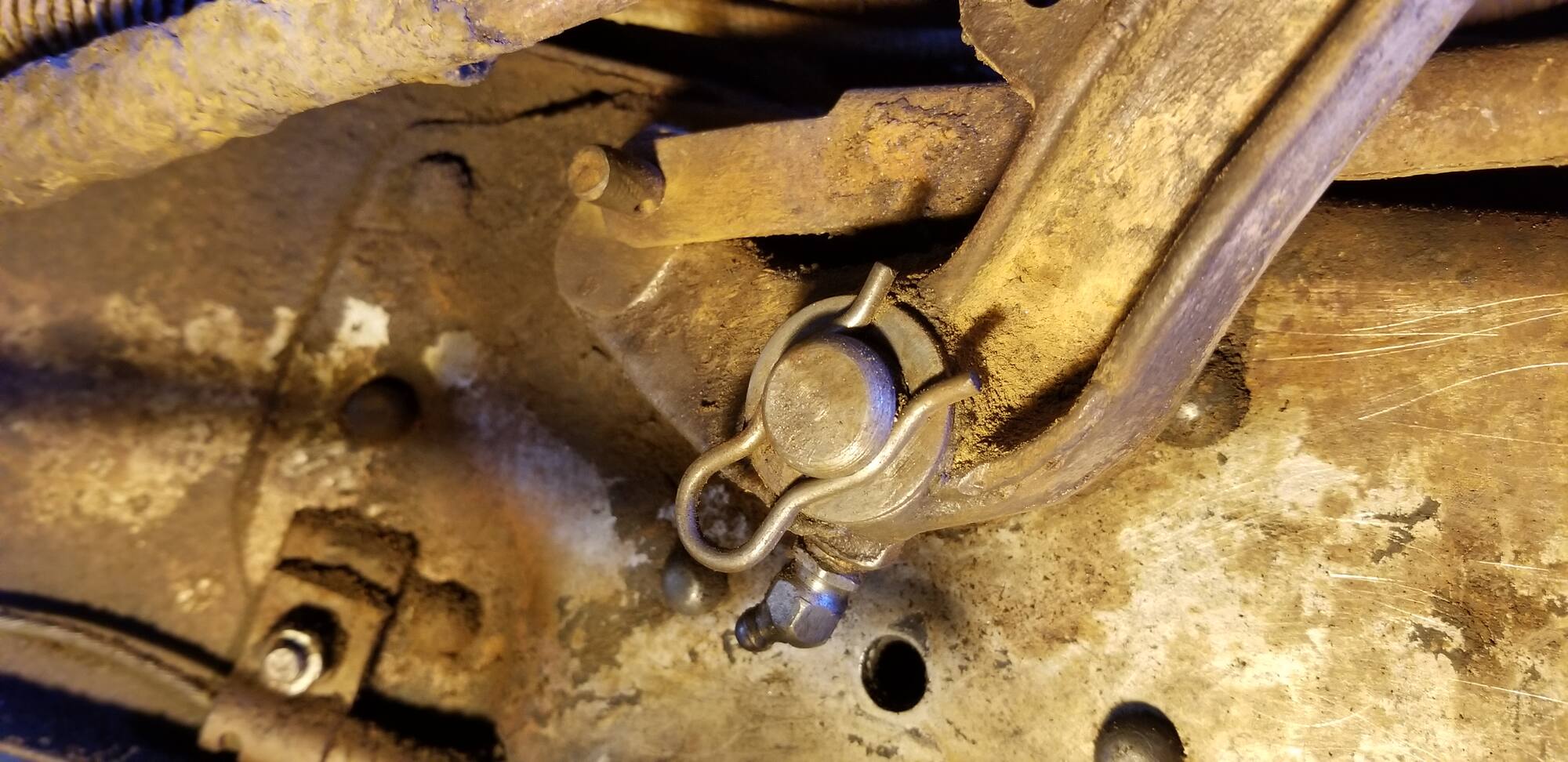

PhilA Posted June 10, 2019 Author Posted June 10, 2019 Tonight I propped the doors open, set up the big drum fan and started cleaning up the driver's side frame rail and steering box area. Coming up pretty well, removed a lot of grease and caked on crud. This seal needs to be replaced, looks to just be a press fit into the bottom of the steering box cross shaft hole. I had my first "Holy crap and I drove that" moment. Let's all play "Spot what's missing from the brake clevis", shall we, boys and girls? Phil LightBulbFun, STUNO, rainagain and 1 other 4
paulplom Posted June 11, 2019 Posted June 11, 2019 The bent nail? STUNO, stonedagain, Joey spud and 3 others 3 3
somewhatfoolish Posted June 11, 2019 Posted June 11, 2019 Nah, a re-purposed kirby grip, or perhaps a bit of mangled 30A fusewire. paulplom 1
PhilA Posted June 11, 2019 Author Posted June 11, 2019 Any of the above would be preferable to nothing at all. Phil paulplom 1
PhilA Posted June 11, 2019 Author Posted June 11, 2019 On a more positive note, the grease for the my steering box has arrived. Phil LightBulbFun, LabRat and paulplom 3
