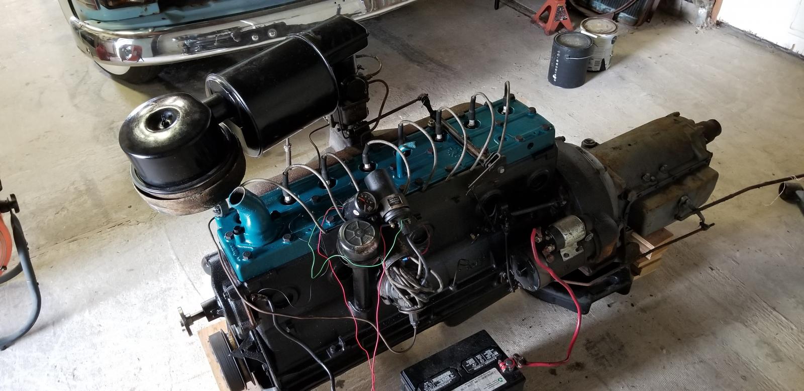

PhilA Posted March 11, 2019 Author Posted March 11, 2019 That sounds lubberly! Top stuff - it just seems bloody straightforward, whether due to your competency or initial good design:)This will be such a nice thing to pilot down the street, knowing you are being propelled by your own graft!I saw a video of one of these being driven along, quoted straight eight but it burbles down the street brap-brap-brap-brap Sounds like it's misfiring on a couple cylinders, either that or it's had a different manifold fitted. You hear this one is very smooth, I'm not sure it should get much of a hit/miss harmonic like you get with a V8 from the exhaust collectors being different lengths. Phil
PhilA Posted March 11, 2019 Author Posted March 11, 2019 The video I referenced. To me that sounds rather unhappy... egg 1
Junkman Posted March 11, 2019 Posted March 11, 2019 I saw a video of one of these being driven along, quoted straight eight but it burbles down the street brap-brap-brap-brap Sounds like it's misfiring on a couple cylinders, either that or it's had a different manifold fitted. You hear this one is very smooth, I'm not sure it should get much of a hit/miss harmonic like you get with a V8 from the exhaust collectors being different lengths. Phil You won't get anything near a V8 burble. A straight 8 should be evenly firing.What gives a V8 its typical sound is the odd firing order required to make it run at all. PhilA 1
PhilA Posted March 11, 2019 Author Posted March 11, 2019 That was rather my point, adding the rest of the exhaust shouldn't greatly change what's coming out of the manifold. You can fit uneven length headers to it but what's the benefit? Smooth firing off an 8-1 manifold just doesn't seem to have a great deal of scavenge. I could see 8-4-2 pipes providing that, but it wouldn't change the exhaust note if the primaries are tuned right. The whole object of the straight eight was to produce a smooth, quiet engine. I do like the noise this one makes. Reminds me of WW2 army trucks. Phil tooSavvy, mercrocker, Junkman and 2 others 5

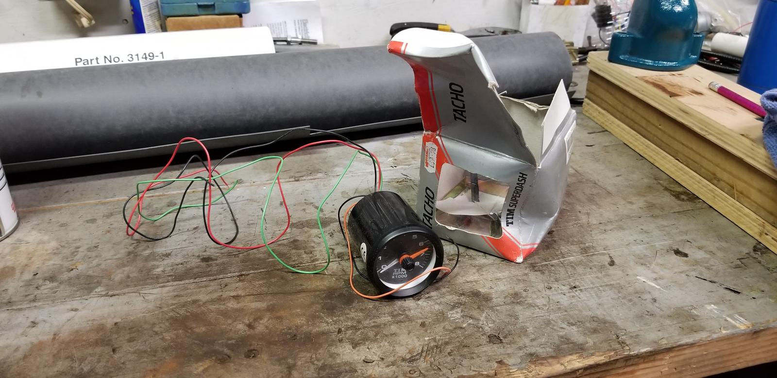

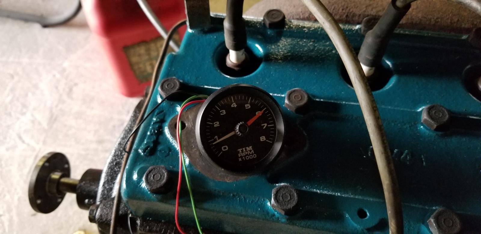

PhilA Posted March 11, 2019 Author Posted March 11, 2019 I had a rummage in the storeroom and found my little tachometer. It's got a very faded receipt from Motaman in Bedminster dated 2004. £38 even back then. Spent a little while bashing and bending metal. I need a vice.Net result is the air filter now sits correctly. I couldn't easily see where it was before, with the engine out access is very good. Still need to finish cleaning the lower section of the filter assembly. Hooked the tacho up and started the engine up. It reads nicely. It'll be useful for setting the gearbox up (needs to be set up to 700RPM to adjust the bands). Fuel pump needs a new gasket. That won't be a problem! Also fitted the thermostat housing with a new gasket I cut out. It'll need to come off again but showed me the clearance to the air filter housing, which sits much closer to the engine than I thought originally. Onward and upward. Phil Scruffy Bodger, DeeJay, Burnside and 7 others 10

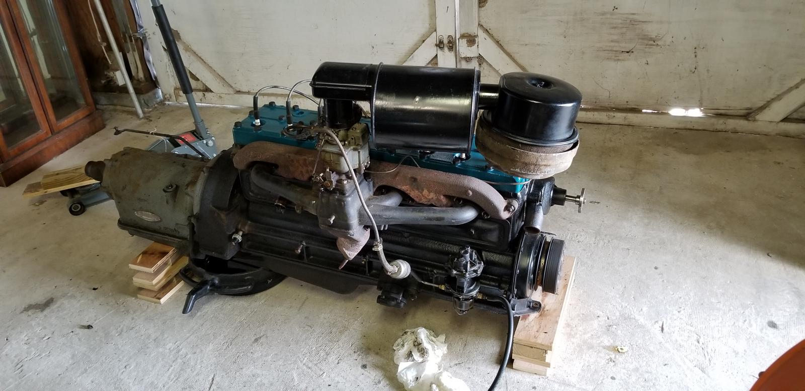

PhilA Posted March 11, 2019 Author Posted March 11, 2019 It's a fair bit quieter with the air filter assembly on. A good chunk of noise is intake related. At idle it's also very hissy, which this all but removes. Don't get me wrong, I do enjoy the sound of a V8, particularly a high performance one being given some beans. I miss my Challenger! If there's an automotive noise to define a country, the burble of a big computer controlled V8 is really modern America. It's by far the most common noise around here, for sure. The UK? These days the monotonous, tuneless rattling drone of a common rail inline 4 diesel. I miss the days of hearing Fords, BMCs, Vauxhalls, Rootes and the different sounds they brought. So yes, anything that has a bit of soul, a bit of character to break the humdrum is welcome to the ears. Phil Burnside, egg, LightBulbFun and 7 others 10

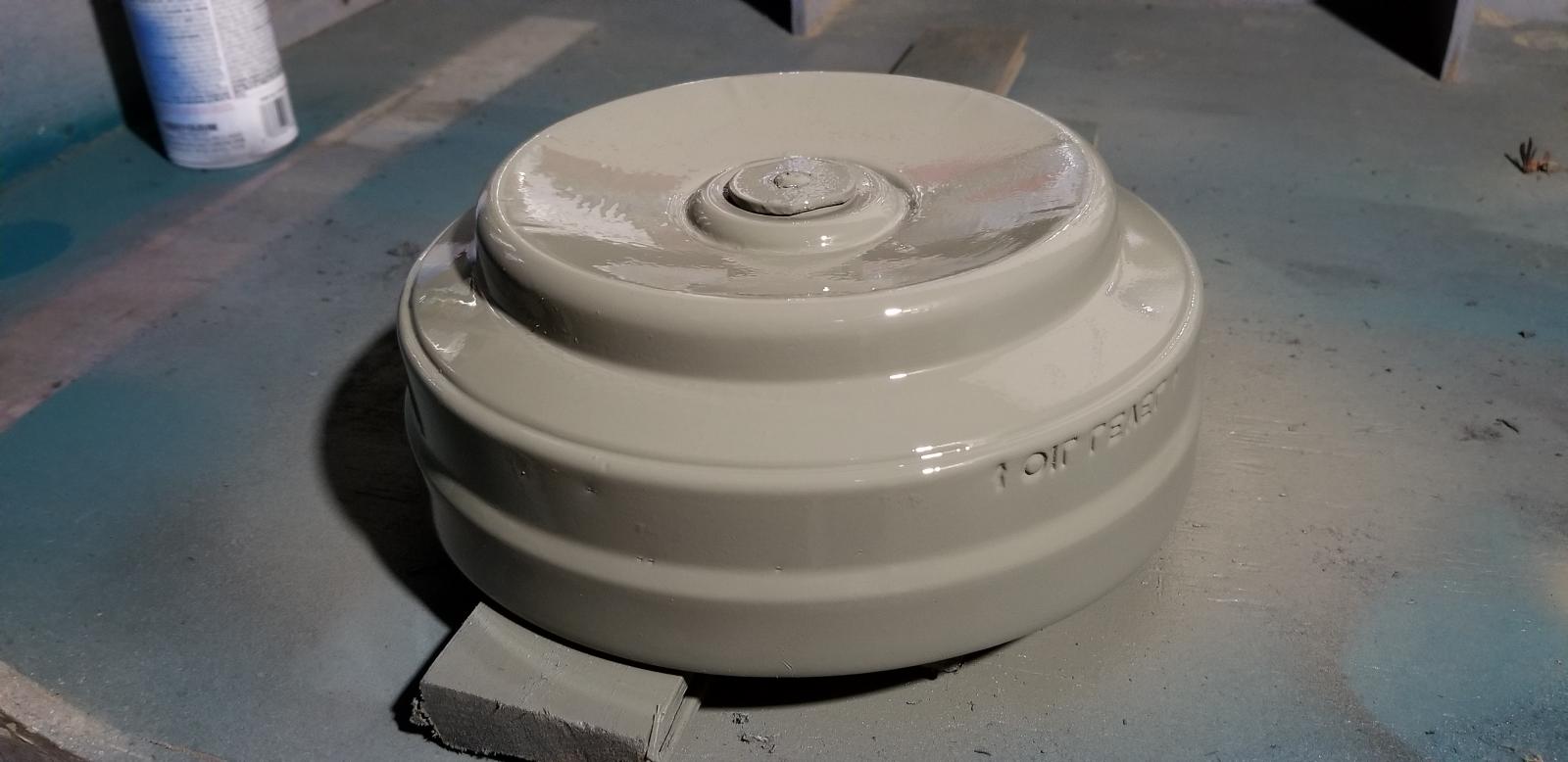

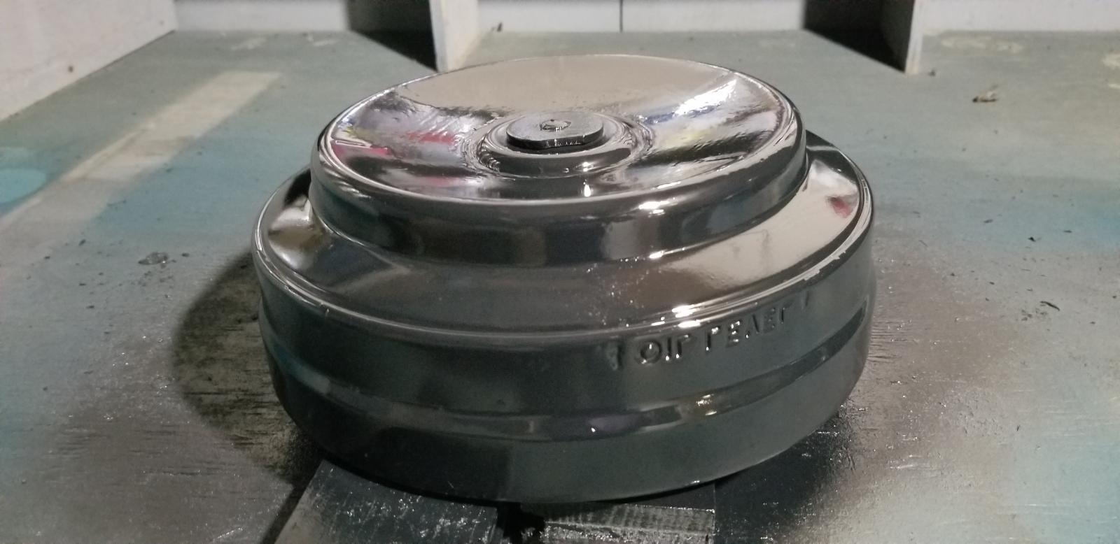

PhilA Posted March 16, 2019 Author Posted March 16, 2019 It was raining today so I did a little something on the car. Lower section of the air filter assembly. Cleaned, rust removed. Primed. Painted. It's so black it doesn't even look black. I like enamel. Phil LightBulbFun, steveo3002, somewhatfoolish and 15 others 18

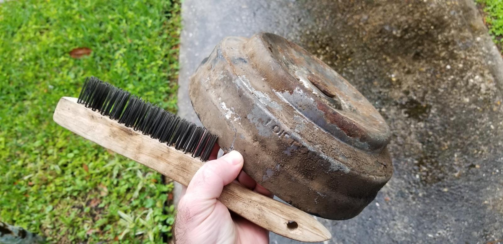

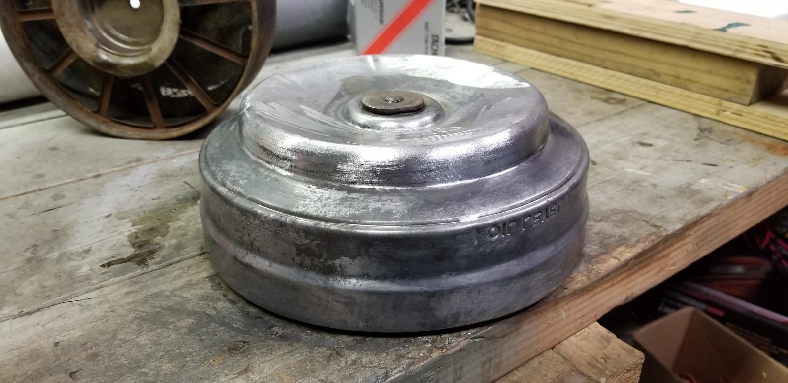

PhilA Posted March 16, 2019 Author Posted March 16, 2019 Nice afternoon today, so I took a little time to try finish one thing up. Filter element assembly. Started cleaning it up. Got it all scrubbed down nice. Stuffed it full of new filter mesh. And painted it black again. Phil Squire_Dawson, DeeJay, LightBulbFun and 5 others 8
