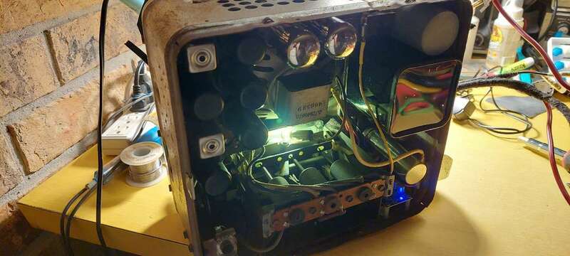

PhilA Posted December 4, 2022 Author Posted December 4, 2022 The radio hadn't been playing very well, so I wrangled it out from behind the dash. It's been sat there since 2020; eight months sitting up seems to have not done it any favors. Turns out to have been the fader switch, which got a good clean. While I was at it, I decided to redo the alignment. For you radio buffs, minus the 1.000MHz frequency tuned in, that's an odd IF by today's standards (260kHz). Tweaked it up a touch better. Reception was good before, it's improved now, particularly during the day. Then, on to tiny clockwork. The clock had been losing time, so I pulled the escapement apart and cleaned it, and re-oiled it. It then got balanced on the oscilloscope so the clockwise and anticlockwise electric contacts are even. Hopefully that'll keep time. Phil Rust Collector, Joey spud, loserone and 17 others 20
PhilA Posted December 4, 2022 Author Posted December 4, 2022 All back together and so far it seems to be keeping time quite well. I'll stick it back in the car later. Rust Collector, LightBulbFun, hairnet and 7 others 10
