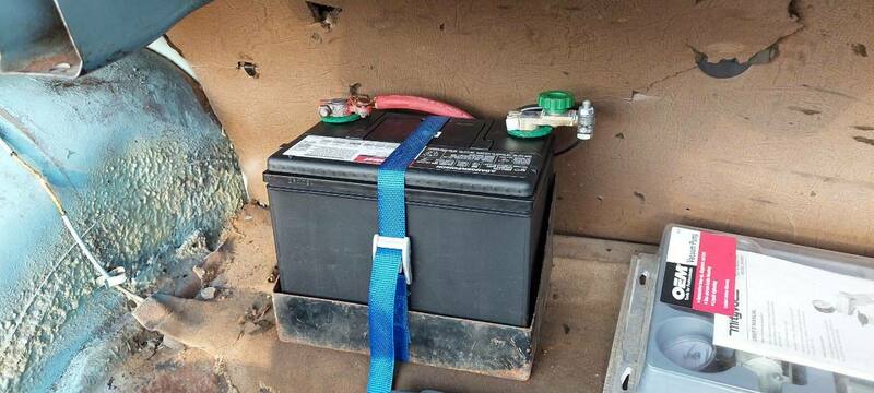

PhilA Posted June 9, 2022 Author Posted June 9, 2022 $210 poorer, I now have a reliable battery. The engine has never cranked over so fast! It also doesn't falter at idle any more so I'm guessing the ignition just didn't have the amps it needed to operate correctly with the old battery. Phil AnnoyingPentium, Saabnut, cort1977 and 7 others 10
