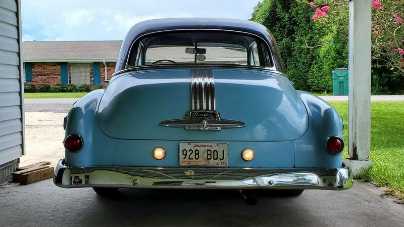

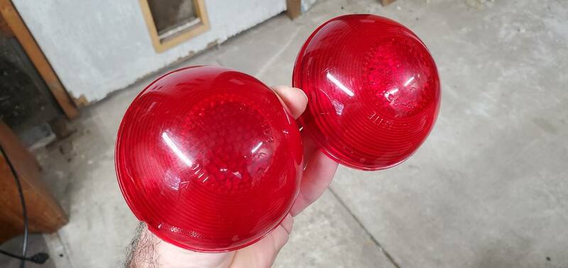

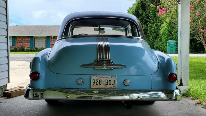

Recieved a pair of new old stock tail light lenses in the mail. They're in great shape. Half an hour in the ultrasonic bath got them nice and clean.
Bright, compared to the old ones.
They look nice in the sun and the reflectiors work well, too.
Hopefully that'll reduce the number of people looking to drive into the back end of the car when I'm slowing down.

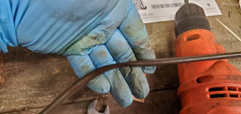

Went out last night to get a chocolate malt.
On the way home, I pushed on the brake pedal to turn into this street and the pedal hit the carpet. I drove the rest of the way using the handbrake, and upon parking up there was the unmistakeable smell of DOT3 under the car and a small pool. It was too dark then so this morning I jacked the car up to investigate.
Found the culprit, on full suspension compression the fuel line was interfering with the brake line. It went pop (fuel line is ok, it was rubbing over a long edge versus short edge of the brake line there).
Discovered the new exhaust managed to hit the only place there's a brake pipe too.
So two for two, rerouted a new pipe to avoid both places.
Bled up and tested. Múy bien.

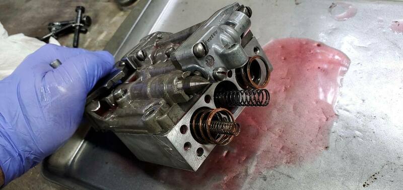

However, the gearbox is acting up again so I need to pull the valve block off (again) after having done done research. There's a ridge that wears in on the narrow part of the valve stem which causes the 1-2 valve to hang up.
I'm going to have a go at removing that and getting the valves to shuttle better again.
Phil
I took the valve block off.
Cleaned it and made sure the valves operate correctly.
Went for a drive. Cold it's much better. Hot, still the same old nonsense.

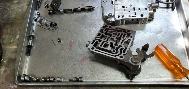

9am, 30C. Time to work on the car.
Drained the catch pan of the oil from last time. Bit grubby.
Drained this lot down and pulled the valve body. I focused more on the top half and the throttle modulator circuit. Ultrasonic bath, thoroughly cleaned and all the shuttles polished and checked for movement.
Put it all together and went for a road test.
It no longer engages the parking pawl when put into reverse with the engine running.
It doesn't drop to 1st gear now from 3rd when slowing down to turn and gently accelerating (would go 4-3-1-2-1 before).
Occasionally sticks in first but can now be persuaded to change gently to 2nd by tapping the throttle most of the time.
Verdict: imperfect but better
