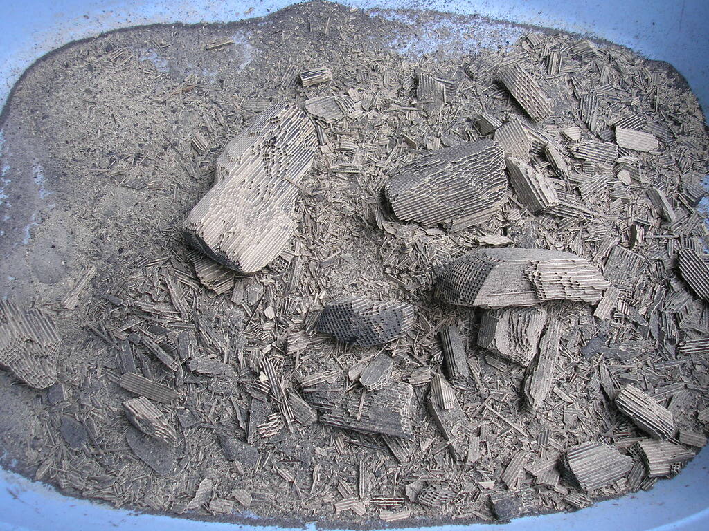

Well, finally found a job on the Passat that's easy at least- by the law of averages it was bound to happen eventually. I took the alternator regulator off last week, and ordered a replacement from ebay. It arrived with the socket slightly broken, I suspect from the postman forcing it through my letterbox, but fortunately not in a way that's likely to have any effect. I will inform the ebay seller in case of problems down the line. Here's the end of the alternator with the old reg removed and the slip rings visible (I've reinstalled the outer cover just so it and the fasteners don't get lost):
If you click to enlarge you can see one side of the slip ring is quite worn, but there's still copper there. I don't know why they wear unevenly, must be some sort of electrical effect, my Mondeo one was the same. The brushes on the old reg are similarly unevenly worn. Hoping that was the problem, anyway.

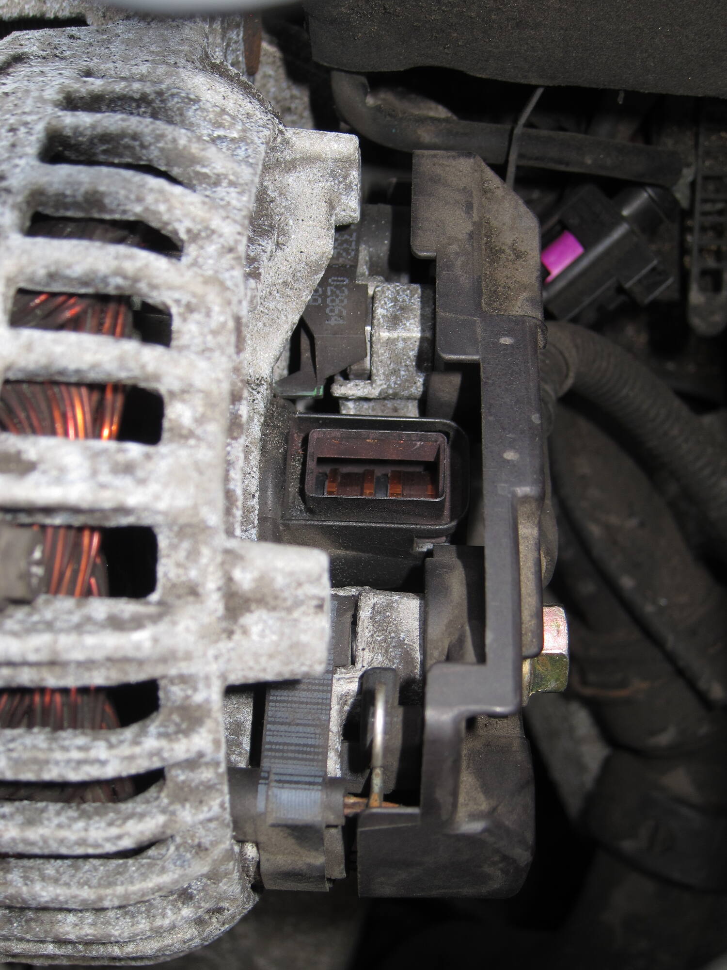

There's loads of room to work, just got to be careful not to clonk the dipstick as apparently they can break off, causing arseache:
Here's the new one installed:

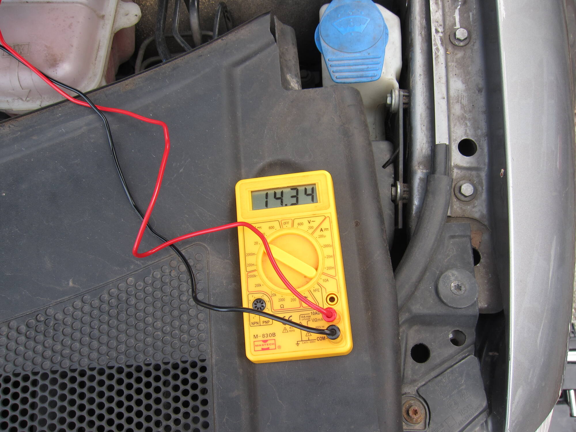

Reinstalled the battery, started the car, and...
Hurrah! I'll try and take it for a reasonably long test run before I risk taking it to Sheffield for our first big away day of the season, but fingers crossed it's fixed now. That's two cars with alternator faults that I've now fixed (touch wood) simply by replacing the reg. The Mondeo one was about 30 quid, but you had to remove the alternator to swap it, so that was just a financial saving; but on this car it was 16 quid and a way easier job than taking the alternator off, so a win all round. It seems to me that people are overly keen to go with the whole new alternator option when they give trouble.
