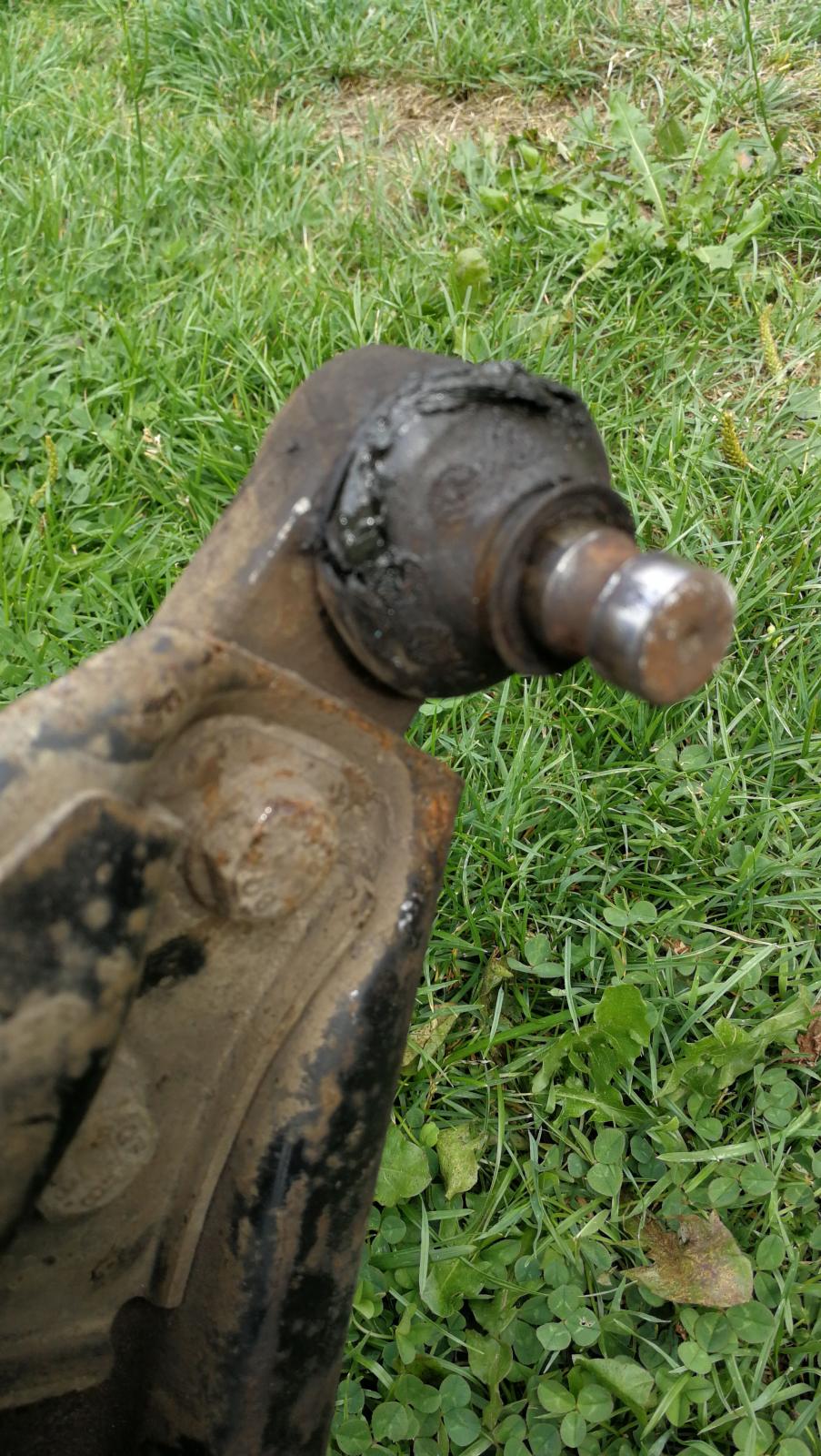

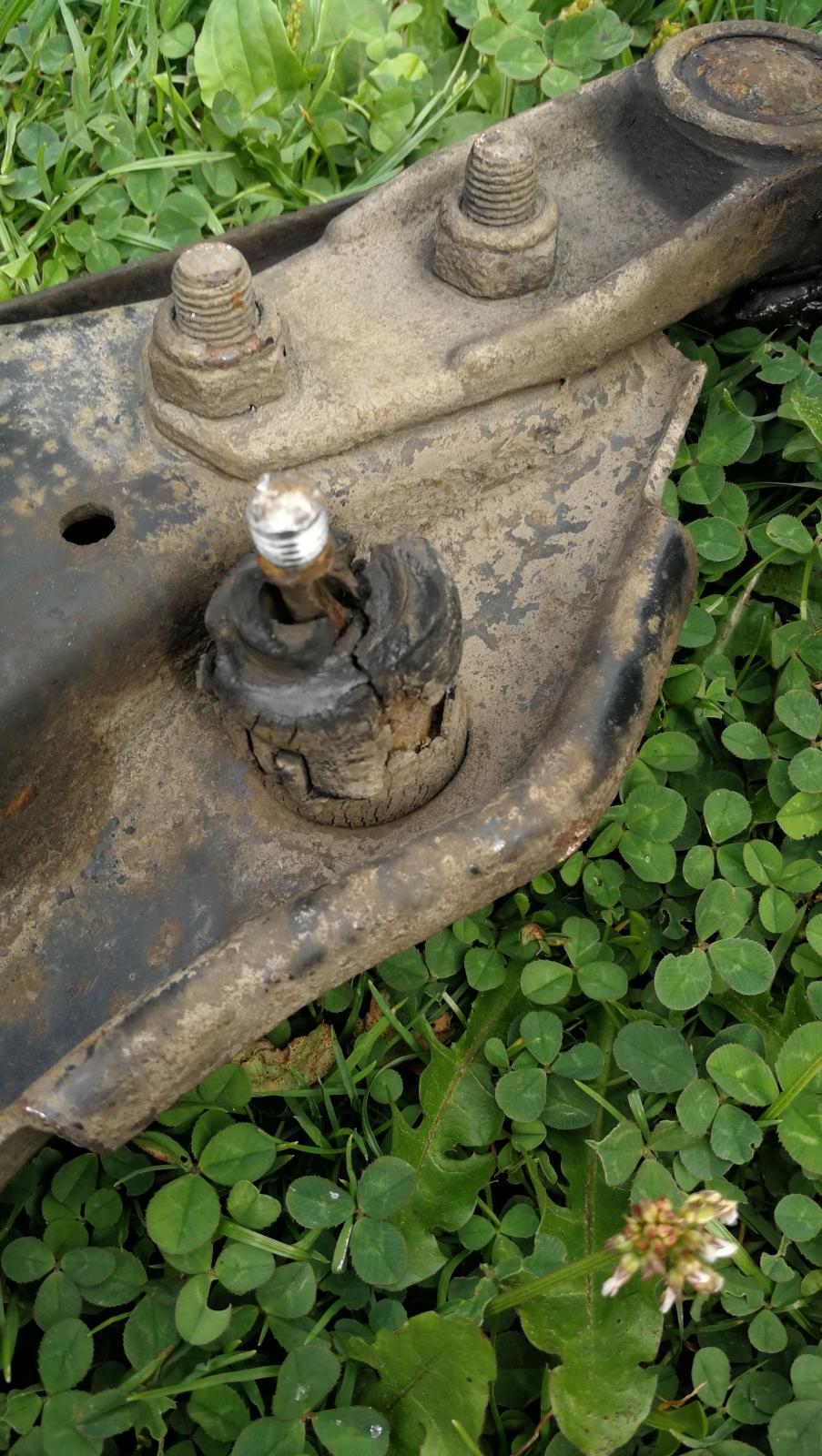

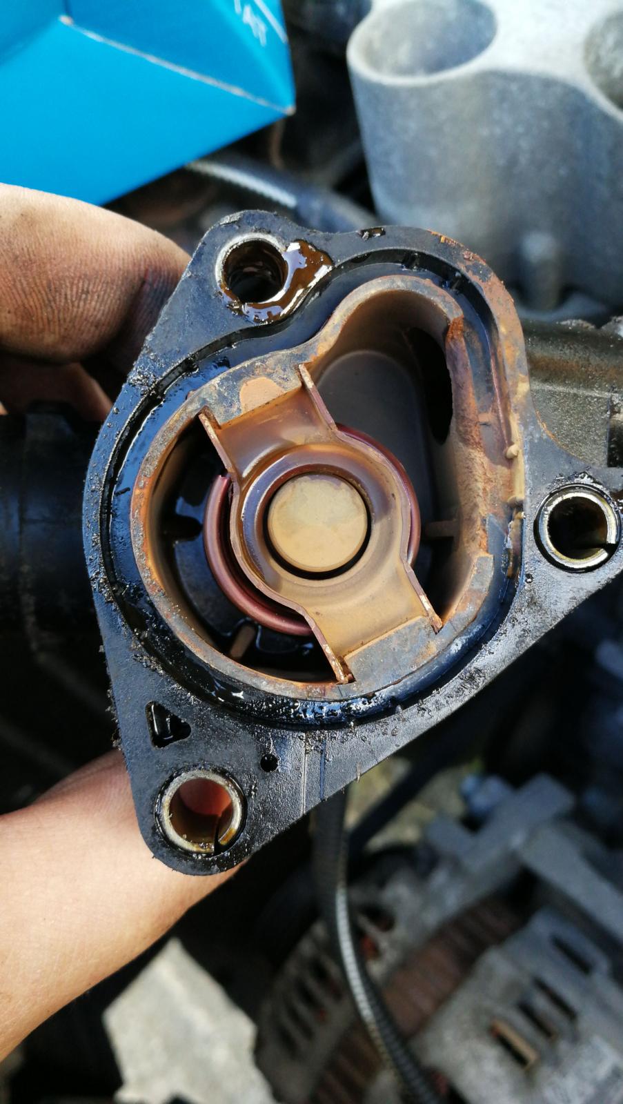

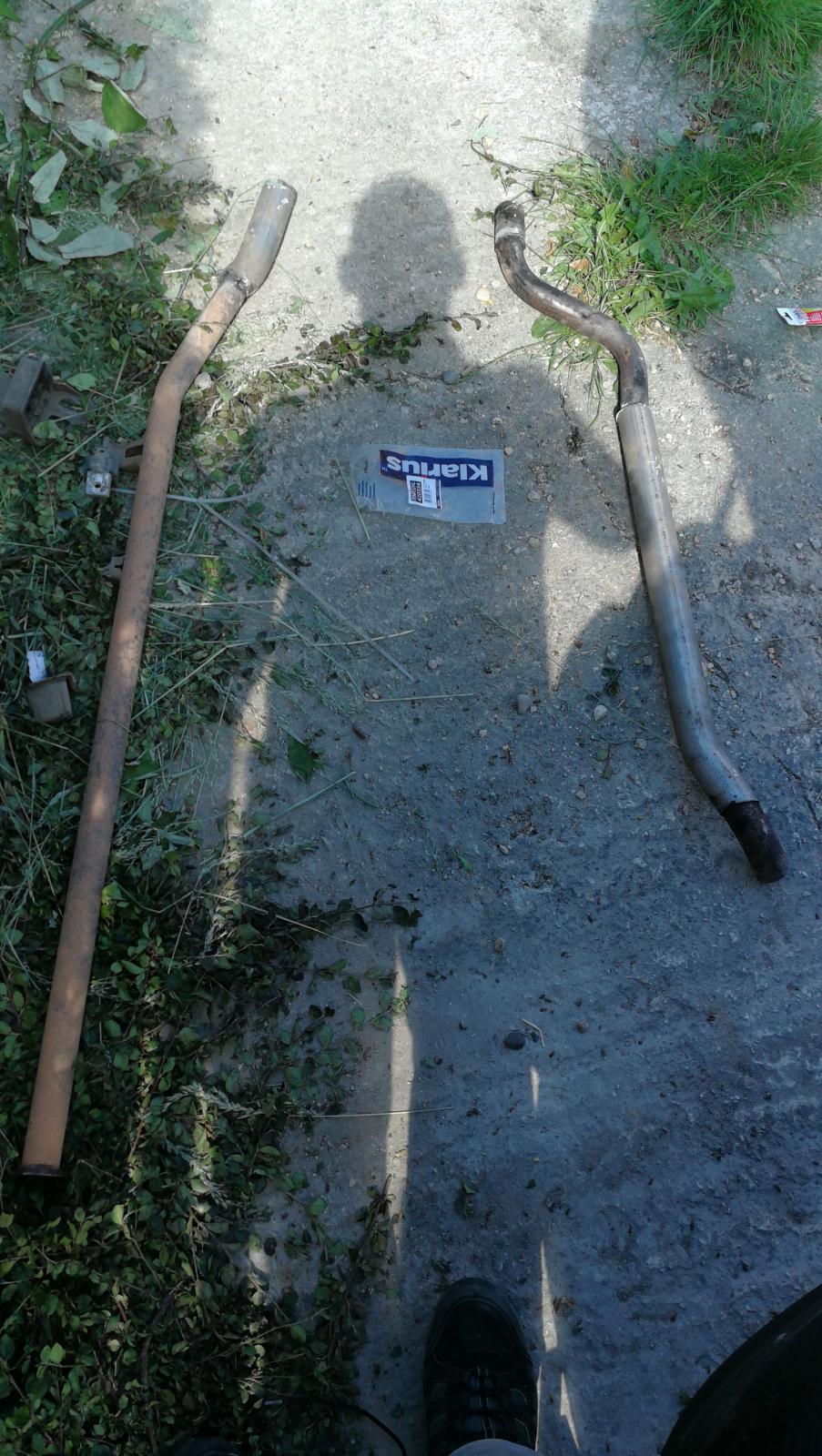

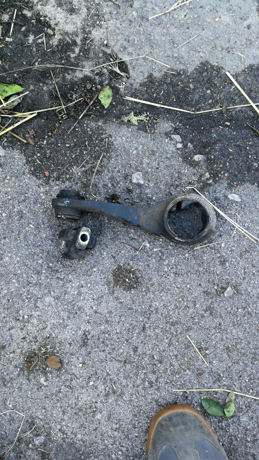

chompy_snake Posted August 24, 2018 Author Posted August 24, 2018 Ok, here we are at last.....A catalogue to date of parts that have HAD to be replaced as a direct result (so far) of a bodged clutch replacement! Rear centre engine mount (dogbone) The manifold had to be completely replaced as that broken stud would not come out and there really isn't enough material to just drill and through bolt Also he snapped the cat Flexi so the whole cat had to be changed too! The snapped ABS reluctor ring on the driveshaft that was totally fine when it went in and is now actually bent (reckon it had been thrown on the floor) Knackered balljointRelated snapped drop link The thermostat housing he had promised me that he had sealed and wasn't leaking anymore. And for comedy value .... The exhaust (if you can call it that) that was fitted when I got it! Now I'm not daft and I know some of these items were worn and would have needed replacing at some point soon. But there was plenty of life left in most of it! Also due to family emergency I am back and forth to Grimsby daily and realised the gearbox had started howling in 5th.Sent it to the garage this morning and it needed 3.5 litres of oil adding .... So all of the oil wasn't there basically!The guy that did the job this morning pointed out that there wasn't any leaks at all and the bolt to fill had not been out in a very long time if ever at all. The person that did the clutch simply must not have filled the box when done! Gearbox thankfully seems to have survived the ordeal. As the person who did the work and broke my car doesn't want to liaise at all about it. I am taking him through trading standards and small claims court as this has been a VERY expensive mistake. And just to point out the mega mpg of my little 1.2 16v Clio ..... That was my house to Grimsby including stuck in some rather heavy traffic entering the land of the cod heads Broadsword, HarmonicCheeseburger, ProgRocker and 4 others 7

vulgalour Posted August 25, 2018 Posted August 25, 2018 Interesting Klarius exhaust you had there. chompy_snake 1
chompy_snake Posted August 25, 2018 Author Posted August 25, 2018 Interesting Klarius exhaust you had there.It did used to backfire on command and frighten the life out of people..... It did have some redeeming features I suppose
