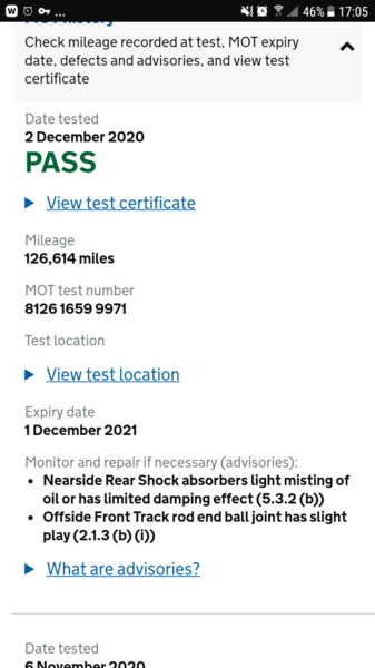

I made a slightly upsetting discovery at Cholmondeley.
Never mind, I'll just buy a new pair.
http://www.skandix.de/en/spare-parts/suspension-steering/shock-absorbing/shock-absorber/shock-absorber-rear-axle-nivomat/1006402/
Oh.
A second hand pair then.
https://www.ebay.co.uk/itm/2x-Level-Regulator-Nivomat-Volvo-850-Wagon-V70-I-Shock-Absorber-Niveaumat-Rear/372708452327?fits=Car+Make%3AVolvo|Model%3A850&hash=item56c727a7e7:g:JYAAAOSwT8ZdI1cx
Oh.
Luckily I had looked into all this when I got the car and discovered HOW FUCKING MUCH people ask for them, so I'd bagged a pair for a much more agreeable price when a suitable donor turned up in the local breakers.
