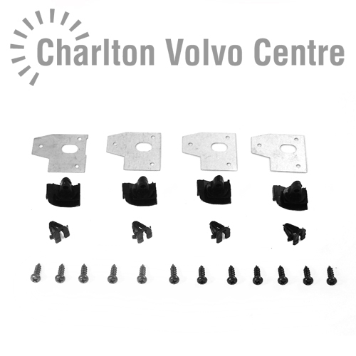

Two of the declared issues were the rear washer not working and the tailgate not locking or unlocking with the central locking- although the central locking does work from the tailgate.
The seller claimed that the washer would be a blocked non-return valve at the jet. I braved removing the tailgate trim, which broke every remaining clip as I expected, and pulled the hose off the non-return valve. No water came out when I tried the washers, so I held them on a bit longer. Still nothing from the hose, but water started coming out from below the fuel filler. I lifted the floor panel and found that the pressure from the blocked valve had forced the rubber hose off the end of the hard plastic pipe. I fitted a longer piece of hose and tried again, this time I got water where I wanted it. I changed the valve and put it all back together, mission accomplished.
I'd read that the boot only works with the central locking if you remove the key in the vertical position, which was certainly the case with the saloon. The lock won't move to a vertical position on this car and everything in the mechanism seemed to move as it should, so that's been left for further investigation.
There wasn't much I could do with the mounting clips so I ordered a repair kit, which arrived next day! https://www.ebay.co.uk/itm/273371973645
Obviously one of the new clips broke on assembly, so I had to reuse the one intact old one.
