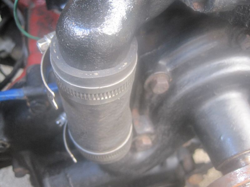

So I put the new bottom hose on without major pain. Then tried the bypass hose, and it's a complete bastard? It doesn't want to go on the water pump outlet at all, just keeps folding in the middle. Finally managed to get it down to where appears right, but it then looks too long and the part that connects to the thermostat housing is 1/4 inch too high up to bolt back on. The old pipe looks quite "bulgy" at the ends as if it's been forced further than it should be to get it on.
Any suggestions? Chop 1/4 inch off the top? Keep on forcing and hope I can get it down a bit more? Kill it with fire?

As for the hose I think you're having problems with, I took the combined thermostat housing/heater valve off to replace it which means you can remove it from the water pump with very little effort. In fact I couldn't see any other way of doing it. I'll try and get photos - currently it's pitch black outside. I certainly didn't have any problems with length or fitting it once I'd taken off the thermostat housing/heater valve. One thing I do rely on is the official parts manual, which helps out no end in terms of getting the right part number (with the except of the rocker cover which I'm sure they've got the two types for the petrol 2.25 the wrong way round engine number-wise.)
I took the heater valve / top bit of pipe off, 2 bolts on the side of thermostat housing. New hose down on the water pump outlet as far as I can get it, then put the valve bit into the bypass pipe. It's then too high to reconnect to the thermostat housing. I'll have to get a pic tomorrow.
Maybe there's more than one bypass hose? Or it's got a britpart water pump that doesn't fit very well. (guessing). Hose is 574871 which appears to be for all 2 1/4s according to paddocks.
On other forums people have been reporting problems with bypass hoses being a little too small an internal diameter, almost as if there is a batch made of a metric size just under the correct imperial size.
Try having a measure of the old, new and the stubbs?

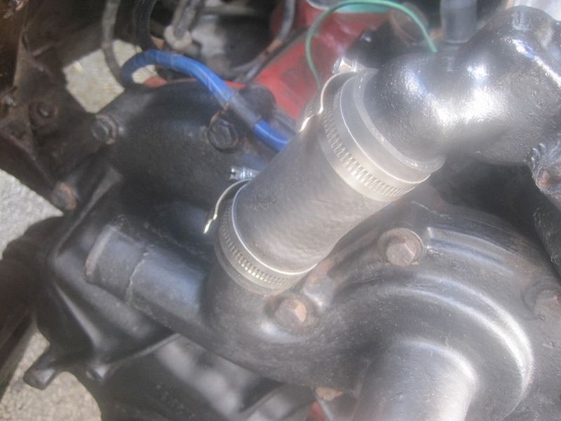

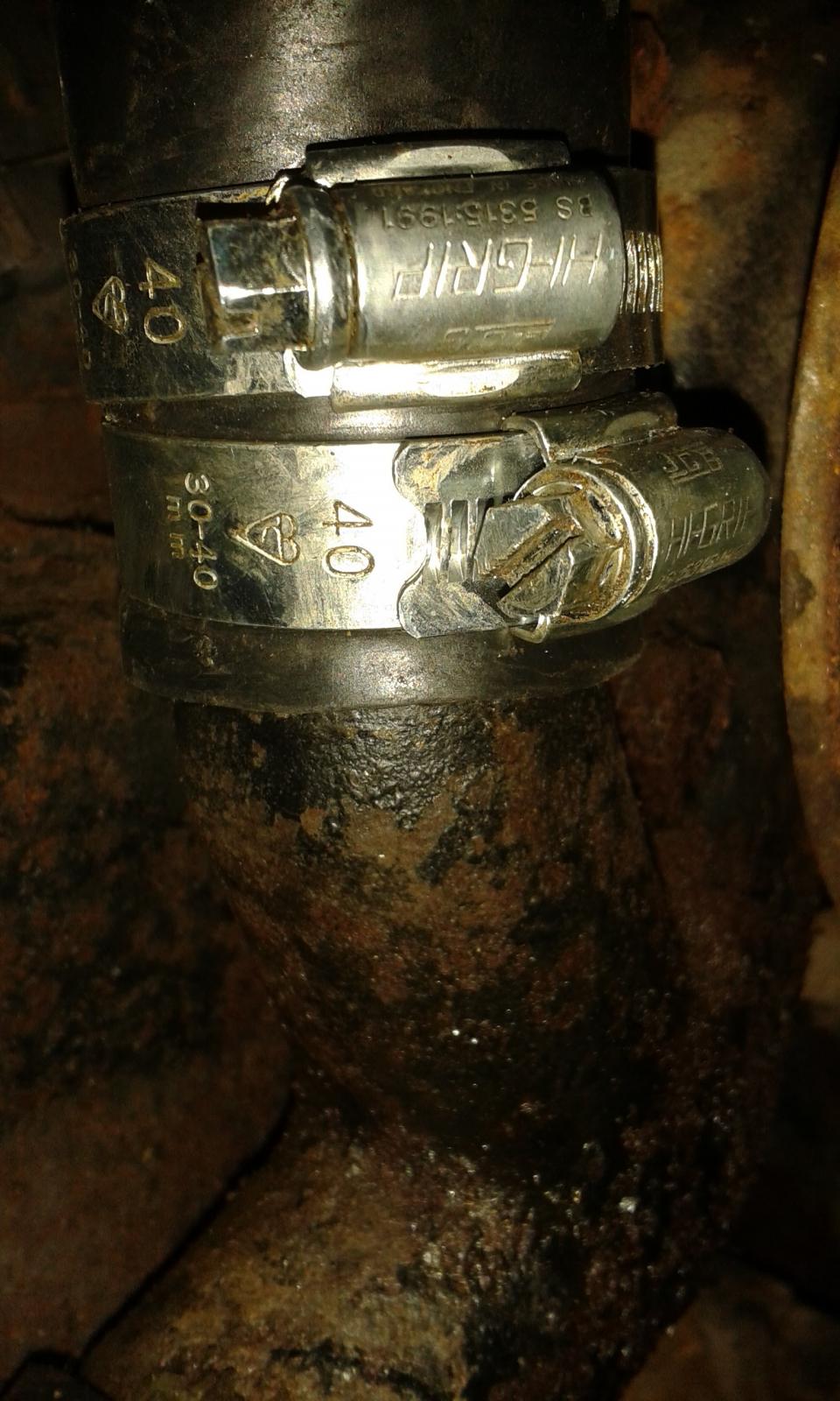

No problems with the by-pass hose (it's the only one I've currently fitted). I'll try and get photos tonight.
Mine is a late 2.25 petrol - the five bearing version - not that I think that makes a jot of difference. The part number - 574871 - does appear to cover all (although I'll double-check the official parts manual tonight). Here's the hose on its own from the same eBay seller:
http://https://www.ebay.co.uk/itm/Bearmach-Land-Rover-Series-2-3-88-109-2-25-Water-bypass-hose-574871/221852147894?hash=item33a76b20b6:g:h~IAAOSwyQtVzLlU
I'm sure you know that Land Rovers (like VW Beetles) seem to suffer from a shed load of cheap (and useless) repo parts. When buying bits for the LR half my time is trying to ensure I get the best quality possible.
It looks like this currently:
Maybe I'm supposed to get it further onto the water pump, but I couldn't force it any further last night. I'll leave it on over the weekend and try again. maybe it will expand a bit being left stretched? Yeah, wishful thinking.
My impressions from the pictures are as you've stated. It looks rather tight, the bit of hose on the water pump looks a little too short and the bit on the by-pass end too long. Mine certainly wasn't any kind of problem to fit and I can be a bit of an old woman when it comes to getting such things right. As soon as I get home I will have a nose and report back.
I've had a look and mine is no way as near a tight as that. The part number is correct according to the manual and it seems universal for all 2.25 petrol engines.
I've got photos, but cannot for the life of me see how to add them to this site. Do they need to be hosted by a third party? I've clicked on the 'My Media' icon in the editor, but cannot see how I can add photos to it. Any tips?
Yours definitely fits better. Bloody britpart strikes again.

The bearmach hose finally arrived today. It's the same dimensions as the britpart one, but different material. It's got a lot more stretch in it, and went straight on. Success!

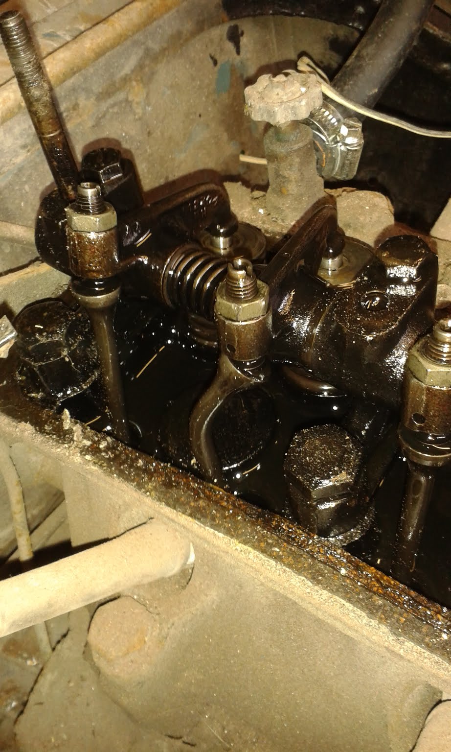

Take rocker shaft off and tap the valve with a hammer to see if it moves. If/when it doesn't you know you'll need the head off
Rocker shaft removed. All inlet valve pushrods have at least a bit of bendy. #4 (worst one) the valve moves but sticks before eventually springing back up, so that one at least is bendy?

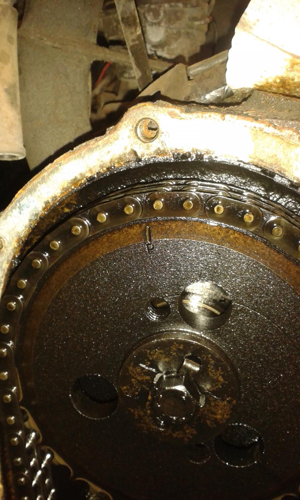

Guessing timing chain has jumped and clonky clonky? Think it's fixable?
Yes its fixable.
Get the head off, your going to have to change some valves.
Then check the cam timing is correct.

So I pulled the head. No obvious damage to piston 4, and all the bores look fine.
Removed the timing cover. Er it all looks normal and things line up as per haynes book of lies.
Removed the collets / springs on the valve with the most bent pushrod. Valve does not want to move and has to be drifted out. But once it's out it looks pretty straight
It does not want to go back in. It would be a drive fit to make it do so. All the other inlet valves appear to not move when given a tap with a hammer. (exhaust valves move).
So it looks like all the inlet valves have decided to stick solid overnight after running the day before. Which makes no sense whatsoever. As far as I can tell the bottom end & cam timing is fine, damage is from valves not moving.
Suggest me up where to go from here plz???
Didn't you say it has been standing for some time? Might be stuck valves initially bending pushrods then limited opening allowing it to run. Would idle reasonably but driving would show up lack of power or misfire.
Your gearbox issue is odd! Either the mainshaft has moved/got play i it or a needle roller on the mainshaft has seized up. Wasn't it very low on oil? Could be the reason but either way, as you say, gearbox out. Be interesting to see what the problem was if you decide to strip it rather than just put another box in.
