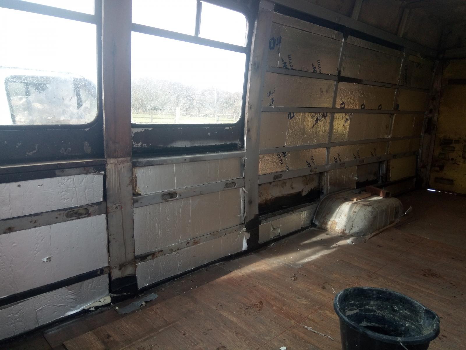

Started the first part of the refit by putting some insulation in.
That was a load of free kingspan from work, a load more picked up today. It's being pulled out of a house we are renovating and would be skipped otherwise so it's a Billy bonus for me. Not cheap stuff, especially at 40mm thick.
Normally 40mm is special order from the merchant.
Also got the first of the "insert choice expletive" sunroofs out.
My flabber is completely ghasted at who thought they were a good idea to fit.
Leaky, heavy and couldn't be opened for ventilation.
Goodbye.

You want some old coach skylights for that - preferably with the bright orange tinted glass...
That interior shot really does show how vast this thing is.

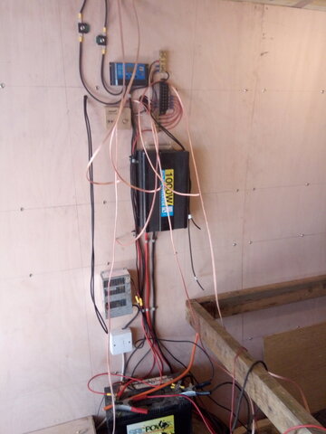

Got my P.V panels. 3x120w panels. Got the controller, made the cables, just need some inline fuses and to fit them

Solar all fitted and working.
I've got a dead battery attached to the leisure battery with jump leads, hopefully the sun will bring it back to life.
Piece of piss.
All the connections are marked. Either + or -.
If you make your own cables then you can't go wrong.
As long as you have a crimper tool, it should work.
