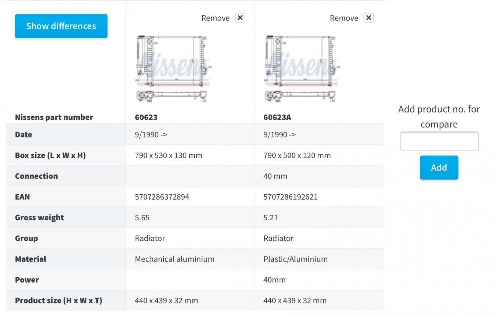

Vince70 Posted June 21, 2018 Author Posted June 21, 2018 After the fiasco fitting the cheapo pattern part radiator the other day and the bleed screw breaking I’ve decided to bite the bullet and buy another and have found a Nissens rad which are supposedly top notch. Now the problem is I don’t know which one I’m supposed to have as the part number comes up as 60623 or 60623A The one I’ve found for my Z3 is 60623 and just wondered what the difference is as my car is quite Poverty spec manual in it has no aircon or an oil cooler.Would either be ok. The Moog 1
spike60 Posted June 21, 2018 Posted June 21, 2018 I would reckon A has a built in oil cooler for an auto box and the other doesn't. Ask the seller. chaseracer and Vince70 2
Shirley Knott Posted June 21, 2018 Posted June 21, 2018 Nissens are kind of mid range tbh... I fitted a nissens rad to the Golf (£59 iirc) a year and a half back and no issues so far though. Vince70 1
Vince70 Posted June 21, 2018 Author Posted June 21, 2018 Cheers JoeyI’ve just ordered it as I emailed Nissens direct and got an answer instantly back that the A is an internal thing so isn’t anything to be concerned about.The next job tonight will be to clean up my trusty pela pump as it’s covered in oil and drain the coolant. The Moog 1
Guest Hooli Posted June 21, 2018 Posted June 21, 2018 According to the chart you put up the 'A' is part plastic & weighs less.
