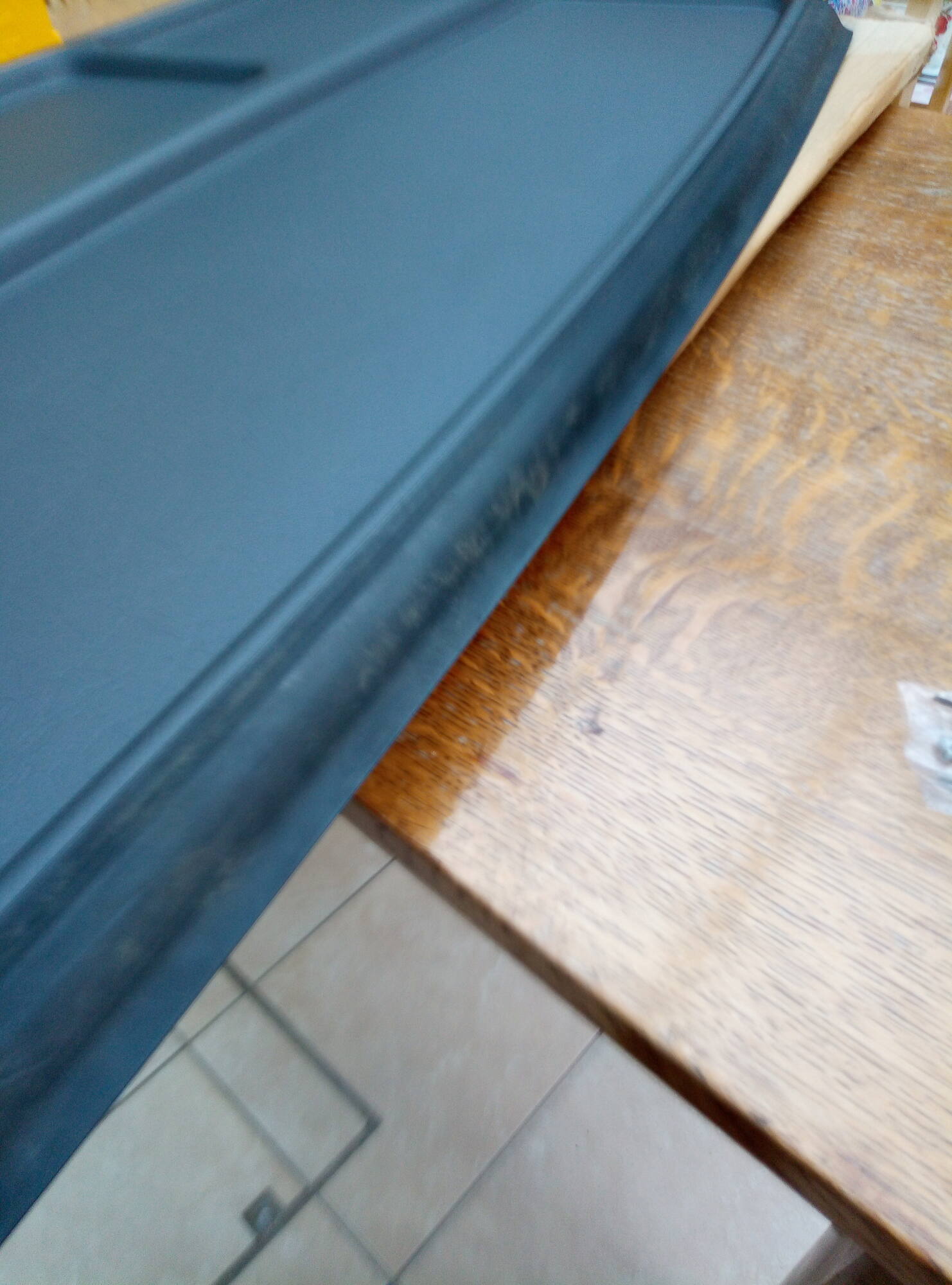

Well this weather isn’t helping. I have done some cleaning of trim bits and fitted the parcel shelf supports. Then sat down to order a few bits I need, so a few interior bits, lower front grills, tiny nuts and bolts for the parcel shelf trim are on their way. Still frustrating though as could have got a lot done today.
IMG_20200614_134046.thumb.jpg.c734f8dac647566bbe2cddff18677a01.jpgIMG_20200614_134237.thumb.jpg.061ae0c1506a19ff95666b9e3401f522.jpg
My back garden could be used for the monsoon season scenes in a Vietnam film at the moment so all bigger jobs on hold again. What a ballache. So what is left to do that can be done inside? Not much really so I turned to the utterly essential job of sorting the parcel shelf. Ford parcel shelves are notoriously shit from this era and Capris are no different. I had stripped the old one a few days ago and my wife kindly bought me a new one from CCI a few years ago for Christmas. So this afternoon has been spent moving bits across. I decided to use small stainless nuts and bolts rather than rivets and it’s gone well. When the rain stops I will drop it in and see how it looks.
IMG_20200614_142515.thumb.jpg.aba856c2a40b99a4025629915acdc072.jpgIMG_20200614_142726.thumb.jpg.1c59b5e7893054ab8d3270cf0dc60dbe.jpgIMG_20200614_144138.thumb.jpg.1baf05f52a0c9a6e71248b8d937237ee.jpg

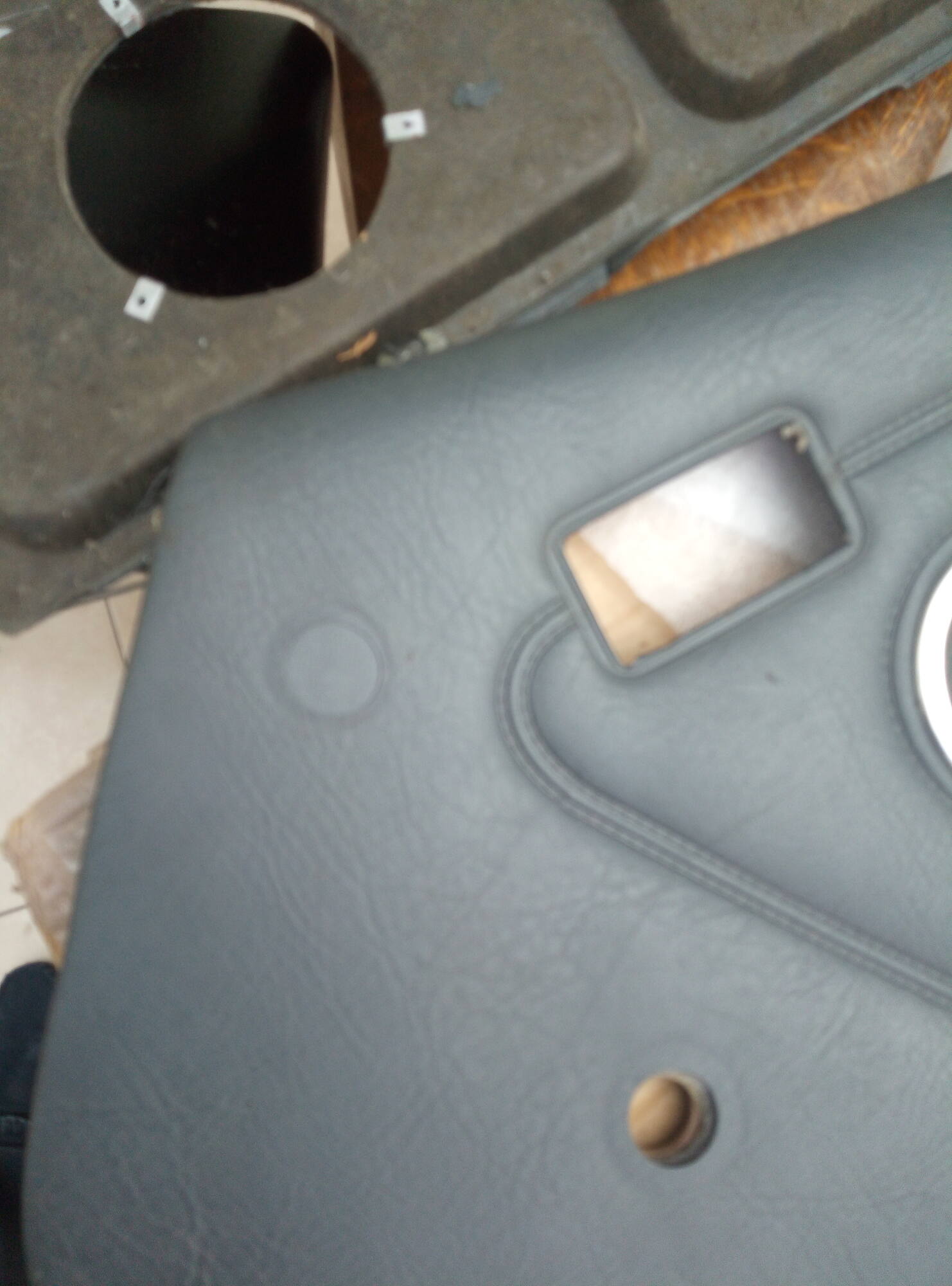

I managed to get a few dry minutes and tried the new parcel shelf which looks very nice I think! I also had a go with the gap in the door card for a remote mirror which I don’t have and that has come out ok as well. It would be nice to do the bigger jobs but the small ones need doing sometime so it all works towards the end point.

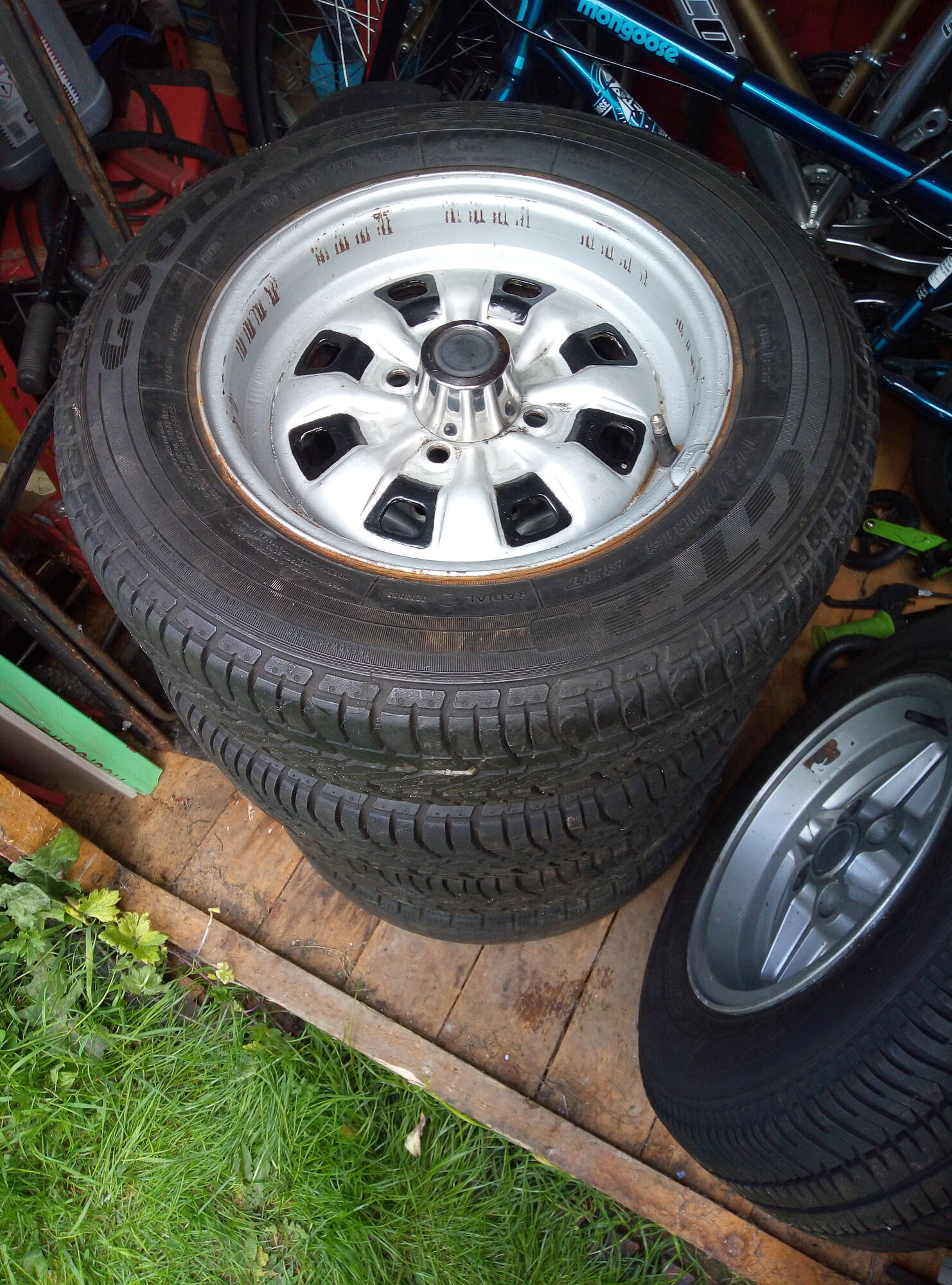

With the crap weather I started looking on Gumtree. Guess what I found......
4 minutes ago, danthecapriman said:
Nice rimz! Early ones too with the stainless centre caps.
Yup! Bargain too, just sheer luck. If it hadn't rained I would have missed them. They need a refresh but that's ok. I am sure I saw a plastic mask for doing the black bits somewhere.

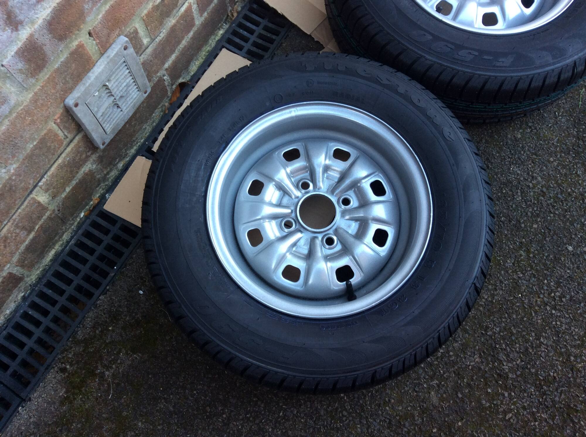

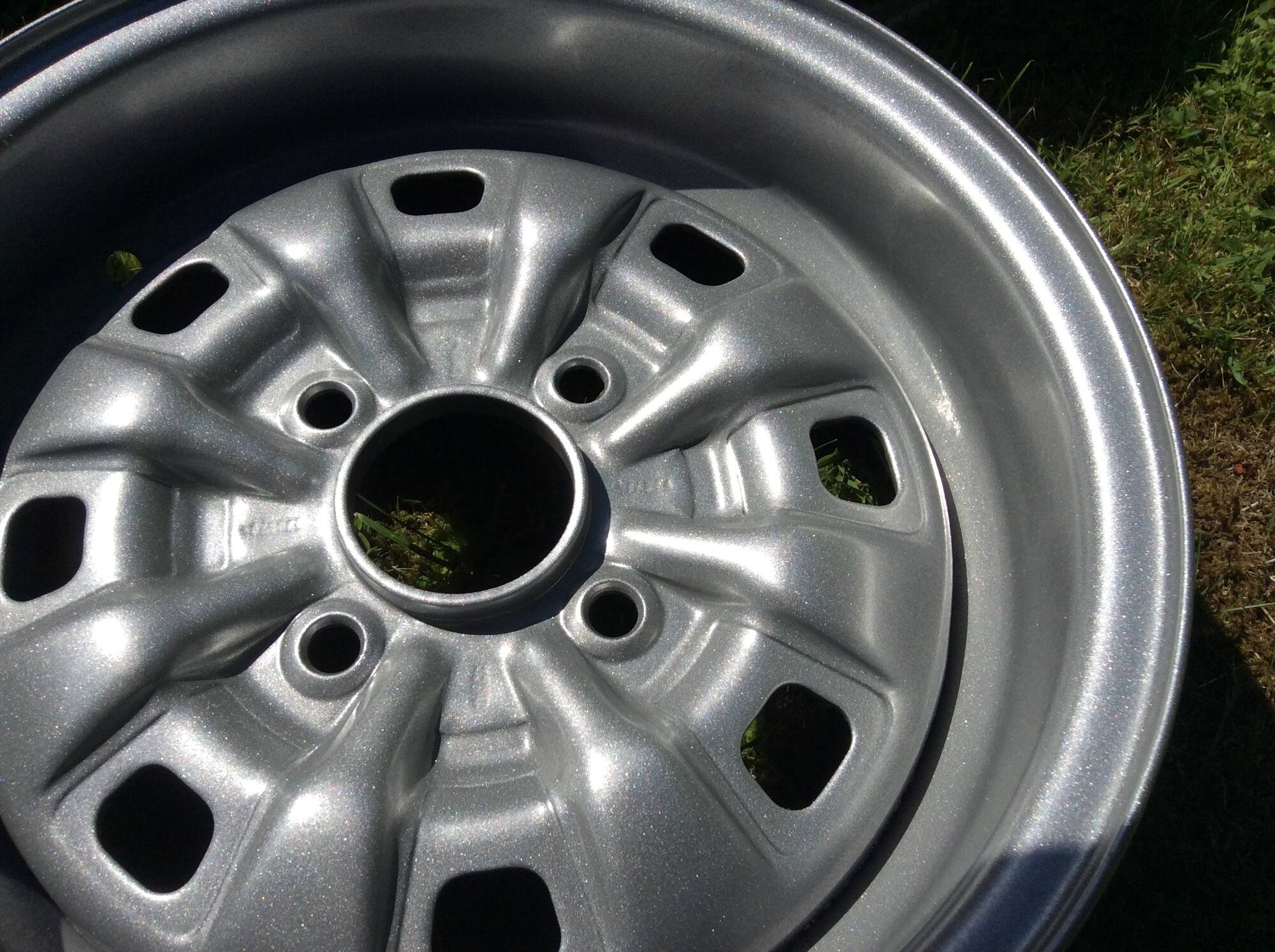

Did you get yours painted or powder coated? I am looking at powder coating as a localish place does them cheap.
I had mine blasted, then powder coated. I think for wheels it’s the best option tbh. When they did the powder coating on mine they said they could do them in standard grey or silver (or indeed any colour I wanted!) but they also had a darker silver colour that also had a bit more of a metallic ‘fleck’ in it. They said it was a lovely colour for wheels so I went for that. It’s obviously not standard, but I think it looks a bit nicer.
Only thing you do need to be careful with is when you fit them sometimes the powder coat needs sanding or scraping from around the wheel nuts and hubs, it’s thicker than paint and can stop them fitting properly. And also when the wheel nuts are tightened the powder coat can break away from under the nut, letting the nuts loosen. I had my Volvo wheels done at the same time as these and I had these problems with it, I had to keep checking the wheel nut torque every couple of months!
They look very nice! Exactly the colour I had in mind. Light anthracite at the local place.
