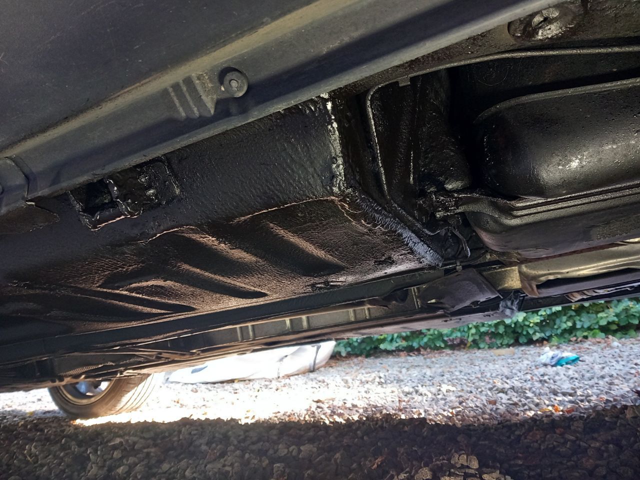

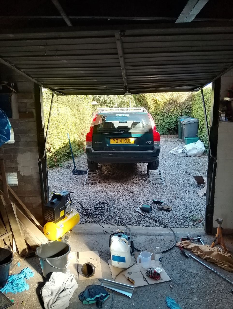

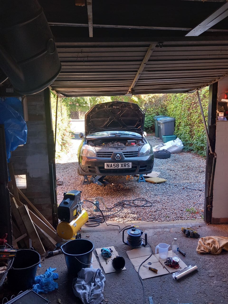

Busy week with the Clio and the V70 preparing for the forthcoming onslaught of winter road salt (They're 17 and 24 year old cars respectively so need all the help they can get)
Monday- Both undersides jetwashed and a decent run out to dry off.
Wednesday- Wire brushing and Jelonite rust converter where needed.
Yesterday- Waxing the bejesus out of them both with Dynax UB fed through my new (And incredibly impressive) compressor at 80psi.

Looks a nice job though, it’s something I need to do on my 740. How’s the compressor going compared to using the aerosols?

Way better.
It belts the product out really well and not having to keep tilting cans to get them to work makes it much less frustrating. Also 5l of UB comes in at under £50, the equivalent volume in aerosols is nearly double that, so over a couple of cars it basically means the compressor is free (Or at least that's what I've allowed my man maths to tell me)

Looked great upon application but all gone very quickly- Much like lanoguard I suspect, really easy to put on but needs reaplying every 8 weeks.
I've used UB many times in the past, it's much tougher but none of these products are 'fit and forget'... Honestly I think that's where people go wrong with them, they ALL need reapplication and none of them last indefinitely.

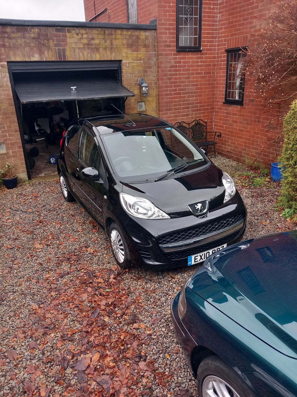

Bit of a catch up here. New car in, 10/11/25.
Mrs Knott had been nagging for ages for a newer vehicle with four doors as she's apparently fed up of having to move seats forward to allow our offspring in and out (Its a hard life eh) 🙄
Enter Peugeot 107 (Aygo really)
Bit of an interesting one. 2010 reg, only 37k clocked up (good) but had been stood for the best part of a year not being used (bad). A southern car and one of the cleanest I've ever seen underneath. Virtually spotless after a jet wash.
Impressed.
I promptly ruined all of that by covering the underside with several coats of Dynax UB.
New discs and pads fitted as the old ones were a bit past their best even by my relaxed standards.
Followed this up with a service. Oil, filter, plugs, air filter.

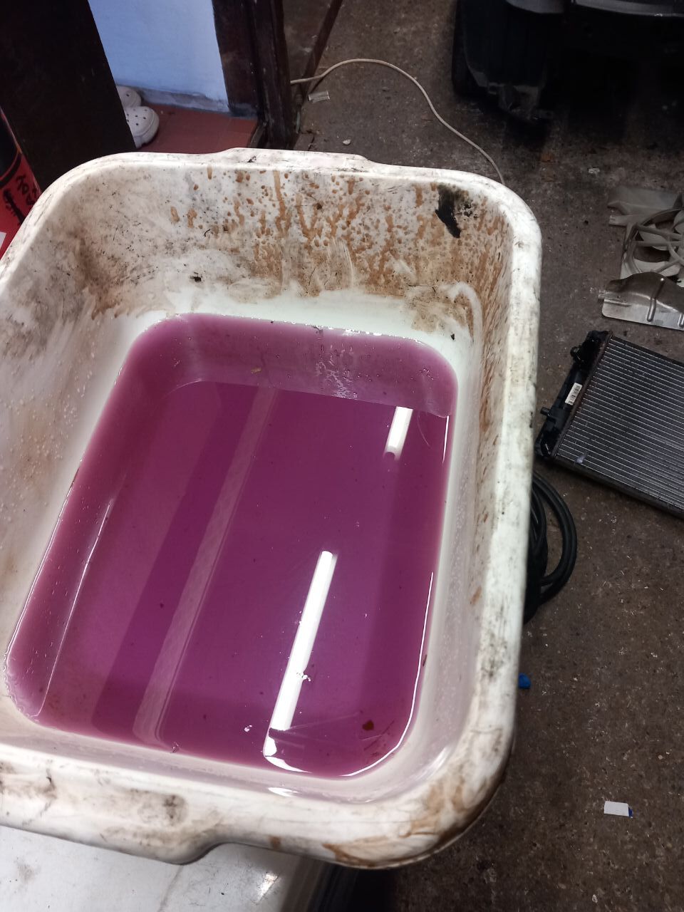

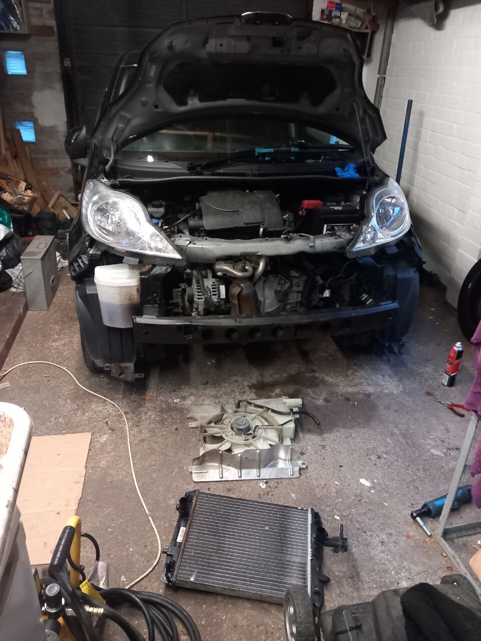

It immediately thanked me by bursting its radiator.  New radiator fitted.
Not impressed.

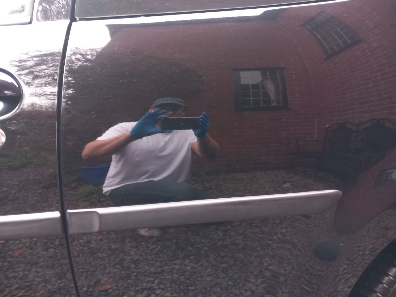

Polished the bejesus out if it and waxed it.
Impressed.
Next step, pre-emptively replaced all of the rear light seals with uprated items and removed the rear bumper to seal around the rear vents in an attempt to avoid the inevitable boot leak that these are plagued by.
Wait for it.... Still FKN leaks.
Not Impressed.
This brings us up to date. It hasn't let me down in any massive way *yet, but it'll take another few months before it's earned my full trust.
