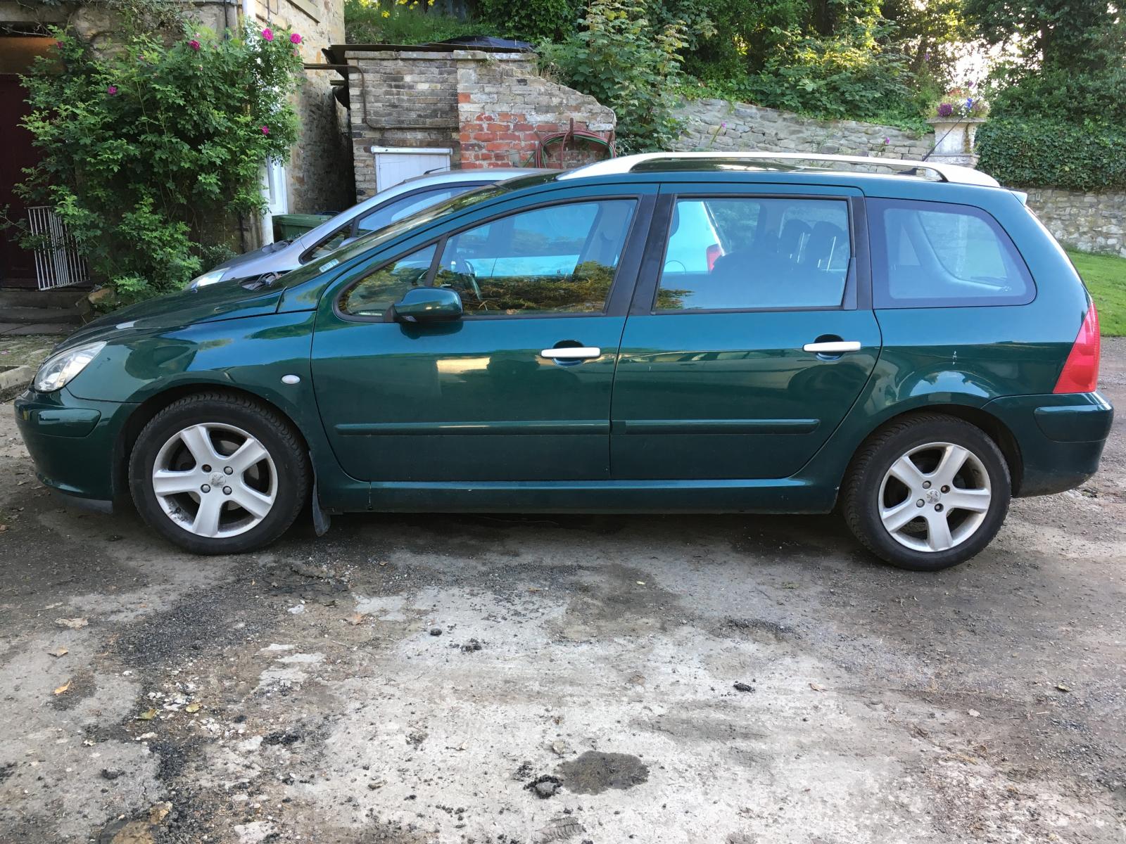

rainagain Posted March 26, 2018 Author Posted March 26, 2018 I bought a 2003 2.0 hdi 110bhp SW SE 7 seater with working climate control and full MOT for £450 from Lincolnshire just over a year ago. 170k Miles. Immaculate bar a couple of small scuffs and one tiny bit of burnt headlining from someone putting a fag out of the window. Despite that it didn’t smell at all of smoke and the ashtray was unused. CD multiplayer and reversing sensors both inoperative, so disconnected. I fitted a matching set of part worn Michelin Alpin 5 from Germany to it that transformed the ride. Replaced the thermostat (running cool) both drop links and a front wheel bearing and it’s now on 182k. Oh, and one balljoint. You need a special 41mm long socket that’s been useful for a few other things since I bought one a few years ago to use on a 90bhp estate I had for a while. I use lots of heat/quench prior to using either a long (like four foot) bar or the aforementioned Clarke mains impact wrench. It does work most of the time!Loaned it to a friend for the last nine months. I managed 43mpg, he gets 48 and it’s quite rapid if you want it to be.When you’re seven-up there’s not a lot of room for anything other than the odd coat or small bag though, but suits my need for carrying five children once in a while. Might have carried nine adults in it once too, off the public highway of course! I like it. Will get it back soon. I’ve bought a LuK solid flywheel/clutch kit for £160 which I’ll fit soon as the flywheel is very squeaky now. Will do engine mounts and probably gear cables too as floppy. Nice, better colour than mine as well!

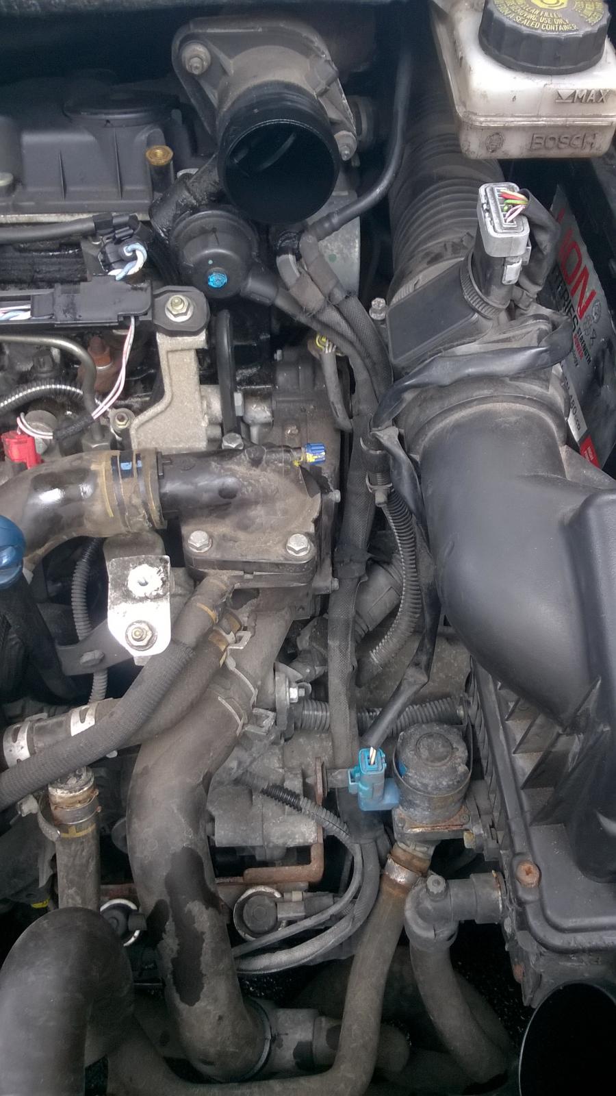

rainagain Posted March 26, 2018 Author Posted March 26, 2018 Once all the joints were done I turned my attention to the running temp, it didn't ever get above 70, it should be sitting around 80. It started well the thermostat was easy to get at so I started to drain the coolant. theshadow 1
rainagain Posted March 26, 2018 Author Posted March 26, 2018 But of course this is a French car so to get to the bleed screw on the pipes going to the heater matrix you have to remove the battery. Once this was bleed through, I used a 2 litre bottle with some electrical tape on the neck to act as a seal to fill the header tank. Ran the engine up to get rid of any air locks and I now have a temperature gauge that happily sits at 80. Well it did most of the time apart from when it randomly read nothing so I changed the sender and that sorted that problem. Lacquer Peel, Mr_Bo11ox, theshadow and 1 other 4
Jimbob McGregor Posted March 26, 2018 Posted March 26, 2018 Nice, better colour than mine as well! I like your colour too - I think my colour (KSU code - Oakland Green) was only sold in 2003 or so as I’ve only ever seen a couple. On the thermostat front, I’ve changed them on every HDI I’ve bought as they all seem to run cool with age. bub2006 1

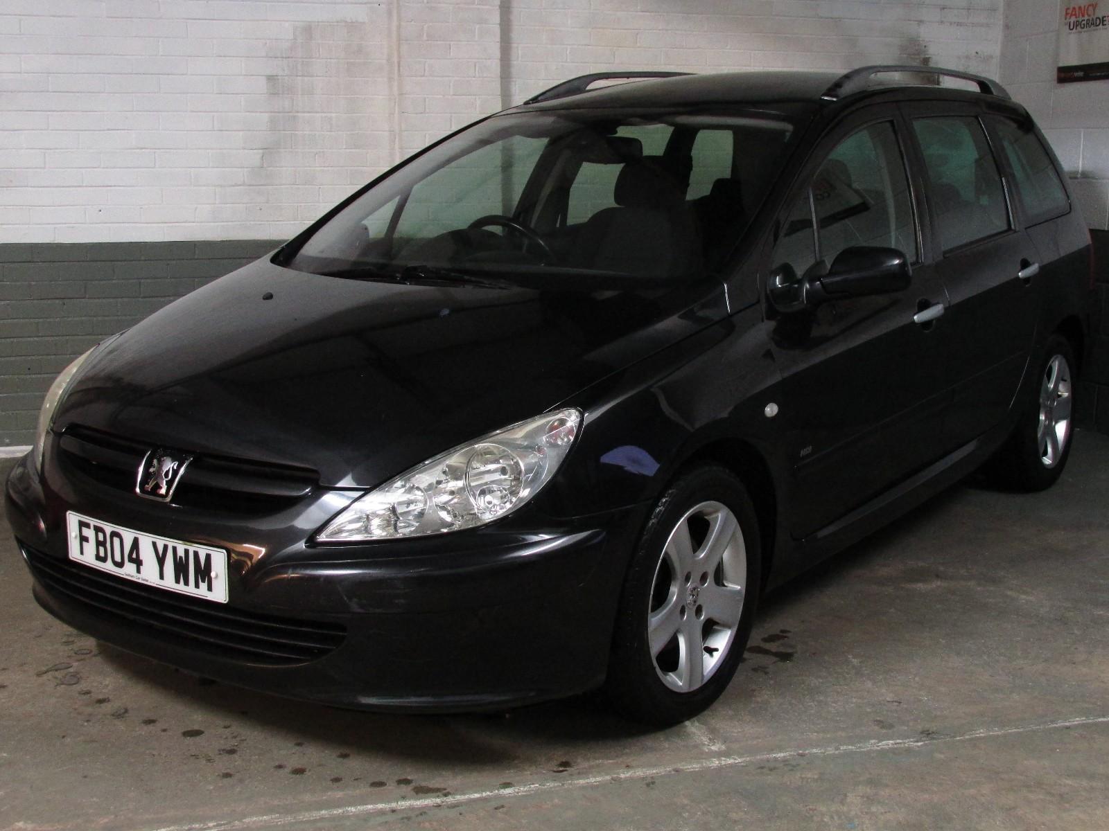

Mr_Bo11ox Posted April 3, 2018 Posted April 3, 2018 I went to see one of these for sale today: https://www.ebay.co.uk/itm/2004-04-PEUGEOT-307-SW-2-0-HDi-90-SE-ESTATE-Runs-Drives-No-MOT-SPARES-REPAIRS/152917649273 Being sold by a trader in Mansfield. I am inspired by this thread and have been keeping my eye on these on eBay and FB market place, this ones been on ebay for about 3 weeks now. Looks quite smart in the photos and the engine drone doesnt seem like a big deal as I would do the cambelt on it anyway if I took it on. Anyway I found the place and the guy fired it up for me, but I just looked at it for 2 mins and said 'nah, dont want to waste your time, its just not for me' Basicaly It was just a little too rough generally. The drivers side had half a dozen scrapes on it and the paint on the front wing had gone funny. Theyre placca wings so wont take much mopping, so really the wing would need repainted. He started it up and sure enough it was droning from the belt end, but i am sure a cambelt swap would fix it, either a cambelt or aux belt tensioner or whatever. The engine was grubby but did not appear to have been attacked by a cable tie & scotchlock merchant. Its got no ticket and needs a refill of Eolys juice to get the messages off the dashboard at the very least, and it looked like it was sitting a little low at the front so might have had a broken spring. Anyway at £450 I said no thanks, and have not regretted that decision! I think a £180 Stilo with another £150 chucked at it for a general going-over feels like a better bet. Lacquer Peel 1
Jimbob McGregor Posted April 6, 2018 Posted April 6, 2018 The ad says it’s a 90 but the warnings spoke of dpf - quick check says sure enough it’s a 110. The aux pulleys/tensioner pulley and best come to a fair chunk (like £80 from my factors for an INA kit?) on the HDI. The overrunning alternator pulley might be seized too, causing vibes in the belt. They’re very sweet once sorted but can take some commitment, as the refurb of a few Berlingo/Partner HDIs has taught me. Great if the car’s a keeper and you’re doing the miles.
bub2006 Posted April 6, 2018 Posted April 6, 2018 I went to see one of these for sale today: https://www.ebay.co.uk/itm/2004-04-PEUGEOT-307-SW-2-0-HDi-90-SE-ESTATE-Runs-Drives-No-MOT-SPARES-REPAIRS/152917649273 Being sold by a trader in Mansfield. I am inspired by this thread and have been keeping my eye on these on eBay and FB market place, this ones been on ebay for about 3 weeks now. Looks quite smart in the photos and the engine drone doesnt seem like a big deal as I would do the cambelt on it anyway if I took it on. Anyway I found the place and the guy fired it up for me, but I just looked at it for 2 mins and said 'nah, dont want to waste your time, its just not for me' Basicaly It was just a little too rough generally. The drivers side had half a dozen scrapes on it and the paint on the front wing had gone funny. Theyre placca wings so wont take much mopping, so really the wing would need repainted. He started it up and sure enough it was droning from the belt end, but i am sure a cambelt swap would fix it, either a cambelt or aux belt tensioner or whatever. The engine was grubby but did not appear to have been attacked by a cable tie & scotchlock merchant. Its got no ticket and needs a refill of Eolys juice to get the messages off the dashboard at the very least, and it looked like it was sitting a little low at the front so might have had a broken spring. Anyway at £450 I said no thanks, and have not regretted that decision! I think a £180 Stilo with another £150 chucked at it for a general going-over feels like a better bet.Been up for sale for quite a while. Looked at a fair few motors over past two weeks and I think that had a chequered MOT history.

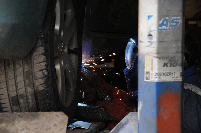

rainagain Posted May 16, 2018 Author Posted May 16, 2018 I had to make up three patches one to remake the inner sill and two for the outside
rainagain Posted May 16, 2018 Author Posted May 16, 2018 With a big thanks to Foad, the sill was once again made of metal as it's maker had intended. Foad is welding in the top two pics and I'm the lower two theshadow, davehedgehog31 and Lacquer Peel 3
