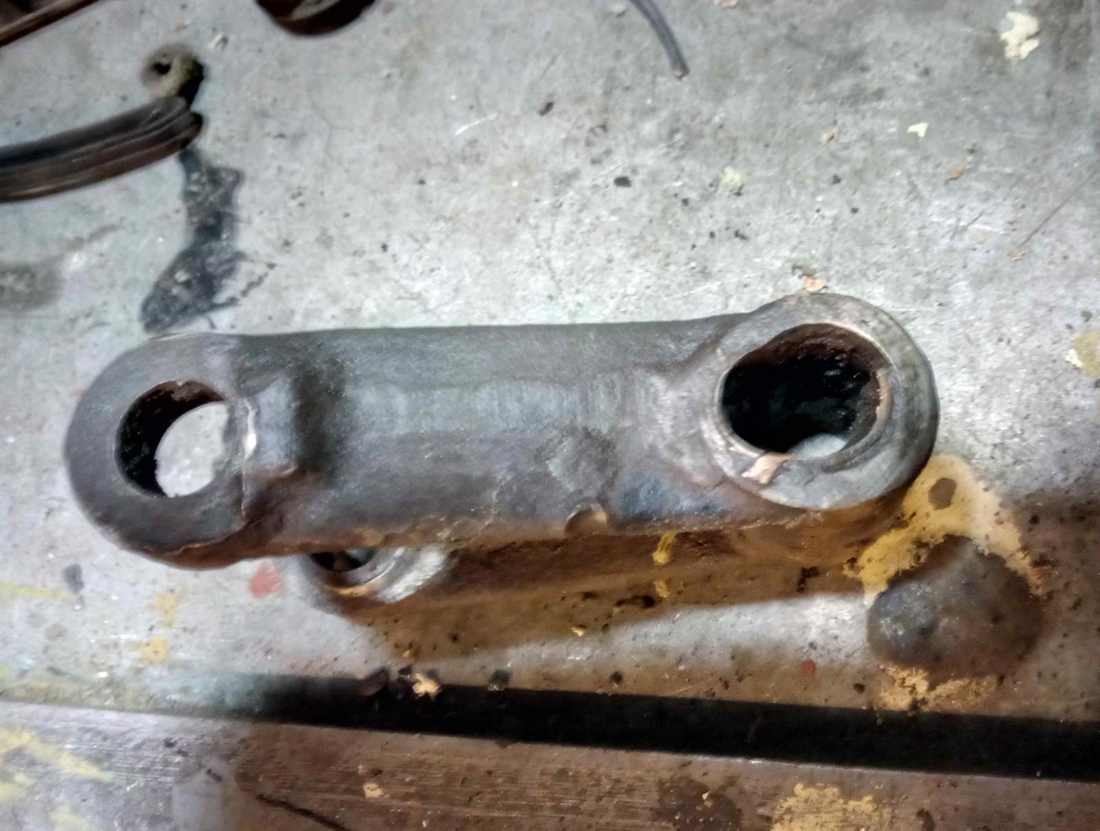

I've got a teensy bit of play in this rear spring hanger bush to sort so I'll certainly be looking for one of Quentin's miracle cures.post-7547-0-54750400-1520275787_thumb.jpg
