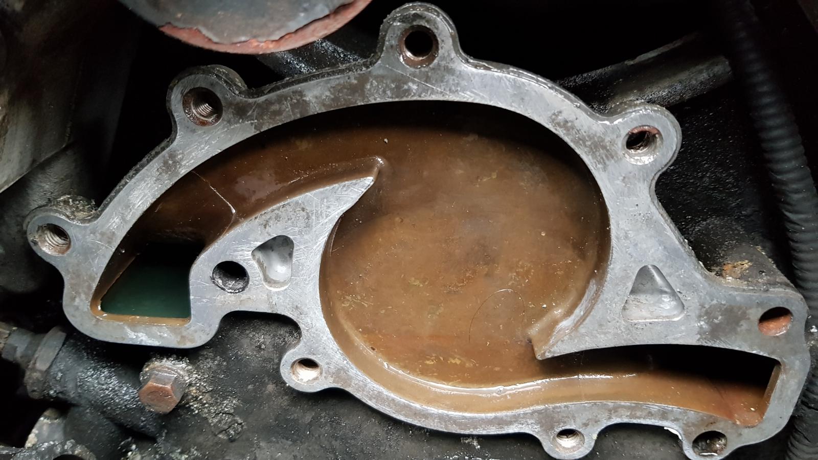

Shiny new water pump
Cleaning up the old gasket was a PITA.
The block

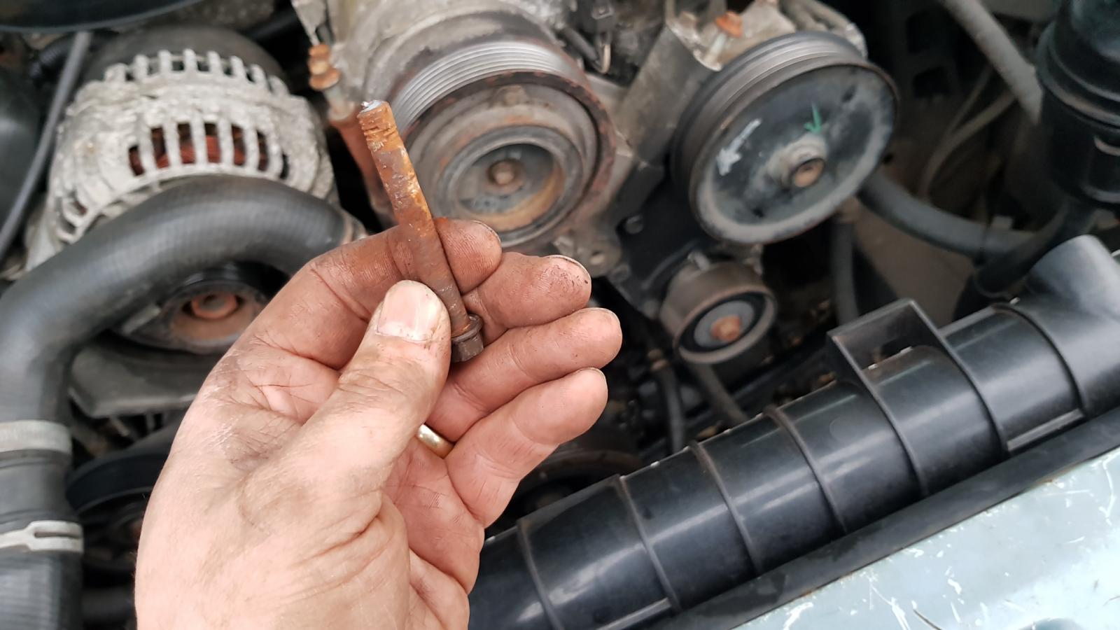

The job was going swimmingly, then
Curseword.
I should have backed it off when it started to tighten with an eighth of an inch to go and cleaned up the threads.
That bolt isn't the one that goes into the water jacket so I carried on regardless.
Put everything back together, filled with coolant and let it run for a while.
No leaks yet. Only the drivers side of the radiator heats up and the heater was cold.
Did it start to unscrew?
I had excellent results removing snapped-off bits of bolt last year with a left-handed drill bit - drill a 3 mm pilot hole into it first, that gives the l/h drill bit something to bite on :-)
More info here: http://autoshite.com/topic/29081-extracting-broken-studs/
Aw, ffs man. :(
I know! I'll have to dig out the thread about broken stud removals.
The bolt wasn't even home when it tightened and snapped. At least there's a good guide for the drill.

See the link in my post above ;-)
Simultaneous typing John! It was when I was putting it back in that it snapped.
