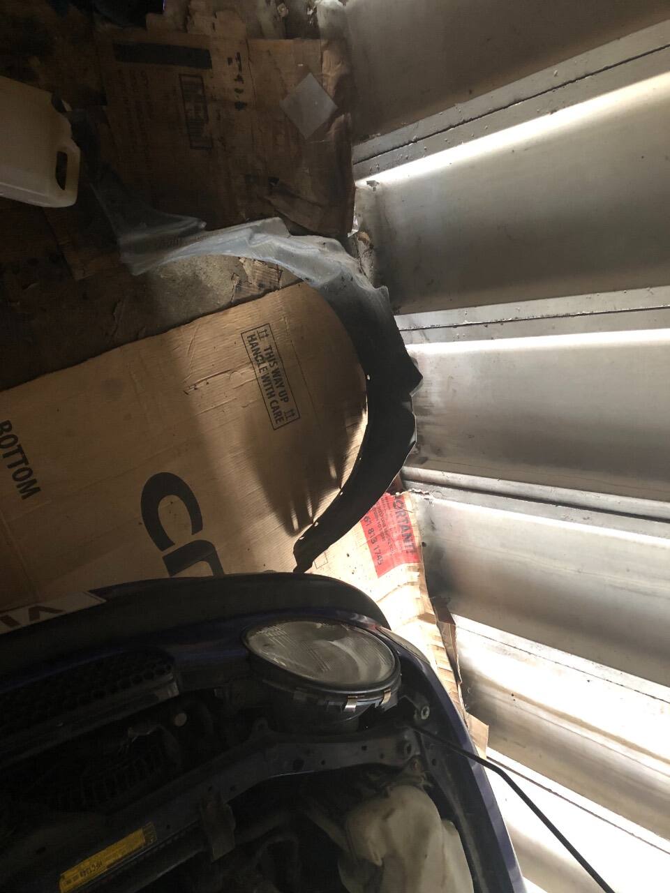

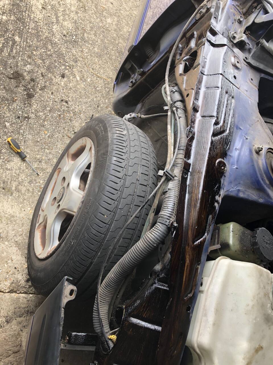

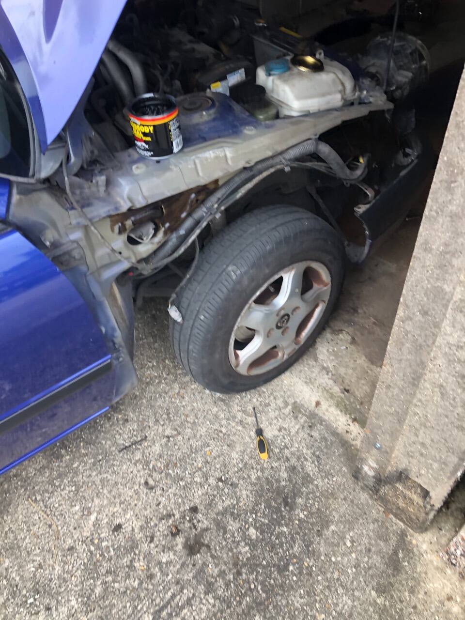

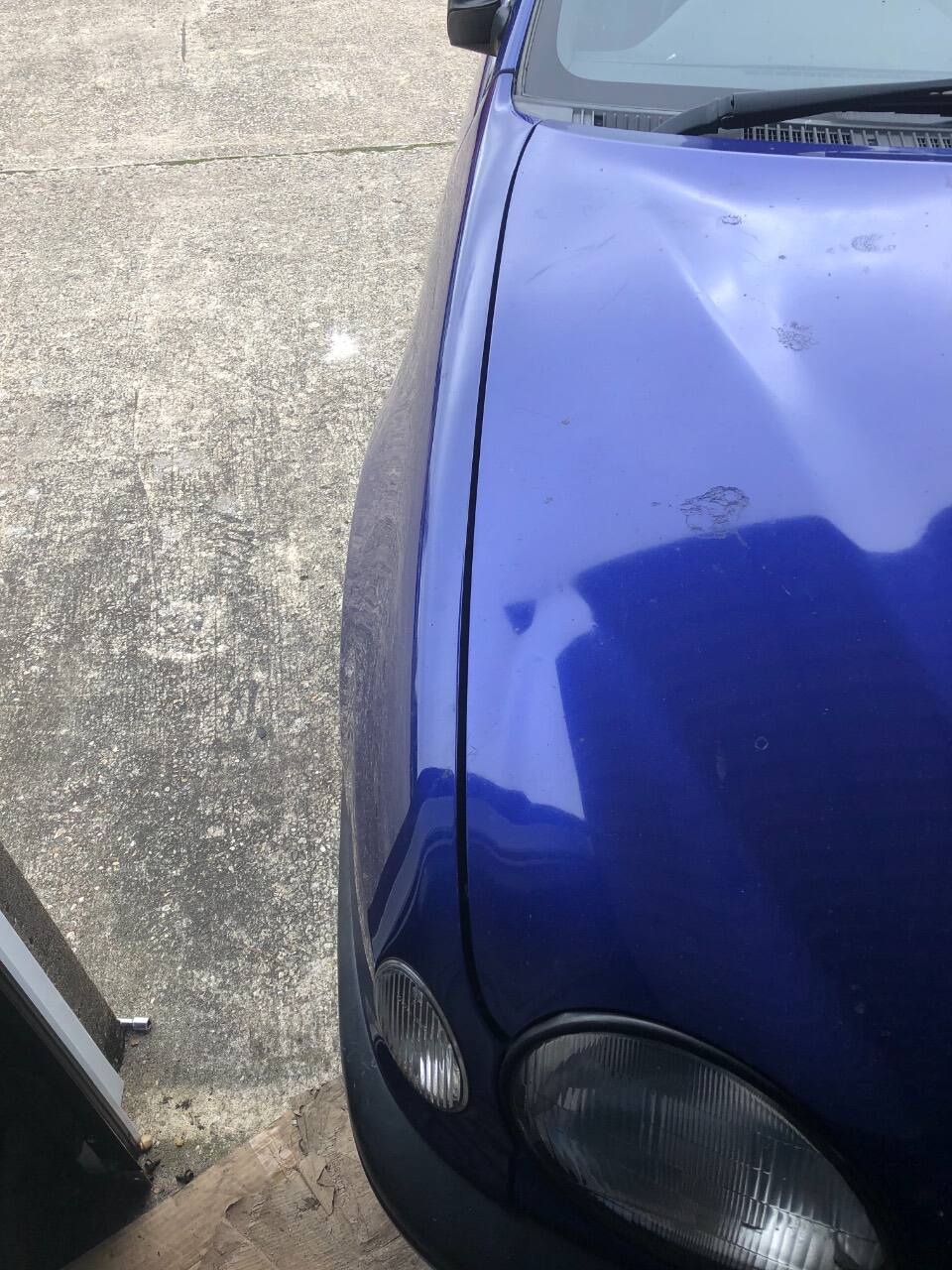

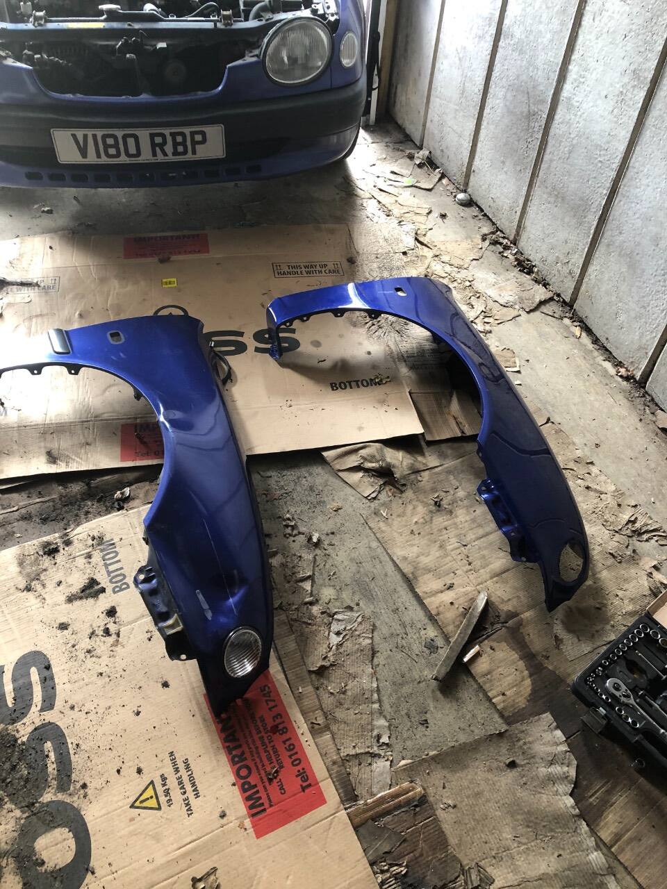

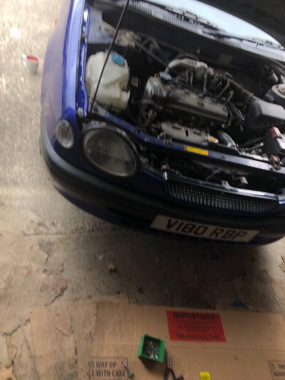

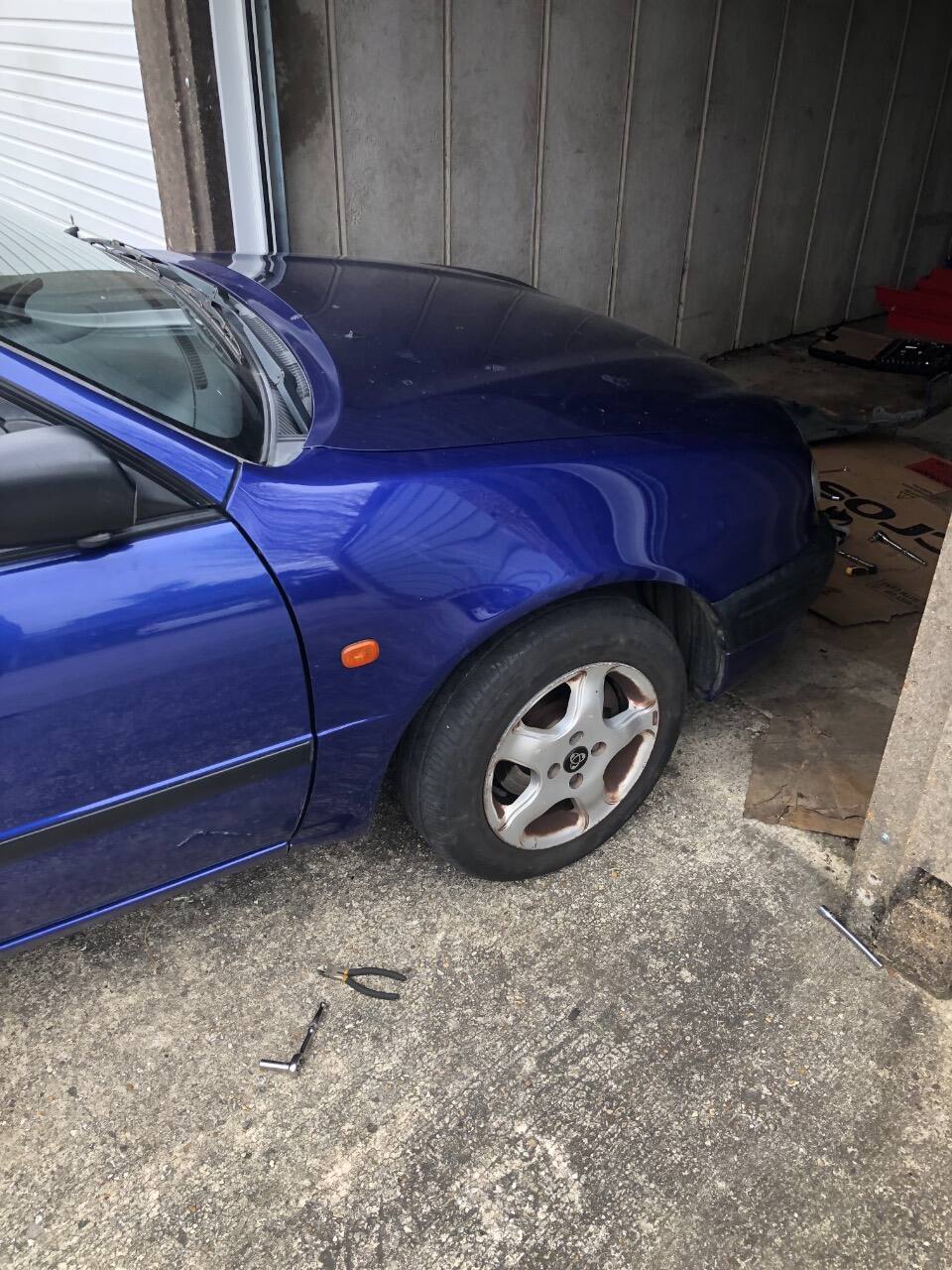

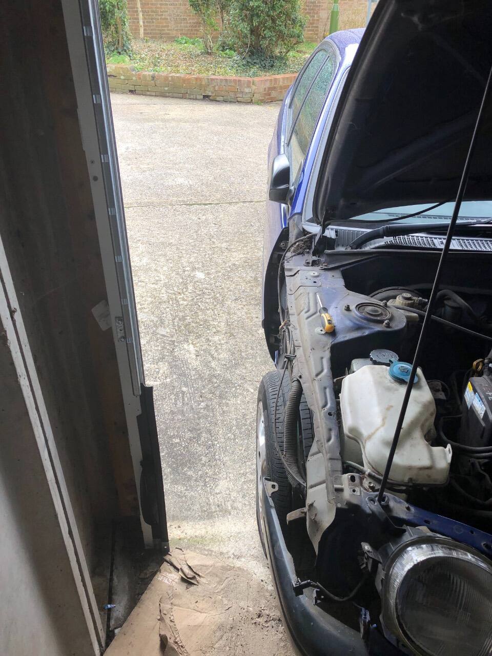

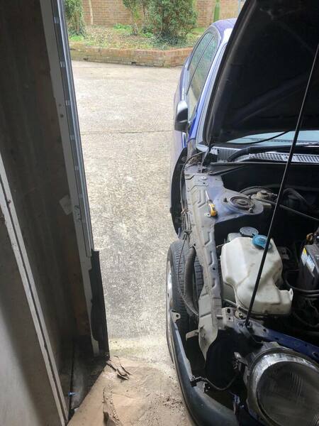

Wing progress.
Getting the arch liner out was a twat of a job. 22 year old plastic snap rivet things meant much recalcitrance to move.
Wing was in comparison a doddle.
I opted not to do a full bumper removal because lack of bothering. I did have to remove the grill though as O/S headlamp needed to come out. Again stubborn fixings meant this didn’t happen as I have  no power in the garage and waiting for cordless tools to arrive.
A good smattering of cavity wax/underseal combo should keep the grot away. It was like new under there.
8475276C-F410-455E-9853-4F1A7DBD12EC.thumb.jpeg.562bae0367a1618e7ef5114e250a9ab7.jpegCAB37F0C-6537-4328-A873-5159730AEEBC.thumb.jpeg.9671dc831d37f69be00db3d9656567d5.jpegD69CC4A3-C8FA-47AF-95B5-B25217E1D94E.thumb.jpeg.d53b9716d677150714d3d31a646b7e46.jpeg
Refitting is reverse blah blah blah. Panel gaps aren’t brilliant because pattern wing which had already been fitted to another car in the past.
TBH a slightly wonky wing is better than a dirty great dent. There was very little wiggle room around the mounting holes. Colour match is pretty good and the few blemishes in the new wing are in keeping with the rest of the car, so it looks like it hasn’t been swapped.

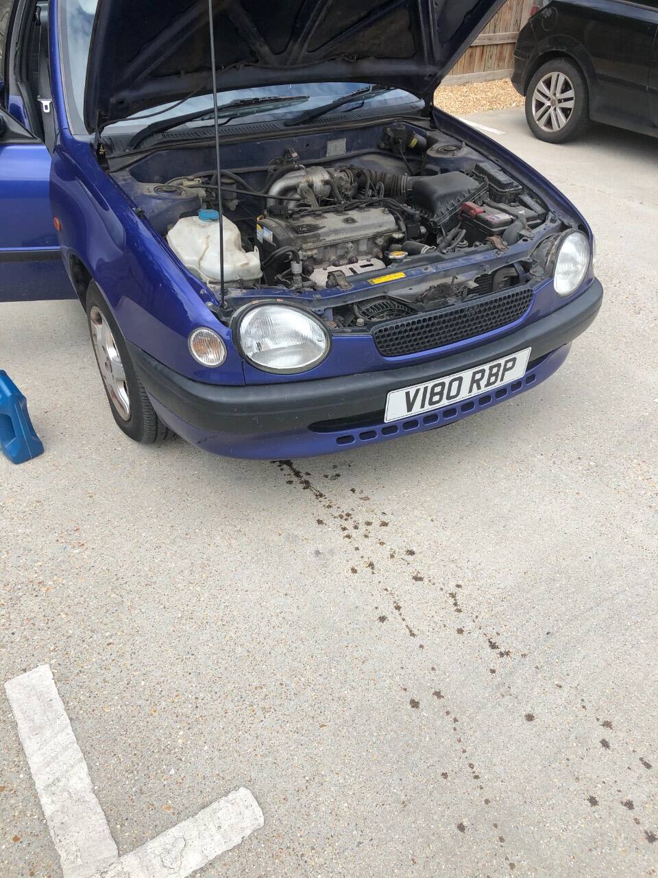

Oh dear
Stepdaughter text me when she got to work that the car was spraying out oil. Oil filter wasn’t very tight or the sealing ring has gone so I have nipped it up by hand - I got a good 1/5 of a turn on it before it felt tight. New one ordered along with oil. I’ve got a crankshaft seal on order as well just in case it’s that.
Do thesr have a crankcase filter on them? HBOL makes no mention of one
  • dozeydustman changed the title to 1999 Corolla of Pleasure - drippage
The car has been sitting overnight and there is still a puddle of oil under it, however it’s now much smaller and it didn’t leave a trail on the road when madam brought it back yesterday evening. I’m hoping it’s just residual and I’ll clean it all up.
I’ve got an oil filter on order which I should be picking up this evening or tomorrow morning.
Oil and filter change first; if that doesn’t cure it then I’ll change the crankshaft seal (also on order). Failing that I’m at my wit’s end and there’s no oil cooler and no pipework for oil that I can easily see. Just hope it’s not some internal seal

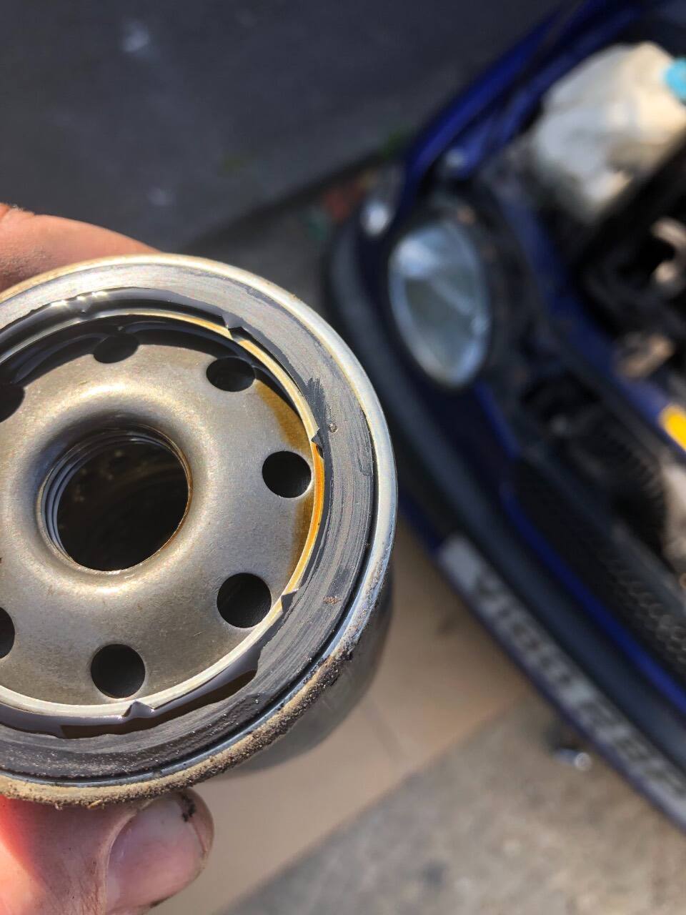

Whipped old filter off after it fought me and dropped the oil.
the seal wasn’t in the best of health and as you can see in the top picture it has damage. Replaced filter and filled with oil.

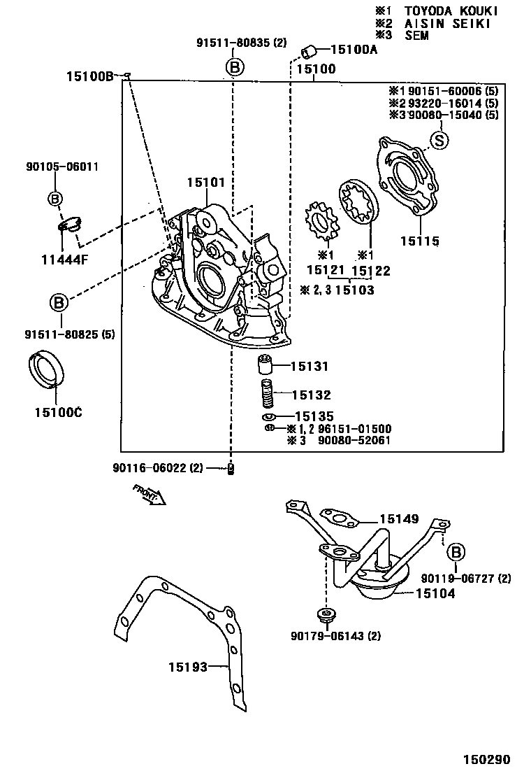

Given the 4E engine has a cam belt driven oil pump this seems a likely cause. Hopefully it’s a seal somewhere under the timing case and isn’t mega-£ to fix

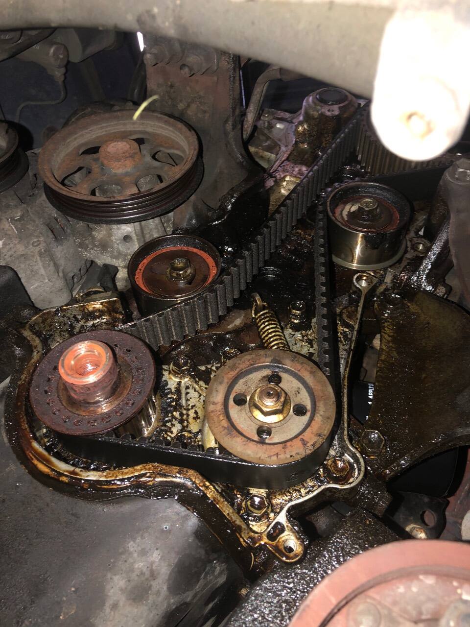

it's the actual oil pump under the timing cover that's spraying oil everywhere. Cambelt off, sump off, strainer removed and change an o-ring by the looks of it.
oh, and there's a nail in the offside front tyre as well :/

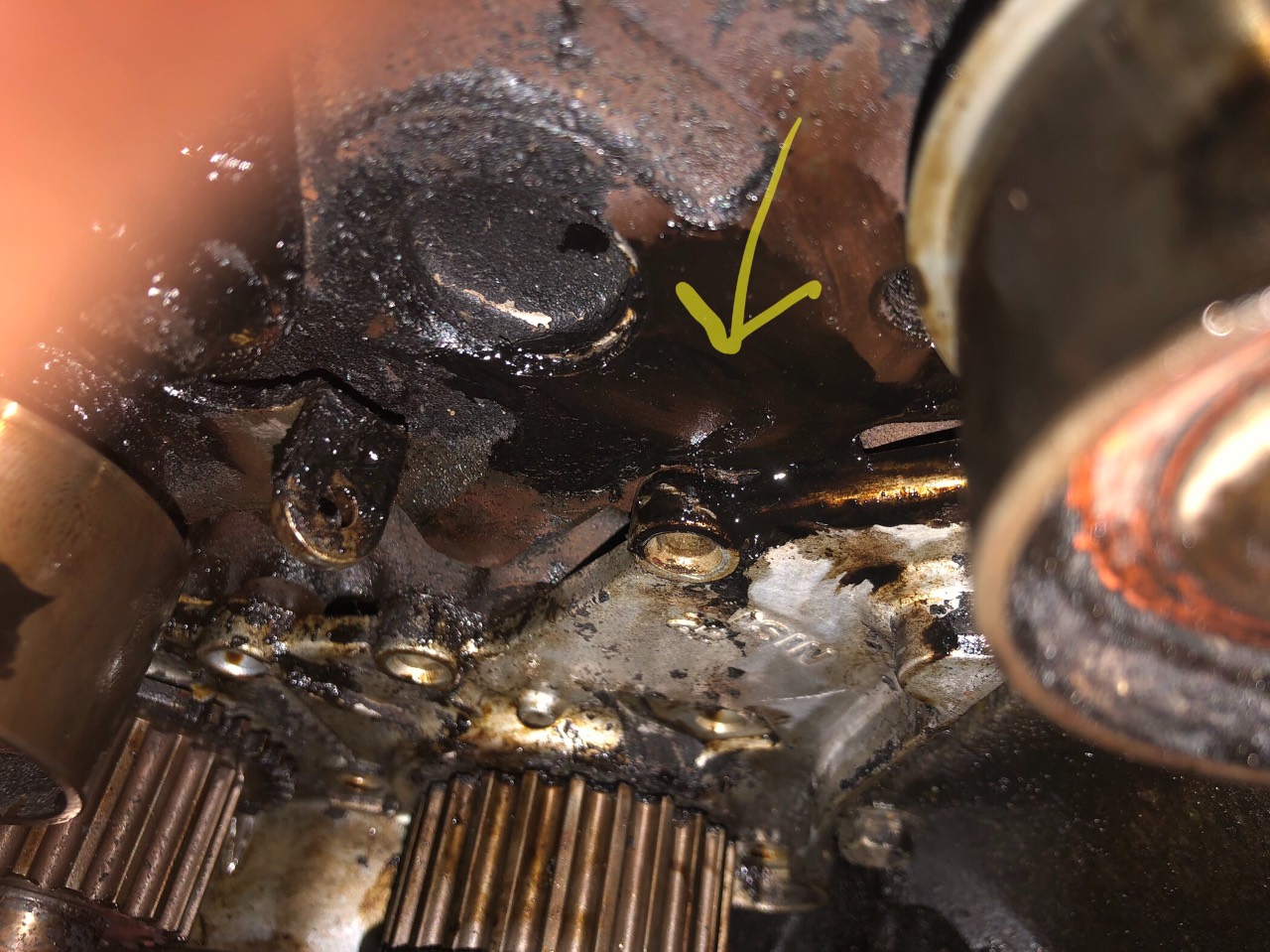

Definitely some major leakage in there
This doesn’t look good
tiny line here, and i’ve wiped it several times yet oil collects here. I hope this isn’t a crack
You'd be mightly unlucky if that's cracked.
Hard to tell though.
  • dozeydustman changed the title to 1999 Corolla of Pleasure - is this RIP?
That’s the thing @St.Jude. I know how resilient these 4E engines are. It’s just under 200k and was starting to lack some oomph so I did start thinking maybe in the next 3-4 years it would be rebuild time.
If it is a crack then I don’t have the space to rebuild the engine into a new block; a second hand engine is around £400 on eBay with some kind of guarantee or £250 for one without.
I was really hoping not to have to send this car off for a long time yet as it’s been in the wife’s family since 2000 (wife’s dad bought it at 6months old) so it’s certainly been a good hack for them.
Looks a bit like a crack, and looks like it’s been weeping for a while.
Before condemning it, might be worth trying some JB Weld or similar, as I sealed a corrosion hole in the block of a 205 GTI engine years back, and it survived 2 seasons as a sprint car after. That was coolant leak, though, not oil.
